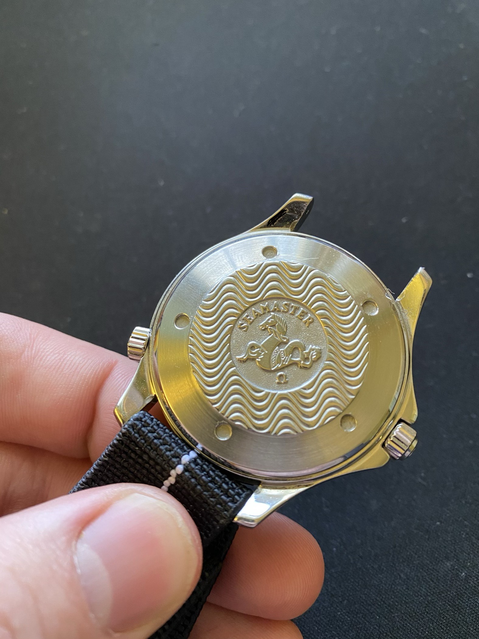

No expert here, but is the "Seamaster" in red correct? Also, both of my Seamasters had the waves surrounding the seahorse on the case back.

Hi Tony, thanks a lot, from what I learned over the past few weeks, the red seamaster and the different case back are expected for the 2221.80 generation. Maybe your seamasters are 2541.80 ?

Both of mine were the mid-size models. The first was a 2062.50 quartz, and my present one is the 2551.80 mechanical. On further research online, it does appear that the "Seamaster" did come in red on some models...I stand corrected!

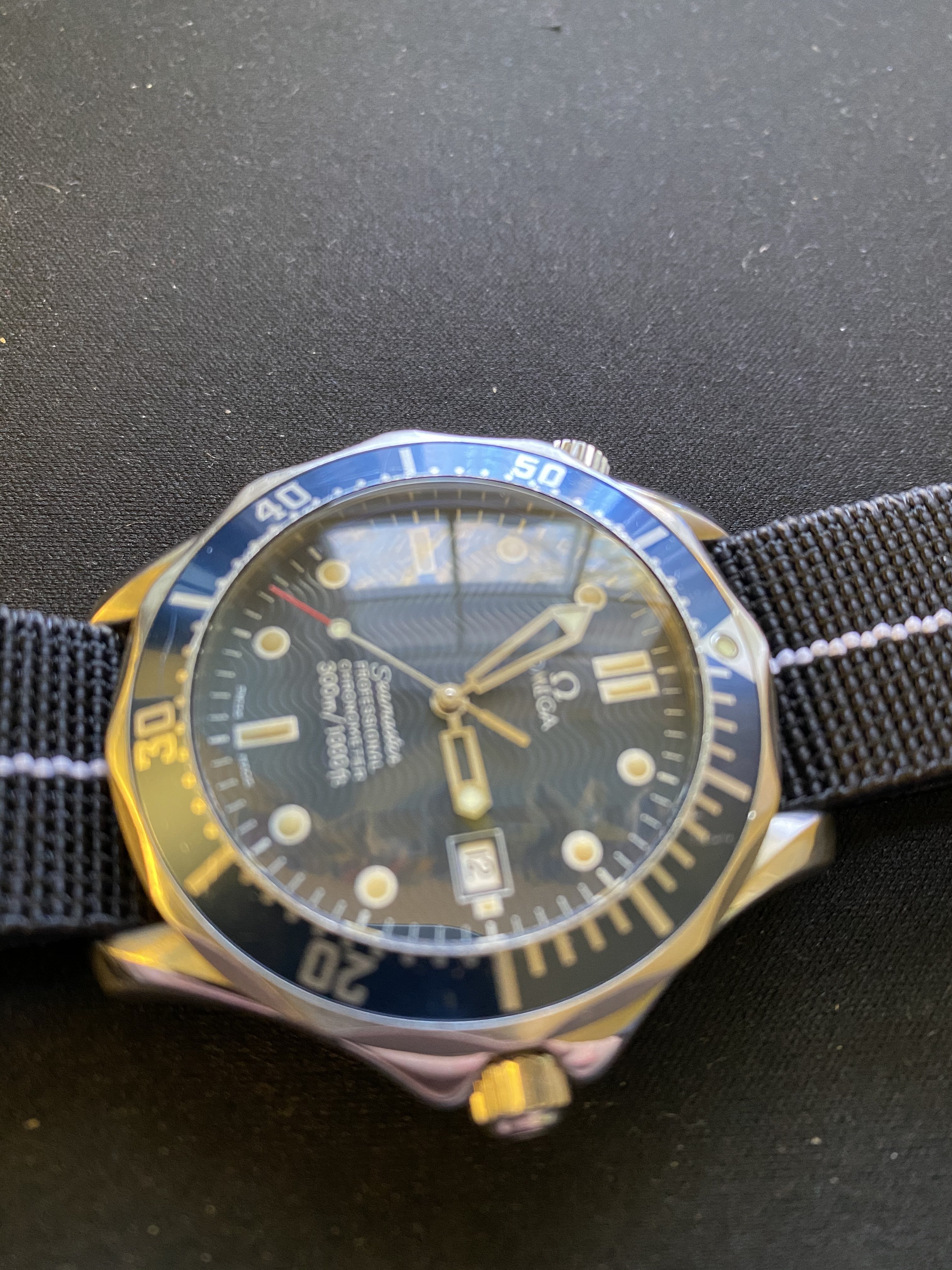

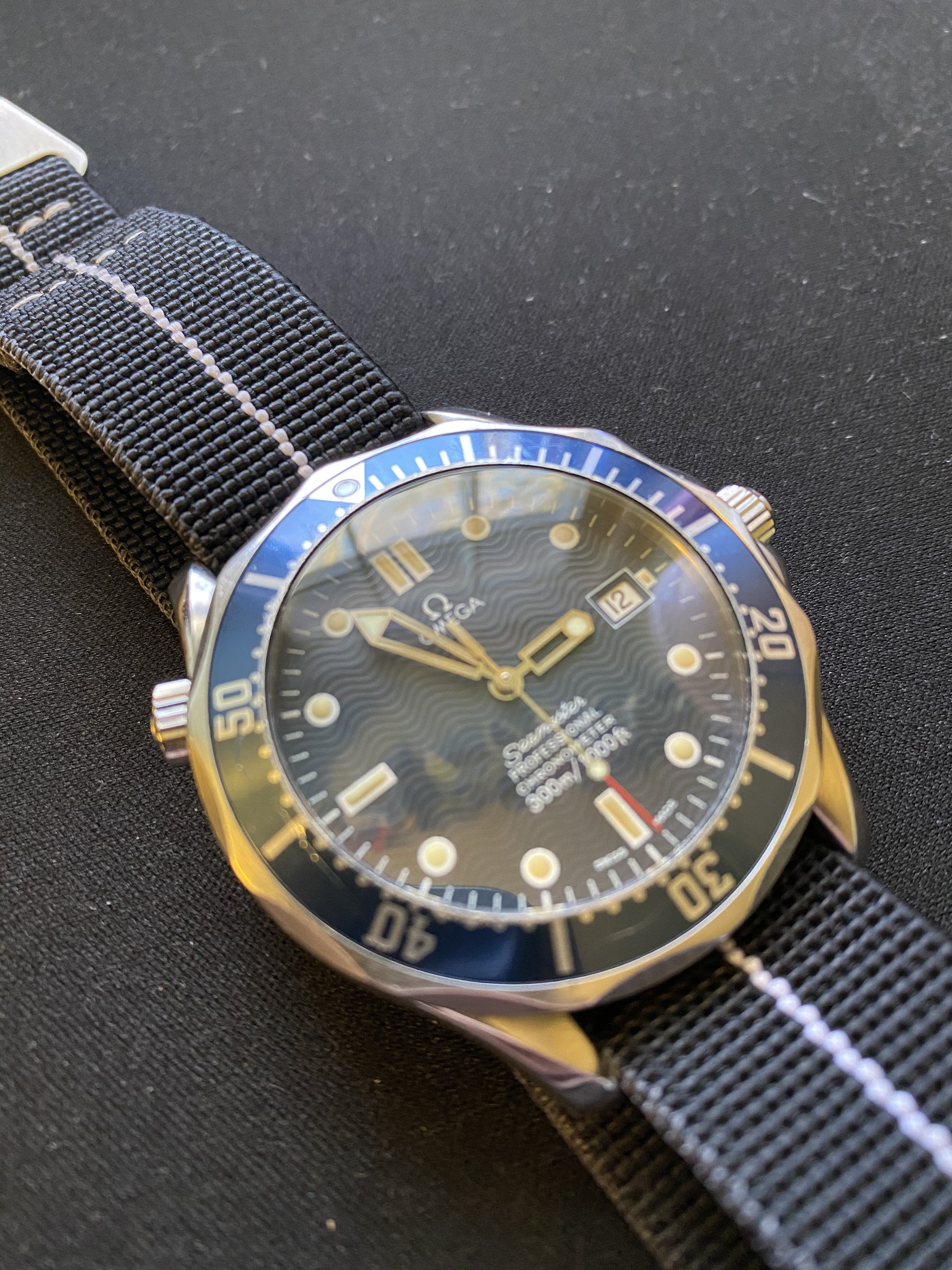

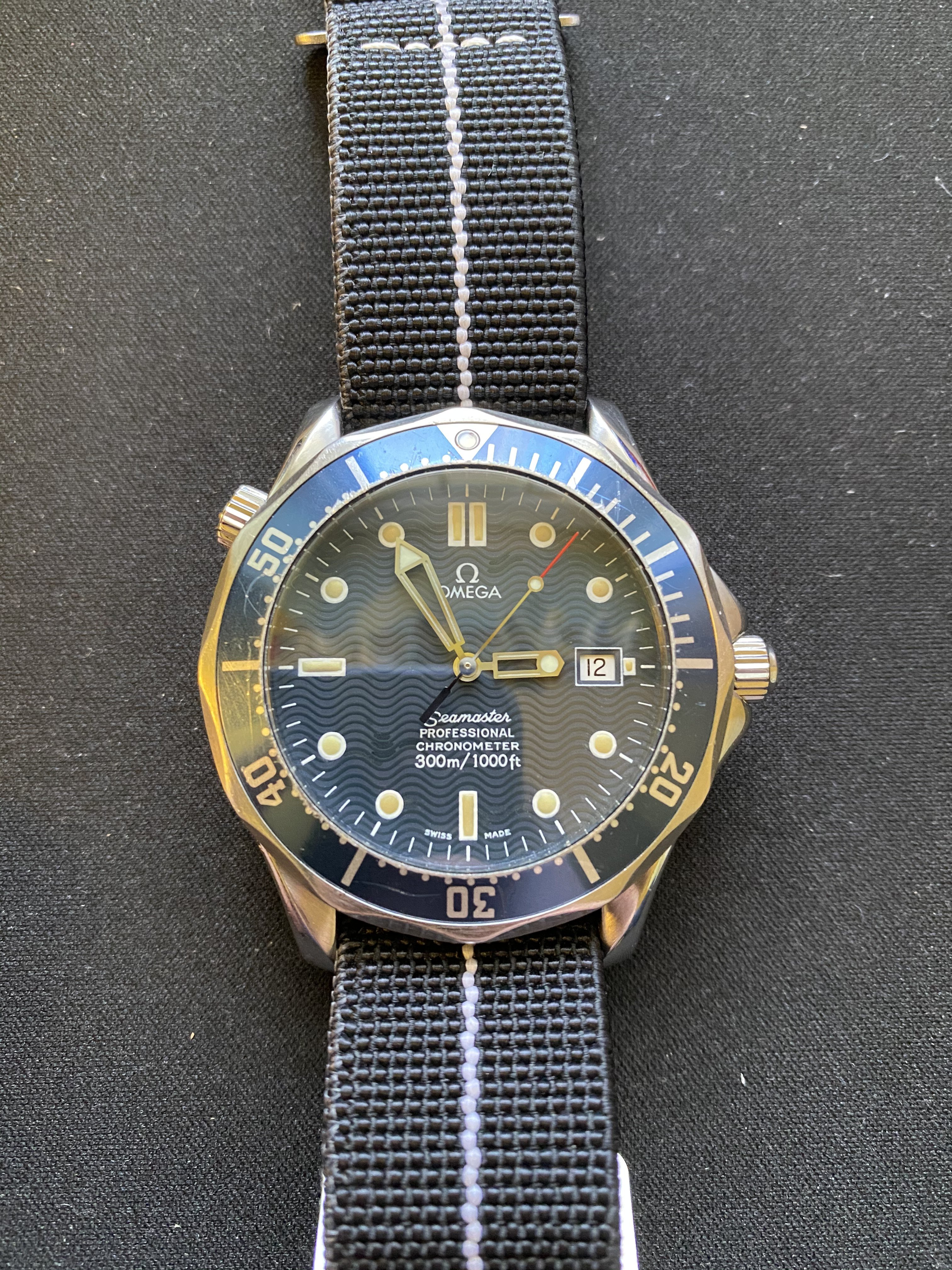

I bought a Seamaster Pro ref 2531.80 (circa 1999) and I wanted to confirm that it is authentic. everything about the watch seems spot on to me except for one thing. All the common mistakes on replicas are good on this watch. The lume pip is in the right spot, the helium valve is good, etc. It even has a serial number and the original seller gave pictures of the movement (but these could always be faked.) The one thing that doesn't seem quite right to me if the dial. The lume just seems a little messy... Maybe this is a common thing with this watch but I'm not an expert. Here are some pics. Thank you in advance everyone!

This is tritium dial, does it still glow anyhow?
Possible that hands been replaced by superluminova hands but at the end of the day the watch looks all original.
3
Spot on. The hands were replaced and the dial is tritium. It still glows but not very bright. I trust the seller and I believe the watch is real but I just wanted some second opinions 😀 Thanks for looking!

But maybe not a 1999, as I think 1997/1998 were the last Tritium years - my son and I have 1998's with luminova, but maybe a few tritium dials snuck through then. Looks genuine.
3
Serial is 60,###,### so i believe its 99. Maybe a few snuck in idk haha
