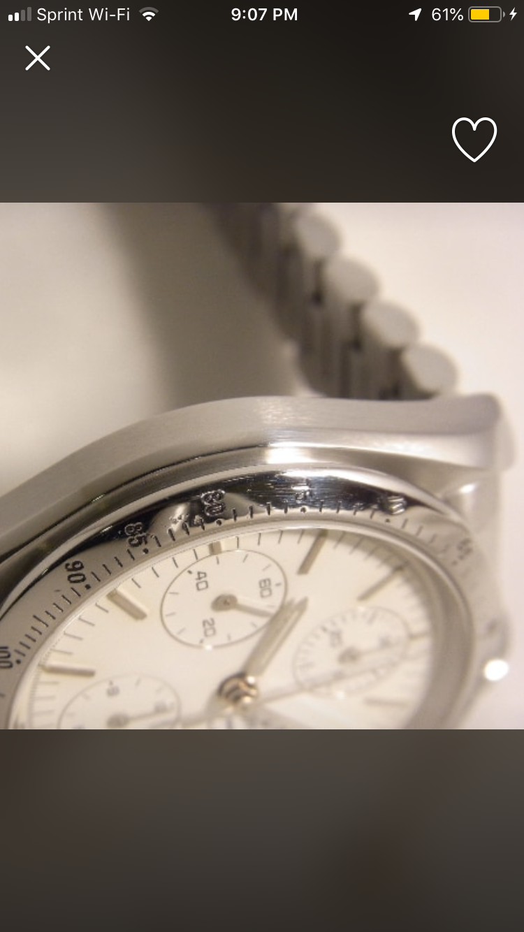

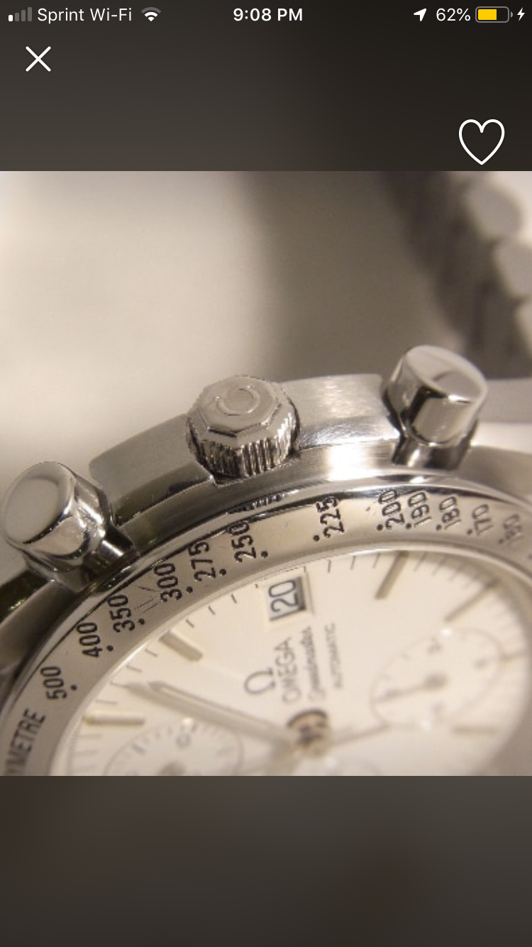

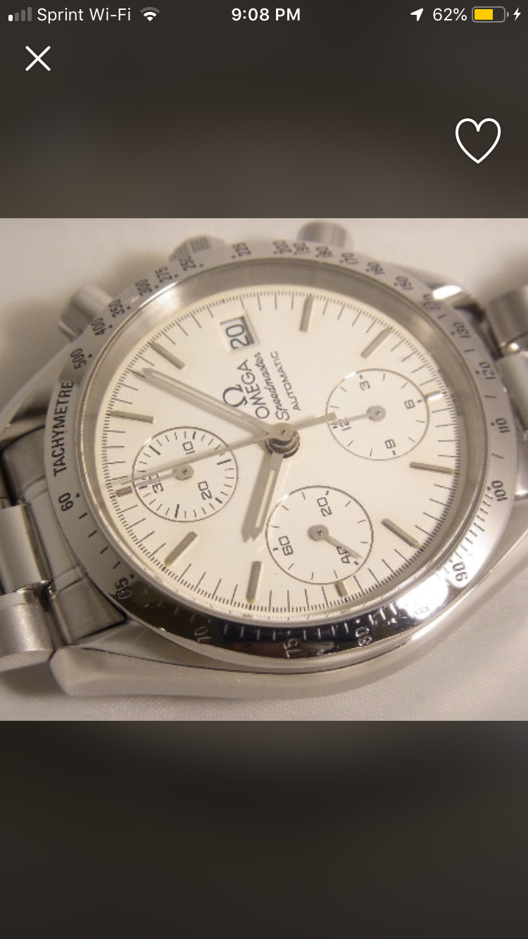

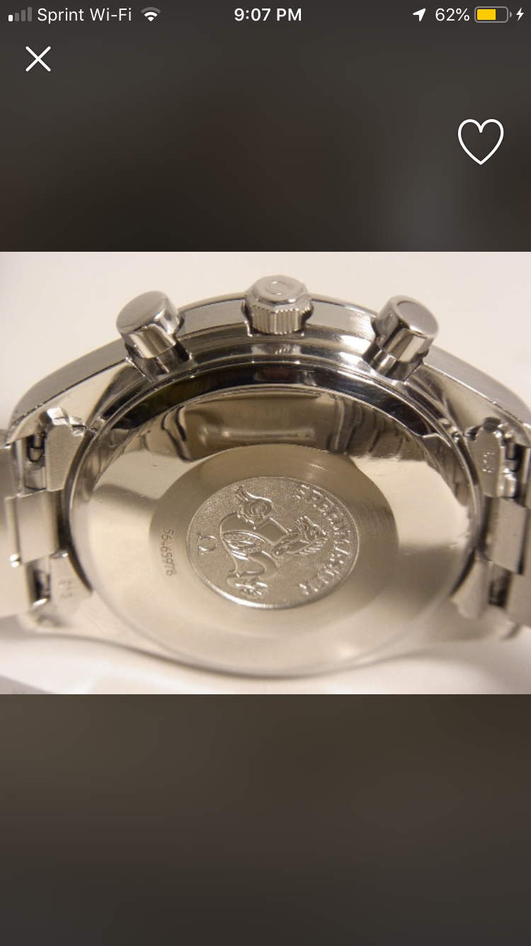

My query is about this 3511.20. The thing that’s jumping out at me most is the case back and the lack of sharpness where it says SPEEDMASTER, the other item that gives me pause is the engraving on the clasp and the Omega symbol there. There are probably other things that will jump out at you experts. I would greatly appreciate an educated assessment of the authenticity of this piece.

Looks fine to me. Never seen a fake with a serial number on the back.

I'm pretty sure it's legit but let's wait some more insights. Do you have pictures of the bracelet and movement ?

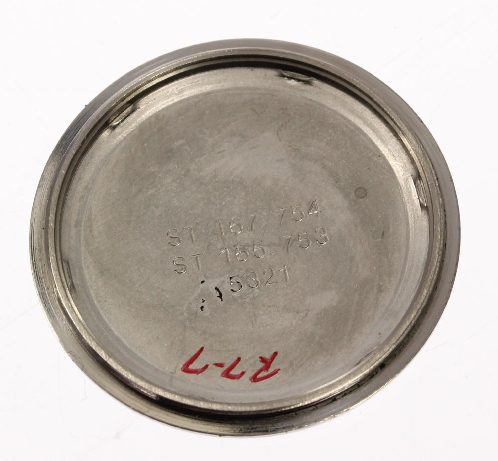

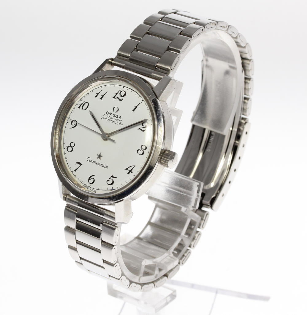

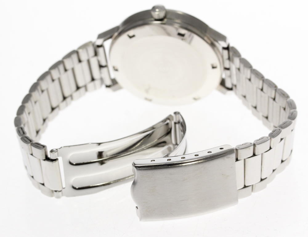

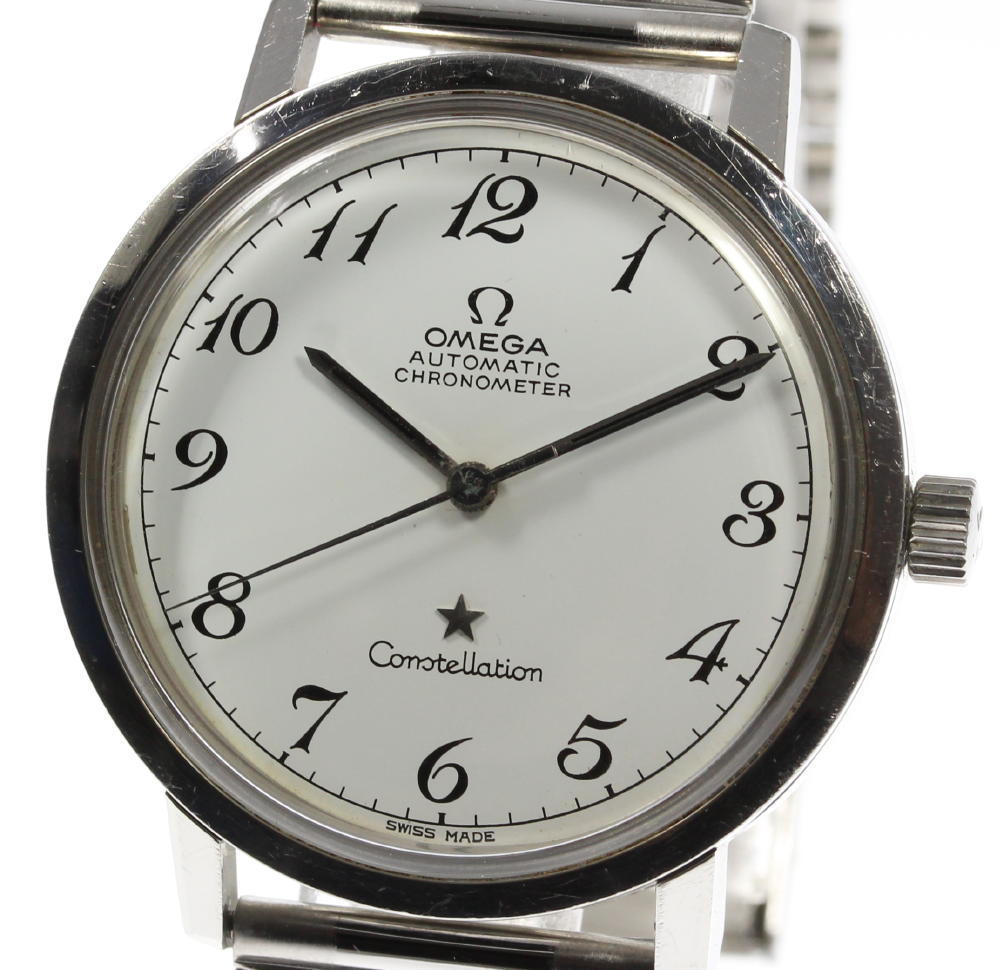

Thoughts on this? I tried looking up the number listed on the case back but none of the results match the dial.
8,701
14,612
It's not fake. Japanese market Connie. I thought it was a redial but I have found another with this dial (doesn't mean it isn't just that there's more than one). http://item.ocnk.net/product/4803

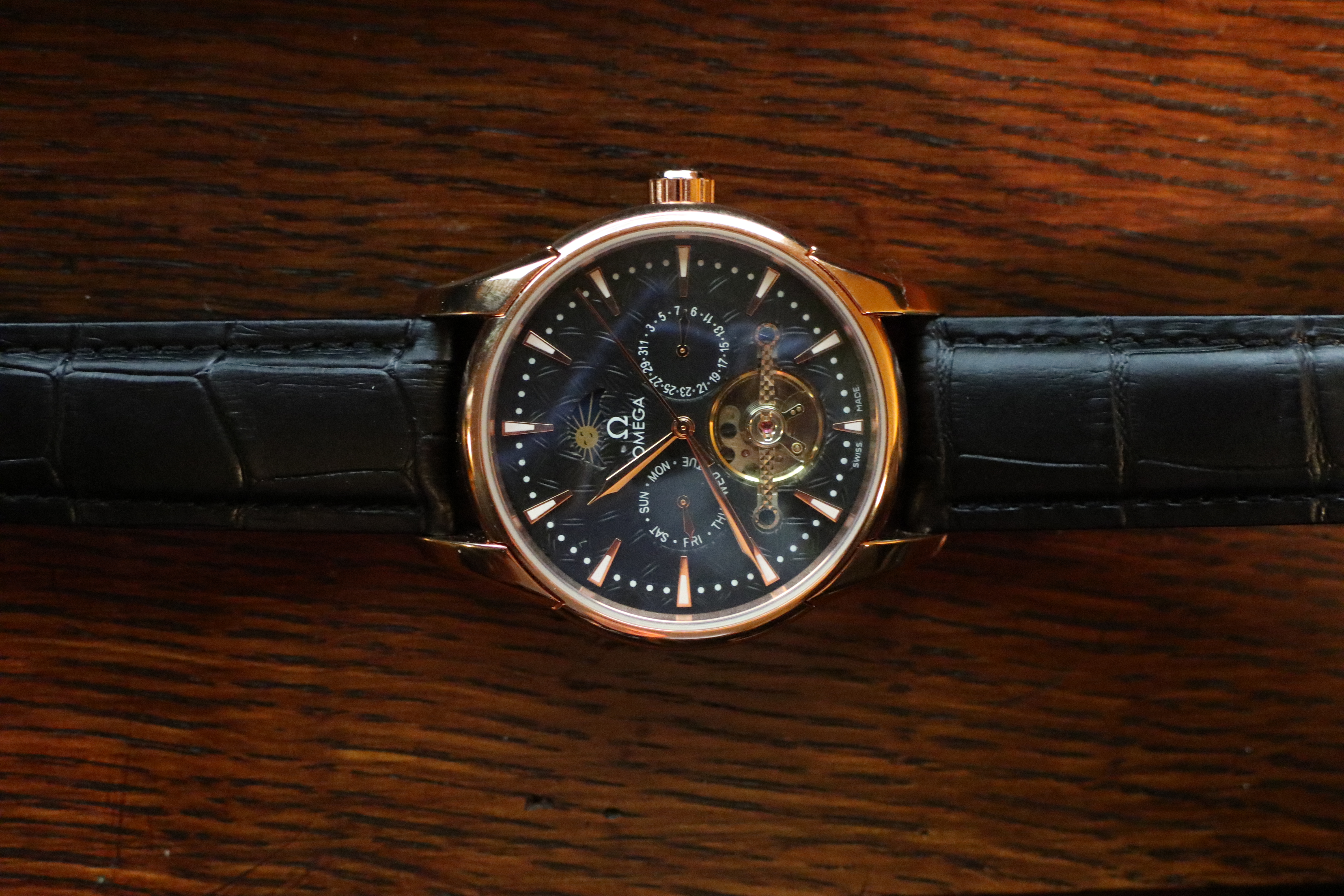

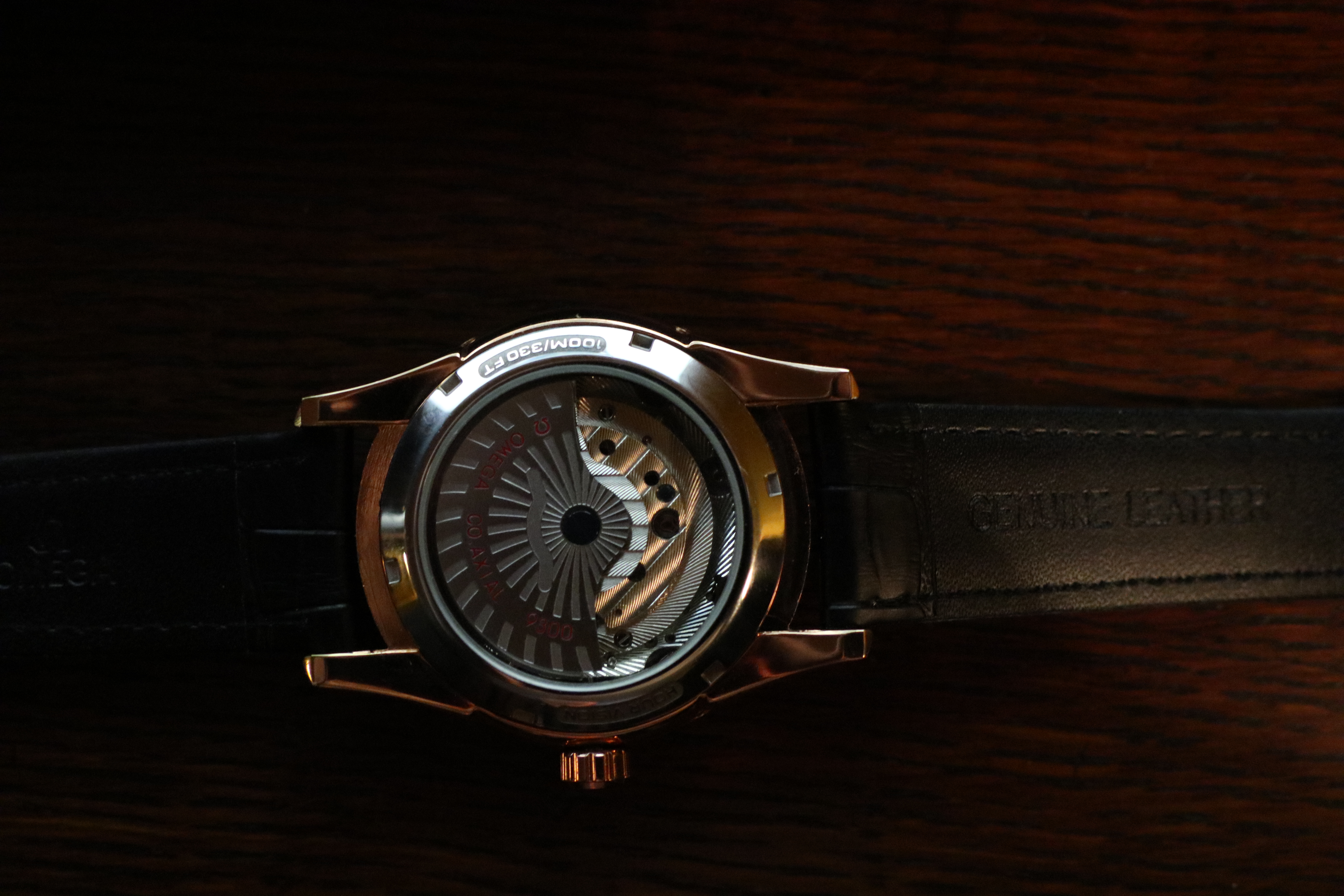

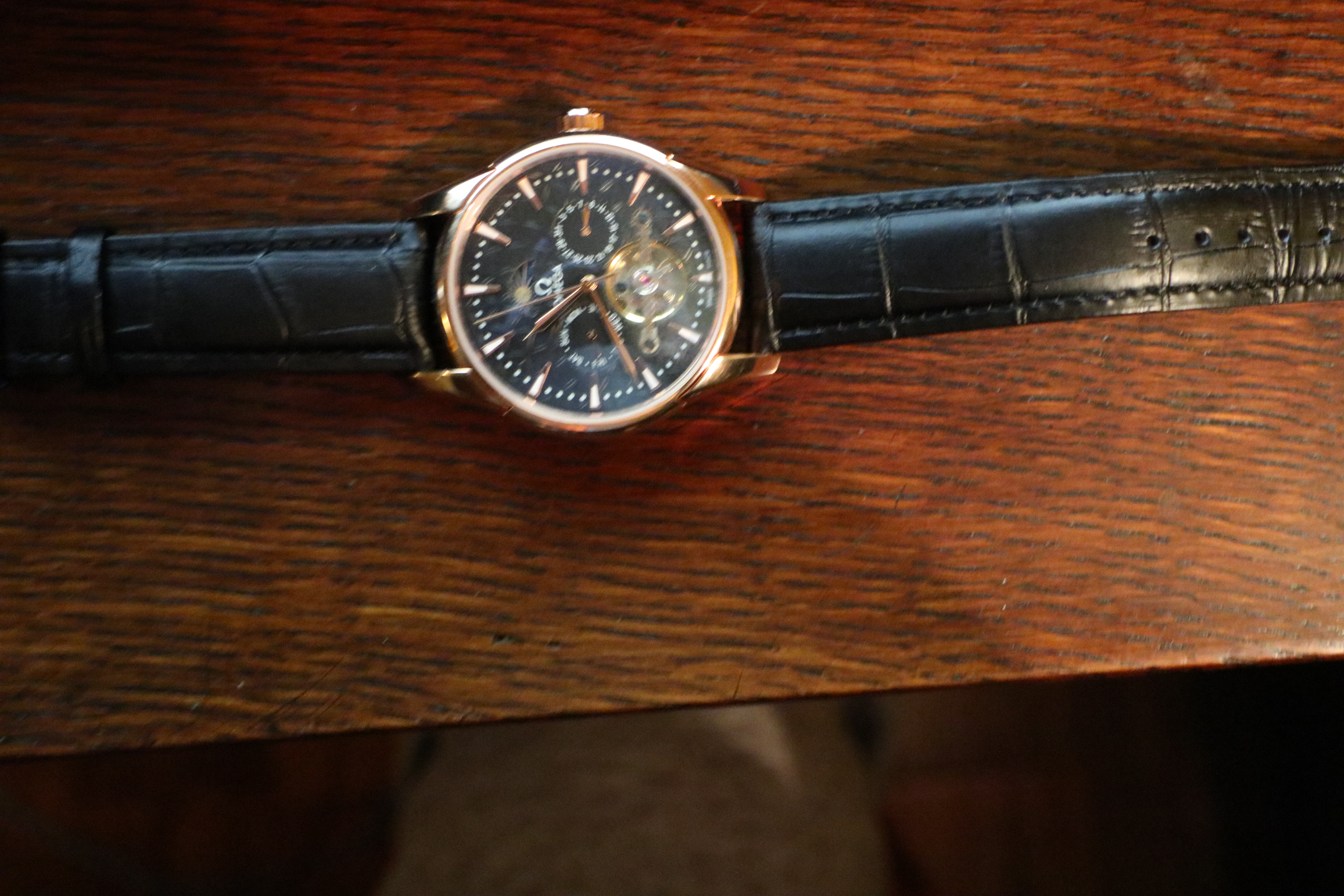

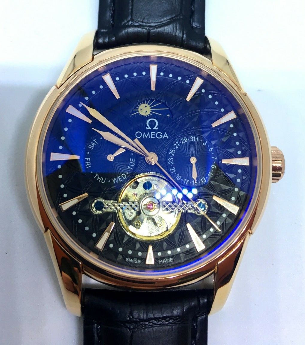

View attachment 705723 View attachment 705723 View attachment 705723 99% sure this is a fake but it is not a copy of anything I can find so not a knock off. Is it just someone's design logoed OMEGA? thanks for any insights! https://www.ebay.com/itm/Automatic-Calendar-Watch-OMEGA-CO-AXIAL-9300-Style/153351530271?ssPageName=STRK:MEBIDX:IT&_trksid=p2057872.m2749.l2649
Pic for posterity.
