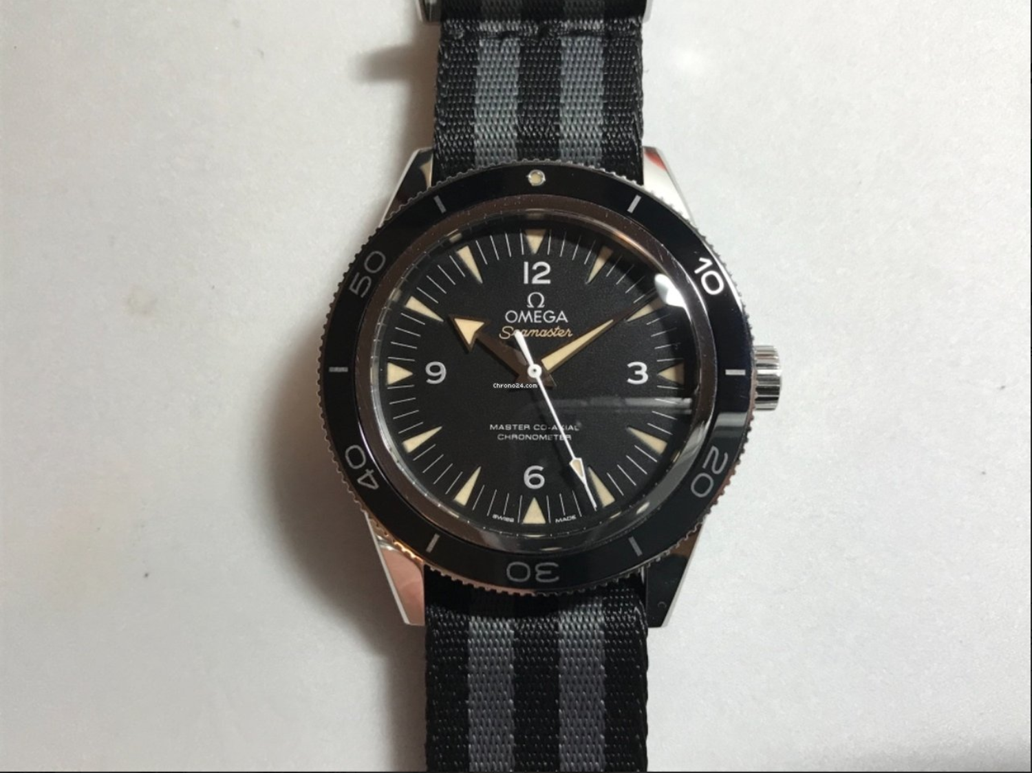

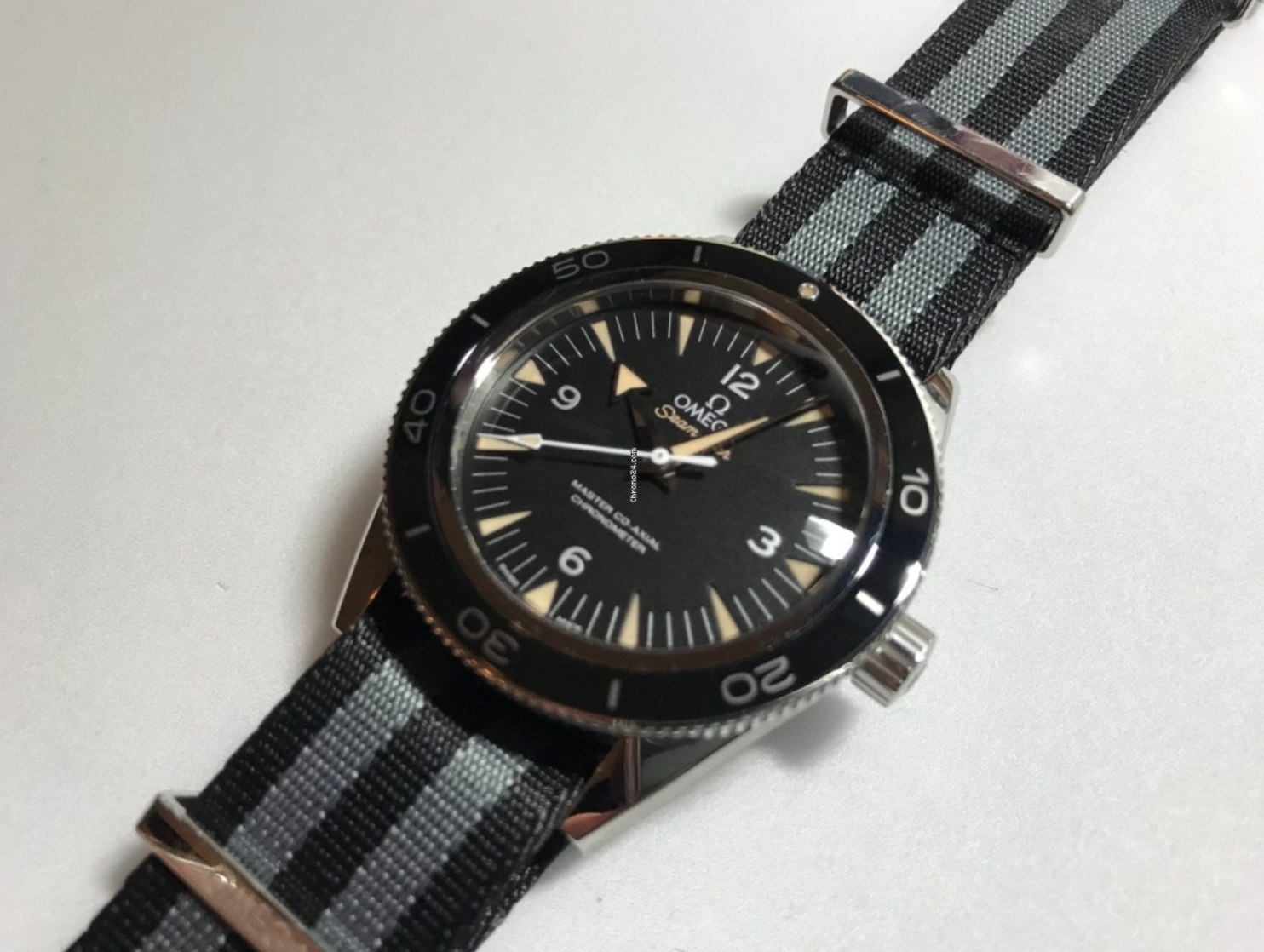

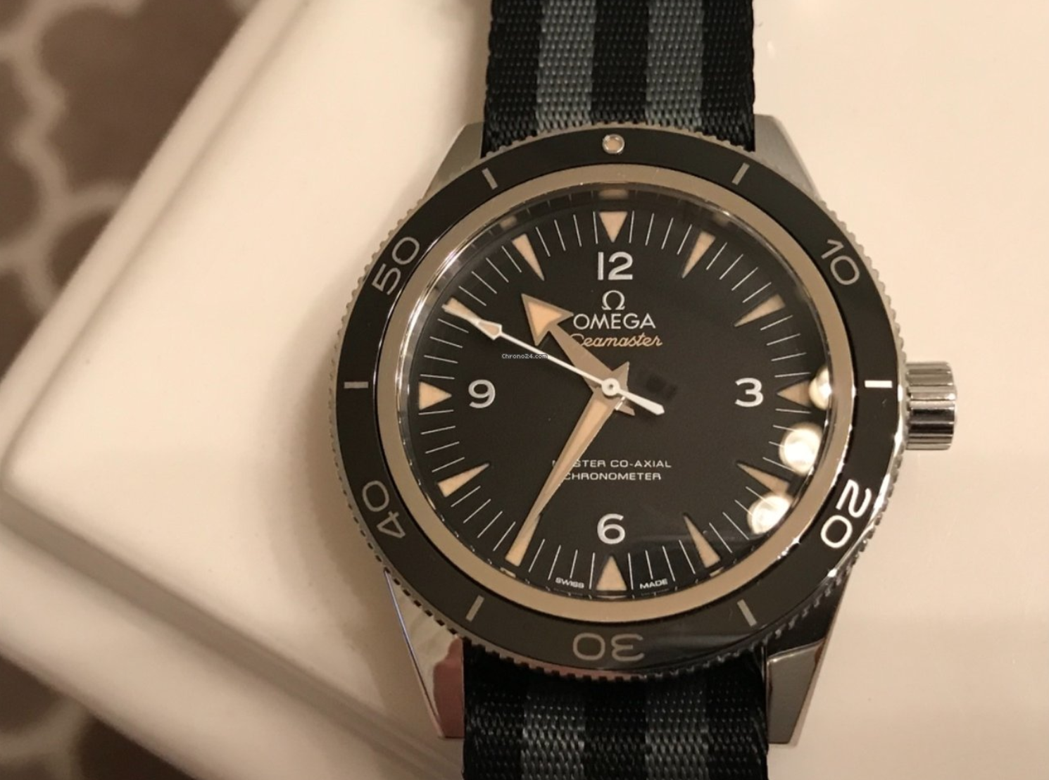

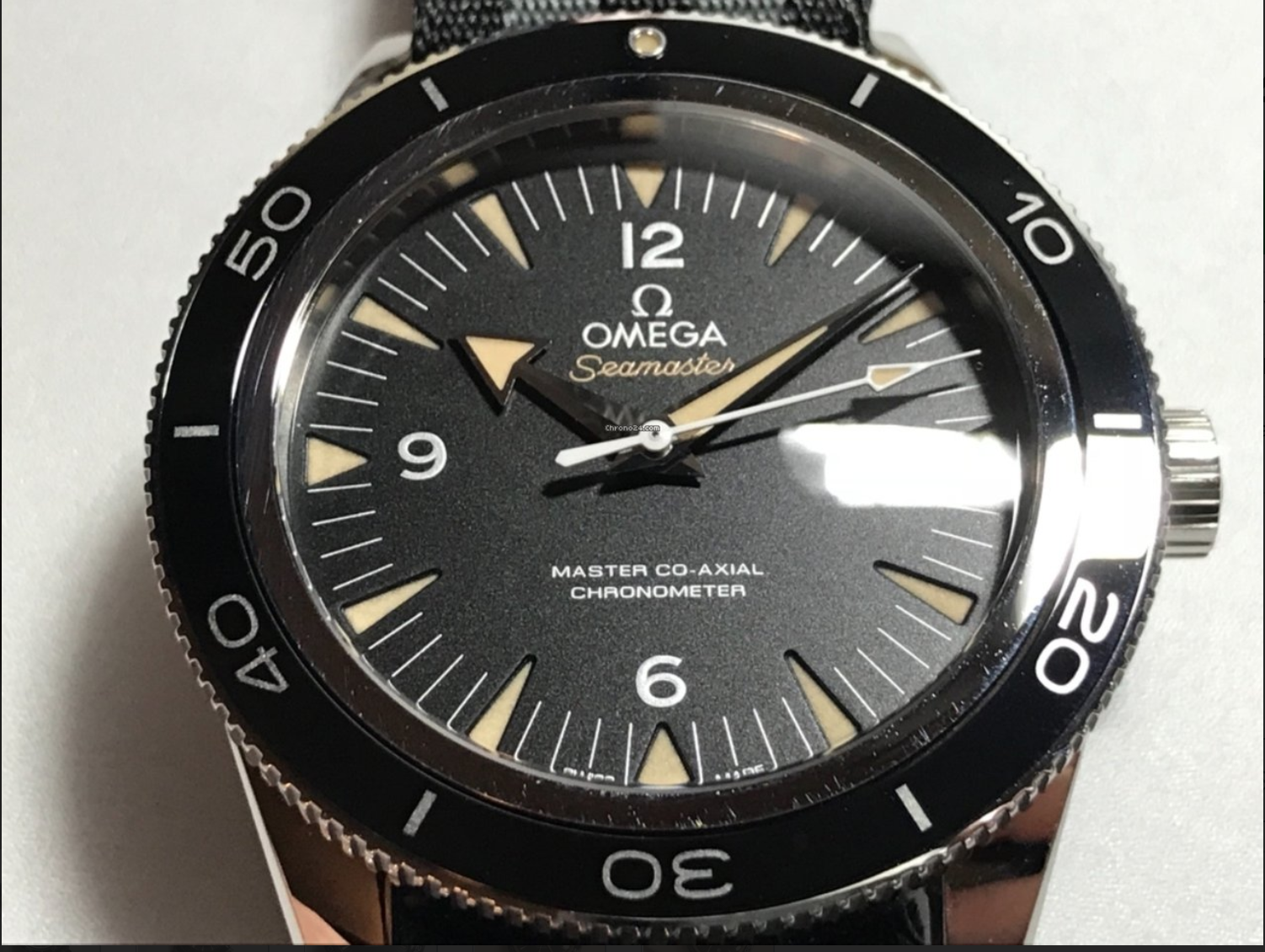

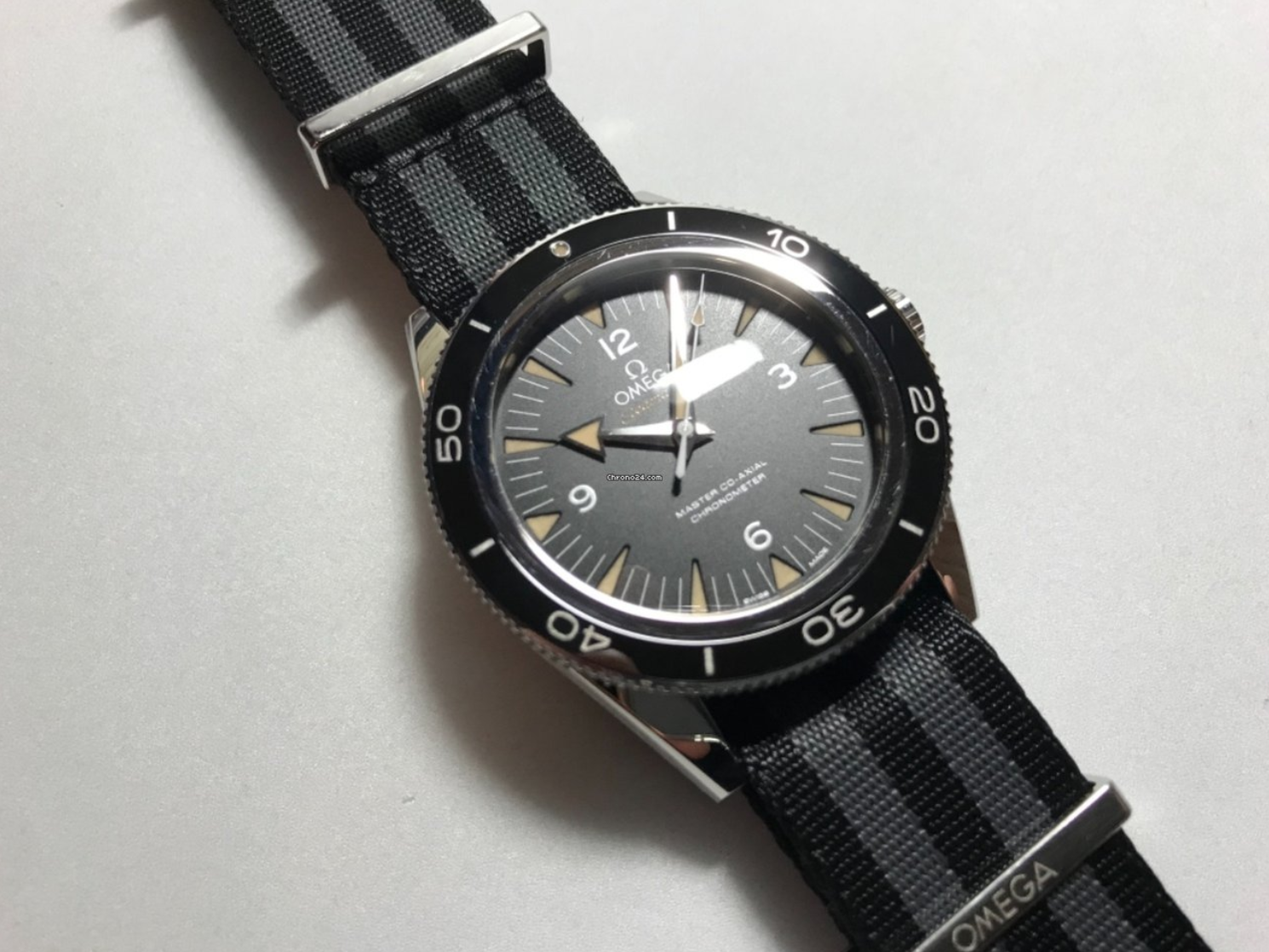

Hi everyone.

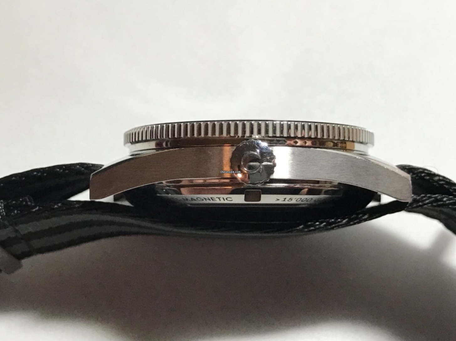

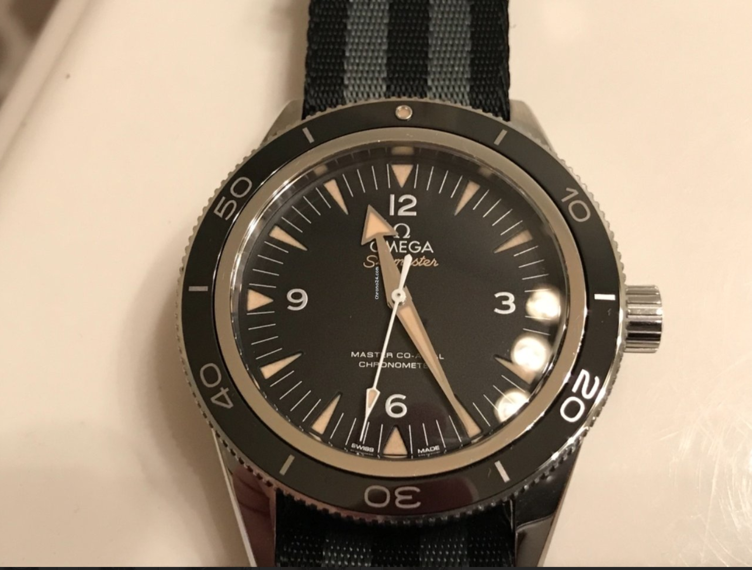

I am about to purchase this Seamaster 300 master co-axial. Just wanted to make sure its authentic. A link to the listing:
https://www.chrono24.ca/omega/seamaster-300--id7678277.htm
Thanks
It's suspicious that there are no pictures of the back. One of the primary ways of determining if these are legit is the presence of a silicone balance wheel. The fakes are still gold tone but otherwise the movement looks pretty similar.
173
97
Thanks for the feedback. I have actually requested a picture of the case back before committing. I will post a pic once he send me one
173
97

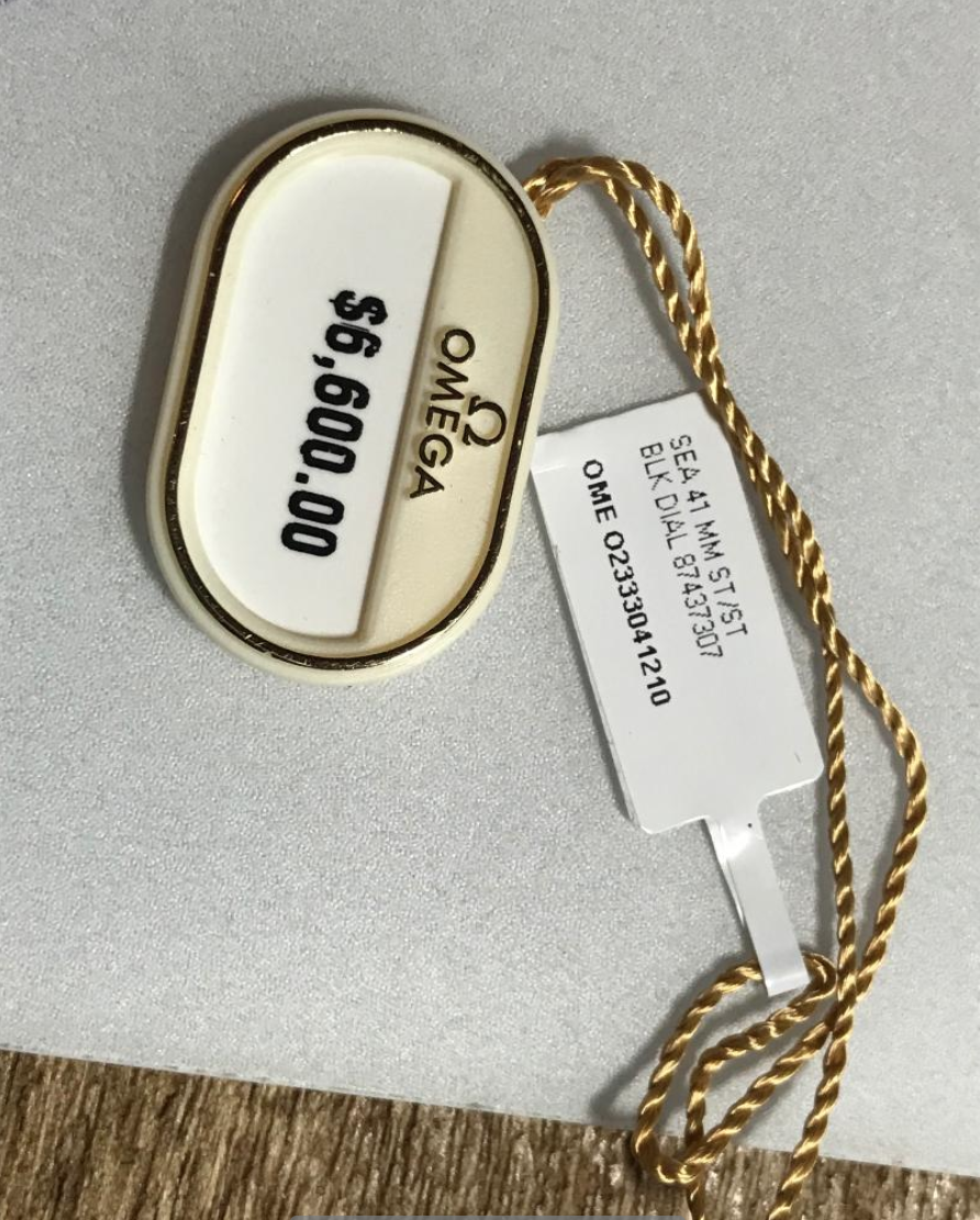

He sent a pic of the hang tag. Still awaiting case back. I'm starting to think I should stay away
173
97

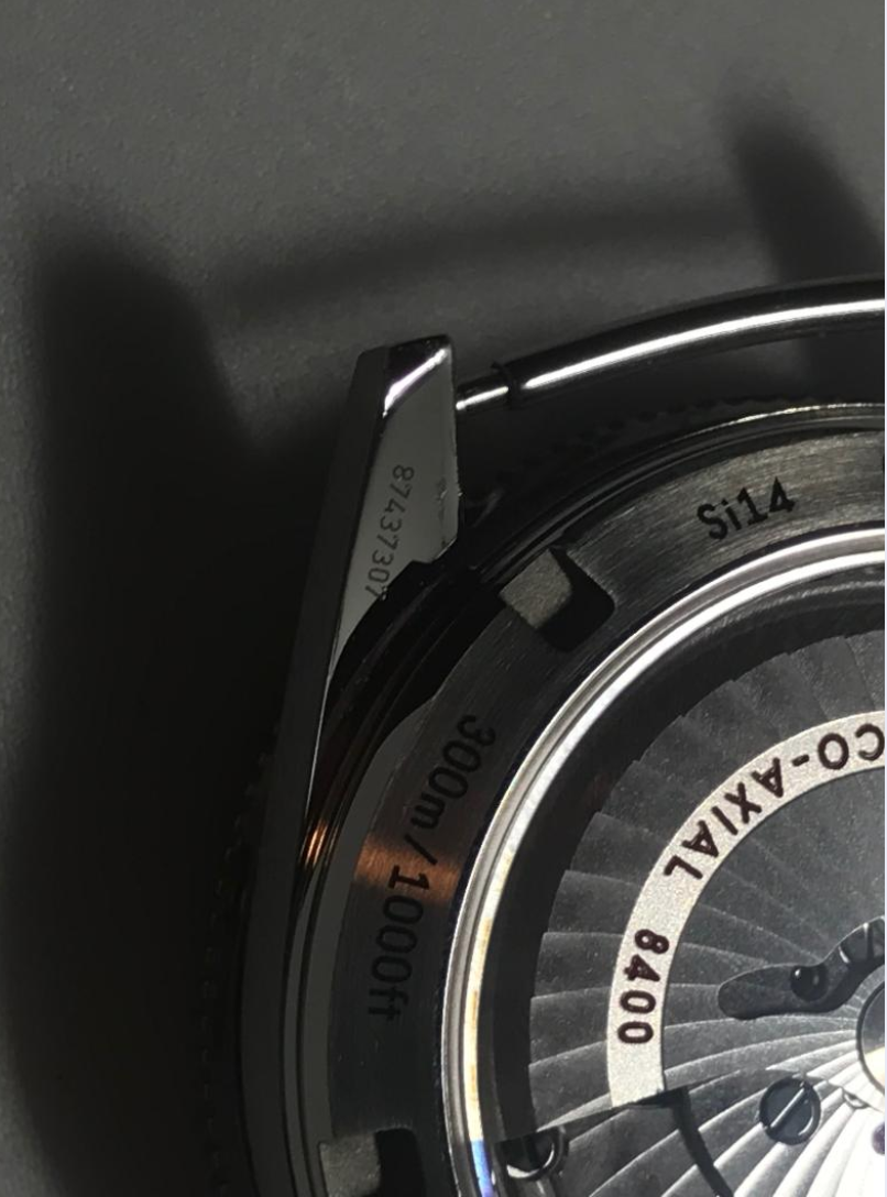

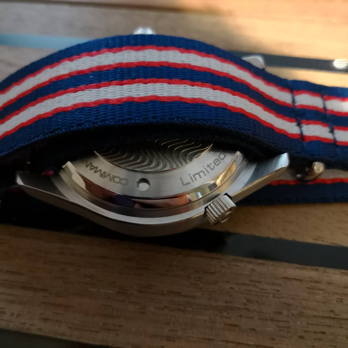

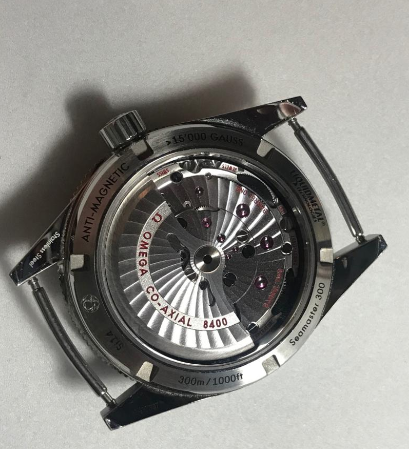

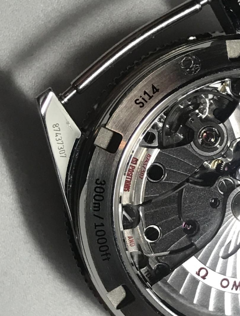

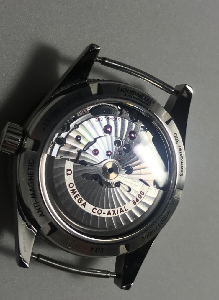

Here are some case back shots
272
208
Just FYI regarding the black balance wheel. Ive seen fake aqua terras and planet oceans running Miyotas with black balance wheels so might not be a good indicator for a fake 300? Last fake 300 I saw were all with brushed crowns. Not sure if they have changed since then.

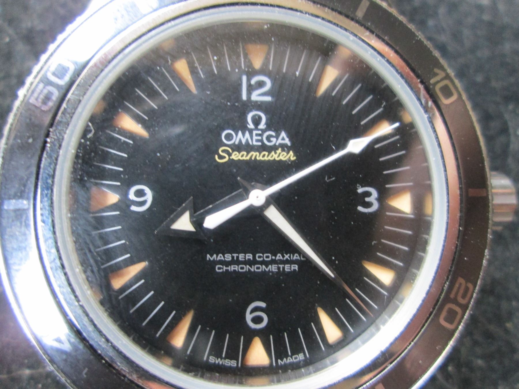

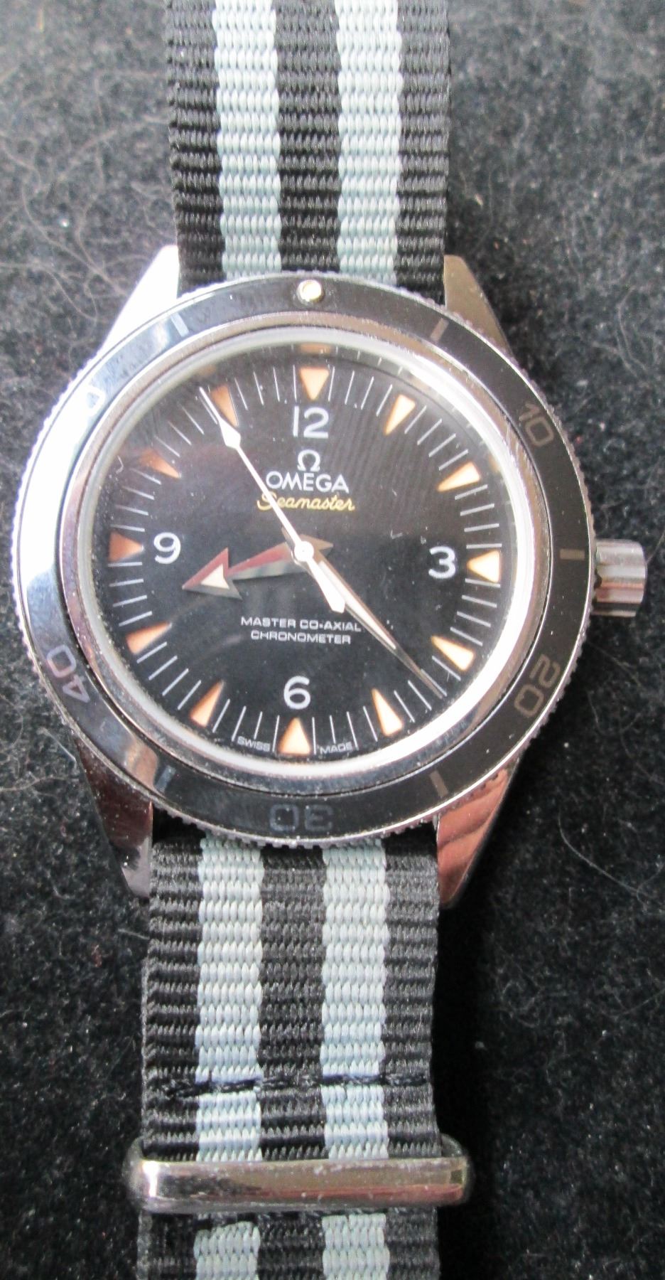

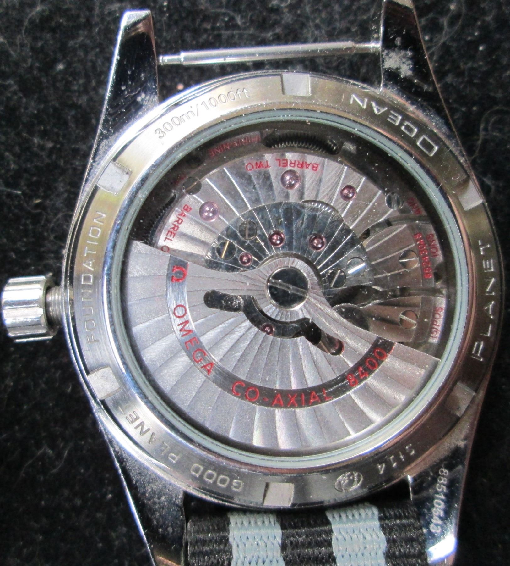

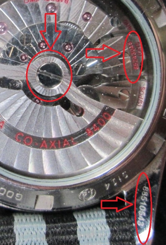

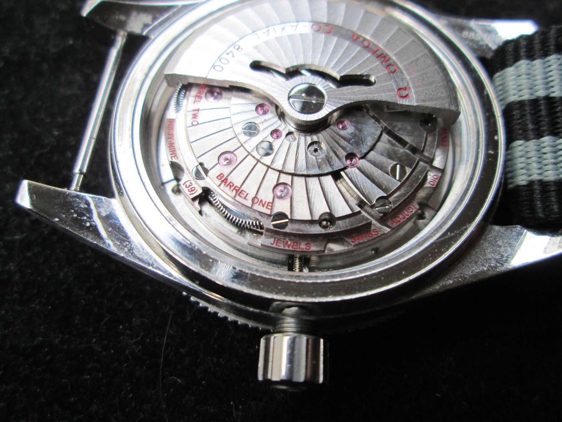

HI everyone, New to the forum. I am a collector but have yet to own an Omega. I am looking to purchase one soon an came across this one at a local auction. Don't know much about them myself so I was hoping you all can help. This one is listed as "100% Authentic" but looks suspicious to me. Any help would be great.
4,517
11,119
Fake. Other than the fit and finish that is lacking. The best way is to search google for the movement caliber. In this case, google Omega 8400 Coaxial. Compare the movements side by side (from a trusted source, of course). Quick glance you can see there is a screw that holds the counter weight in place on your fake. Not present on the Omega. Also check the serial number on the movement that does not match that on the underside of the lug.
261
767
I鈥檓 no expert and happy to be shot down but the engraving on the back has Planet Ocean and Good Planet foundation.
It鈥檚 either the wrong case back, wrong photo or just wrong altogether!

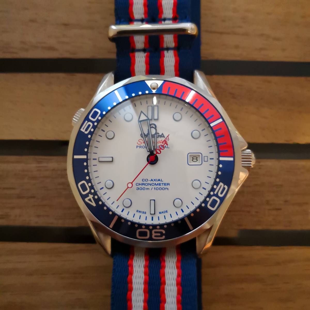

Hi there,
comments and opinions welcome on this Seamaster Automatic DeVille cal. 562
