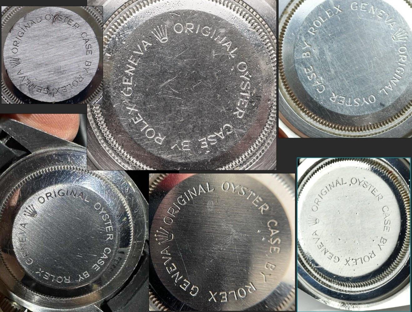

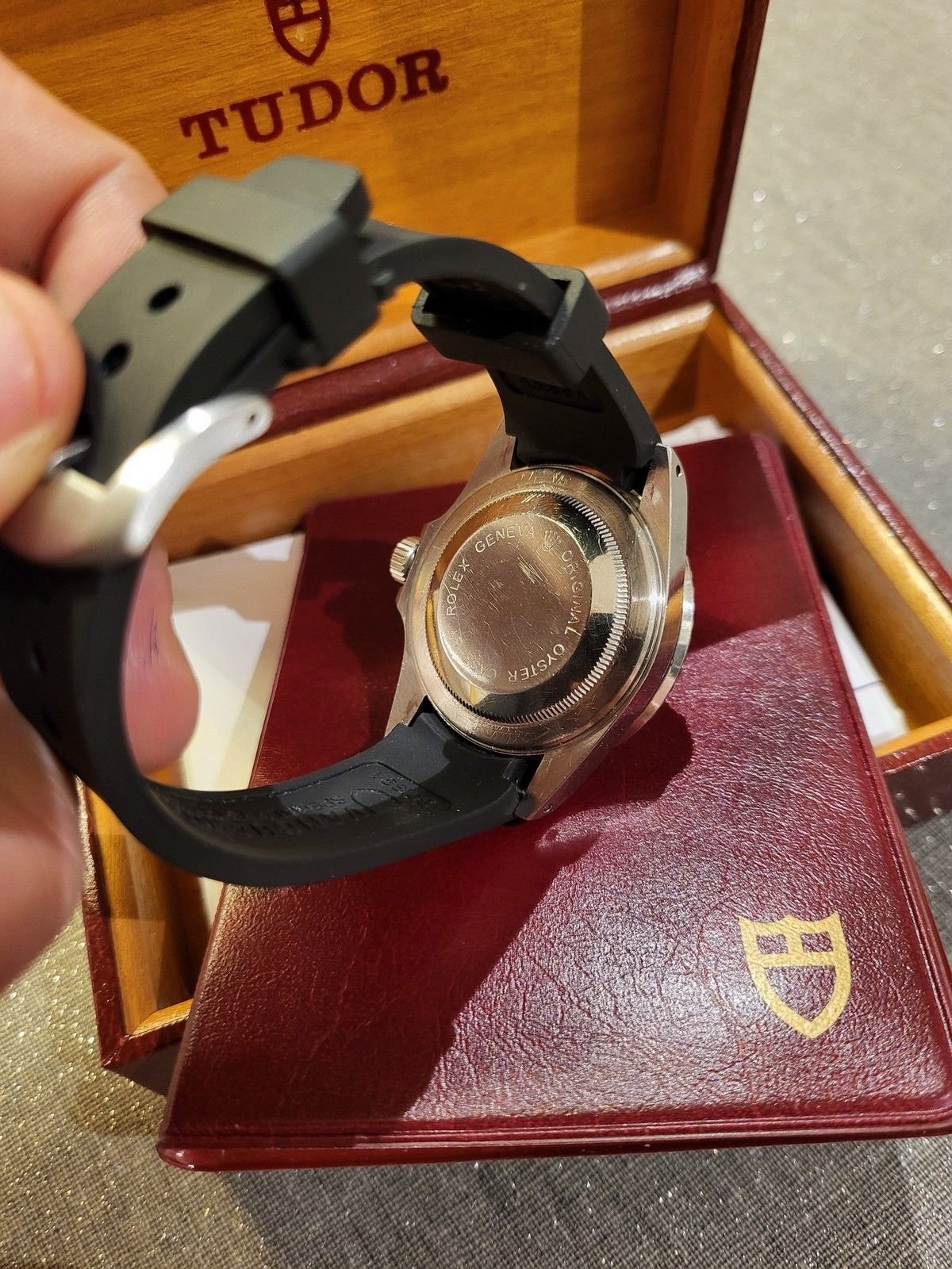

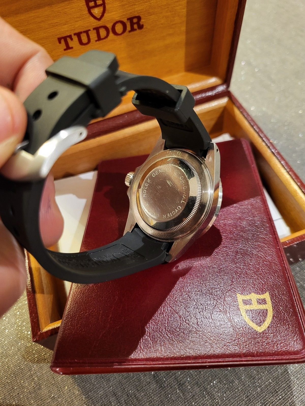

I am about to purchase this tudor, but the caseback font seems off.
The watch im about to buy is bottom left
Only known part that is not genuinge (told by the owner) is the bezel insert.
Also the dial has a big scratch but i think that reflects enought in the price.
Eny thoughts?

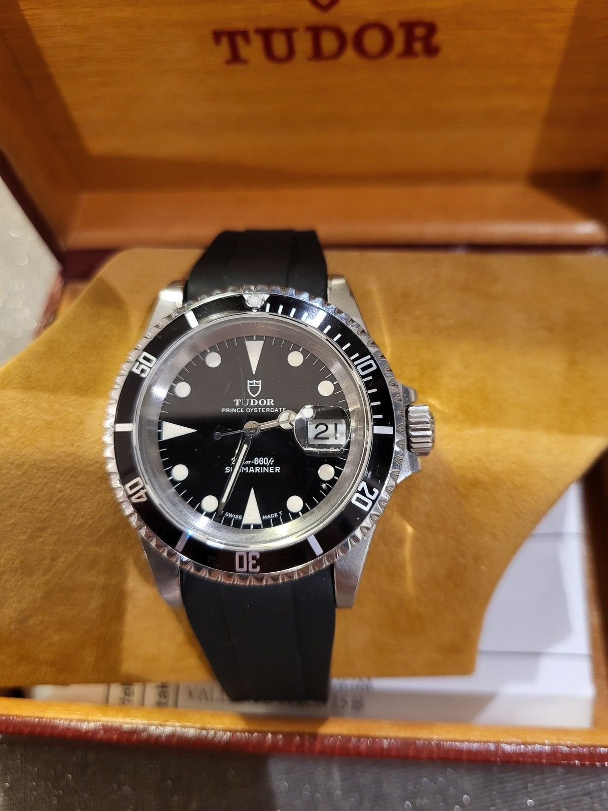

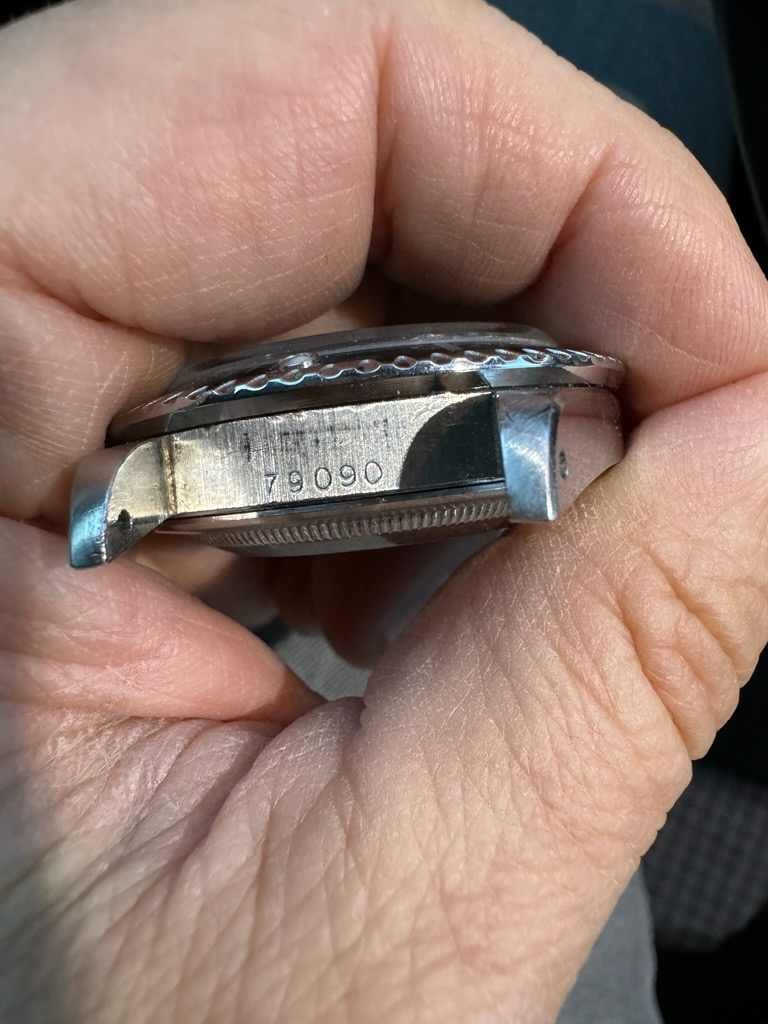

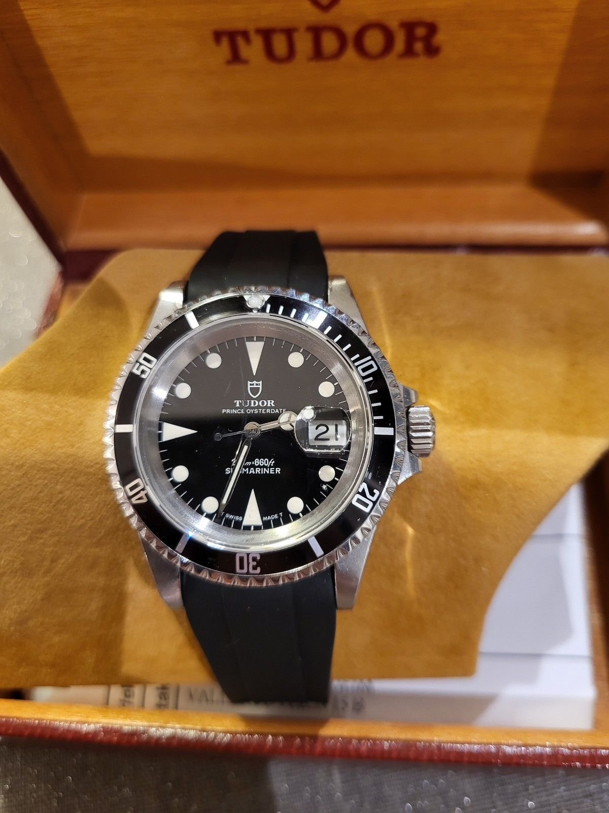

The more i look into it the more it looks like to me more parts are not ok.
The dial: the minute markers seem to short, the font is off.

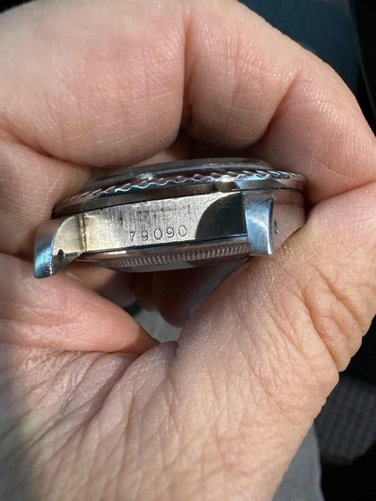

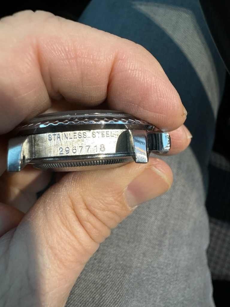

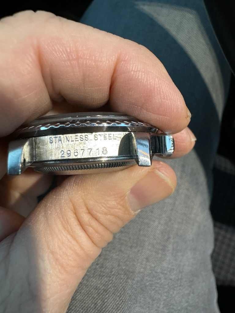

Also the serial numbers seem to be stamped in an ugly way

Near zero bracelet wear on such an old watch. With no wear it wouldn’t need a bezel insert.
Besides the other issues.
I suggest you keep looking.

Did not buy the watch.
I have talked to the owner about all the problems i found witch are more than i mentioned here and he said he will take it to a watchmaker for an inspection as he bought it from a frend who bought the watch on chrono and has import papers supporting that.

All sort's of weird happening here. As an owner of this reference it looks off in many ways. Good pass.
260
672
This watch doesn’t look okay at all. Everything is looking off/fakish.
