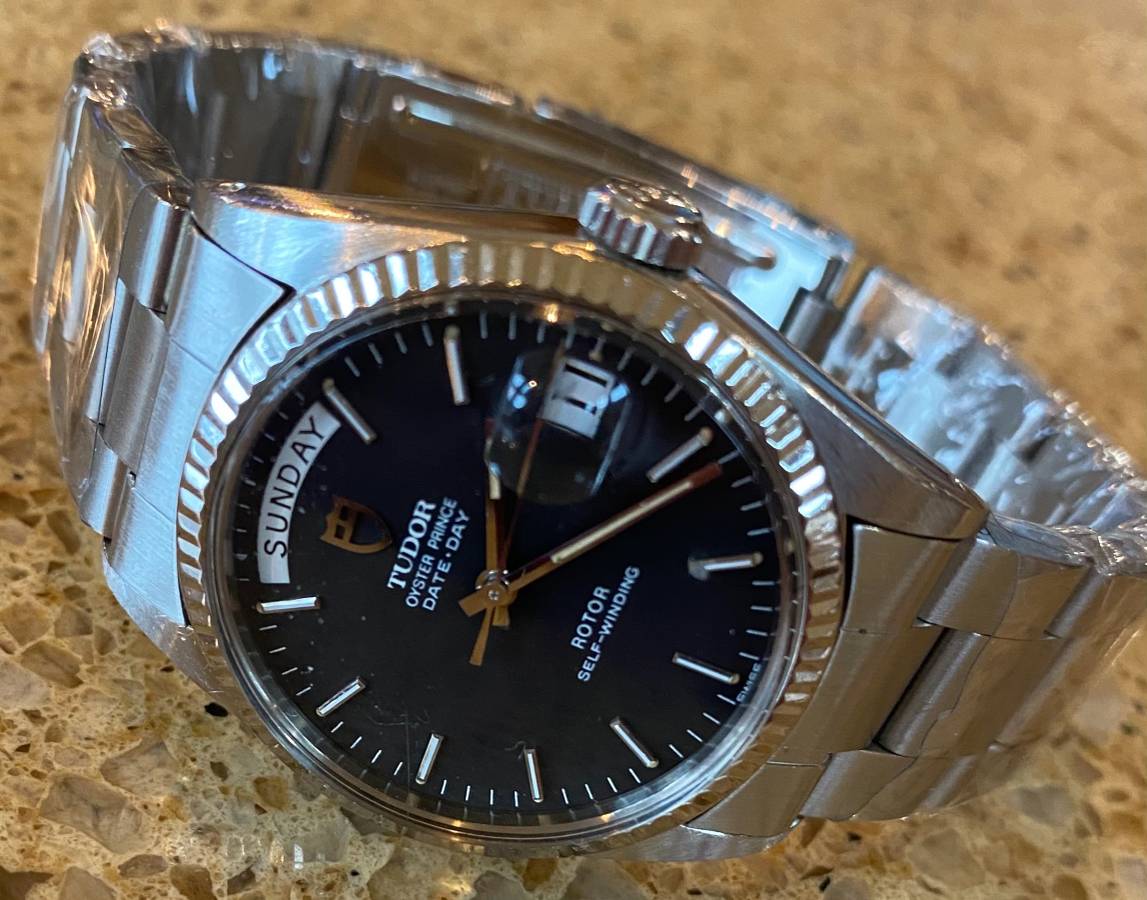

Considering this Tudor Date+Day, thoughts on correctness?
7

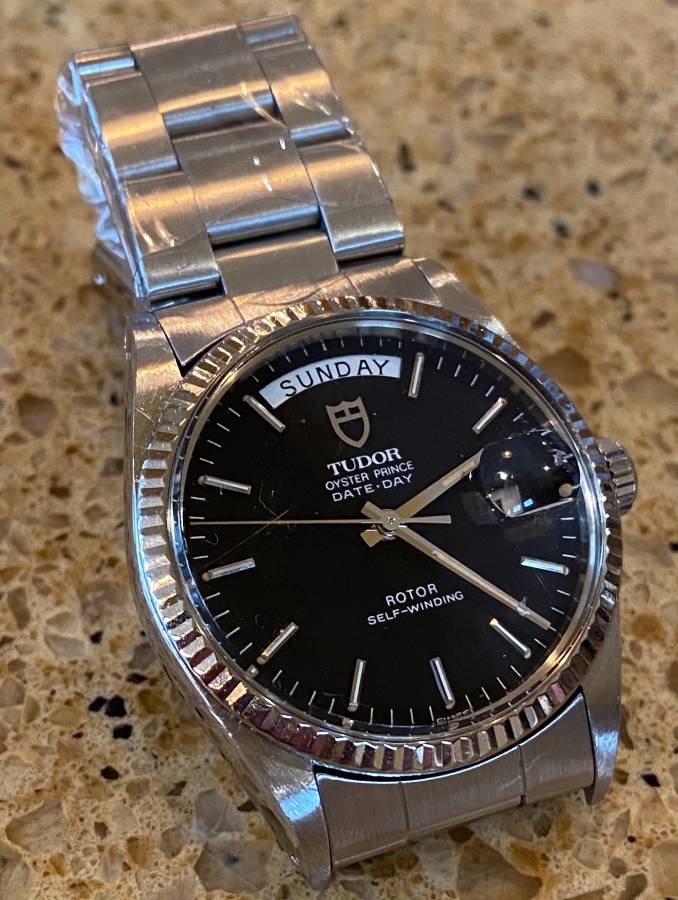

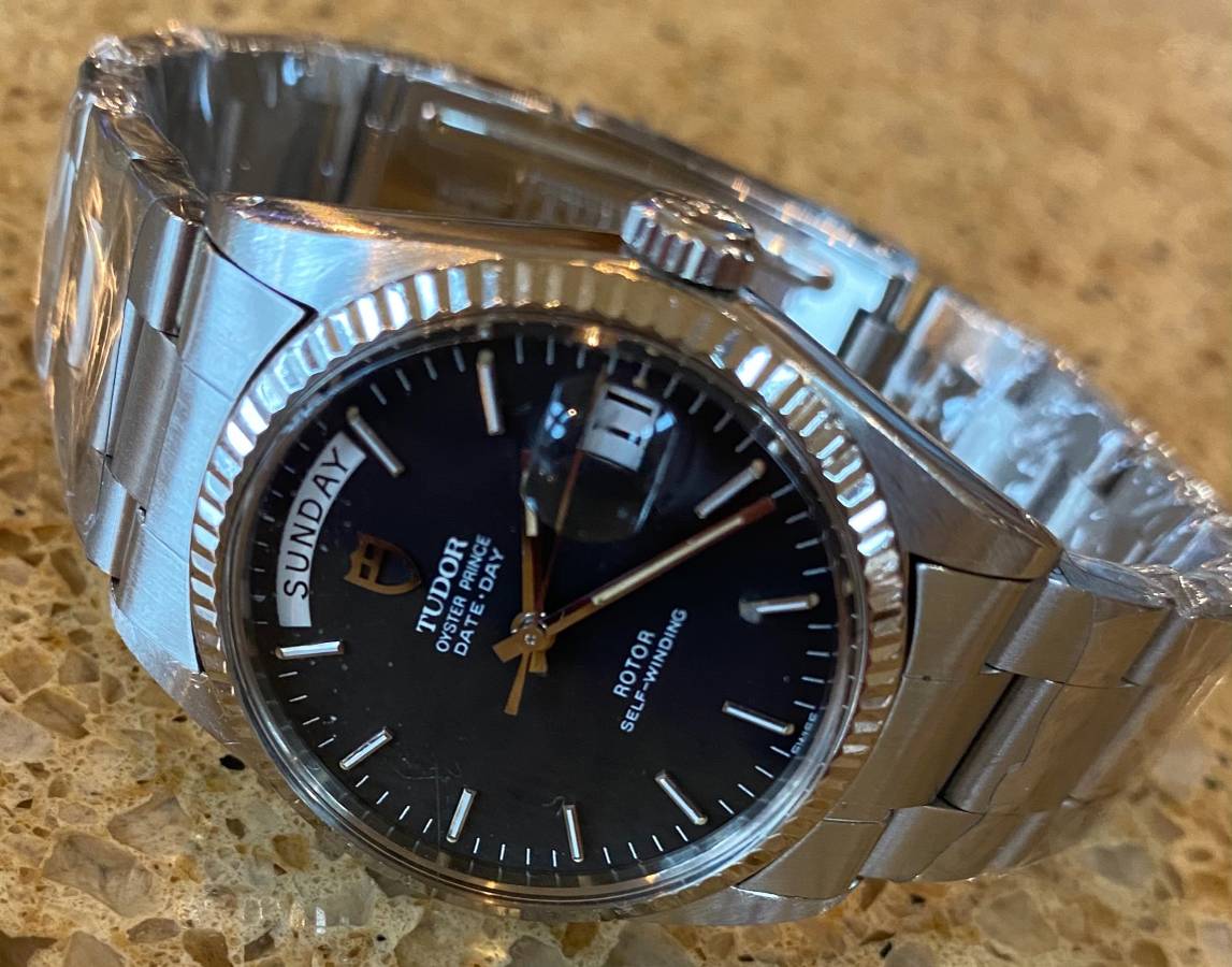

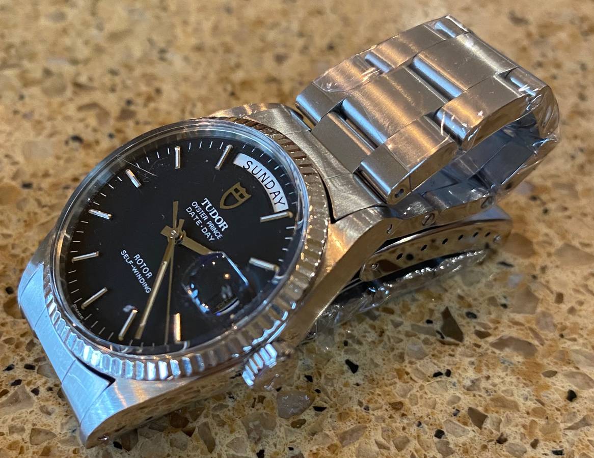

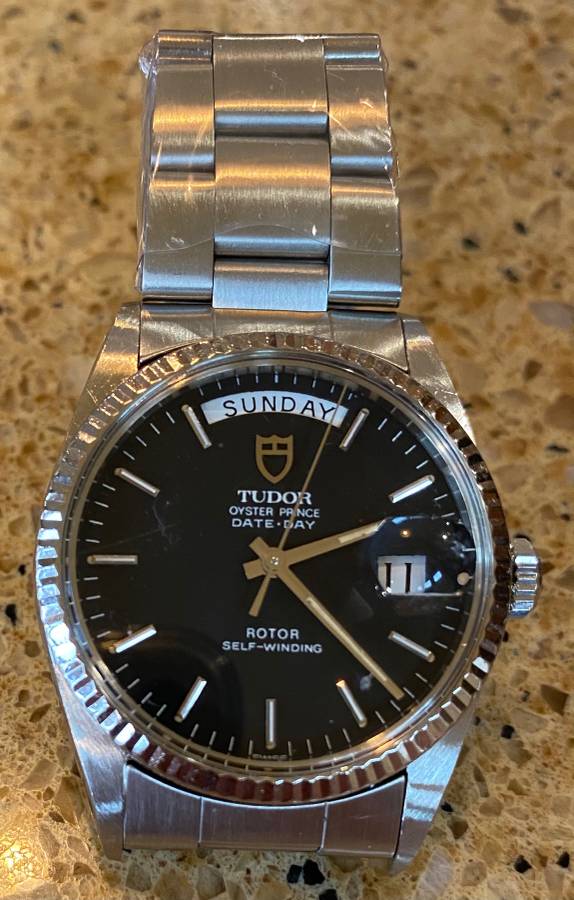

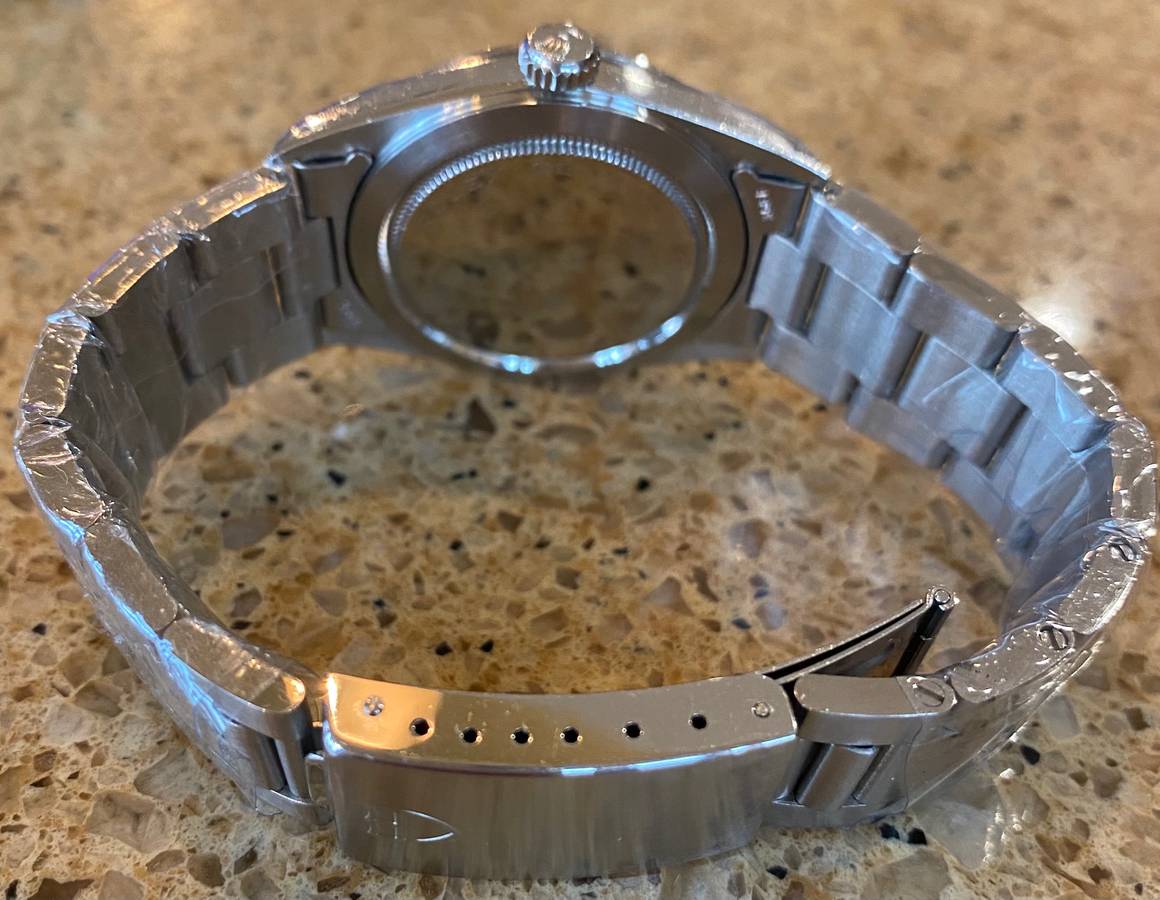

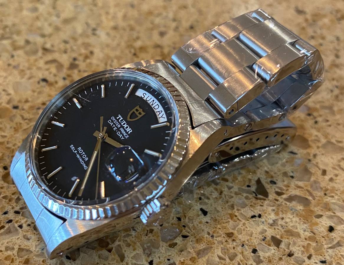

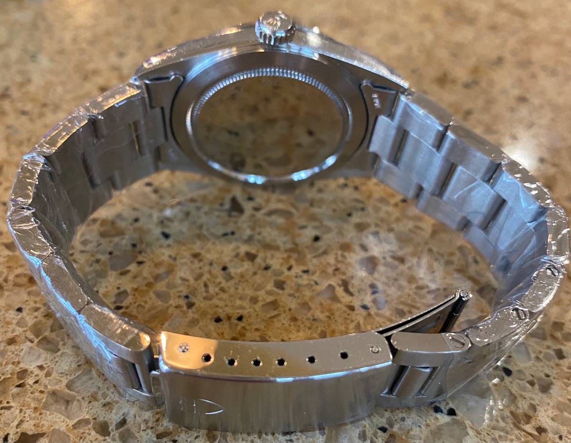

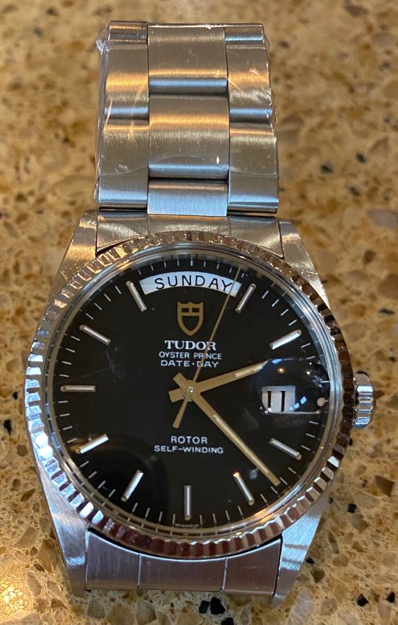

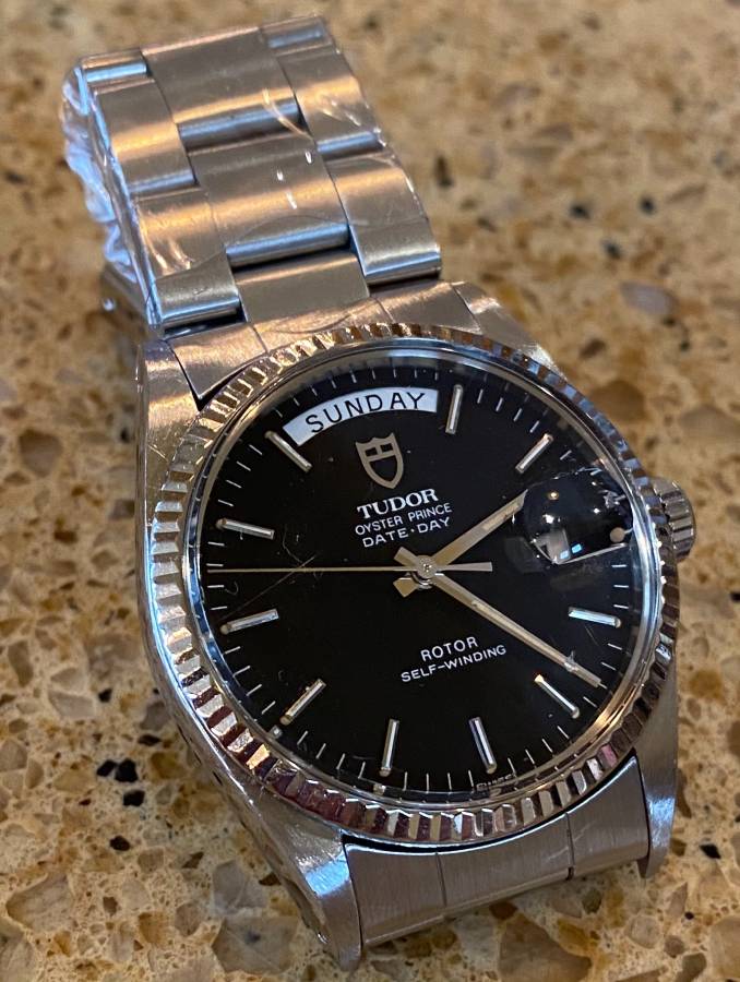

Hi, been lurking the forum for a while and finally pulling the trigger on a vintage Tudor. I’ve been cross referencing pictures all day and the dial seems ok, but I thought I’d get a second opinion from you guys. Thanks In advance!
Seller told me it was inherited from his family and has given me this information:
-18k white gold bezel
-late 80s / 90s

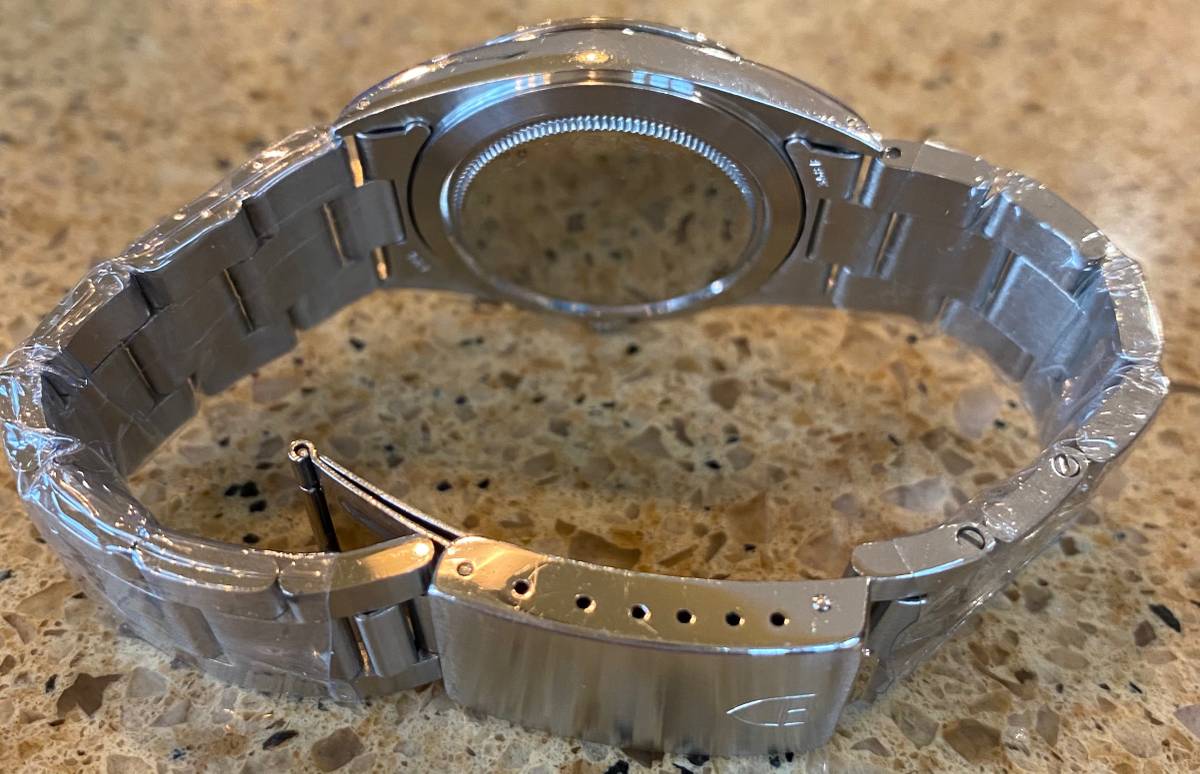

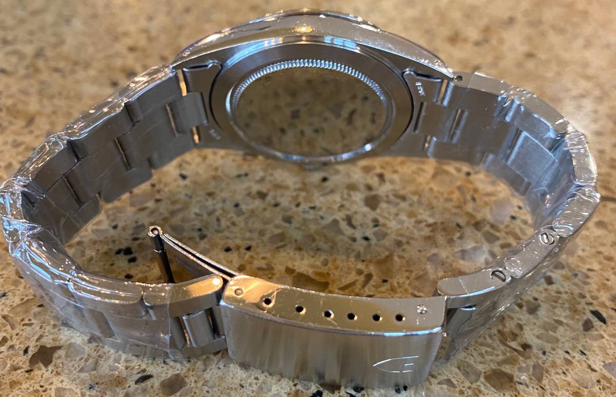

-The bracelet has original ends and clasp aftermarket links. I have the broken original links to include
- ref 94500
- Case back and crown signed Rolex

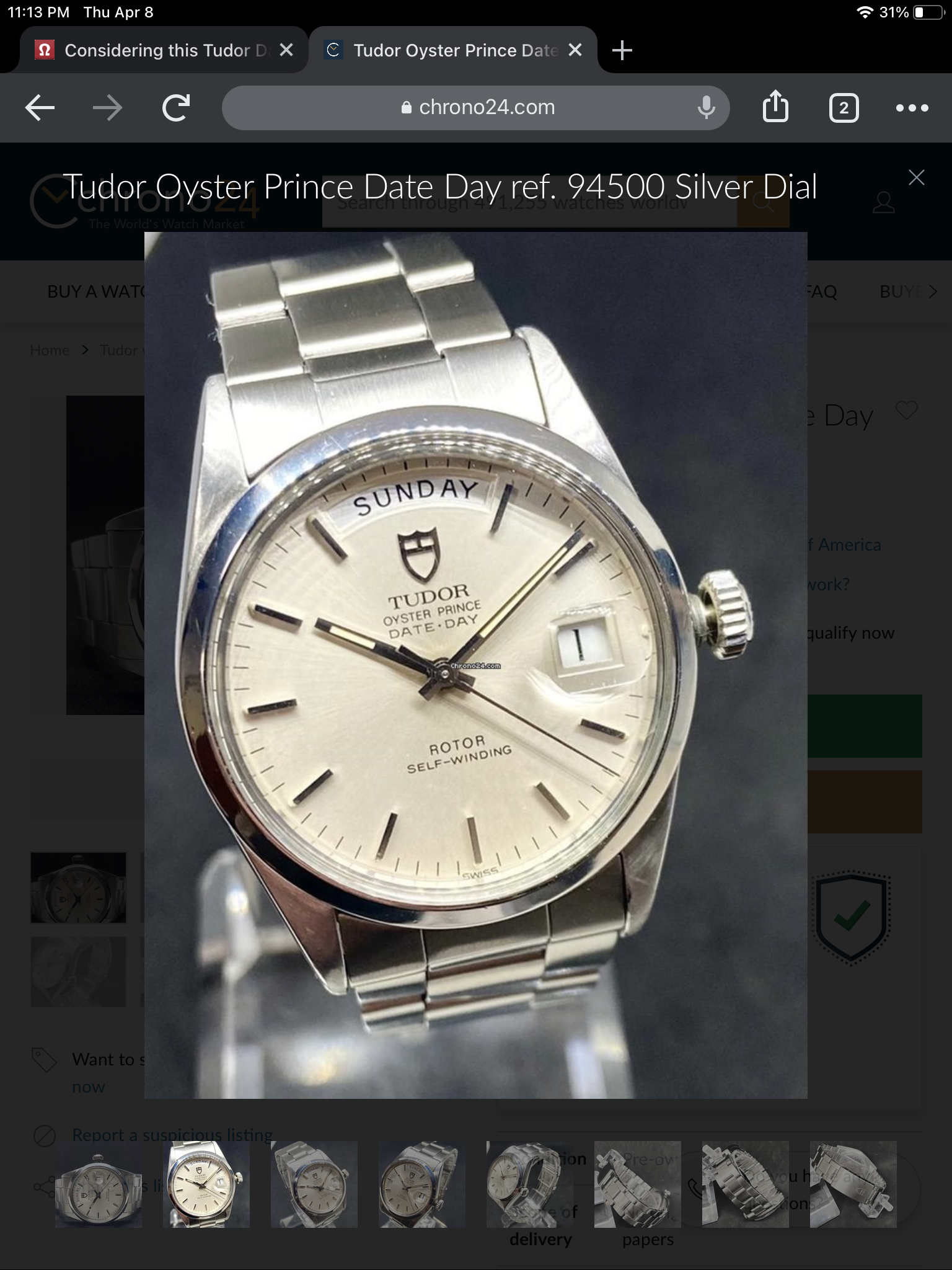

Correct me if I’m wrong but the dial seems older than 90s, I could only find Oyster Print dating back to the 60s/70s with “Swiss” at the bottom whereas later models say “Swiss Made”.
944
2,450
I don’t feel confident in this one. The day-dare font looks pretty serify for 80s-90’s. Also, SUNDAY looks like it was written by a drunk person. Crown looks like it might be fake and assume the whole bracelet is fake. You should get better pics and a shot of the movement.
