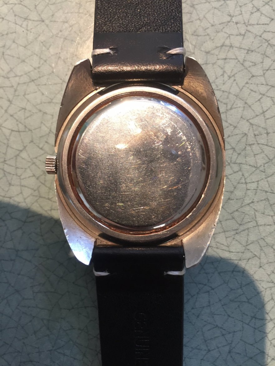

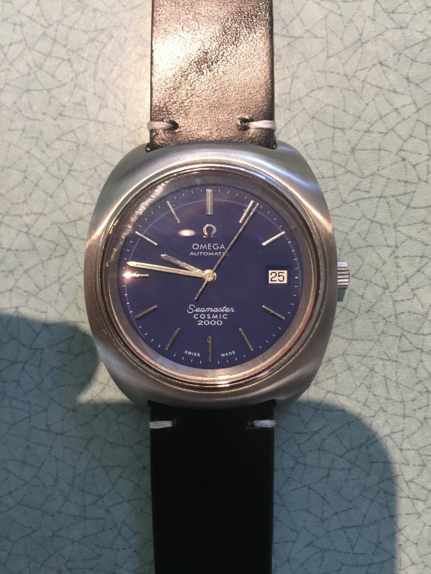

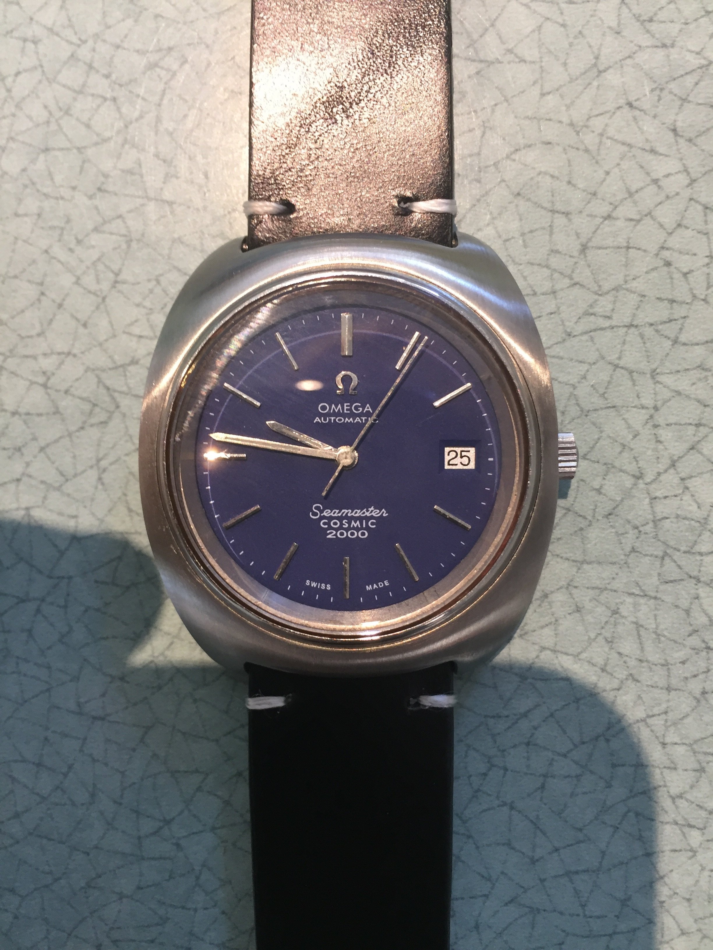

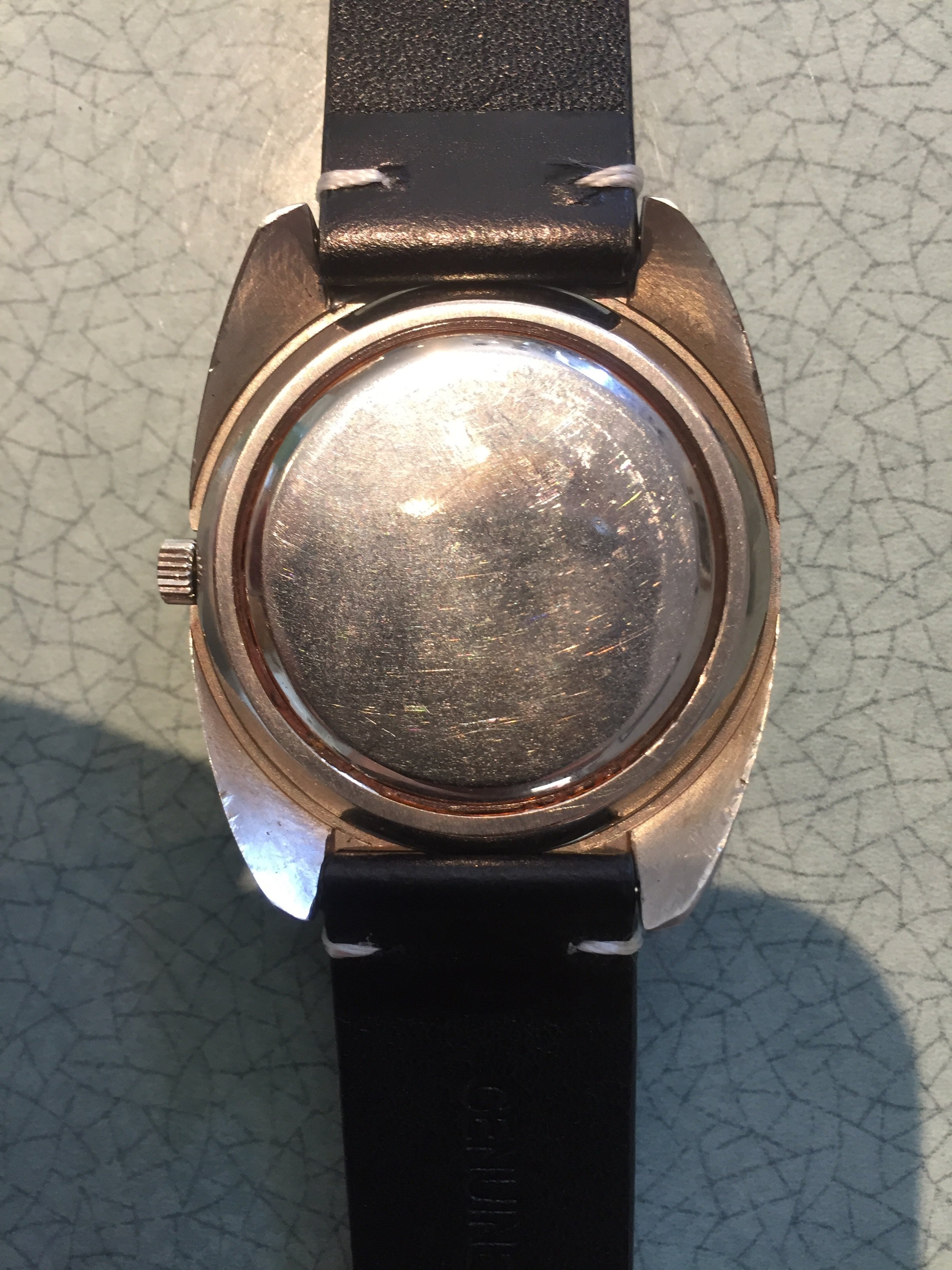

is this seamaster cosmic 2000 from 1972
8
Hello I’m new to watch collecting and was wondering if anybody could help me ascertain whether this is real or not. Thank you

Real, yes.
Based on the back of the watch I'd say the top/sides of the case have been refinished as has the dial.

Thanks for your reply. Real is very pleasing indeed, I appreciate your informed opinion as it was a drunken ebay buy. As for the top and sides of the case I can see the cleaning marks by some abrasive material. I apologise for my ignorance but how would they refinish the dial. Also could I ask if anybody would know the year and cal. of this model.

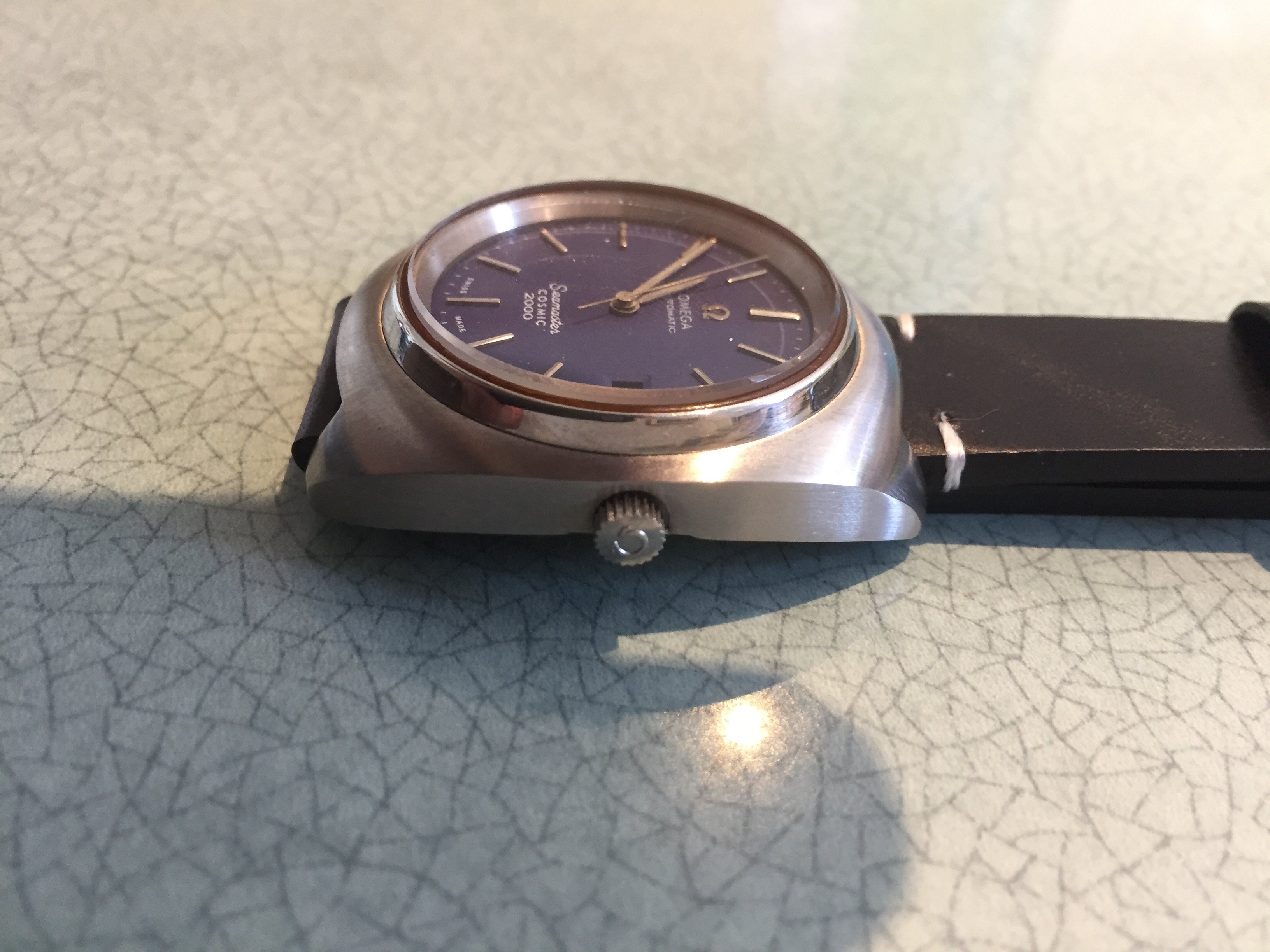

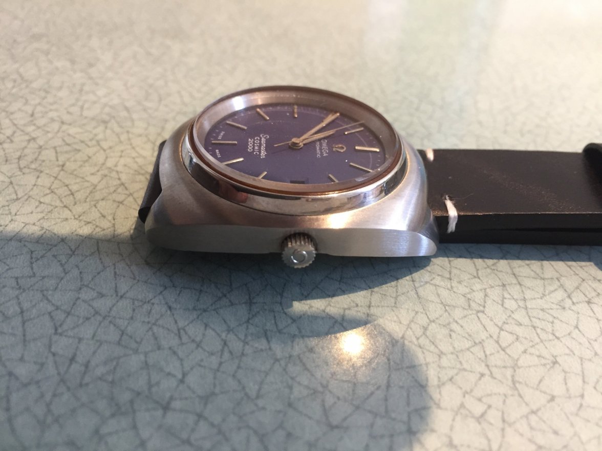

The case looks to have had some serious refinishing as the shape is very ‘off’.
the dial has been cleaned back to bare metal then repainted.
Unfortunately both of the above significantly impact collectability.
It’s probably early-mid 70’s, with a calibre 1012 and likely started off as a Cosmic 2000

Thanks for your answer. I have checked other blue dials and they seem to darken towards the edges instead of the consistency of colour on this dial. As for the shape being off,do you mean that they have scoured a mill or two too much on various planes, which is obvious. Again I must apologise for my ignorance but when you mean it started off as a Cosmic 2000 ,does that mean someone has tinkered and renamed whilst repainting the dial. As for collectability, I paid £600 for it and although maybe not pukka , I do like it. Hopefully it is worth that if it gives me joy, please tell me if I'm way off on price Again if someone could pinpoint the year, that would be fantastic thank you
The case has been subject to quite an aggressive, naive, polish to my eyes.
yes, when repainting the dial, they didn’t include the ‘2000’ text which I think was probably originally present.
It’s certainly not worth £600. More like £250. If price is a factor I would strongly consider returning it. If you like it anyway and aren’t bothered about market value, then what’s a couple of hundred quid if you’re happy.
Again if someone could pinpoint the year, that would be fantastic thank you.
The only way to pin point the year is for you to get the serial number from the movement and apply to Omega for an extract of the archives. This will give you a production date and country of destination etc. Even without an extract, the serial will allow you to date it slightly more accurately but it’s circa mid 70’s
