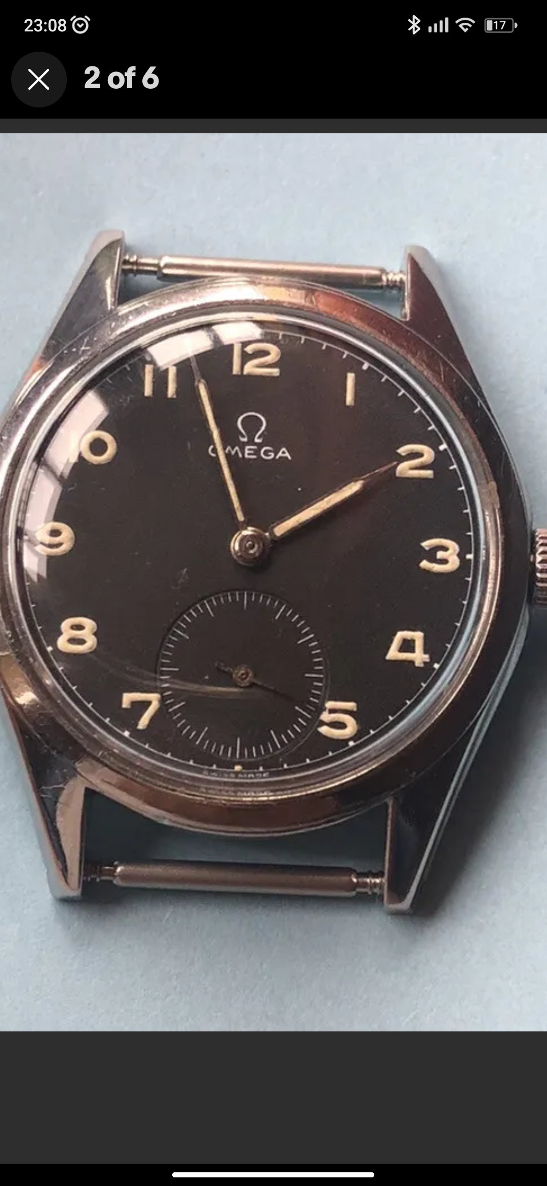

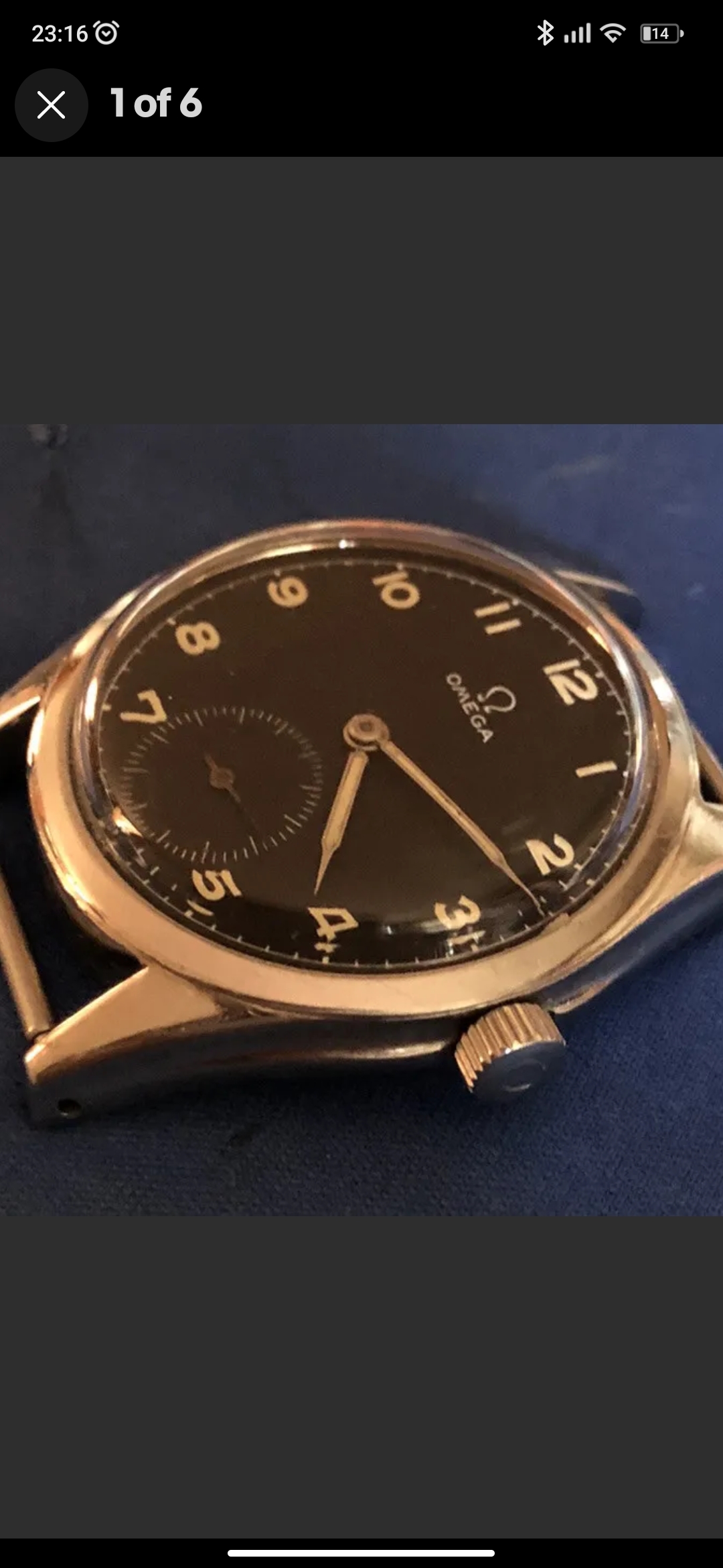

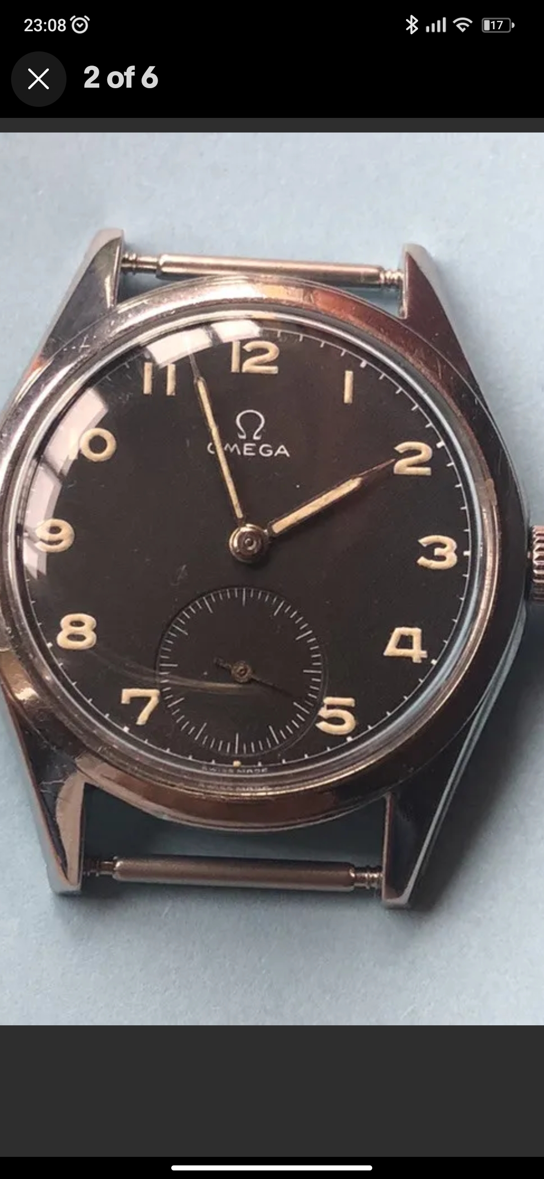

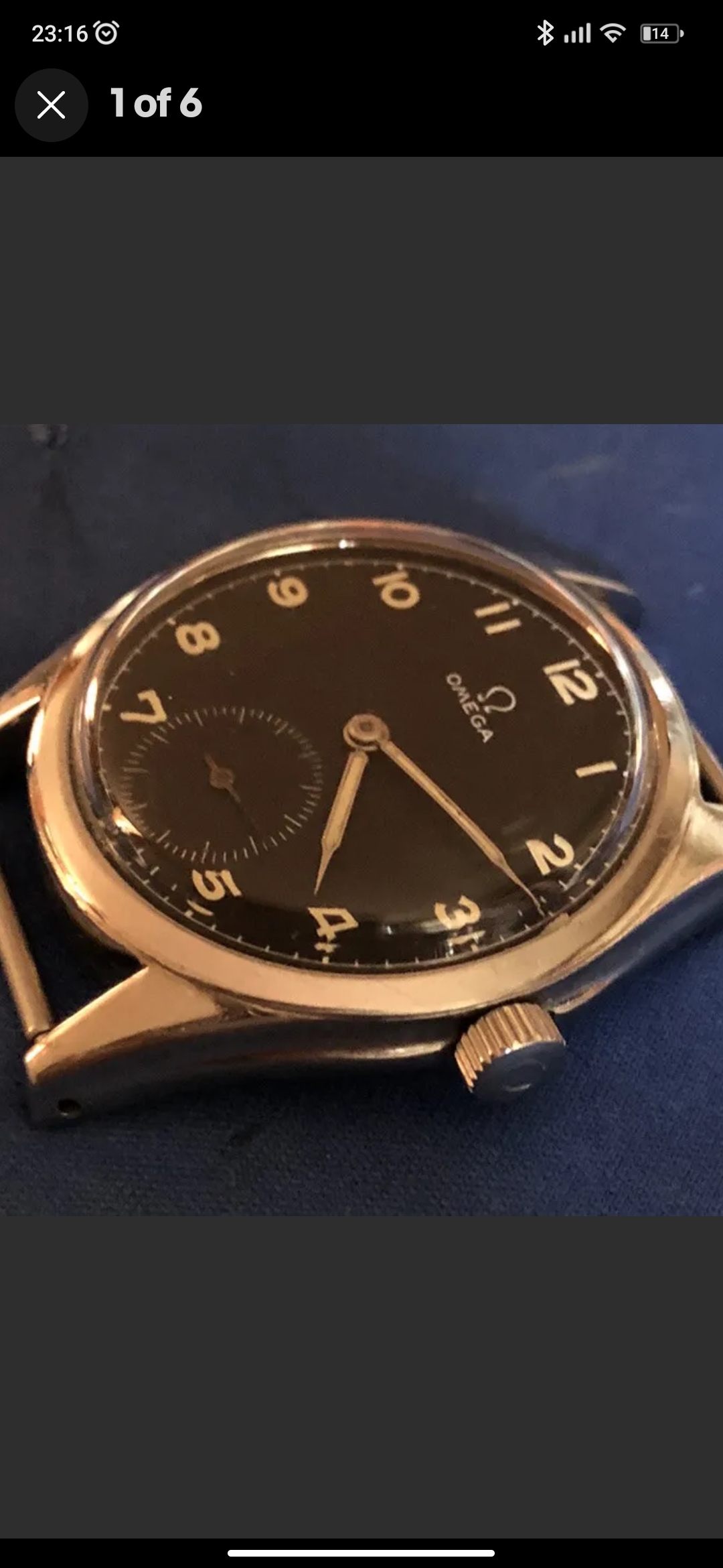

İs this redial?

Based on the single photo that's of any use, I'd say it's a redial.
The Omega text isn't correctly aligned below the Ω and it's in white ink (which may be OK)
Swiss Made isn't positioned correctly below the 6 marker.
The subdial looks to be flat and full of paint.
It's not a bad redial though.

+1 for a redial
the logo is too different, the M of Omega does not seem to fit.
the black paint is too impeccable for a model of this era.
the hands are repainted.

Agree. Omega text wrong, Think ‘A’ should be flat topped.
