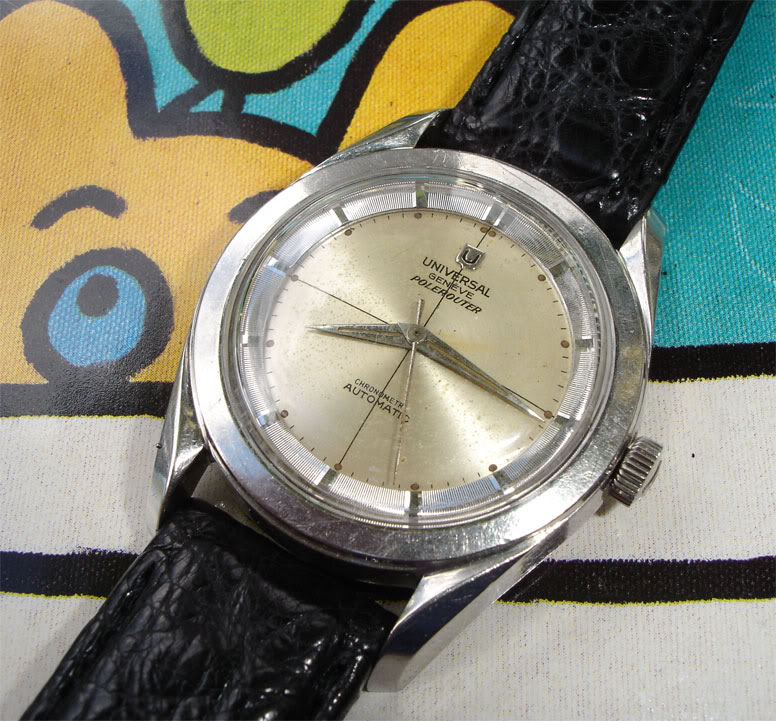

OK it says so on the dial but nothing on the movement let alone any paperwork.
https://www.ebay.co.uk/itm/Ultra-Ra...136101?hash=item262eb169a5:g:g7AAAOSw2B1d99qX
409
1,074
The movement is also numbered if you look carefully.
Unfortunately its inside an H20217-3 case, and should not have lume on the dial or hands, so something is amiss.

It is also missing the 'unadjusted' text, as expected for a chronometre.
So to be fair, the answer to the OP's question is yes - the dial matches the serialised chronometre movement.

I do not believe a Polerouter should have a serialised movement unless it has 'chronometre' on the dial.

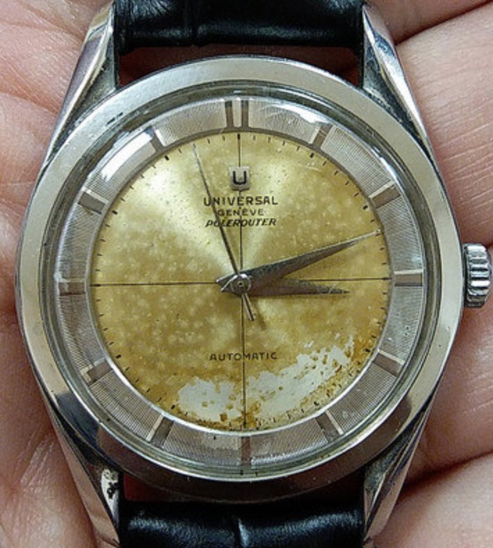

E.g. H20217-3 serial 1806842 (close to your 1806892):
Yes I can confirm 100% that mounting is different between S and H case but not only for plexi but also case size and case inner shape is different. You can not switch a S case mouvement 138 ss and its mouvement holder in a H case and vice versa.
Thanks for your example which leans towards your assumption but does not 100% confirm it. Now next question : have you seen any 138ss Chronomètre with steel H case? With steel S case?
given the scarcity of H case vs S case (which percentage btw?) and the extreme scarcity of 138ss chronomètre (1 out of 1000 ?) if we follow your theory that this watch being a franken, someone went into a lot of complexity and hassle to produce a watch that is at the end not much worth more than a regular 138ss... UGs are not in the same price gap as Zenith or Omega when you switch from a regular one to a Chronomètre one.
At least not yet ;-)

The movement, dial and hands swap over directly as one piece between both case types. Quite simple.
Taking into account the characteristic patterns for all other S and H case 20217, it seems very unlikely to me that this example is as it left the factory.
Regardless, it is super cool to have a chronometre-dial polerouter, with a numbered movement. 😀
However, my opinion is that the focus should be on finding some evidence that it is correct in this configuration, rather than relying on not finding evidence that it is not correct. More of a "guilty until proven innocent" instead of the other way around. Until then...

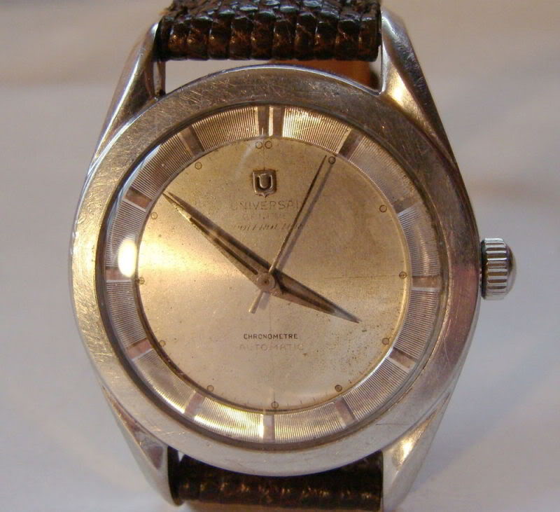

2 interesting things in this thread.
1. the S20217-3 showed by OP is with lumed dial and hands 😕
2. The 2 Chronometre samples owned by Bill are also lumed. That would be great to know which ref they are bearing.
Is he still active on the forum?
Bills are both 20217-5.
