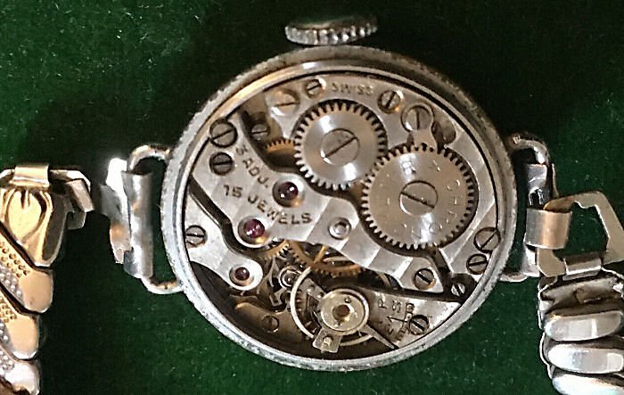

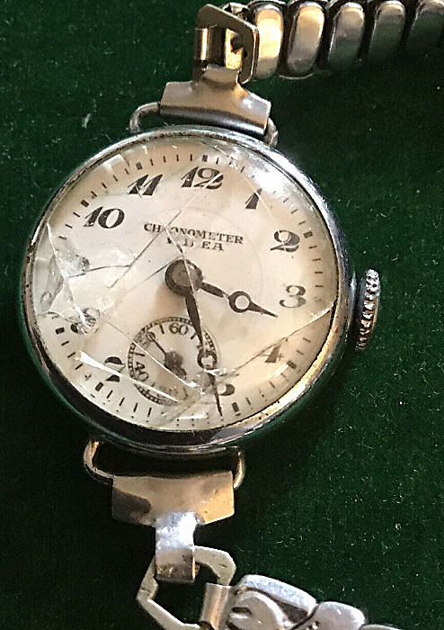

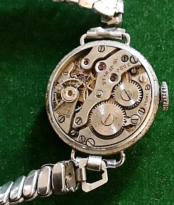

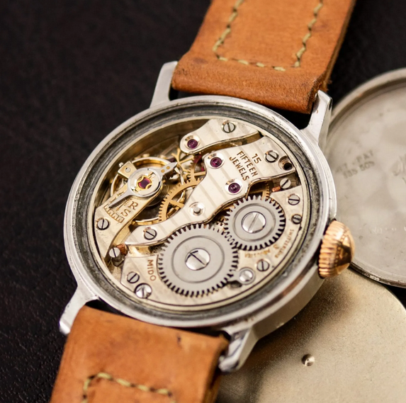

Just wondering if you knowledgeable folks can possibly tell me what this is. Or point me in the right direction. Am having a late night furkle in the internet's Bargain Basement (as you do on a Saturday night), and the movement in a little 1920s (?) ladies watch caught my eye.
Am not having much luck - although that's probably down to my not knowing much about this sort of thing. It's a chronometer, Swiss and small, about 20mm diameter tops. Mainspring barrel is marked with CHRONOMETER and a five-pointed star. To my (admittedly) uneducated eye, it looks like reasonable quality for coffee-and-cake money.
Any ideas? 😕
I've been poking around on Ranfft, but it's like trying to play "pin the tail on the donkey" 😟 But I'd love to know more at any rate.

With 3 adjustments, hardly a chronometer, I’d say!

Well, I'm here to learn... 😟 But then again, if it's not a chronometer, then why would it be stated as such, not only on the mainspring barrel, but also on the dial? 😕
I was under the impression that bog-standard ladies watch movements (i.e. affordable) seem to be largely unadjusted, and this one appears to be adjusted to 3 positions.

Chrono- relating to time.
Meter- to measure.
I suppose every watch is a chronometer in that it measures time. But the term today usually applies to timepieces that are highly accurate, adjusted to 5 or 6 positions (not 3), heat and cold, and isochronism. Total of 8 or 9 adjustments (not 3), micrometer regulator, (or free-sprung), Breguet hairspring (not flat), sweep seconds hand, (not a subsidiary seconds hand). If you can post a picture taken with the dial off, maybe we can tell you more. But it is not a chronometer!

Although you use the the definition as it is today. Does such a narrow and very specific definition still apply to something that's probably as old as you and I combined? It would be like trying to compare a Blower Bentley with a Ferrari 499P, surely?
I don't have the item in hand, it was something I spotted for sale for the price of a coffee and slice of cake and it piqued my curiosity. Have added a couple more pics (including another one of the movement which shows the markings better) from the sales listing. I'd still love to know who made the watch / movement as all my searches are turning up blank. I believe it says Wilea on the dial.

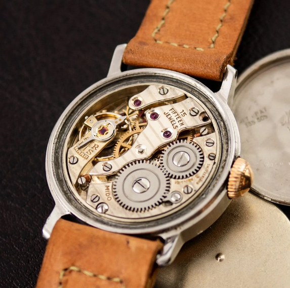

It's a Mido, or the same (Felsa) base caliber...

Obviously this is not a certified chronometer.
The word “chronometer” has been a source of much confusion, particularly in the USA over the years.
Prior to WWII, any watch company could call themselves a “chronometer company”. Ulysse Nardin was famous for this. During this period, UN produced marine chronometers that were fully adjusted, tested and were greatly respected, but most of their wristwatches simply used the company name on the dial without testing.
Other Swiss companies like Omega and Rolex put “chronometer” on the dial and also provided in-house testing results to the purchaser.
After WWII, the Swiss companies set up independent testing facilities to ensure uniformity of standards in the definition of what is a chronometer.
That's spot on! 👍 Thank you SO much 😀
Can go and do a bit more looking up now.

Yes, that explanation definitely helps, muchly appreciated. 👍 Sounds like marketing departments (or perhaps the jeweller selling the watch) were laying things on a bit thick, then.
Will amend thread title accordingly. 😟

In the U.S.A., I don't think a manufacturer ever used the word chronometer to a wristwatch. Like @gatorcpa said, Americans used the term for a marine navigation timekeeper of high precision (marine chronometer). The Hamilton Model 21 is the most famous of those.
The Swiss also developed marine chronometers (in fact, the Hamilton Model 21 is based on a Swiss Ulysse Nardin model).
The Swiss also used the term quite loosely for wristwatches for decades. In the 1940's the Swiss watch industry began to define a few standards of what a wristwatch chronometer should be, that eventually became COSC.

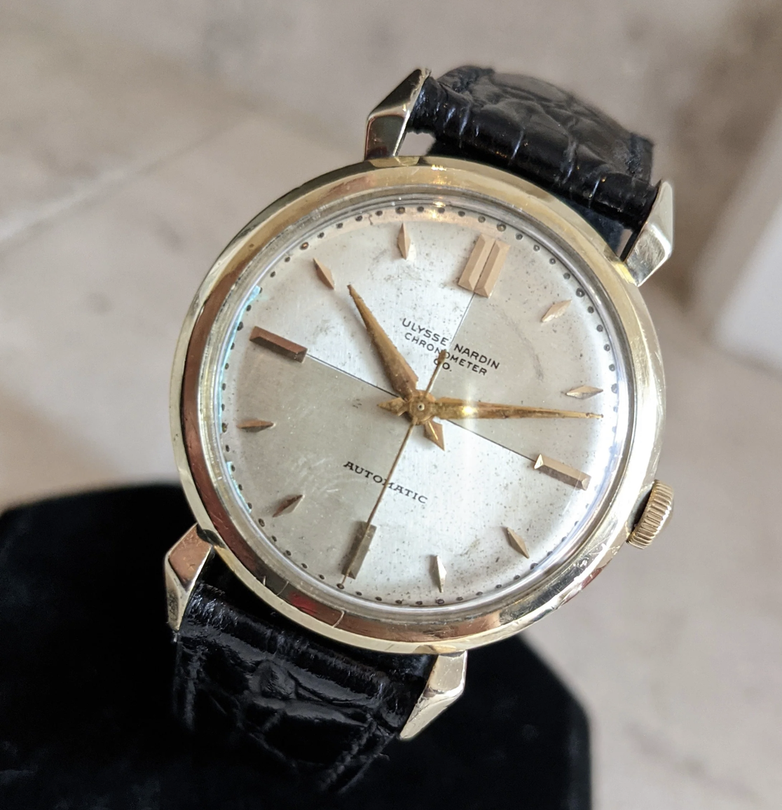

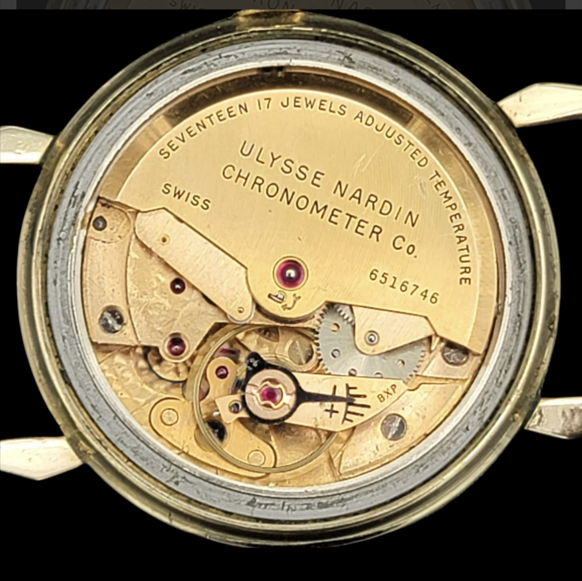

In the U.S.A., I don't think the word chronometer ever applied to a wristwatch.
Actually, I was writing about watches like this:
https://www.secondhandhorology.com/products/ulysse-nardin-chronometer-automatic-watch#images-11
As you can see, the watch has the full name of the company (Ulysse Nardin Chronometer Co.), but while there is indication of some adjustments, there is no indication that it was certified by COSC or the manufacturer, or that it met anyone’s standards for chronometer accuracy when new.
You can see how some people could be confused by this.

A bog stock calibre Felsa 690. One of the very first full rotor automatic wind movement that winds both ways. An excellent watch for that era, but not a chronometer (or chronometre).

If you have not found it Ranfft has a parametric search. Click the advance button next to search. Where you search using graphic images of the movement part placements. It is surprisingly effective.
Millions of watches with that bridge layout have been made. I have trays full of such of these as well. A lot of inexpensive (and high end) used something called a cylinder escapement which was easy to mass produce. This was a step above the pin lever escapement.

@Reynard if you’re ever tempted to go down watch rabbit holes at night, I suggest you read @conelpueblo’s wonderful thread “learn how to fish” and that you keep wisely posting watches on the forum before you pull the trigger. At least until you know more.
I see three major reasons this purchase would have been a complete waste of your money even if it were only 10 dollars:
1/ the dial was likely refinished;
2/ the case is not steel, it’s chrome plated and the chrome is chipping or has worn off on the sides;
3/ the regulator pin (ie the little tail that’s afixed above the balance wheel) is pushed all the way to the side, which means this movement isn’t working so well and you would most definitely incur servicing expenses (without any guarantee the watch will keep good time after that.)
So your 10 dollar watch would cost you 100 to 300 in servicing costs depending on what part of the world you live— and after all that you would still be holding a watch which is worth nothing- due to its other flaws.
If you buy ladies watches you need to really make sure the brand and quality of the watch are worth the ssrvicing expenses, because in most cases they’re probably going to exceed the purchase value of the watch.
You should be aware a lot of your costs will be sunken, and are definitely not an investment— which is how many people justify their purchases of men’s watches.
I suggest you let someone else bear the clutter of the lesser ladies watches- or the task to bin them.
