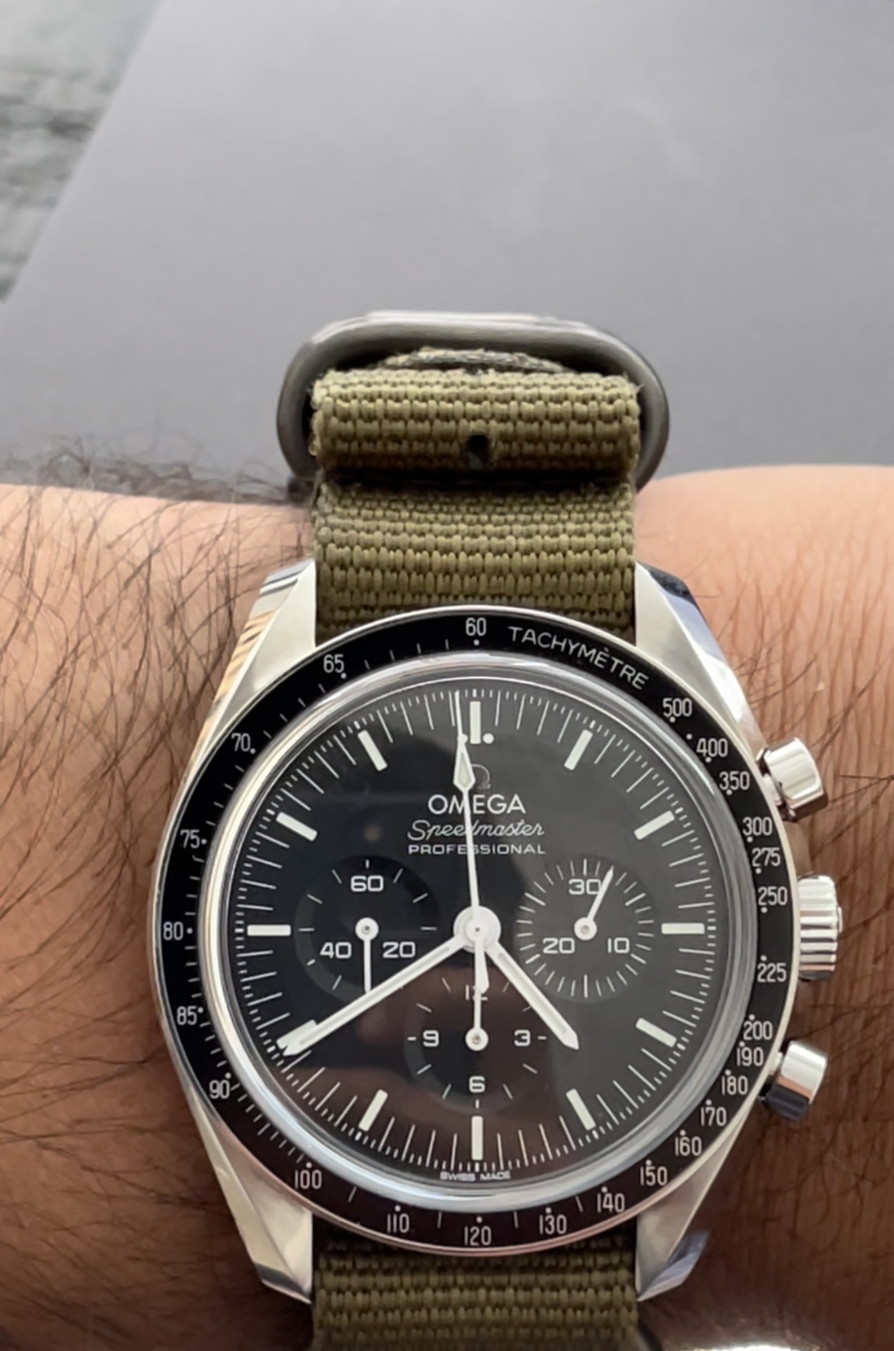

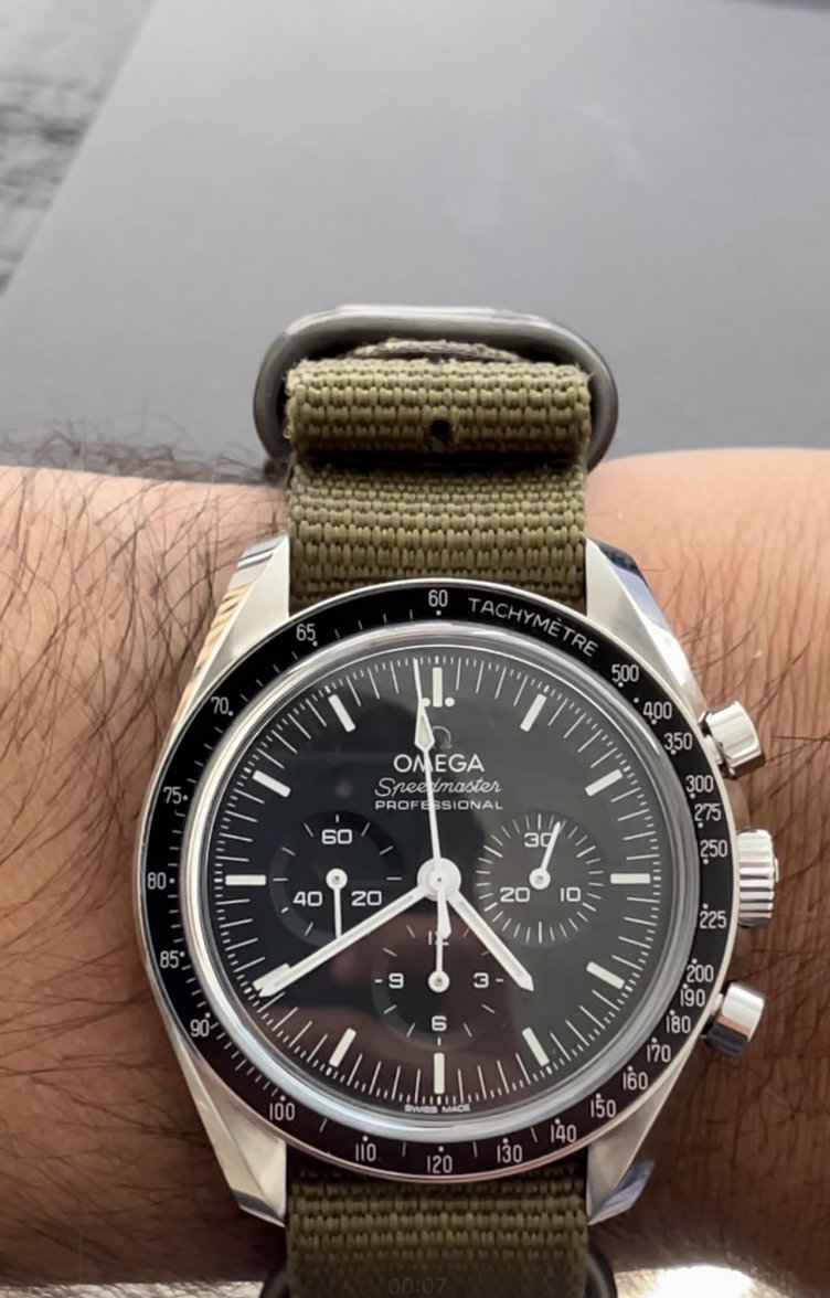

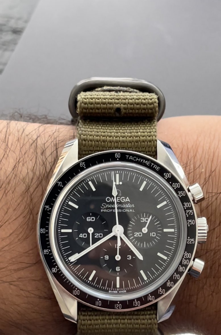

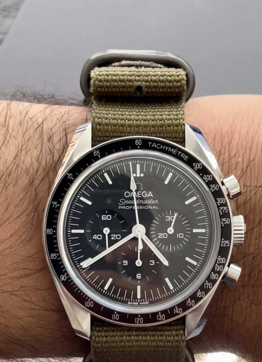

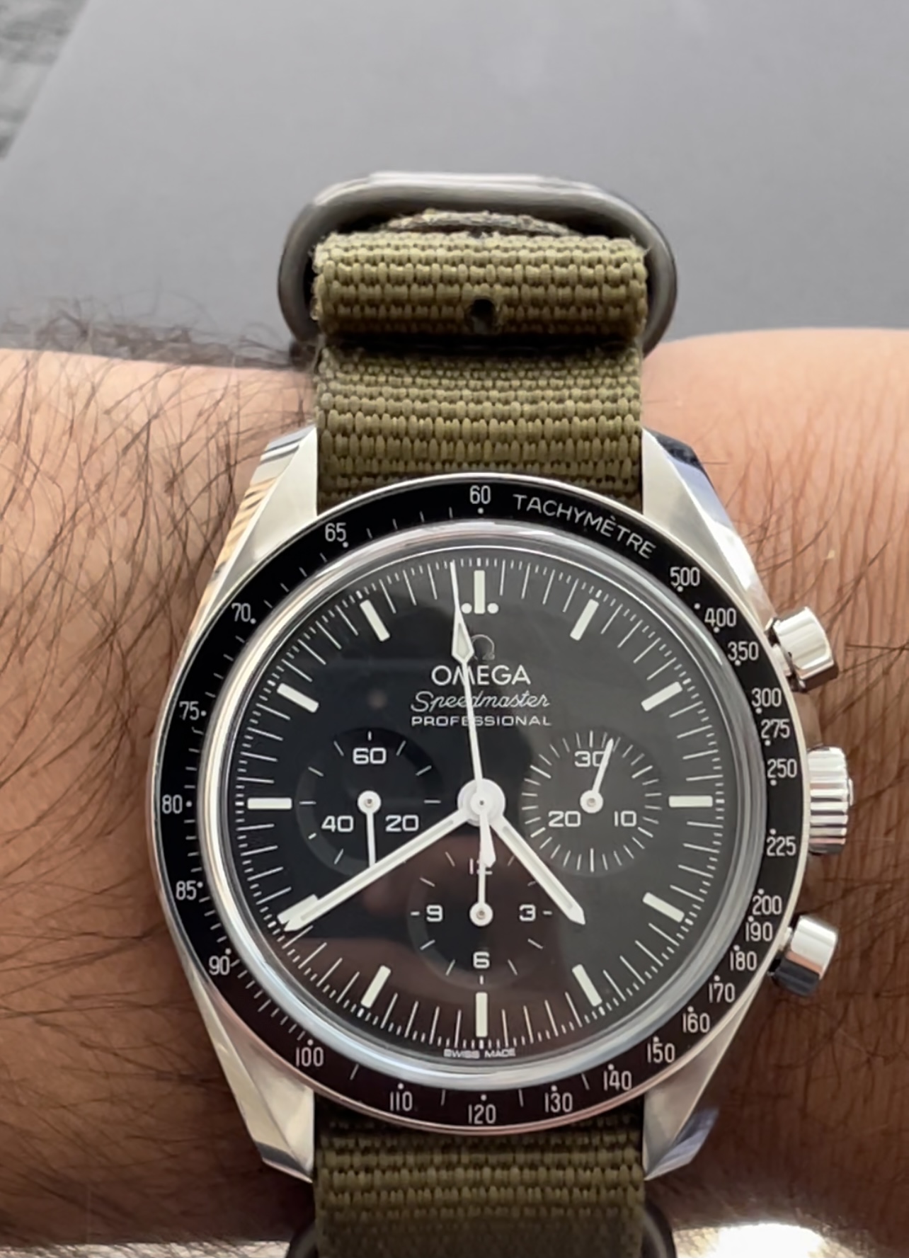

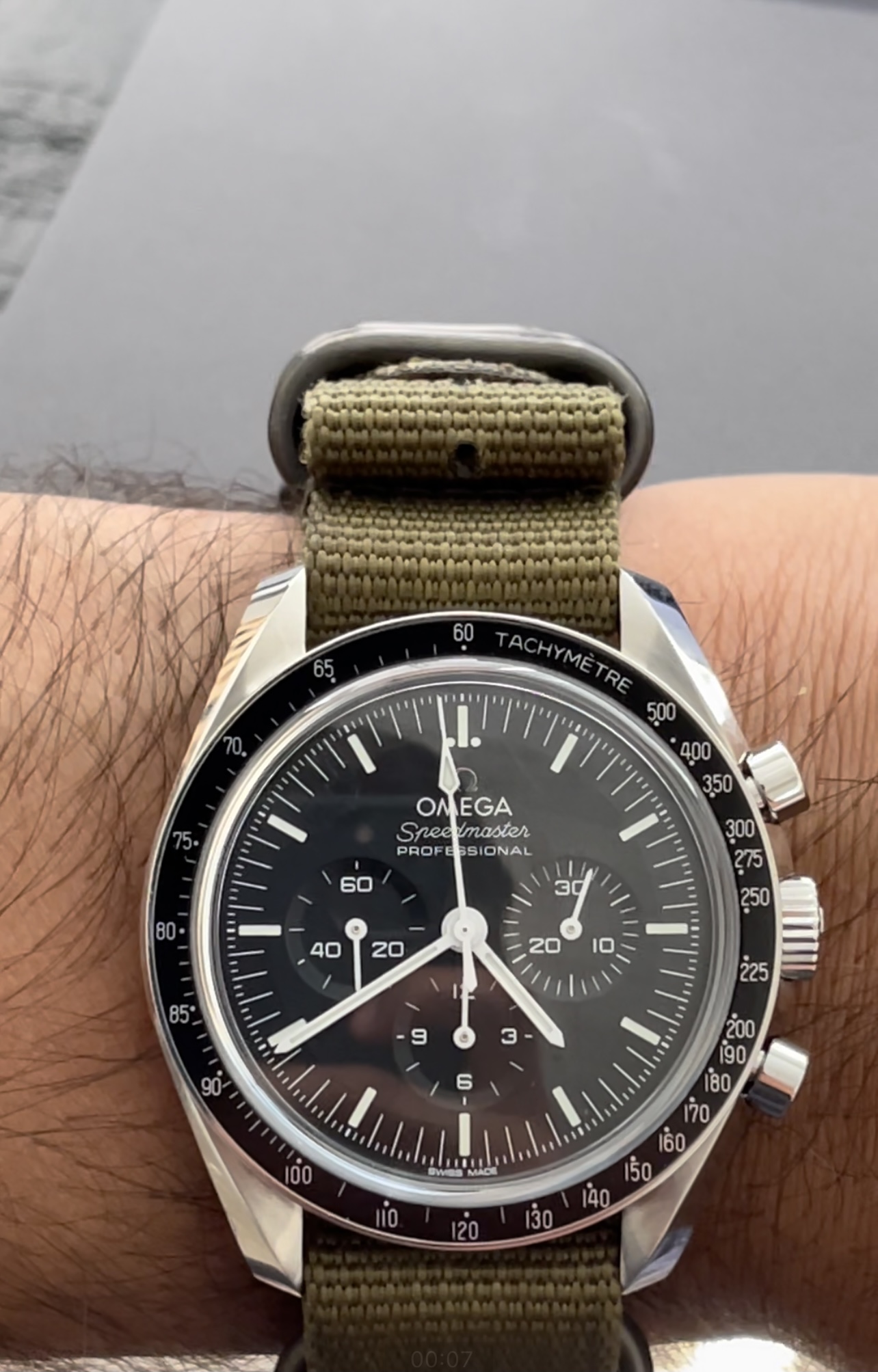

The minute hand ticks just under 1 sec soon. Technically I can stop it and what should be 59 sec would appear as 1 min and 59 sec.
My watch is 14 days old - tomorrow is my last day to return but I’m not sure it’ll pass the return policy. What should I do? Would hate to send a new watch off to service already. Anyone else have this issue?
Here’s the video link:
https://share.icloud.com/photos/05RbQQbk--4iMzUu1TFyyRA3Q#Marina_del_Rey
I’ve attached the 3 frames of the video showing it tick early.
