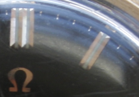

The reason I asked because some early dials (manual winding 30mm etc....) have fixed markers (not removable) These markers were attached permanently onto the dial from the factory and we don't see anything from the other side
This type of dials and also stamped out from the back markers dials. Redial can be seen mile away. When new paint apply with markers on the dial, paint gabbles up around markers with heavy layers, every-time. Most dial refinishers will tell you this upfront.
And I have seen these fixed markers also in some omega chronograph dials and you can imagine the difficulty of properly repainting these sometimes very busy chronograph dials with the markers still in place.
My only advice with fixed markers dial, do redial in black less visible

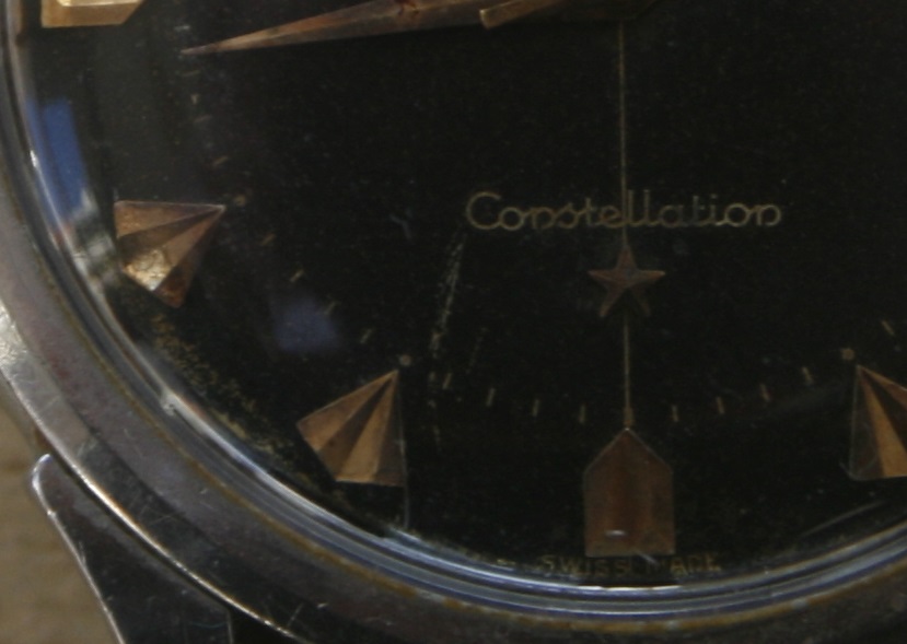

Original Black Omega dials are actually plated as well. On a black and gold dial the gold is put down first with a black top coat
allowing the gold lettering to show through, the lettering and minute track is NOT printed. BTW most 1960/70s blue Omega dials
were plated as well.
The solution to do black or blue plating is ungodly toxic and expensive so few if any dial re-finishers will even touch it.
Thanks very much for the info ref how the black dials were created. I have just purchased 354 and 561 Constellations with black dials and knew that as the black aged then copper or gold speckles showed through which you can just see starting to happen on the 561 below where they catch the light.
But the older 354 has quite a lot of gold showing at the dial edge at the number 7 position and a bit of a streak. I couldn't work out how gold paint could have got there.
Now I know the gold was plated first and then the black applied it makes sense.
Thanks again.
