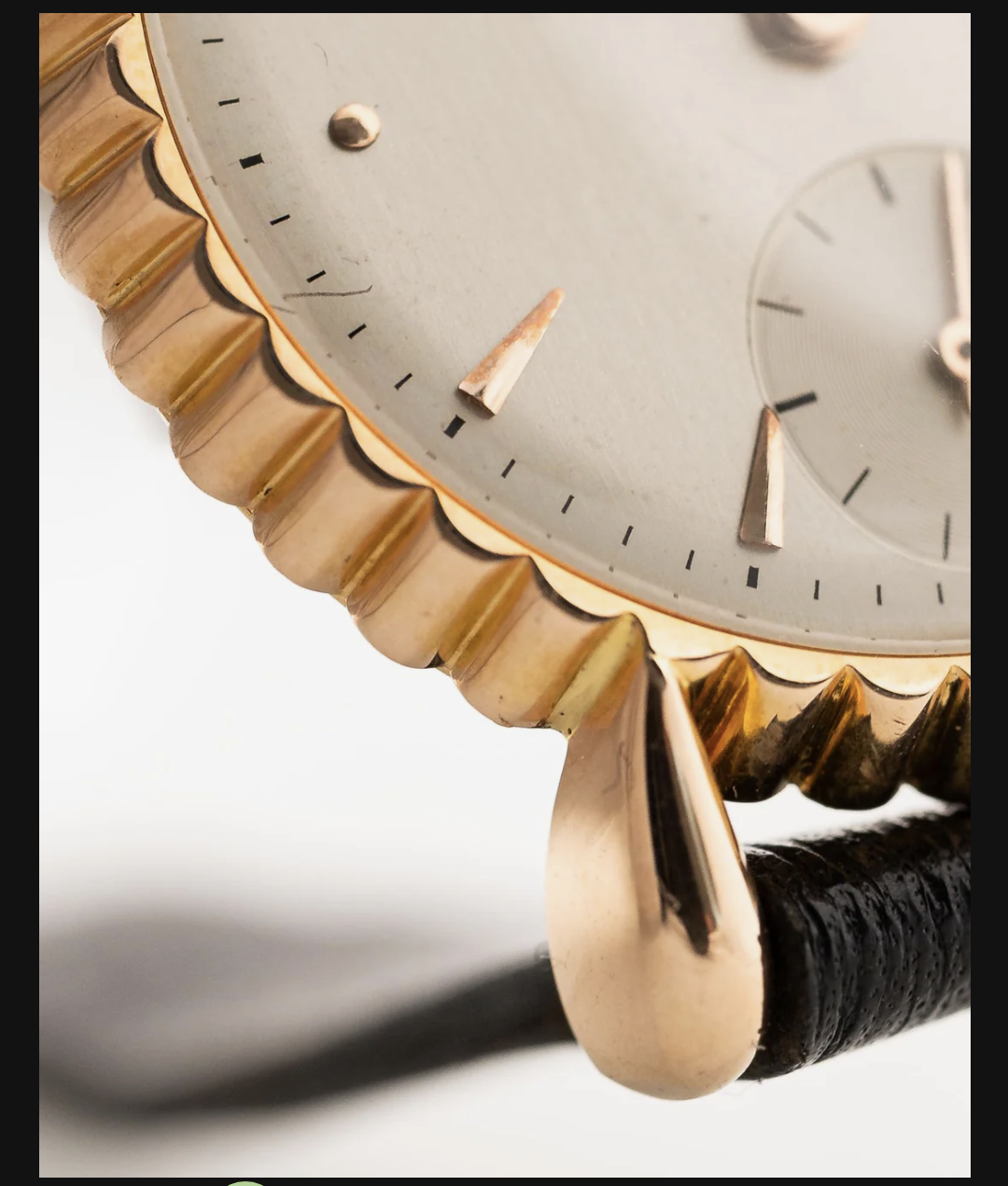

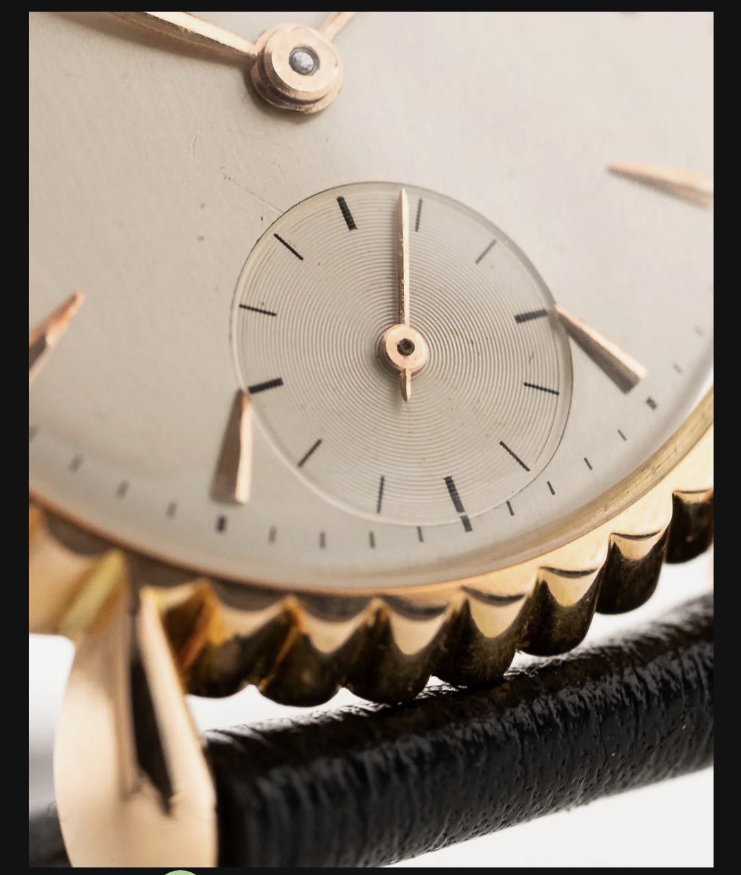

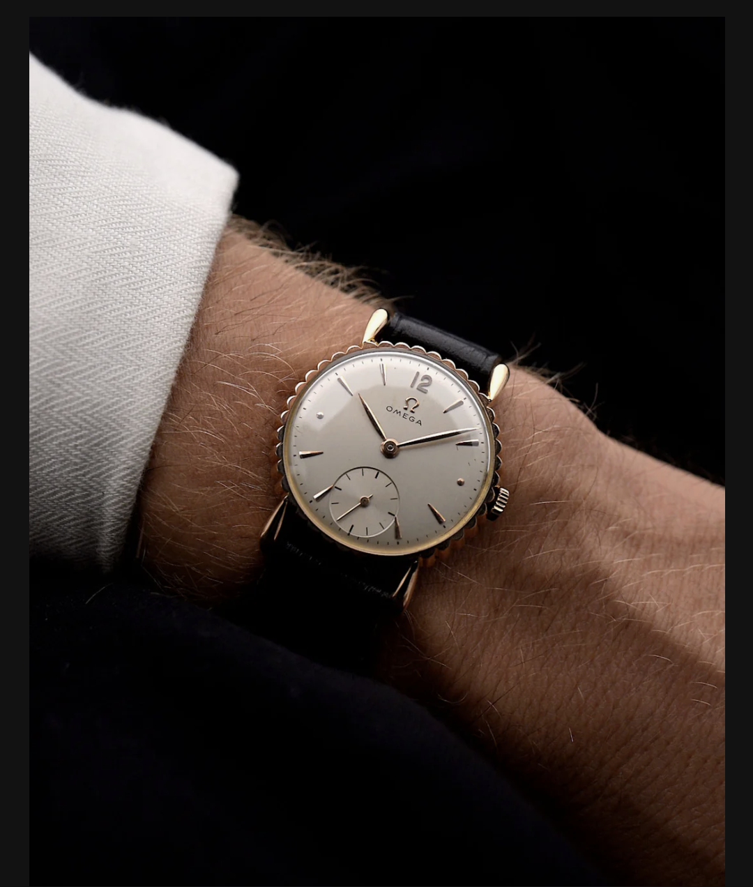

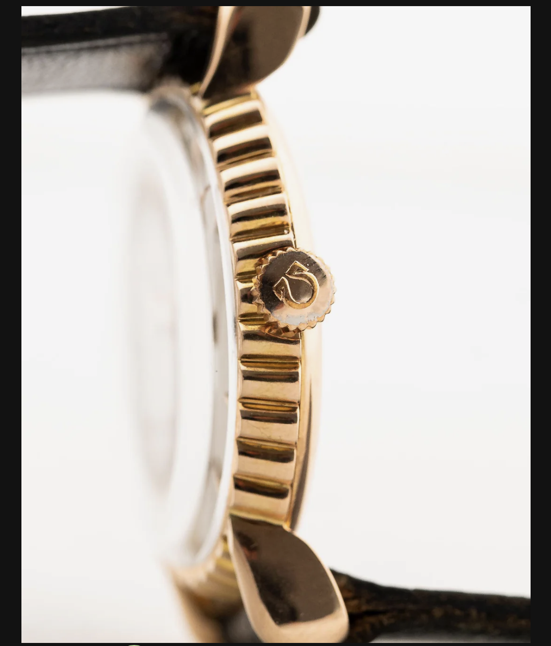

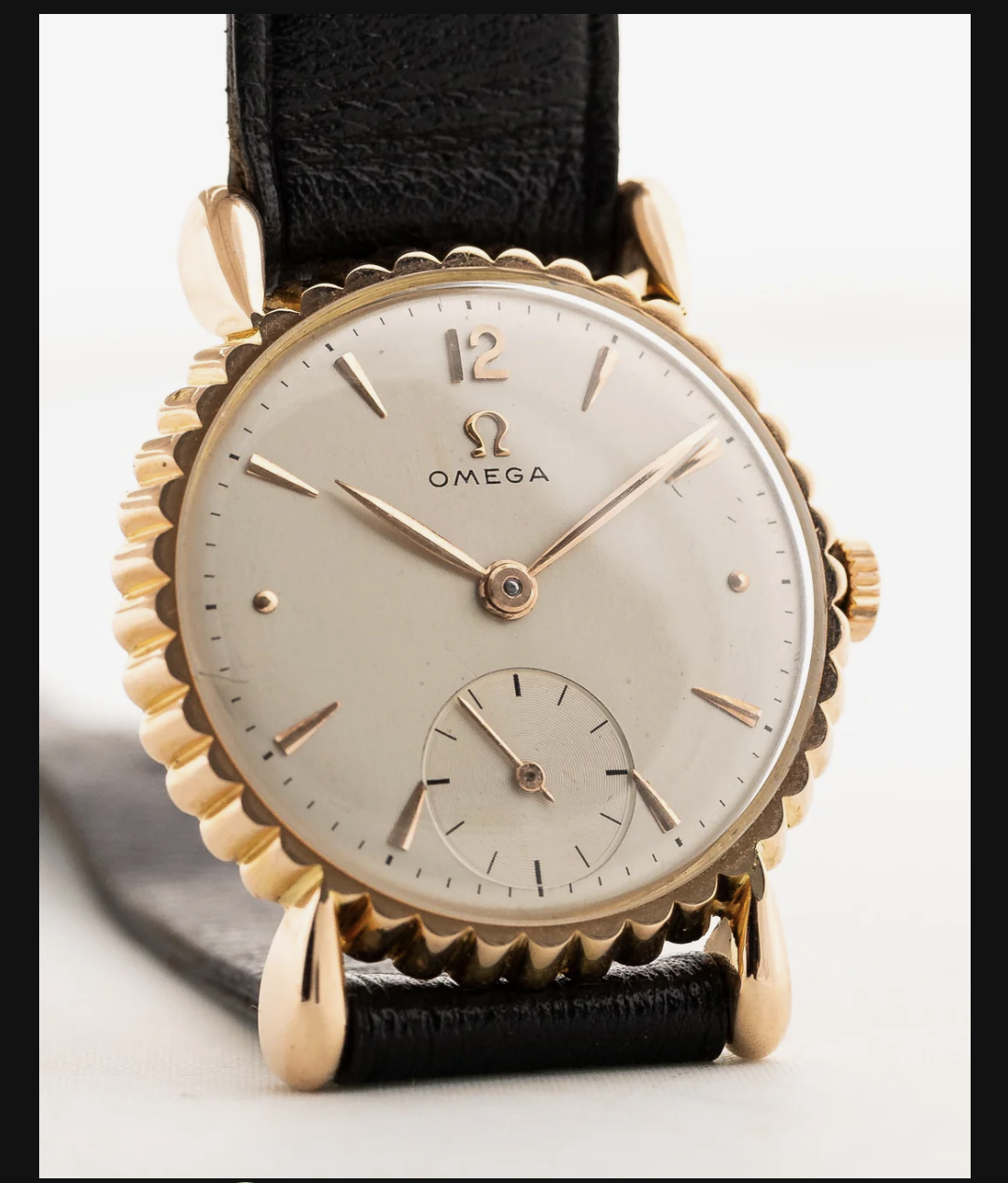

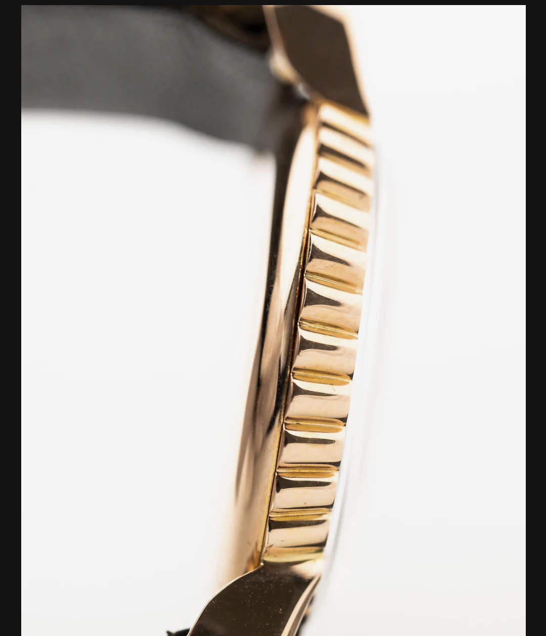

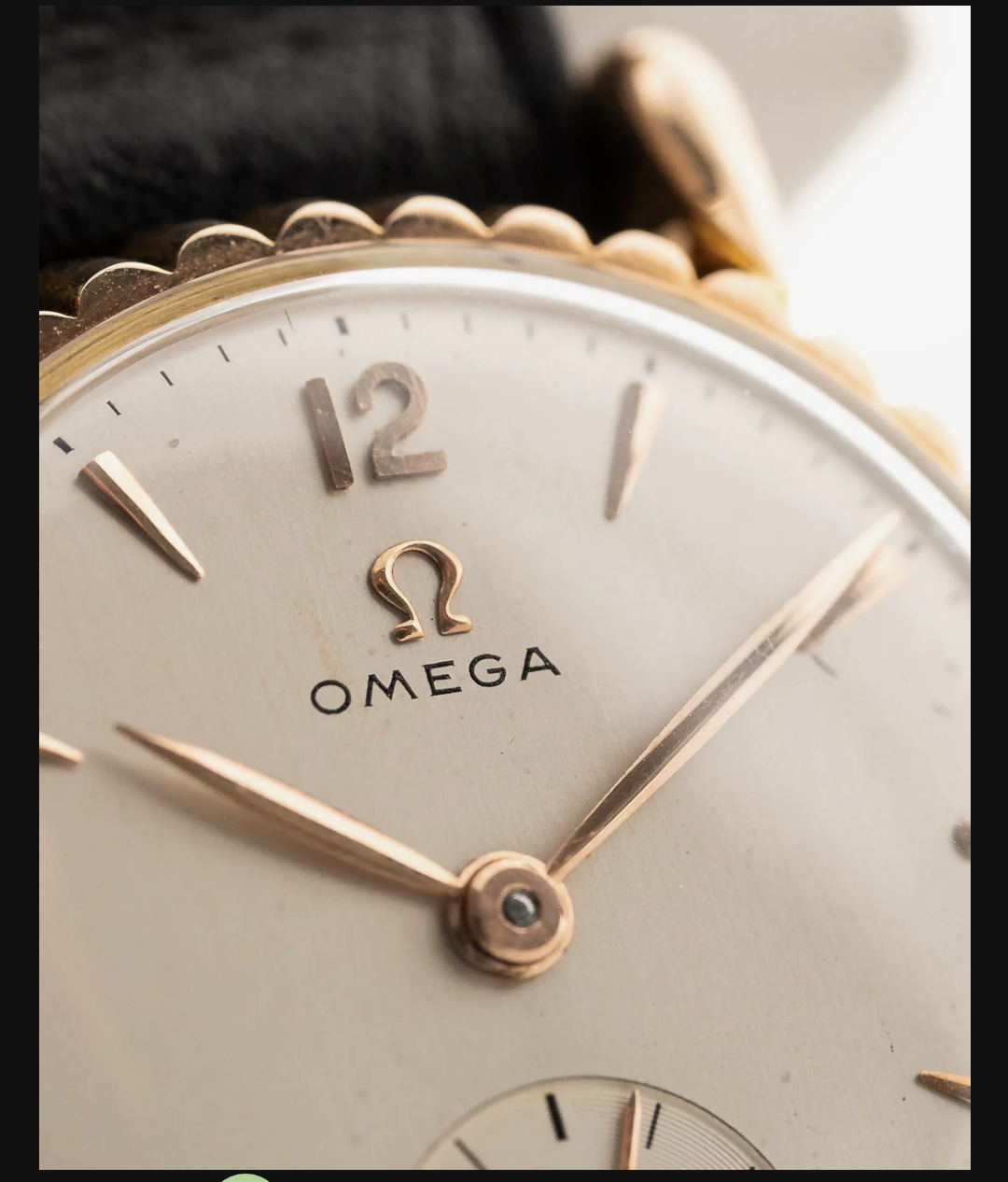

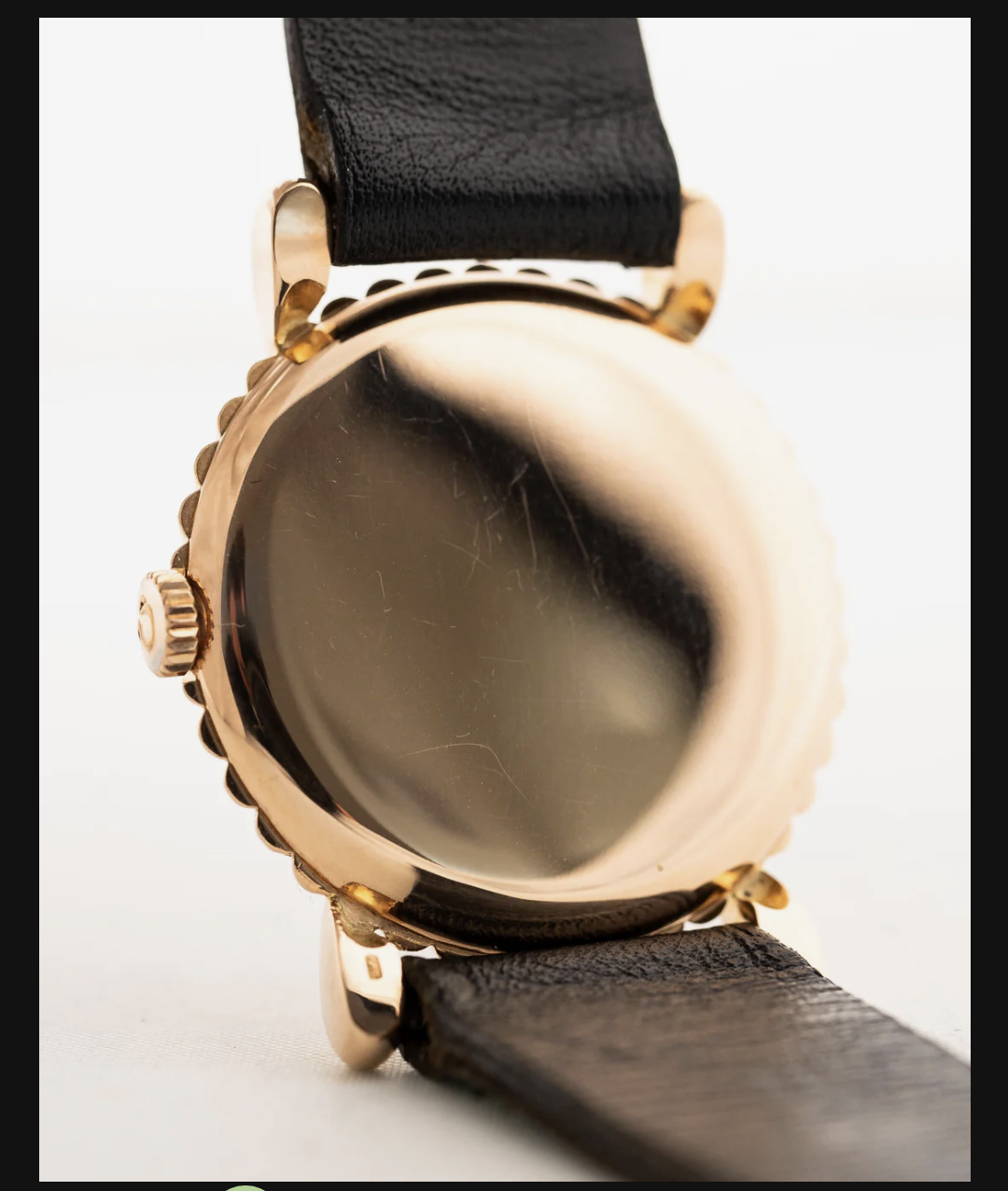

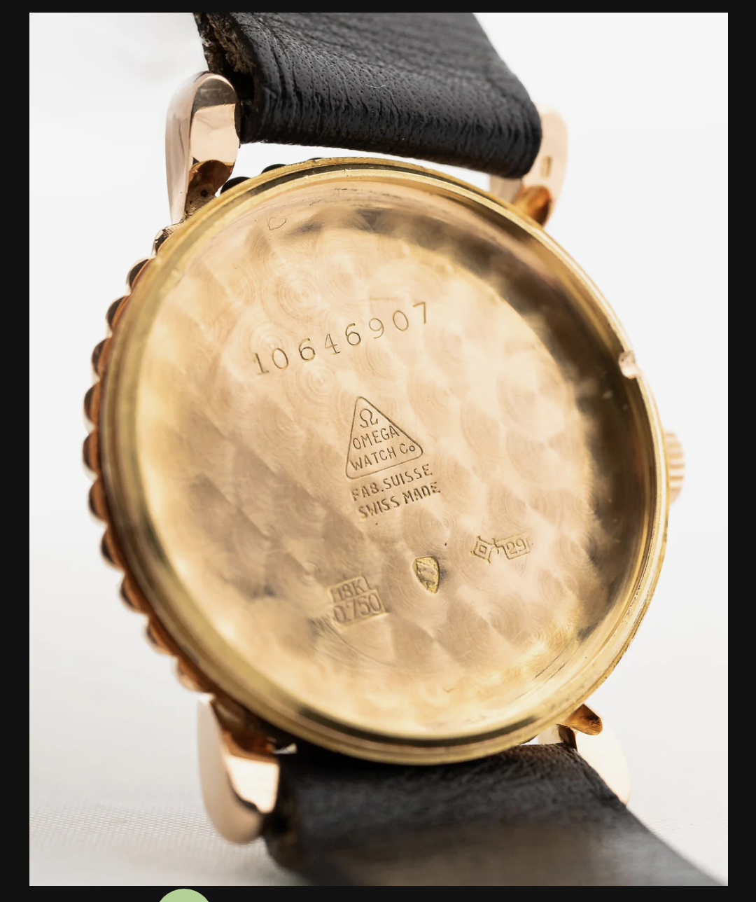

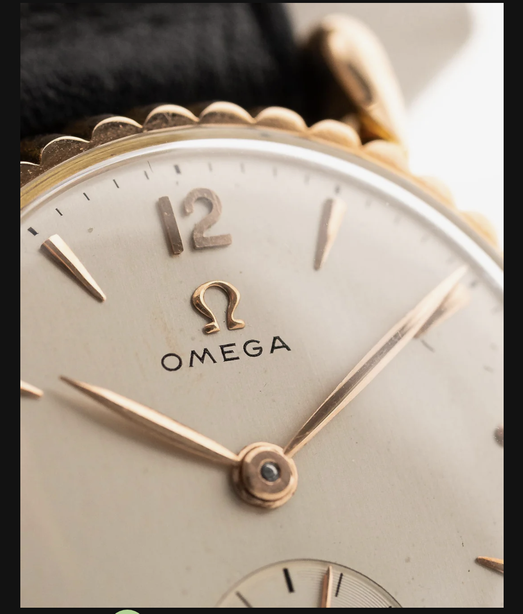

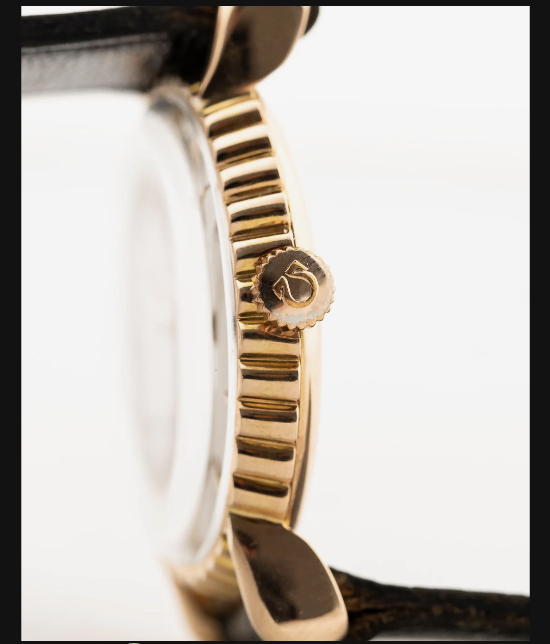

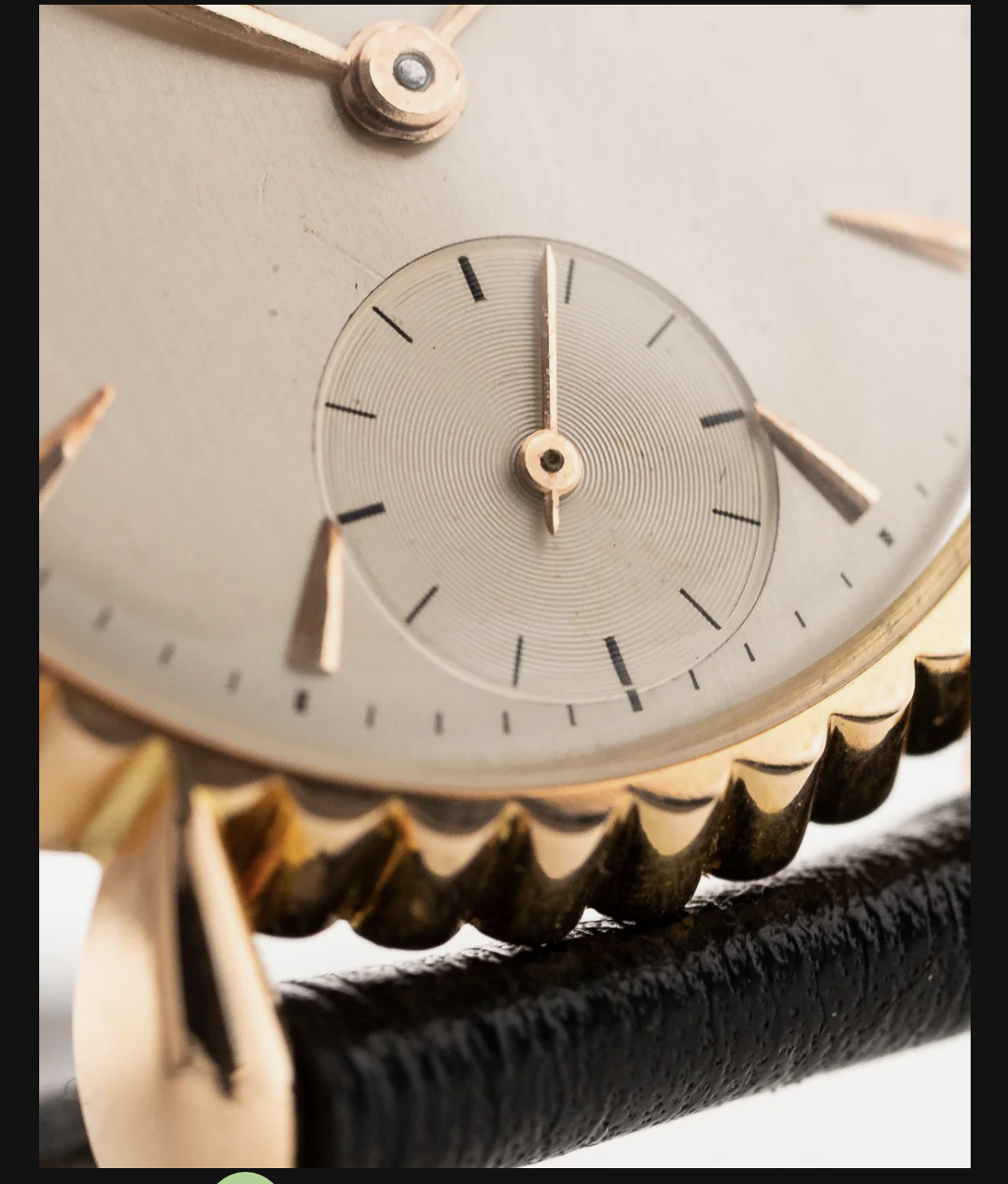

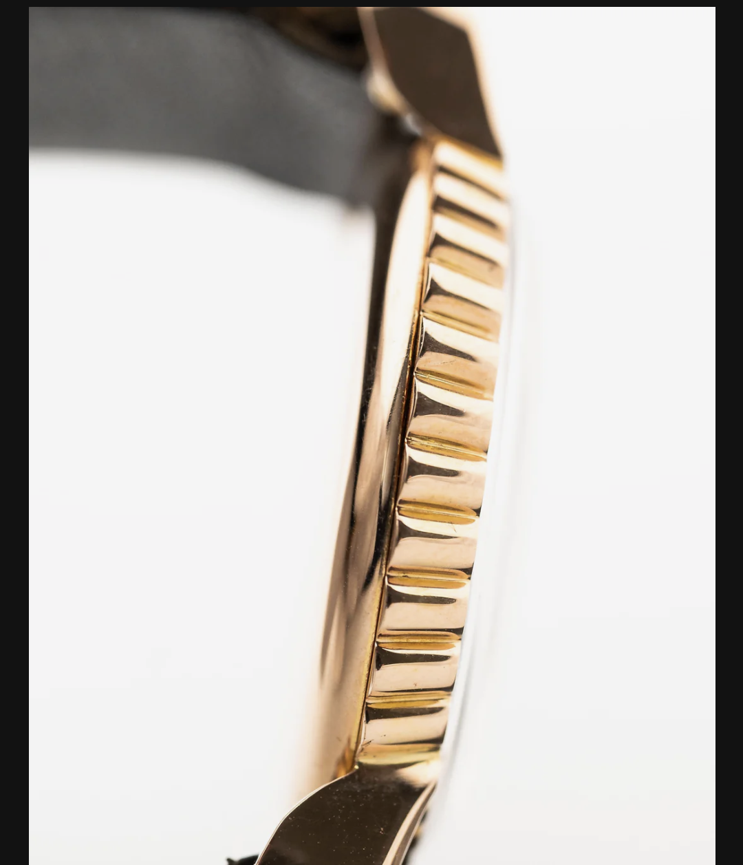

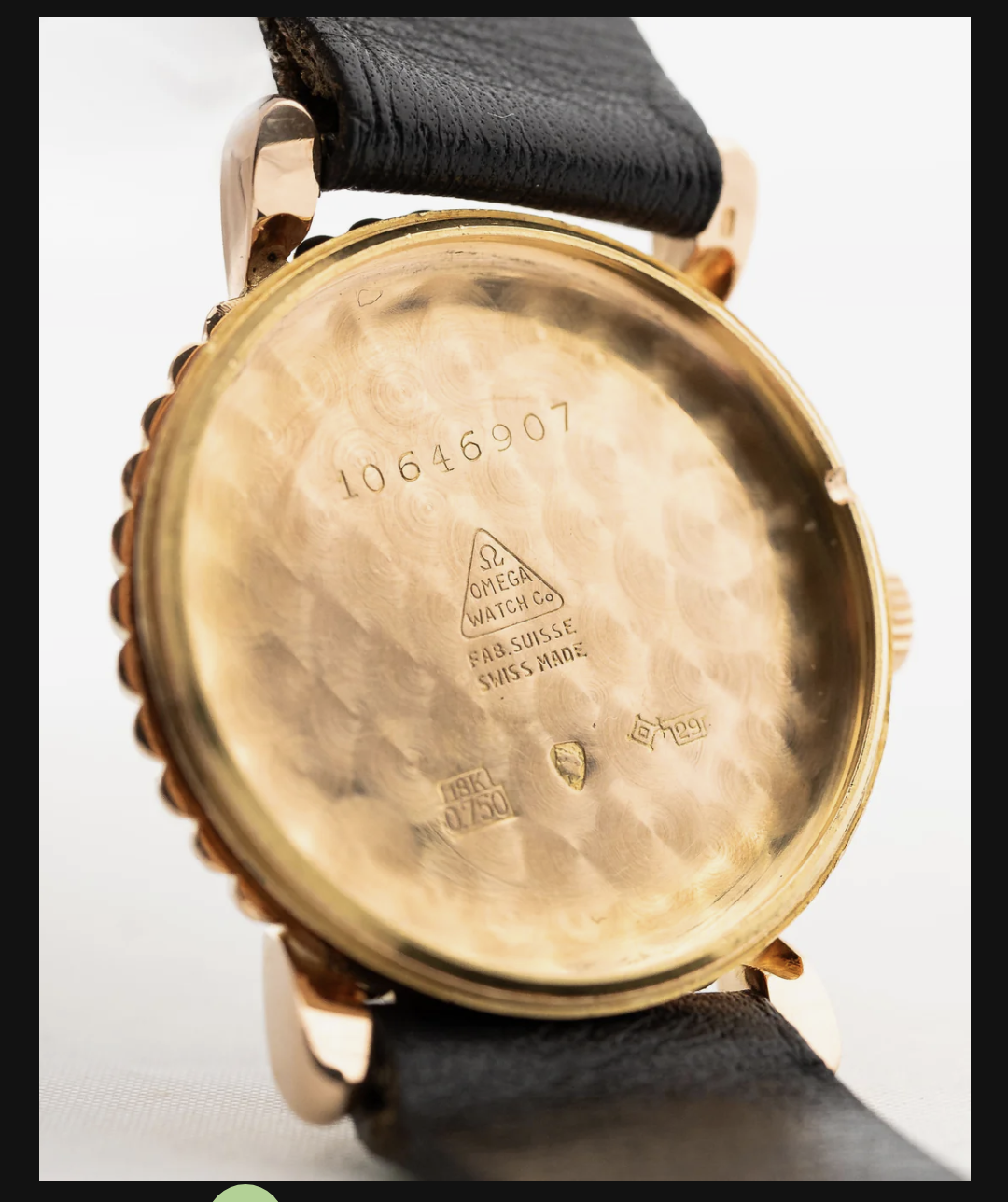

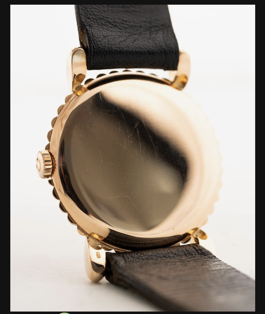

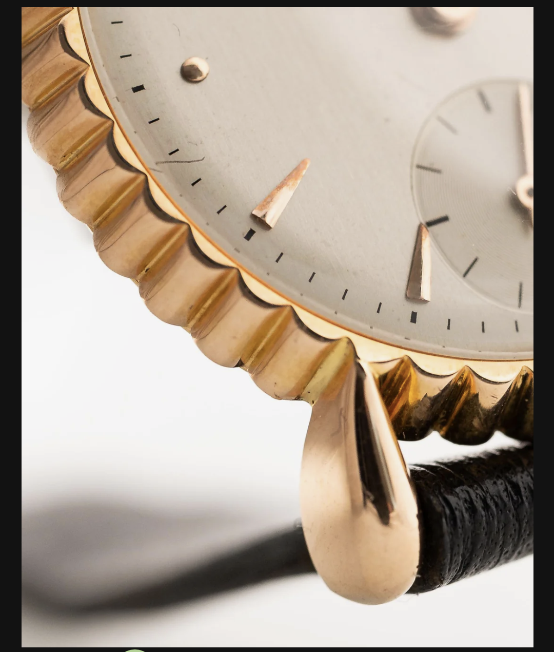

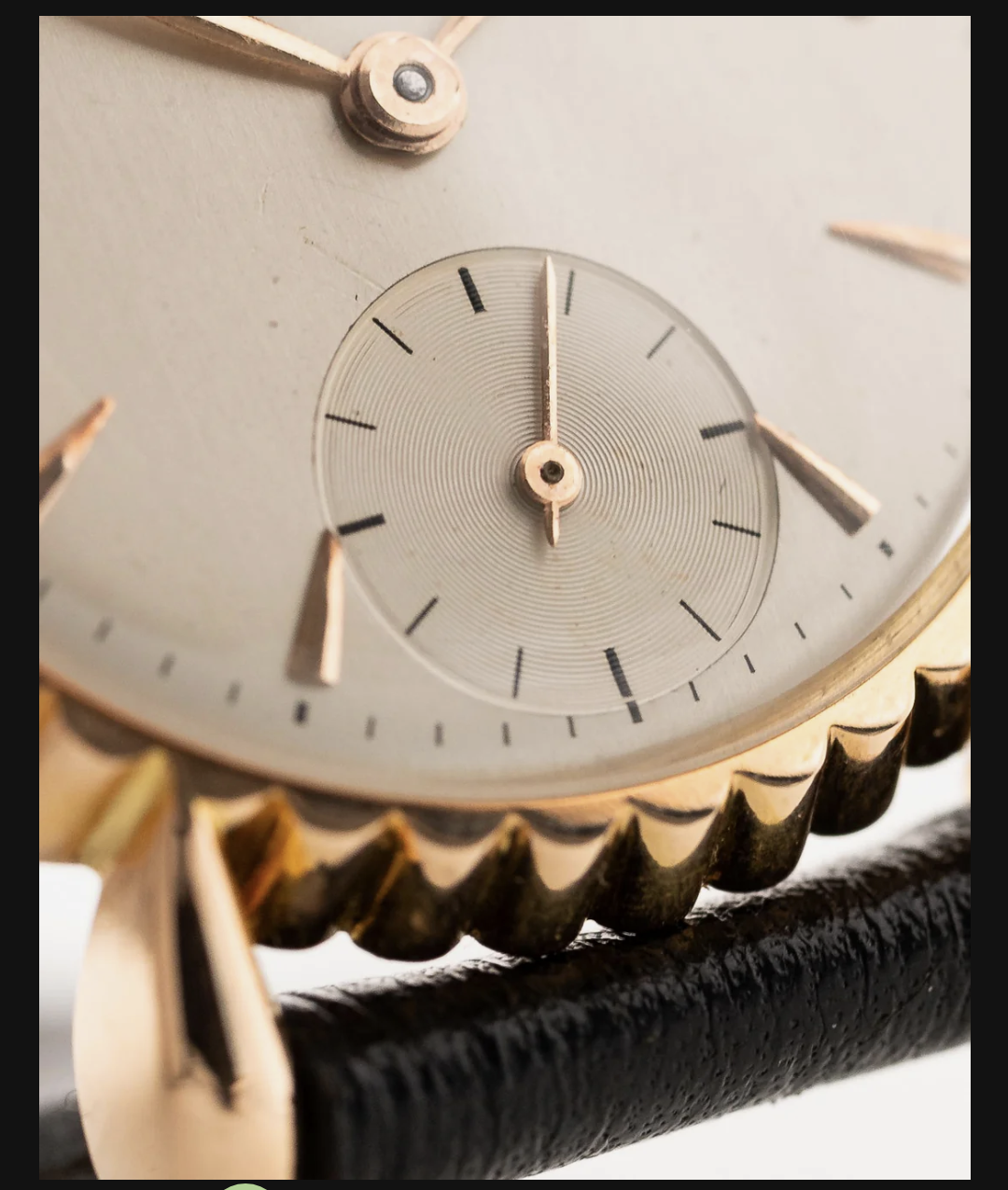

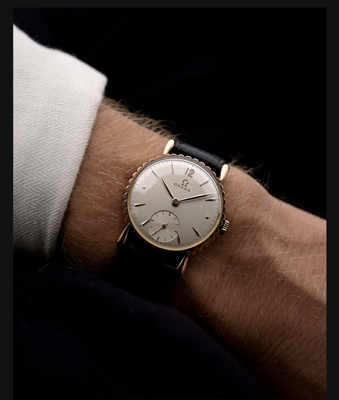

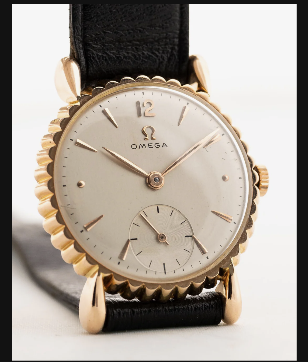

Hi, my daughter has asked me about this 1940s Omega and I need your help. As the photos show it has a scalloped 18k case I've never seen before. The inside case back markings would indicate it is original but something makes me suspicious, especially given the all-too-polished condition. So welcome your thoughts on the whole watch-- case, crown, movement, and dial.

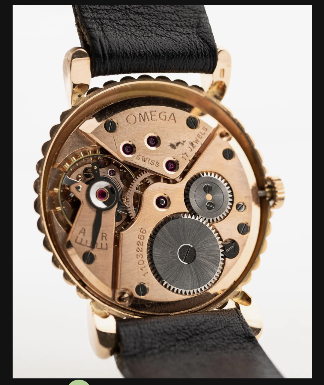

Photos of the case back, both sides, and how the movement is set in the case, should reveal the answer.

An Omega "Bottle Cap" from about 1950.
Example here.

Wondering if old refinish. 5:00 index protruding into the chapter ring. 7:00 correct

Thanks, @ Tony C. Are you able to see the additional photos i posted?
Thanks DON

IMO all original except the crown which is probably a later replacement.
Case is a bit polished but overall a nice looking watch

I am not an expert, but it appears to be a genuine FRENCH case. I'll leave it to the experts to opine on possible refinishing.
I think it is Swiss made. The key hallmark marked 29 indicates Weber & Cie is the case maker.
3,653
7,770
There is the Helvetia head hallmark clearly visible, so it should be a Swiss case.
8,290
29,352
Yes, my mistake, you are correct.

And yet no Swiss or Swiss Made text 🤔
So are you thinking it has been recased?

Any thoughts on @padders suggestion that this might be a redial? Also, the seller indicates it is a Cal. 266. Is that correct?
No, definitely not! This cal 28 (later called 360) is often mixed up with movements out of the 30mm family at a superficial glance.
It is easily discernable by the smaller size and the wide facet at the rim by people who know their stuff...
Thanks, Mac_Omega. I really appreciate it. As always, I value what I can learn from OF and am glad to share it with my daughter this time.
