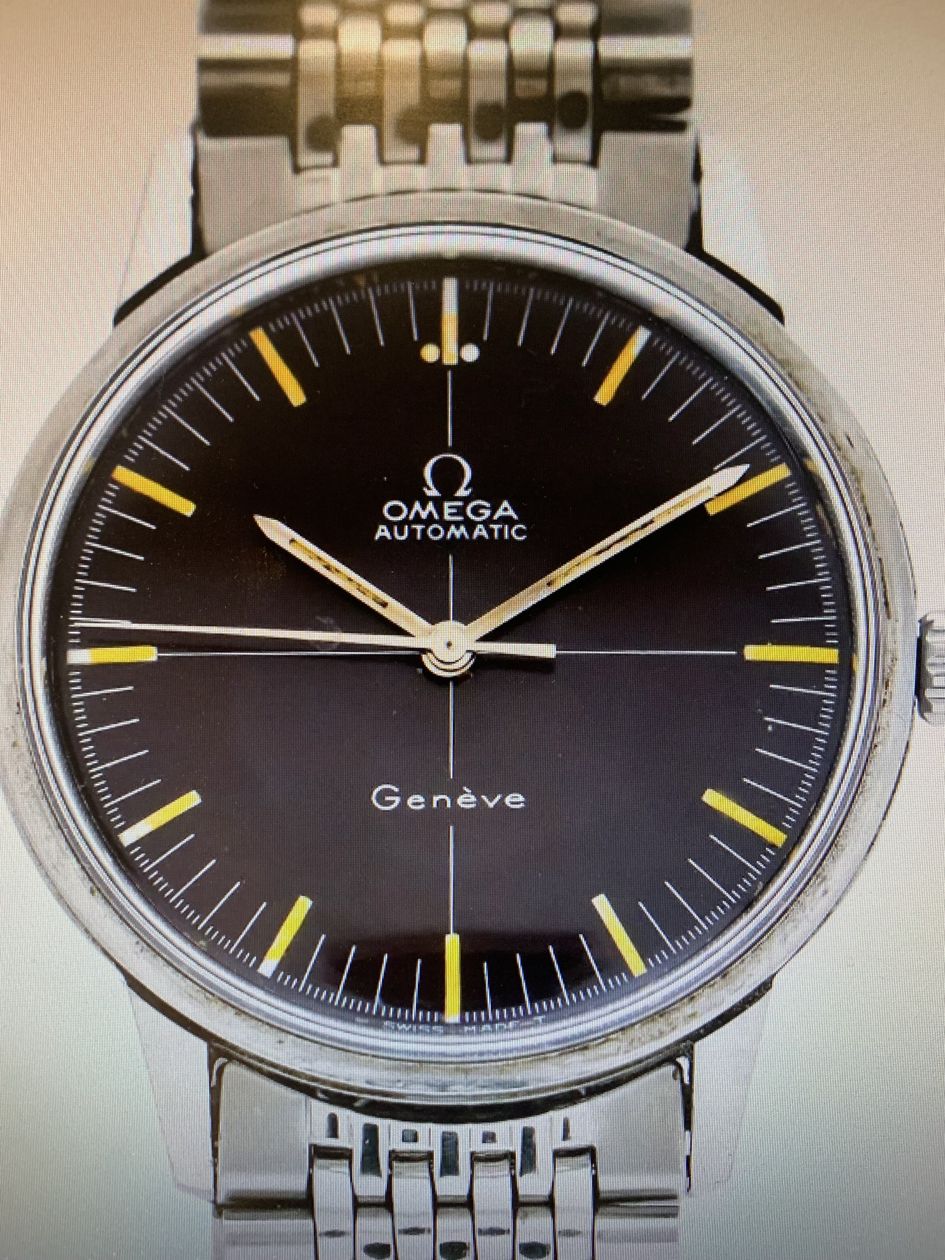

Is this dial original?
28
52
On a resellers site I trust but its my understanding the crosshairs AWAYS runs through the logo and model name. Also the logo looks a tad off center? Its looks properly aged. Thoughts? Reseller claims 100% original. Please educate me.
13,556
23,504
Crosshair having to intersect the text is more on Constellations. For late 60’s Seamasters and Geneves they can absolutely be as shown in your pic.
Original in my view.
28
52
Thank you… I have learned something new today!
1,372
2,001
Given the flaking lume on the dial, I'm voting original. A redial would look perfect.
