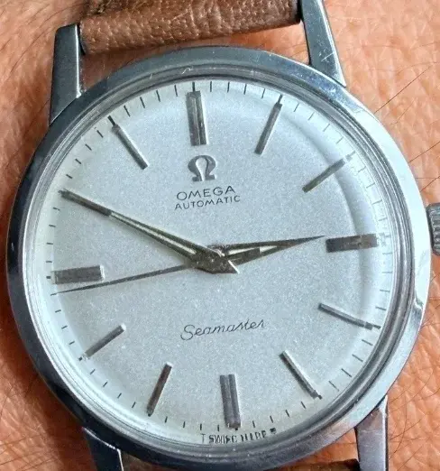

Posts 2 Likes 0 grimReverb ·Sep 2, 2026 What do you guys think? The "seamaster" font (specifically the non-coat hanger "S") and the overall condition put me on edge.
Posts 54 Likes 119 HadgeBadge ·Sep 2, 2026 Definitely a bad redial in my opinion. Indices are squiff to the minute track. Hands look like they have been relumed and the font is wrong.
Posts 290 Likes 124 Temprus ·Sep 3, 2026 HadgeBadge Definitely a bad redial in my opinion. Indices are squiff to the minute track. Hands look like they have been relumed and the font is wrong. Completely agree. Also, the Tritium is missing on the dial, since it stamped "T SWISS MADE T."
