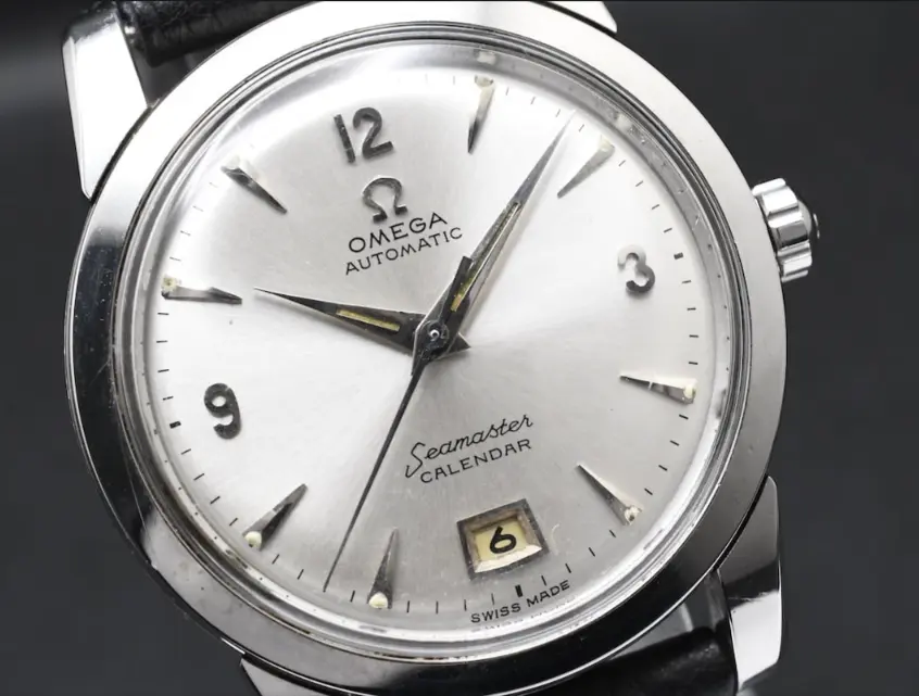

Posts 274 Likes 1,619 Wizzar ·Feb 8, 2025 Hi, please give me your thoughts Im not an expert, on caseback 2757-2
Posts 201 Likes 59 uk_omega ·Feb 8, 2025 Hour markers don't look well aligned so suggest probably a redial
Posts 216 Likes 151 Clelow ·Feb 8, 2025 The image appears overexposed. It would be nice to see the sheen and luster, or lack thereof, of the dial face.
Posts 282 Likes 64 SerP ·Feb 8, 2025 Wizzar What are the signs? Uneven fonts - in "calendar" different height of letters, also S in Seamaster to me looks to sharp, but I'm not the expert.
Posts 4,497 Likes 11,003 redpcar ·Feb 8, 2025 Sun aged calendar wheel vs an un-aged dial is a quick tell that something is off.
Posts 282 Likes 64 SerP ·Feb 8, 2025 redpcar Sun aged calendar wheel vs an un-aged dial is a quick tell that something is off. + luminophore tone on hands and hour marks not match.
Posts 2,814 Likes 6,941 seekingseaquest ·Feb 8, 2025 S font in Seamaster is the biggest giveaway, plus the lume color that looks like tritium, when it would have originally been radium.
Posts 3,578 Likes 13,519 MtV ·Feb 8, 2025 Also, sunburst finishes on Omega dials simply weren’t produced until later that decade.
Posts 18,746 Likes 38,895 JimInOz ·Feb 8, 2025·Melbourne Australia add: Swiss Made not correctly aligned.
