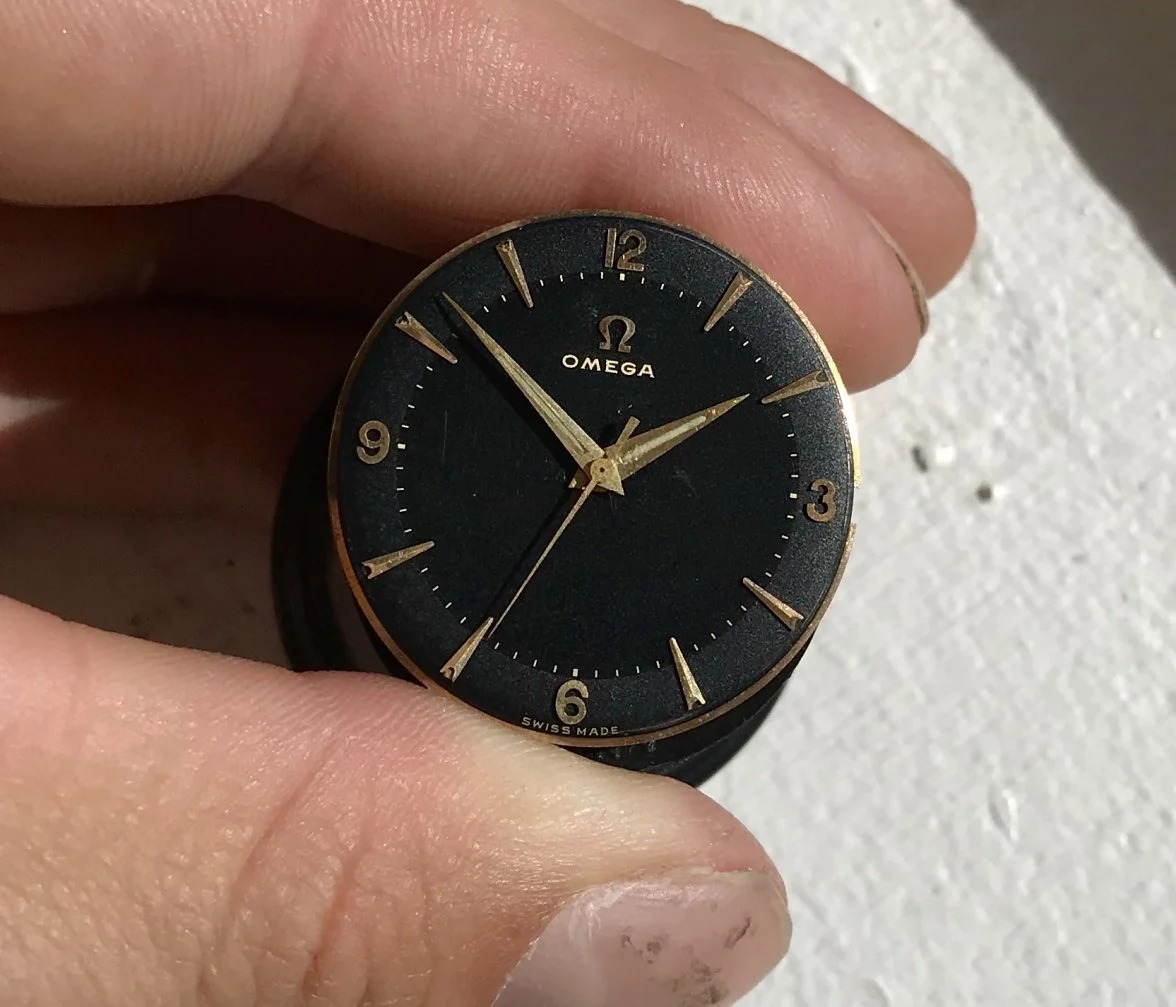

I've managed to find a better picture; hopefully this one can decide whether it's original.
What do you guys think?

I can't see the photo.
edit - I refreshed and now see it. That 2-tone dial with shiny centre section and mat outer ring is puzzling. I have never seen this before. Is it possible that the centre was repainted and hour ring left original? This question is for the experts and I defer to their knowledge and experience.

Two-tone dials are seldom reproduced so good as this.
4,044
45,719
The word "OMEGA" seems to be slightly out of center.
I noticed that too... But Im' OCD for alignments, so it might be me or the angles of the pictures. A straight frontal would be nice.
For my information, what would make the difference of the 2 blacks (center and ring)? 2 different paintings used? Would it have been glossy and mat originally?
I'm not familiair with this exact dial either, but to be fair i've seen more of these references with two tone dials. It seems to be quite common for the reference.
Unfortunately I don't have the watch so i'm unable to provide a center picture. As to your second question, that seems logical but I don't have much evidence to back it up. I have seen another one which was white but with the outer ring showing heavy patina and the inner ring without, presumabely different paint there too.

Look @ 6 O'Clock SWISS MADE, A good indicator it is the genuine article.
At some point the Swiss said unless it was made [ The Dial ] in Swtzeland, we could not print Swiss on the dials when refinished. FYI Like Idaho potatoes have to be from Idaho.

This is absolutely not true. Almost all refinished dials still say ‘Swiss Made’ at 6 o’clock.
