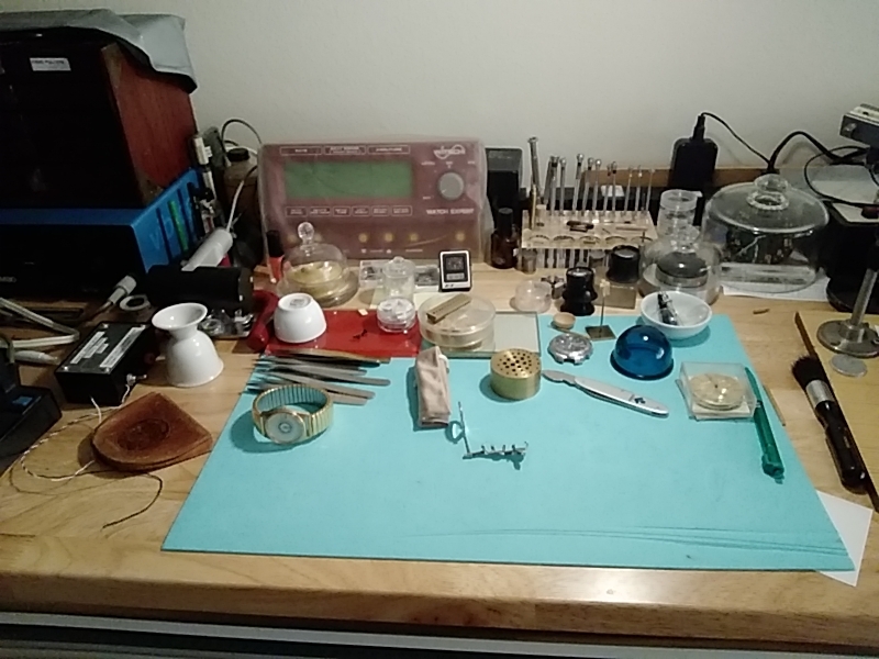

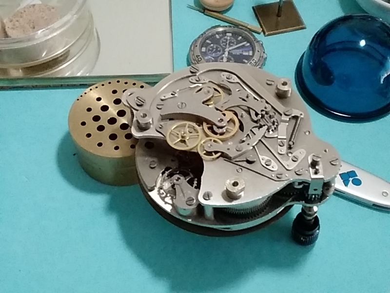

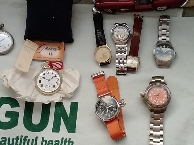

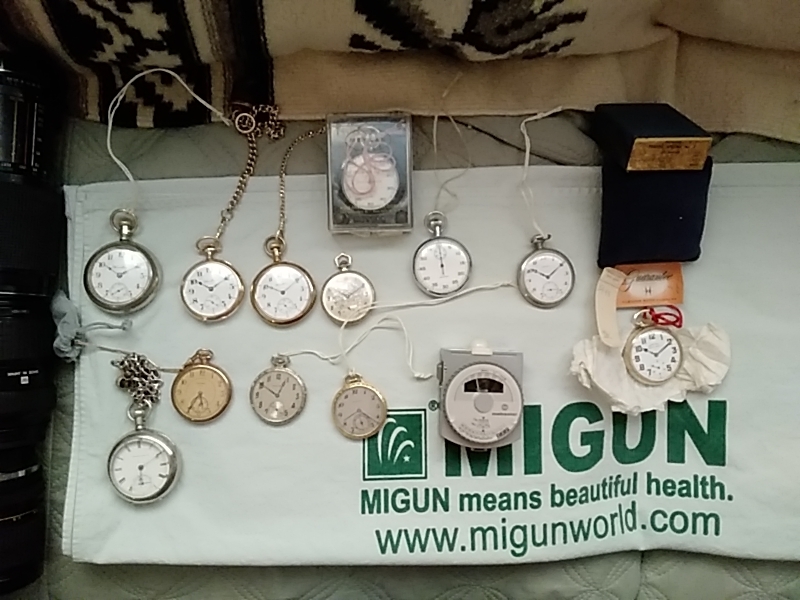

Whats left of my collection & my bench images.

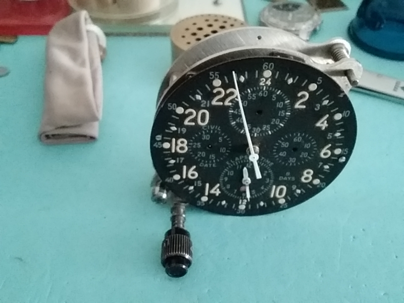

Aircraft clock movement Hamilton WWll, twin barrels, 8 day, elapsed time, running time, civil date, no case or hands. The most compilcated clock produced in America.

I tried to post images of my collection or what is left of it.

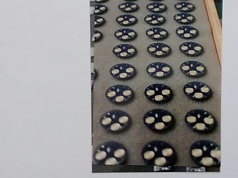

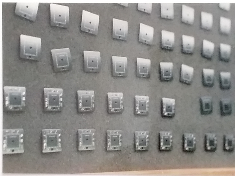

Pictures of Swiss Dial production 1995
Paint to die, die to gummie block, transfered to dial blank.
Breitling chronograph dials
Sun burst dial, being produced o
