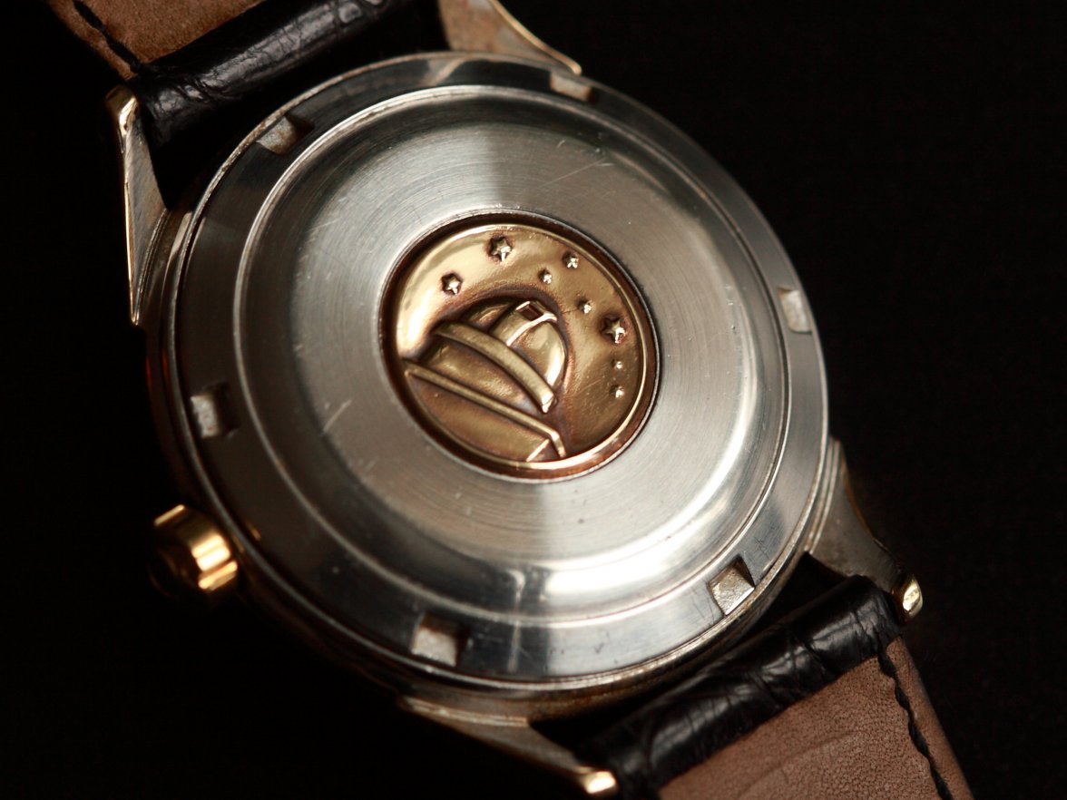

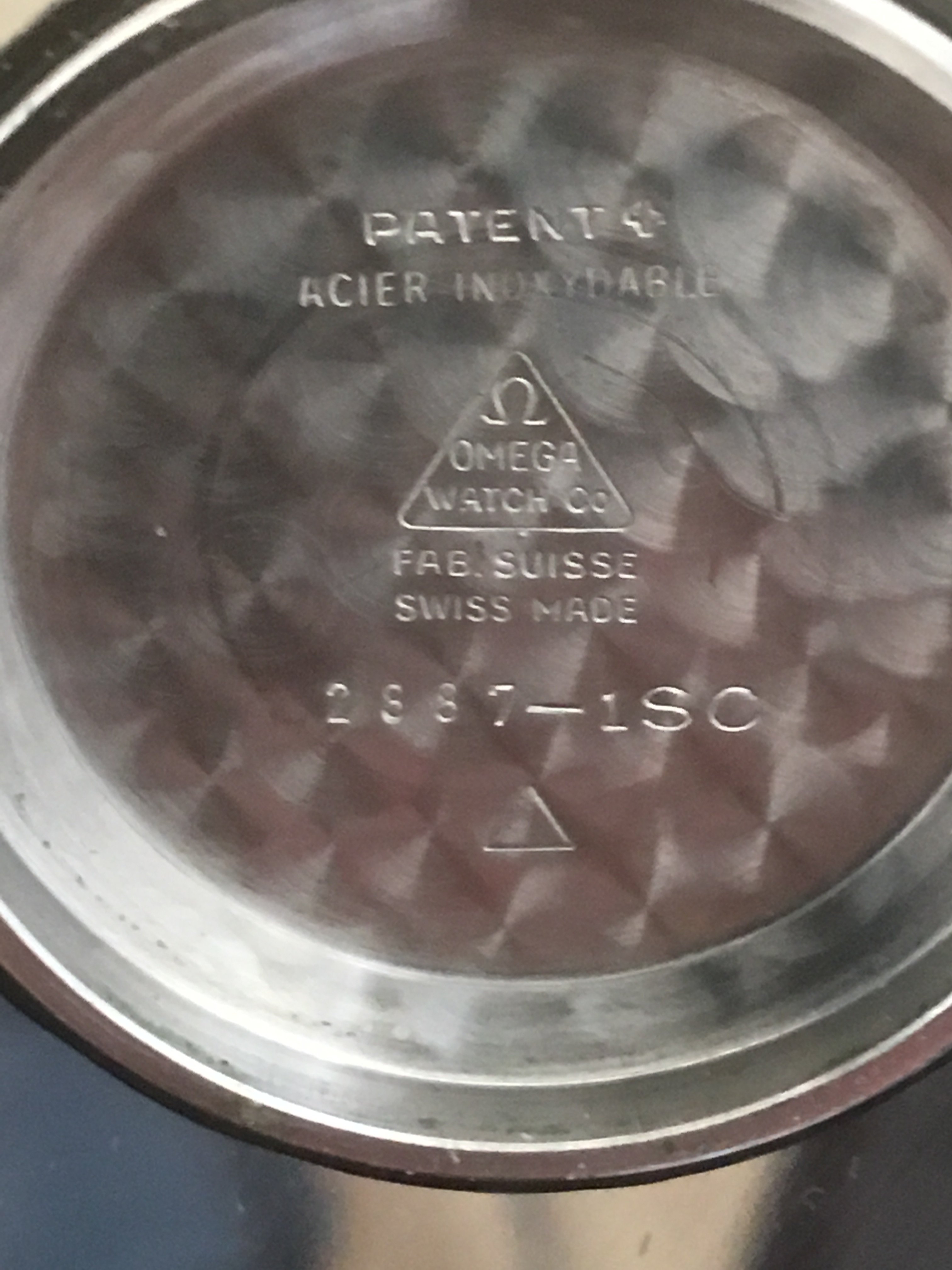

I would be very grateful if you could tell me how you believe this watch to be ref 2887 without seeing inside the back?
There are only two case references of these early Constellations that had screw-in backs. The major difference between these two watches is that the earlier version had a bumper automatic movement and the later one has a rotor automatic. However, since we cannot see the movement, we have to use other means of identification.
The earlier model is the Ref. 2652, with caliber 352 or 354 inside:
As you can see, the medallion on the Ref. 2652 is a bit broader and has a wider rim that your case.
The other reference is the Ref. 2887, which is what both @hoipolloi and I think you have there.
A thinner rim to the medallion and a bit more concave. Here's your example to compare:
24ab8c78-1a36-4fad-9c63-a57059c10d61-jpeg.717710
Which one looks closer to your watch?
gatorcpa
Oh I see, thank you for the time taken with image representation that explained it so well. I cannot thank you all enough for your replies and I did not mean to offend but now I understand so thank you to you both.

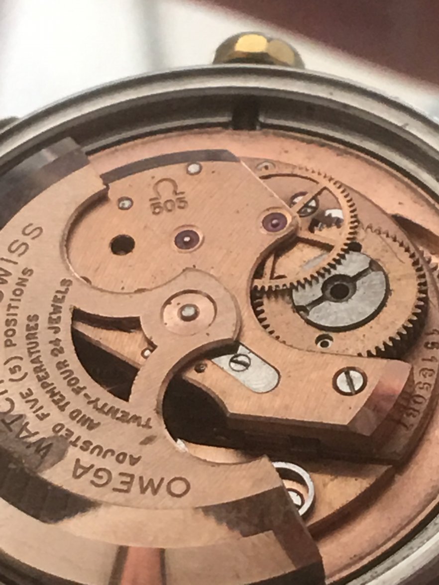

I can see a ring on case back, check the rotor if it touches the case back? If rotor axle is loose, it needs a service .
