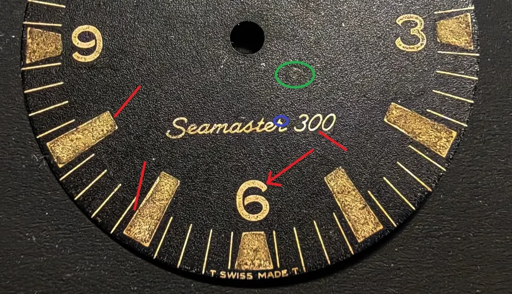

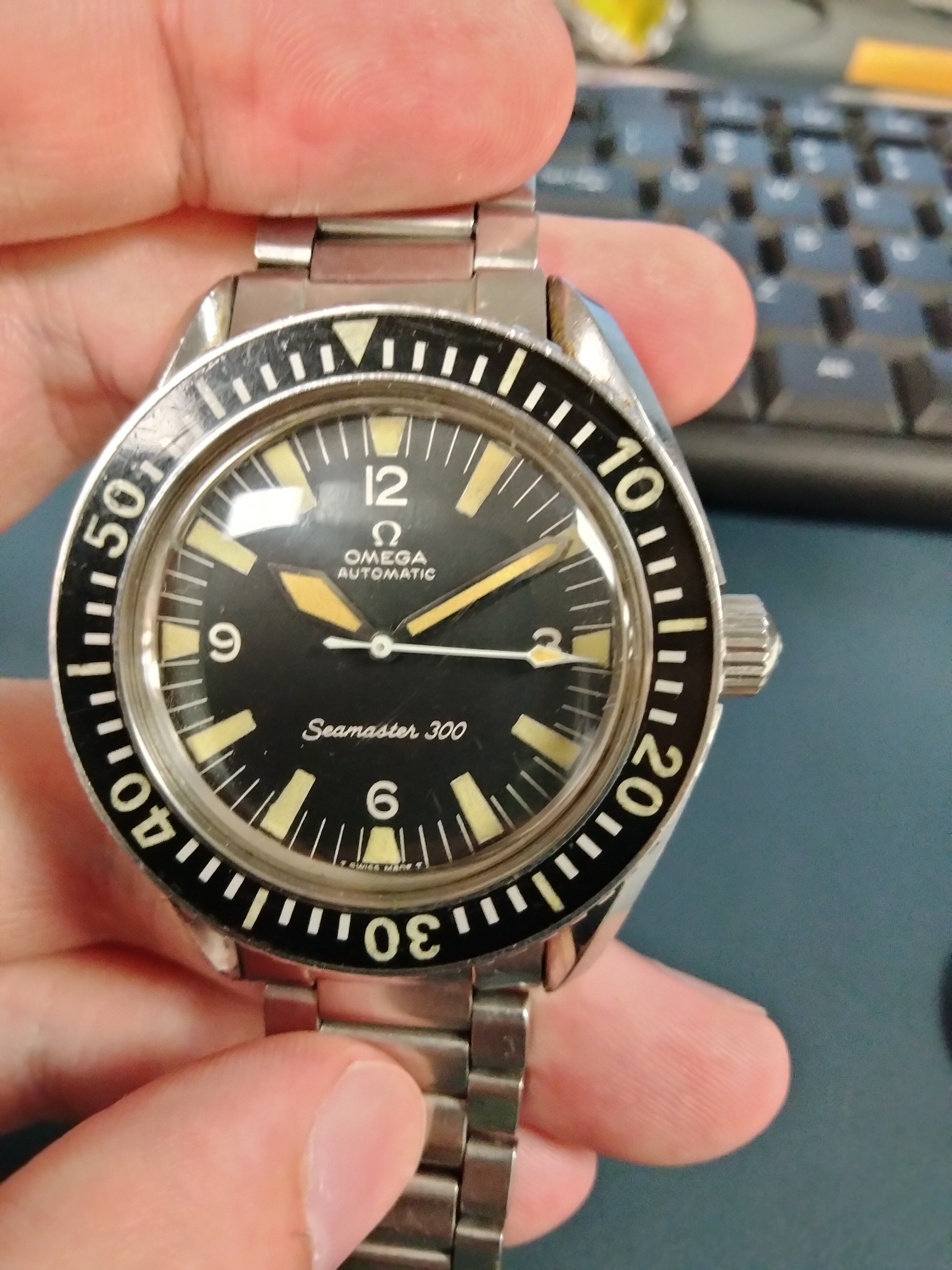

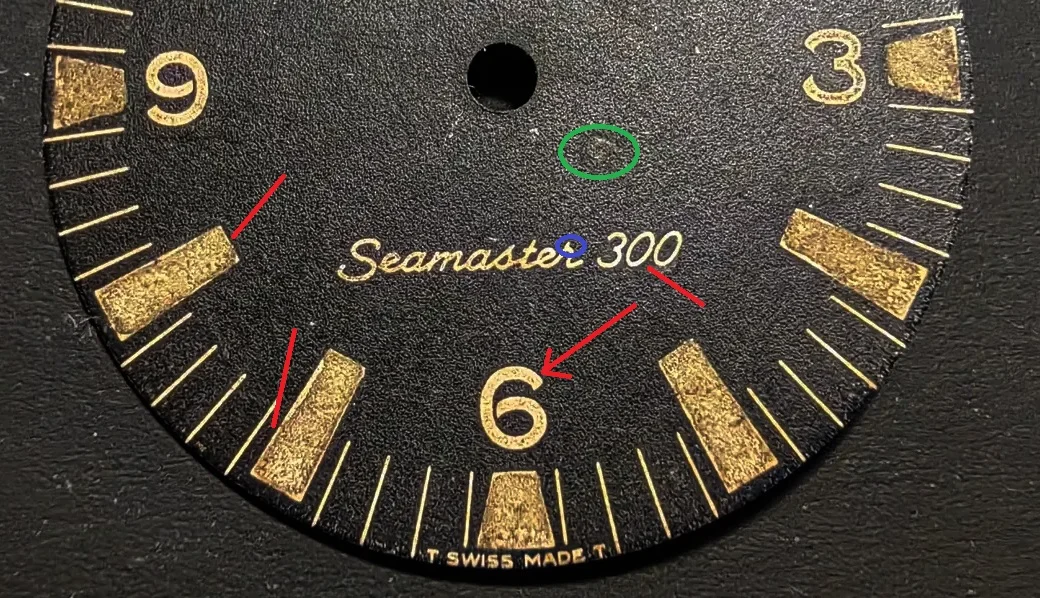

Is this a genuine SM300-set 165.024?

Until today: non information concerning the producer (markings) of this (kind of) dial.
And: it is not a matter of wear of the tampon-print. Omega would never accept this in QC.

It鈥檚 actually a genuine dial, but not often seen.
Yes, he is 馃槑
A-ok dial, and on top also correct within that serial and with the cal 550

Oh thank you guys, you made my day! 馃槄
It would be hard to return this set to the seller if needed..
And thanks for the link - I haven't seen this topic. 馃憤

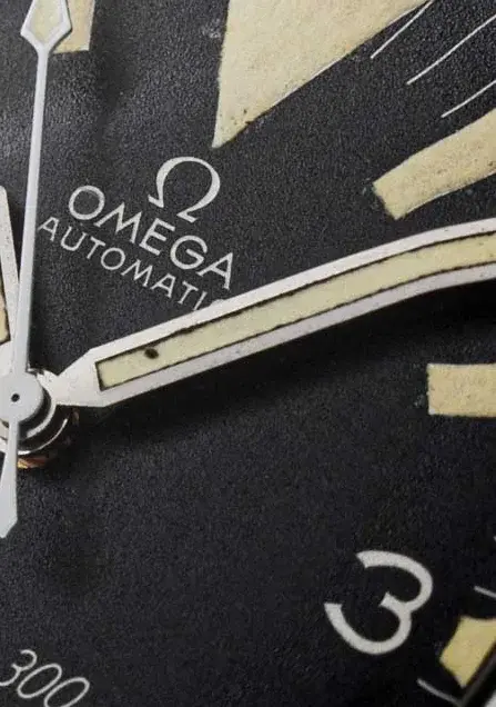

I will not eveal to much for potential fakers, but the blue circle ist the best proof.
If you have never seen a dial under 15x magn. you should not judge...

Here it is:

Here's also, posted here a few days ago - a watch variant that looks the same as the one being discussed now (dial and caliber combination): https://omegaforums.net/threads/reasonable-asking-price-165-024.179633/#post-2437091

just to complete (for non-gilt versions) : "probably" the dial changed on later versions to the serifs on "3"? here on a BT fom 麓67.
to be discussed 馃槈

I would trust what Kox says.

I have learned something today. I would have thought that the damage that runs under the "300" looked suspicious, but I am glad to learn that is its all legitimate from those who know.

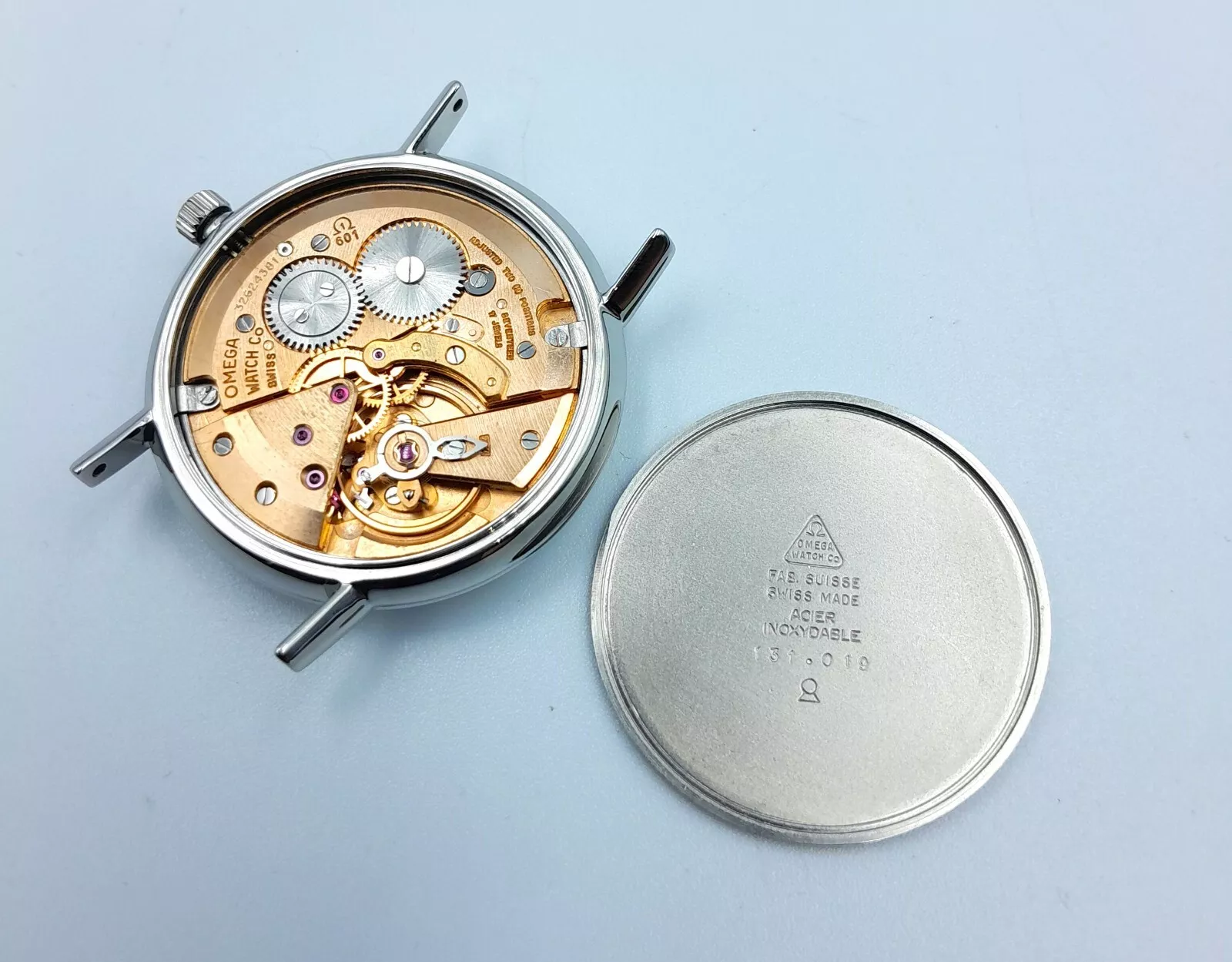

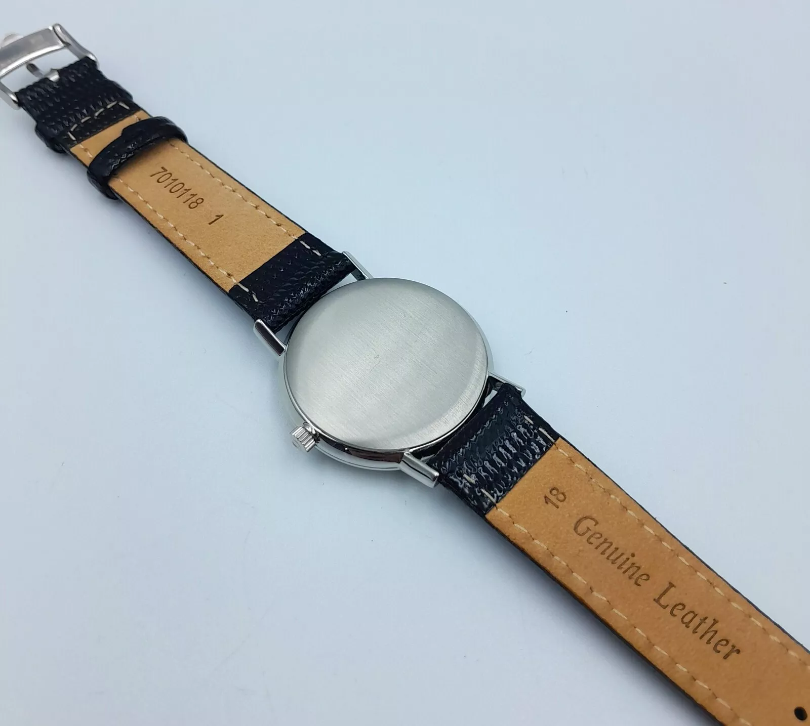

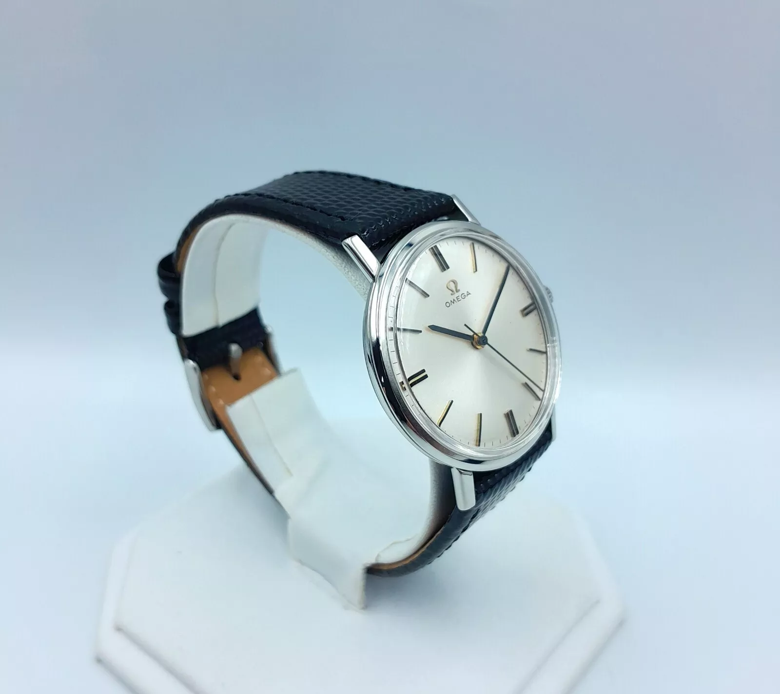

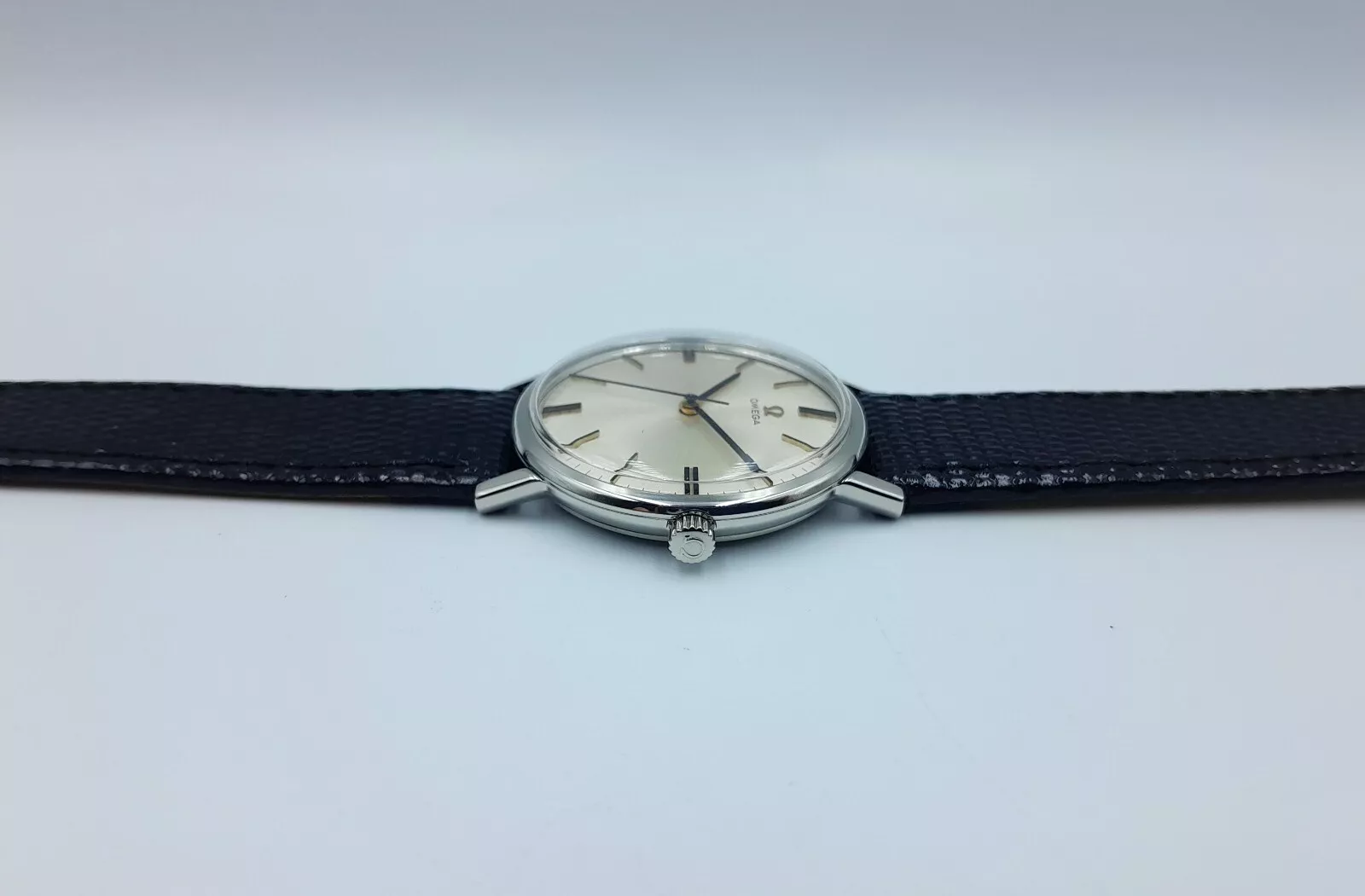

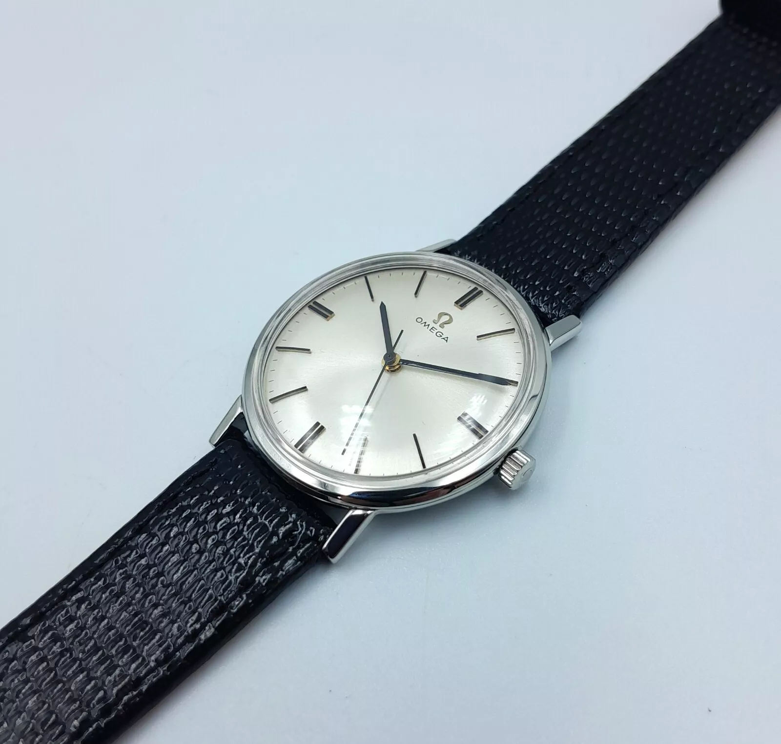

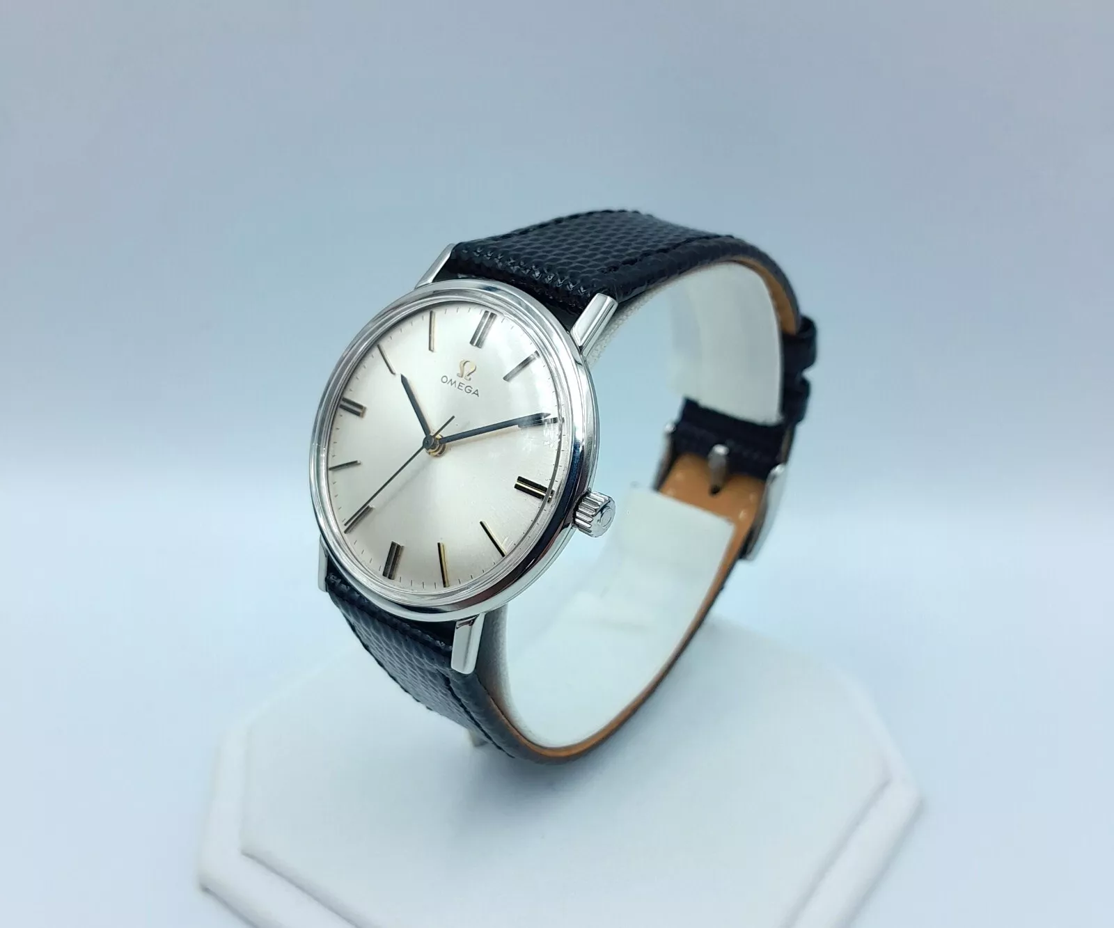

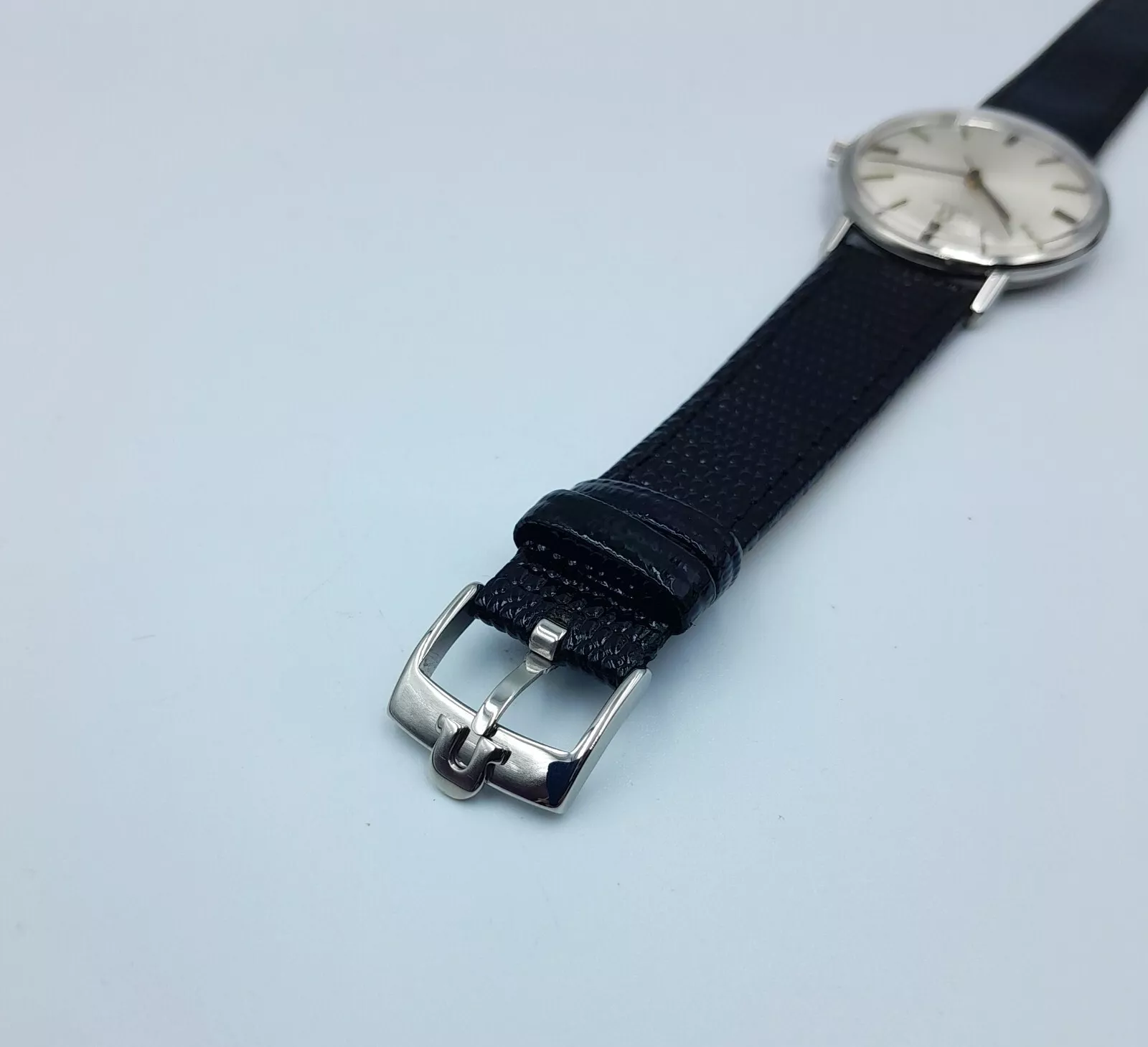

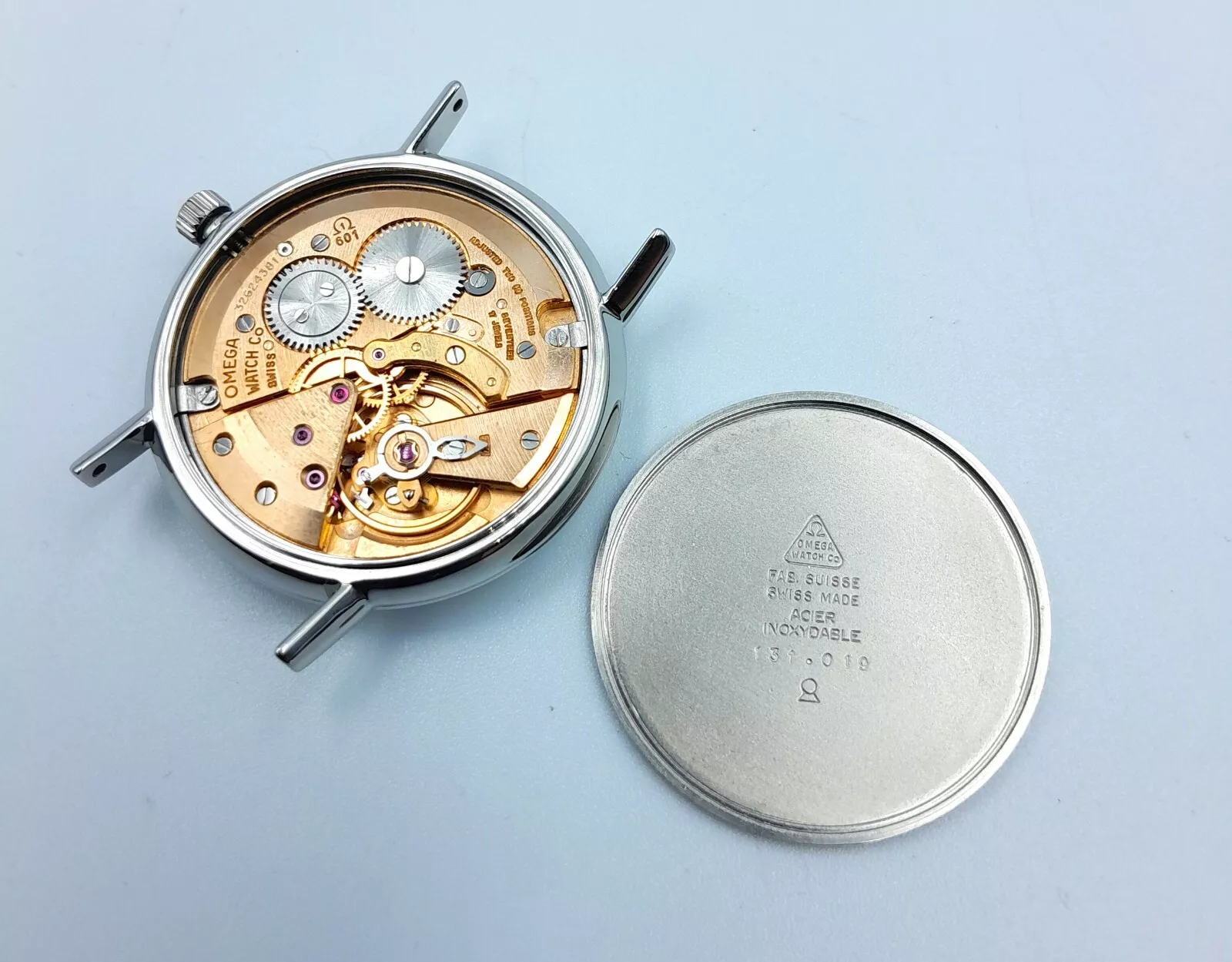

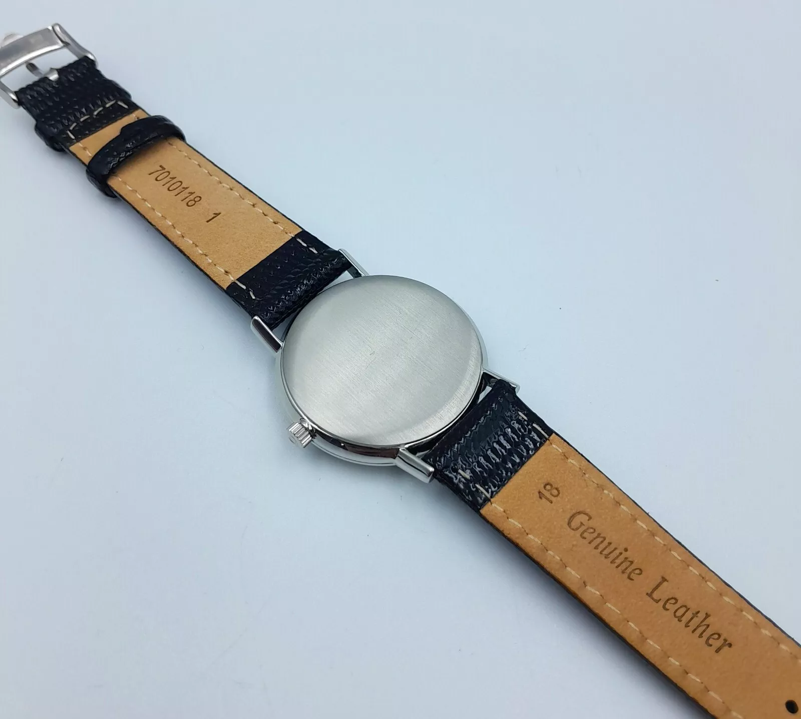

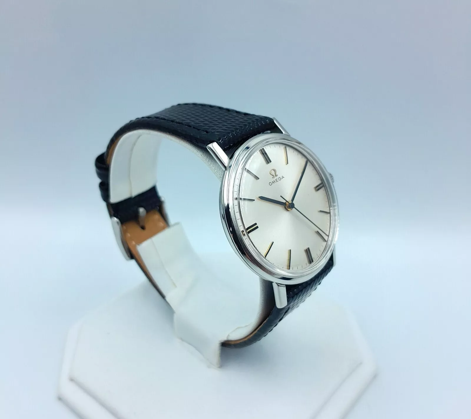

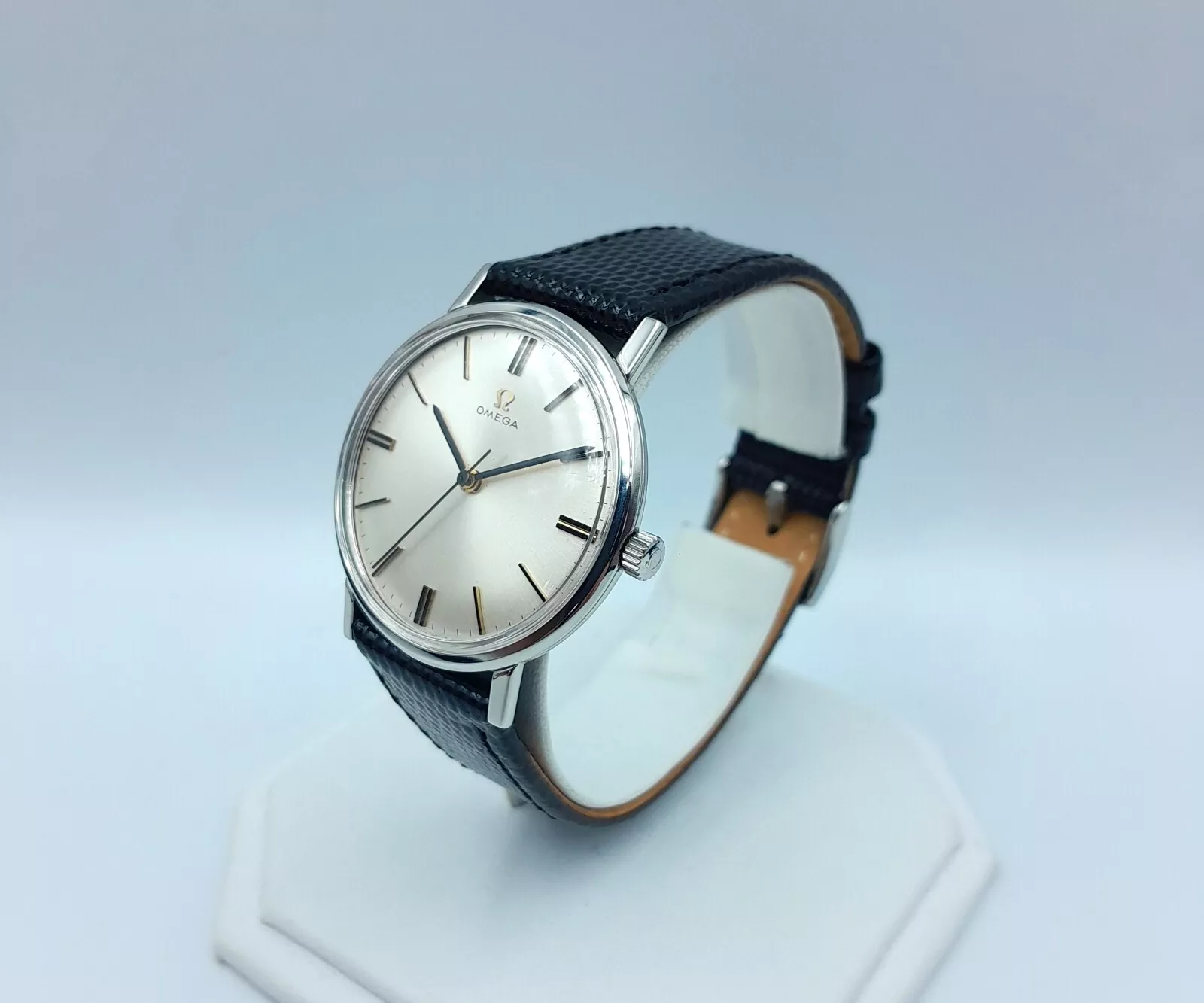

5

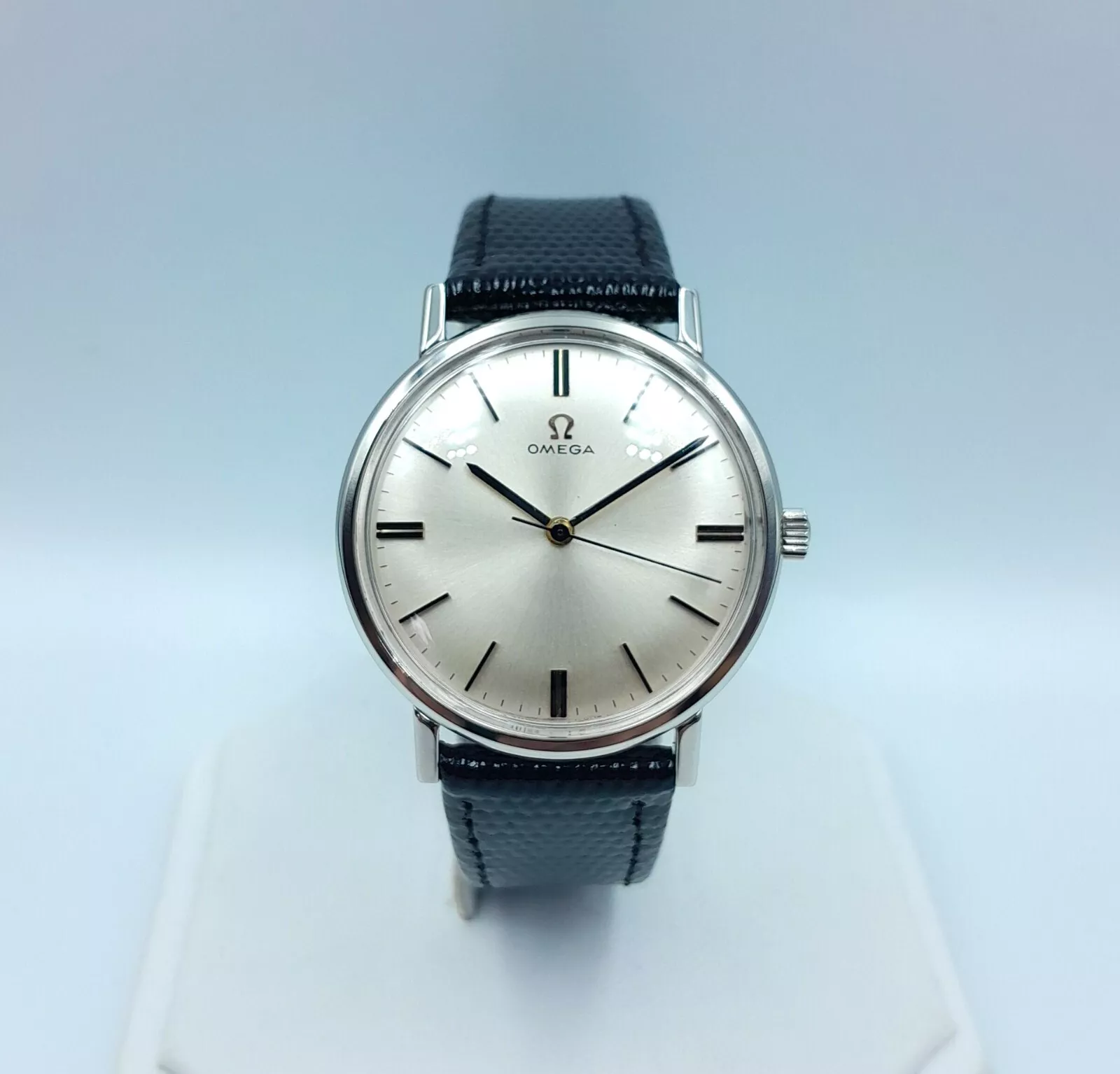

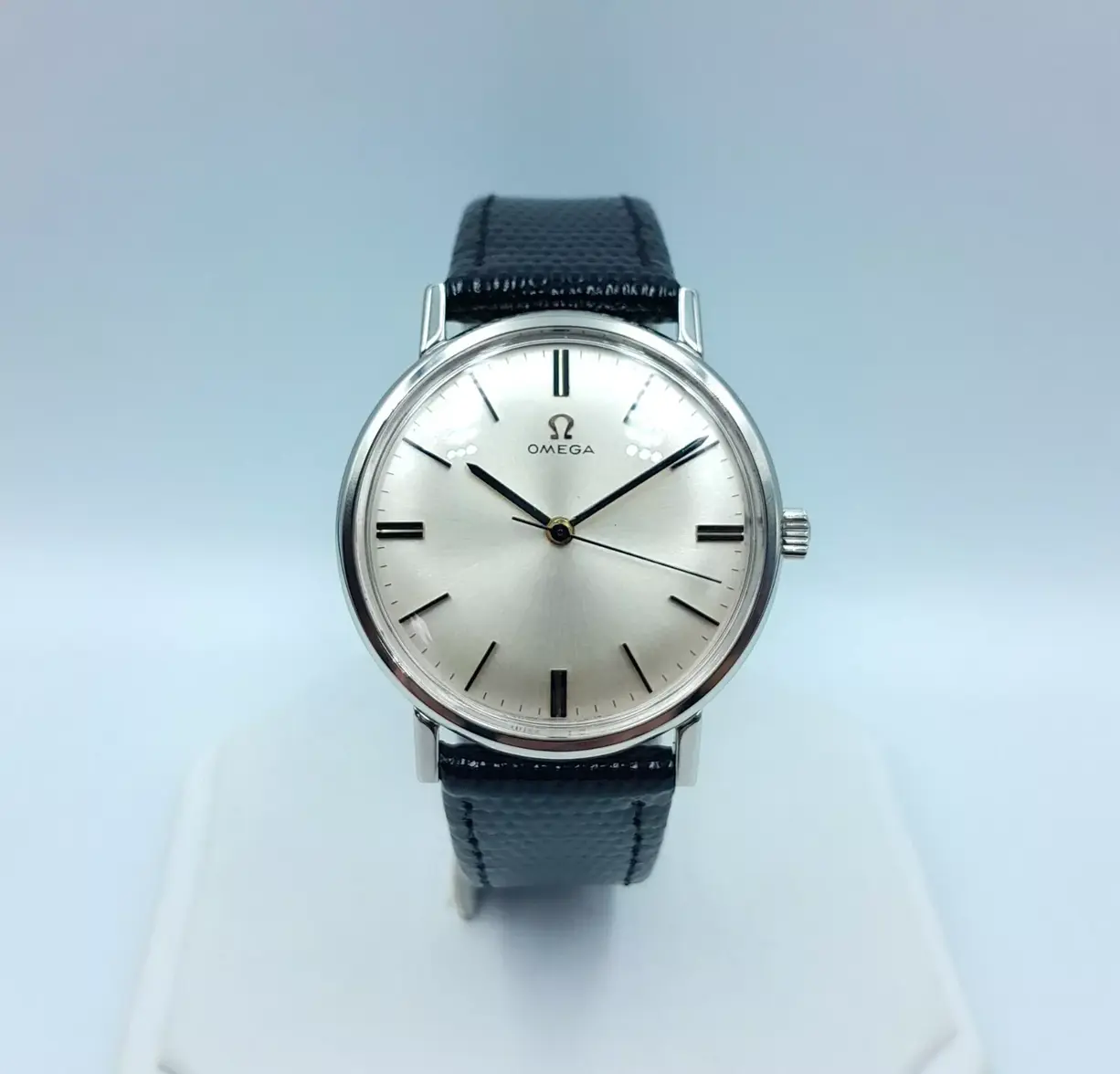

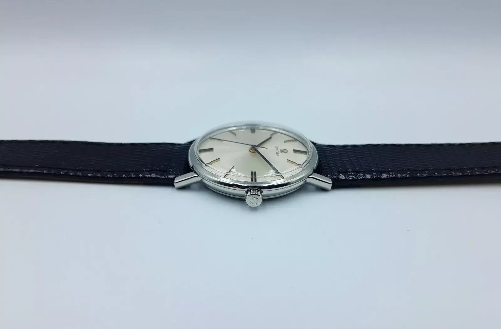

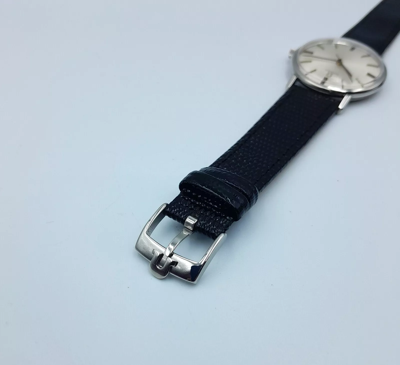

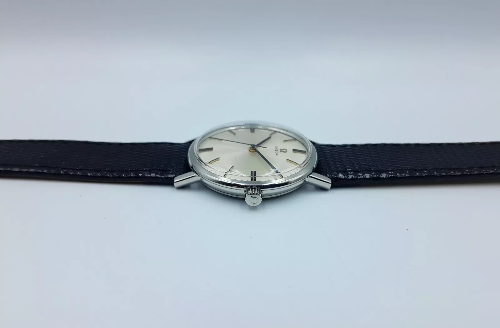

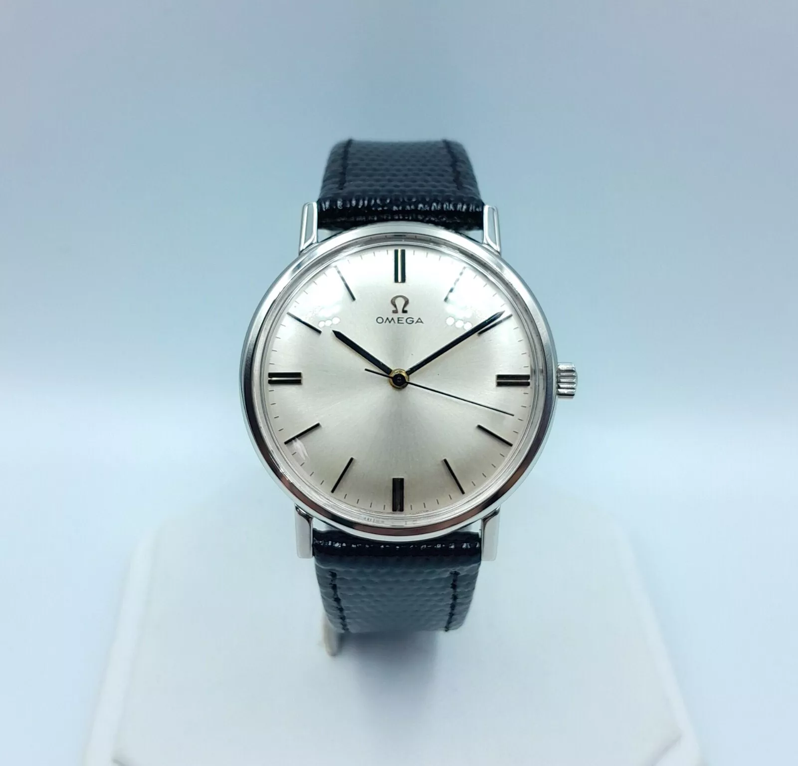

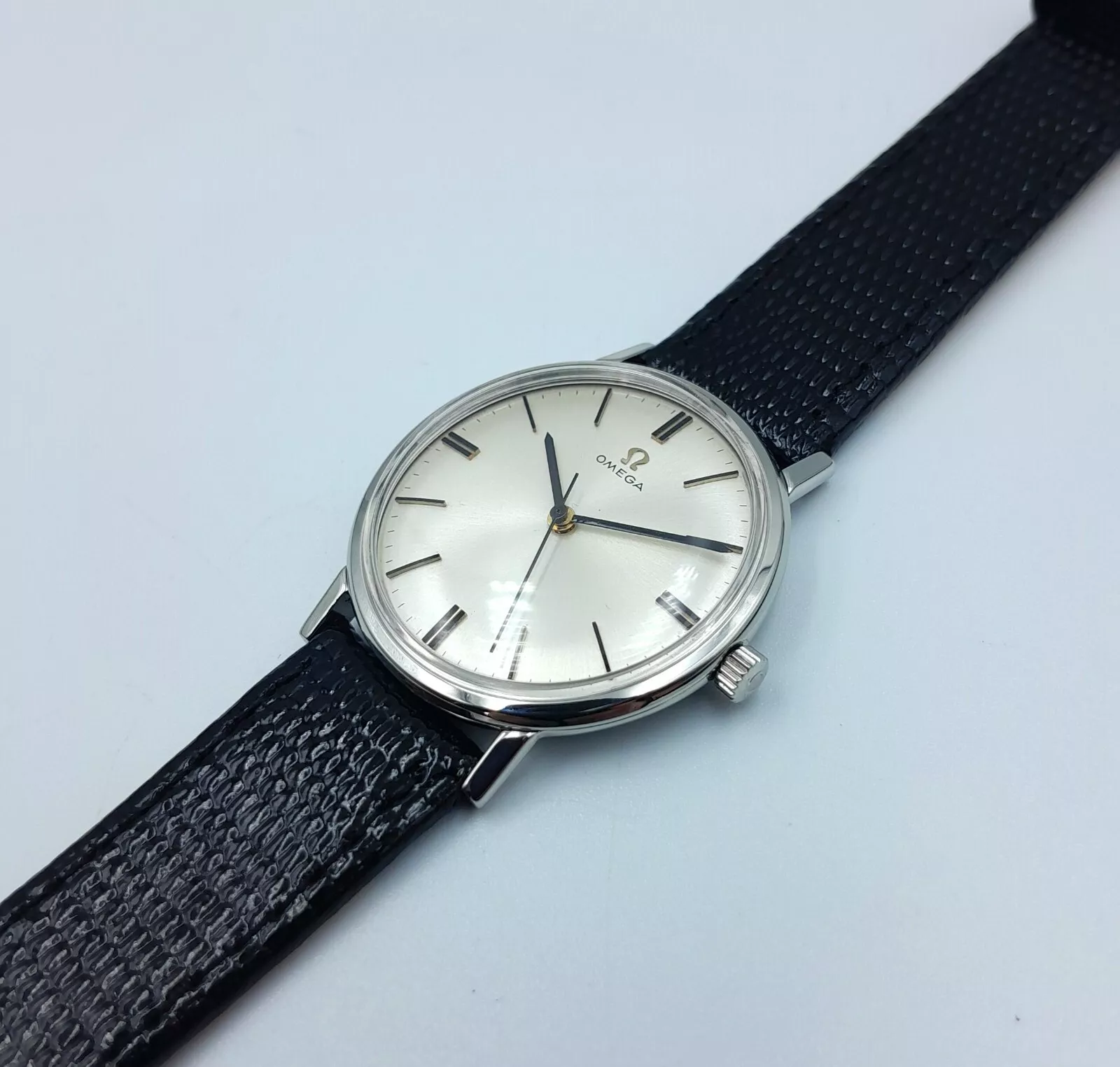

Hello there. I would be most grateful if anybody could give me some feedback on this particular watch. Its advertised as a Geneve, but has no such marking on the watch, nor the swiss made inscription usually found at the six indice. Was there such an original model with black indices and hands? Is the dial original.. Many thanks in advance for what I'm sure is a trivial and all too common enquiry. The watch is listed as - OMEGA Geneve Vintage Manual Steel Gents Watch 131.019 - Year 1970.
