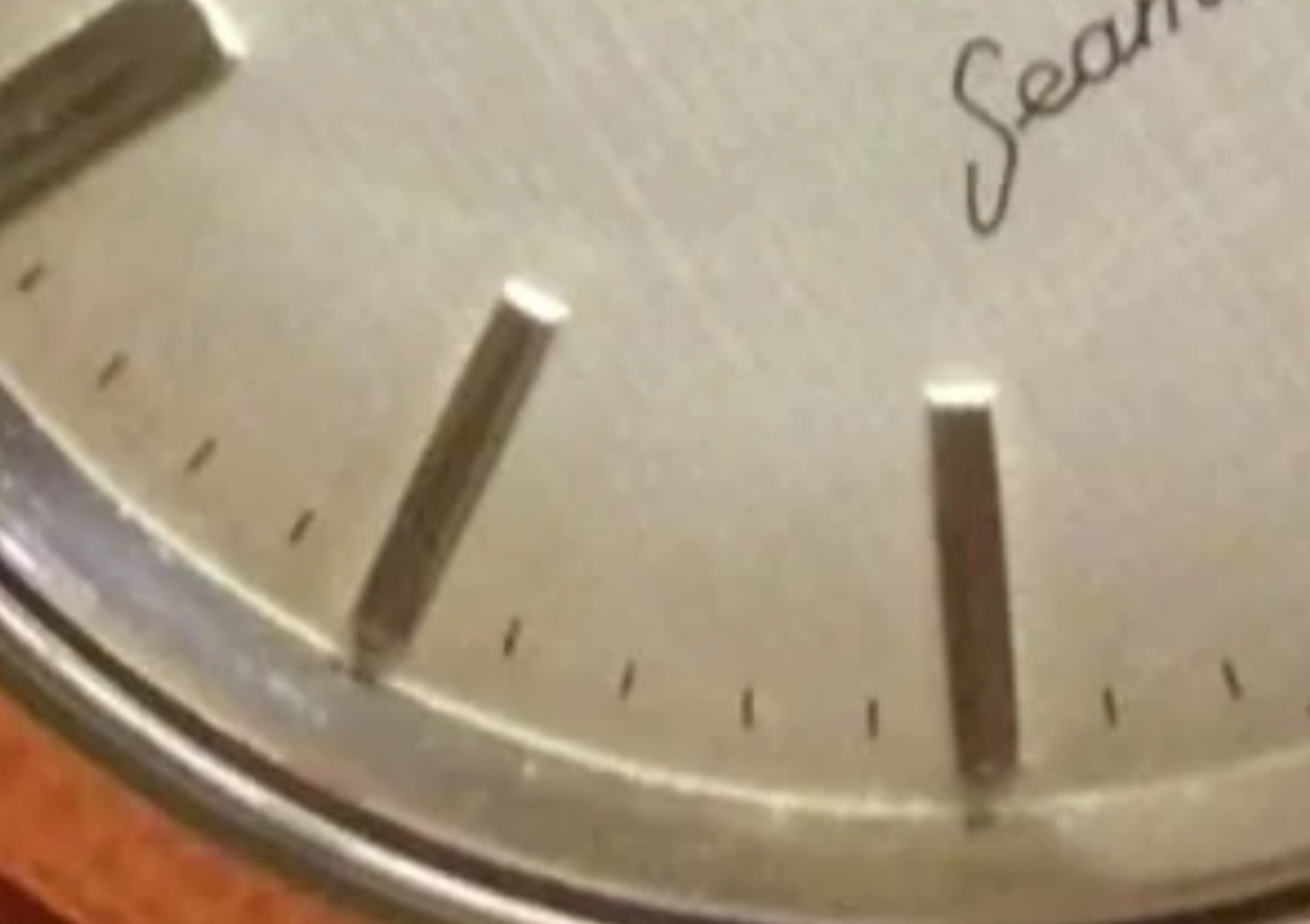

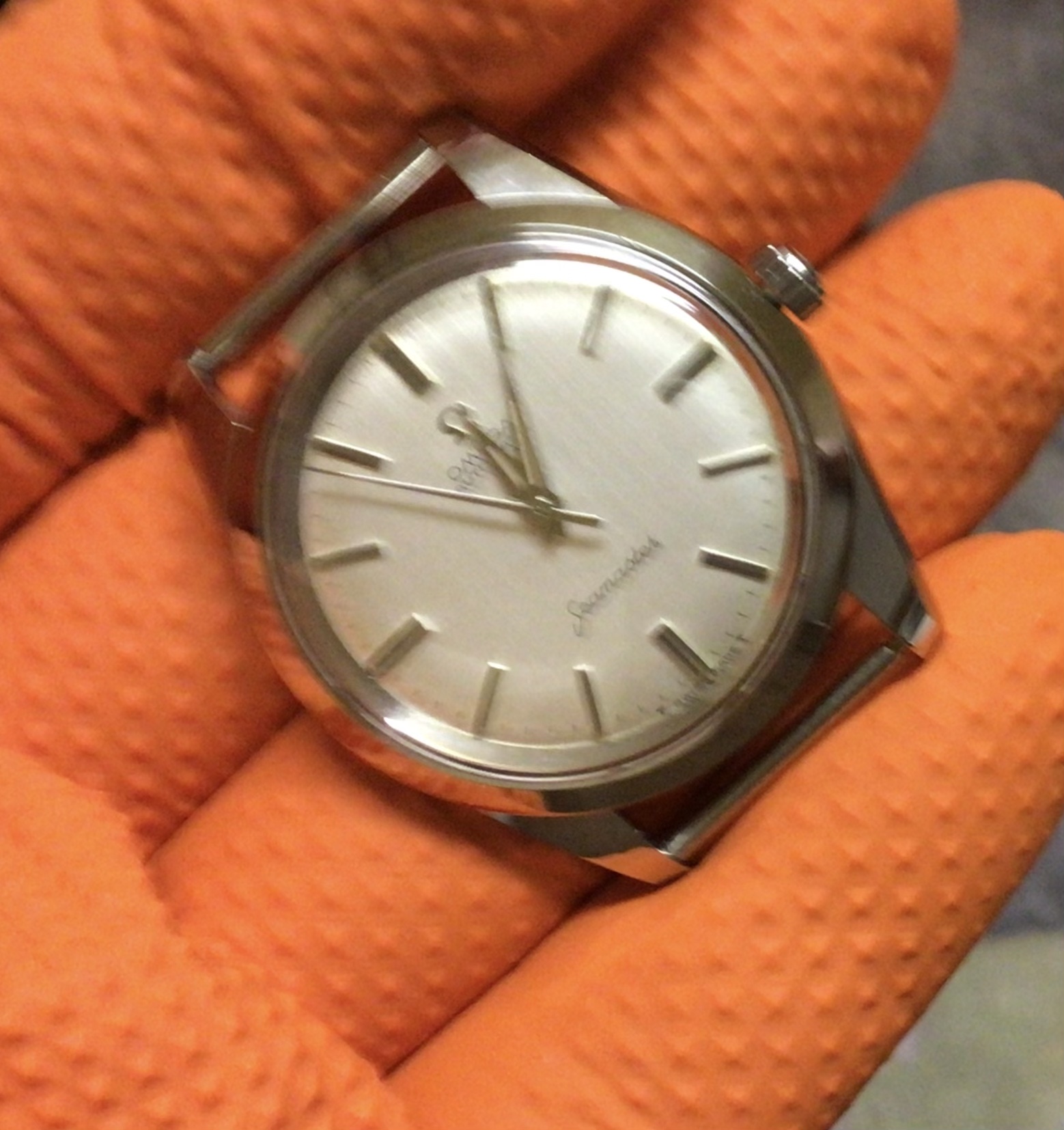

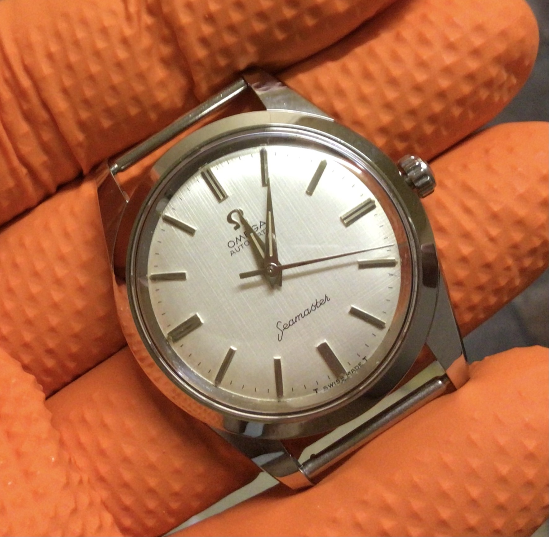

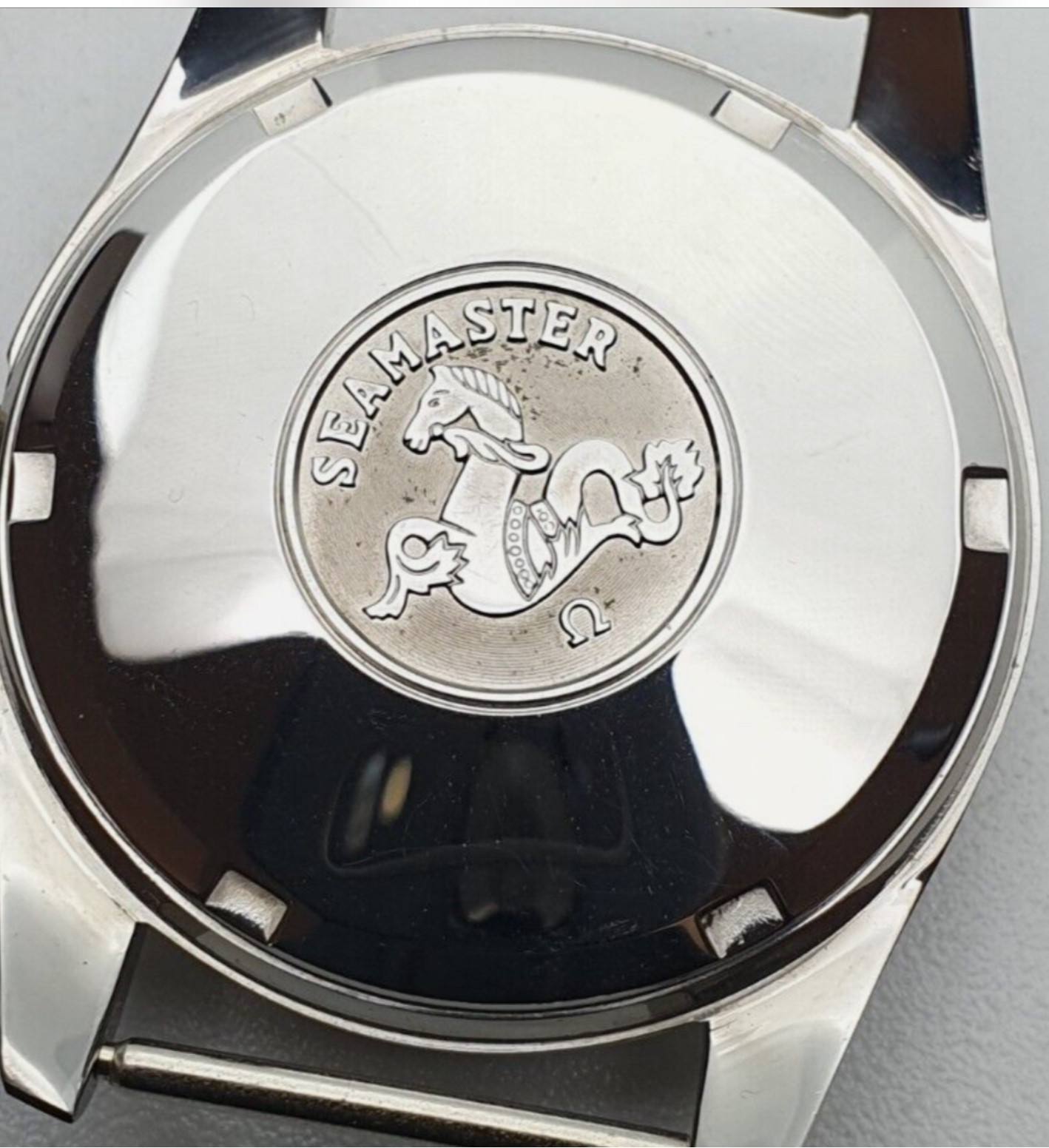

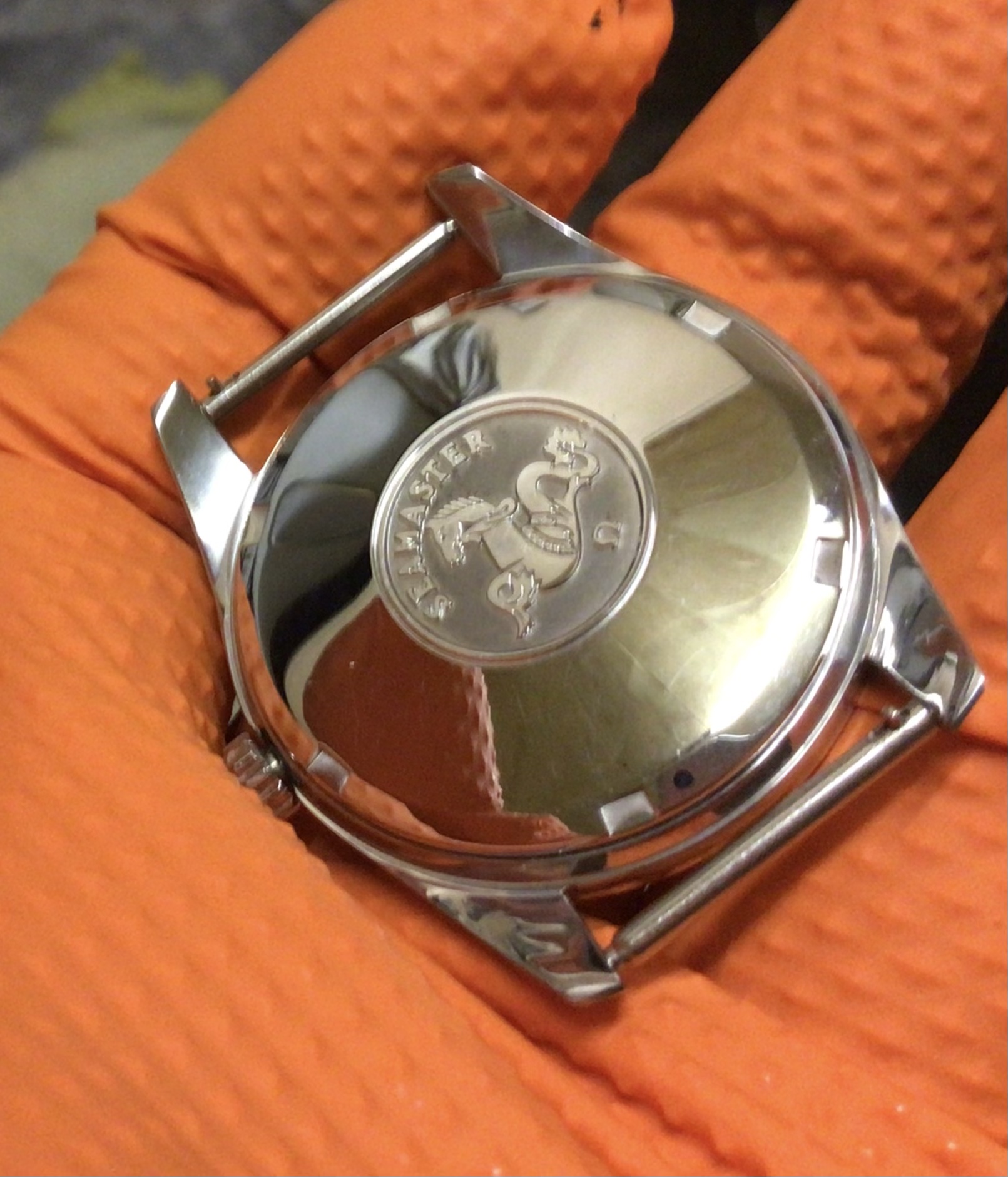

Hello friends,
I got an email from a work colleague doing some cycling training near Lazio Italy and sent me some images of a watch he came across to asking ifI we’re interested to buy, knowing of my fetish with vintage watches especially Omega ! His lodging land lady has recently closed down a small watch and jewellery boutique belonging to her late father( once belonging to his father) and was finalising the estate! Most was all gold and jewellery with a few new old watches of unknown brands! Only one watch was an Omega which was in a box in a safe without a bracelet nor band attached to it, but both omega bands and bracelets were with the watch together with the factory tag and watch box! The watch appears unworn from the phone photos he sent! He is not very savvy with watches so these are the best he took where some are blurry ! What are your thoughts and what model would you identify it with ?

Looks nice, possibly a 165.010 or something similar. If you can get it at a fair price, you should probably just buy it and worry about the details later. If there are no warranty papers, then the accessories don't add much value, unfortunately. The story about the boutique closing down might even be true, but it is just a story in the end, and when you sell the watch in the future, nobody will care. After you wear it a few times, it won't be unworn any more. So just think of it as a vintage Seamaster in excellent condition, with a less common linen dial.
3,243
6,798
Regarding the 1st picture I would agree and judge as 95+ %.
I always wonder, why people ( seller?) take pictures of watches this way.....and ask for a judgement or a fair price.
Did he ride a bike while taking the picture? 😂

In this case the term “safe queen” was not used by the seller nor my colleague who sent me the pictures! As I I have seen this term used quite frequently on other forums over the years by those using it to describe a near mint hardly used pieces , I have paraphrased it in my enquiry of the post, I should have asked if the time piece appears like new old stock and what reference it may possibly be! However, I do agree with what you are implying
He sent me more photos from his phone but some did not come through ! There were some vintage nice Lanco, 1970’s manual wind Zenith in original box and others that I am unfamiliar with! I do agree that the real attraction is the less common linen dial in a near mint case! As to what a fair price would be is upto how much they are in demand, When. considering that they do not come like this every day especially in that combination regardless of warranty papers is really upto how much people are willing to pay! He did say that they are open to best offer. Your comment “ Buy now and worry about details later” is a fair one as I wished I had done this with other never again finds!

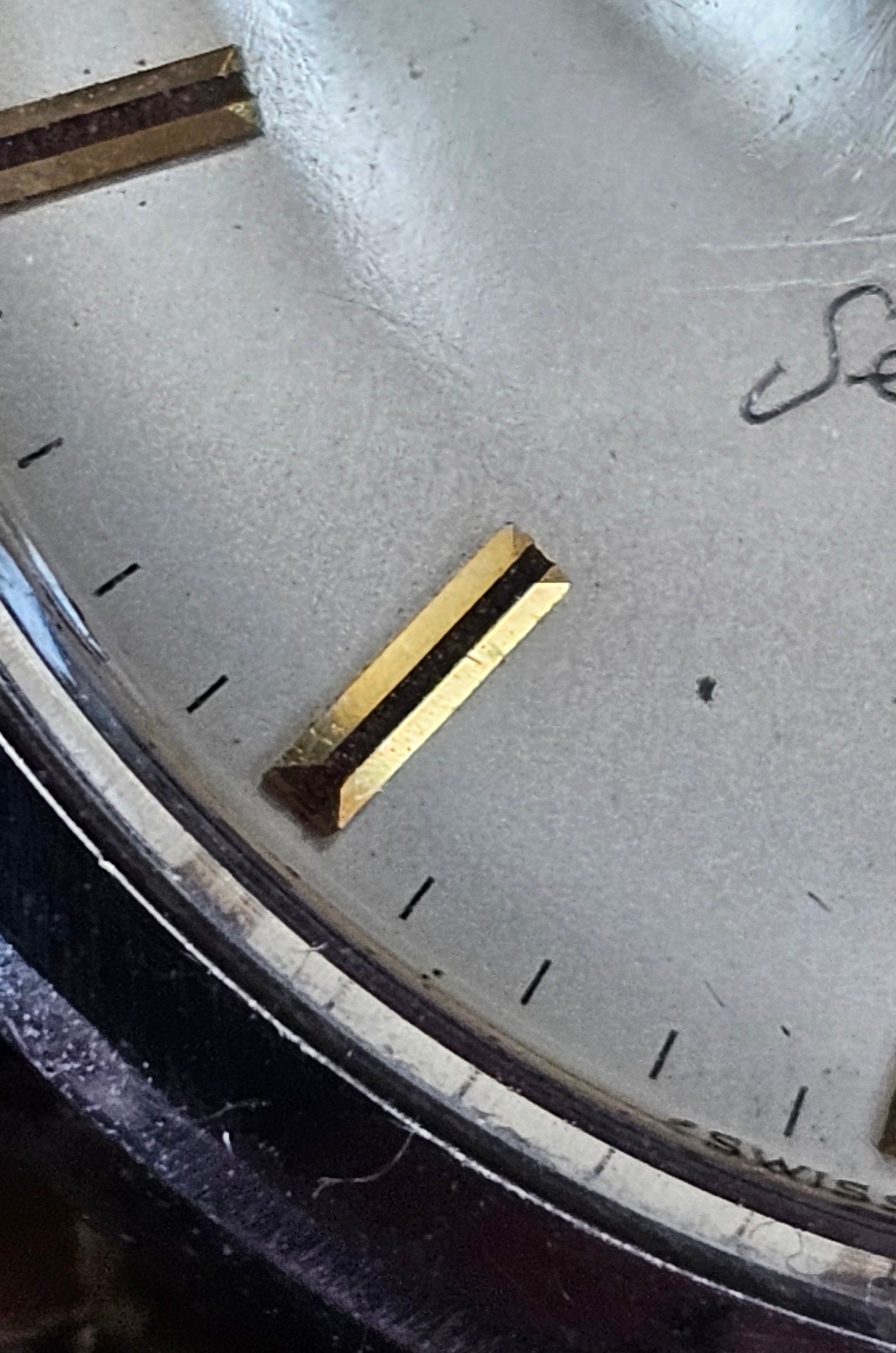

Coat hanger S going with T Swiss Made T is a red flag to me.
Second hand is generic, not Omega original.
10,812
16,817

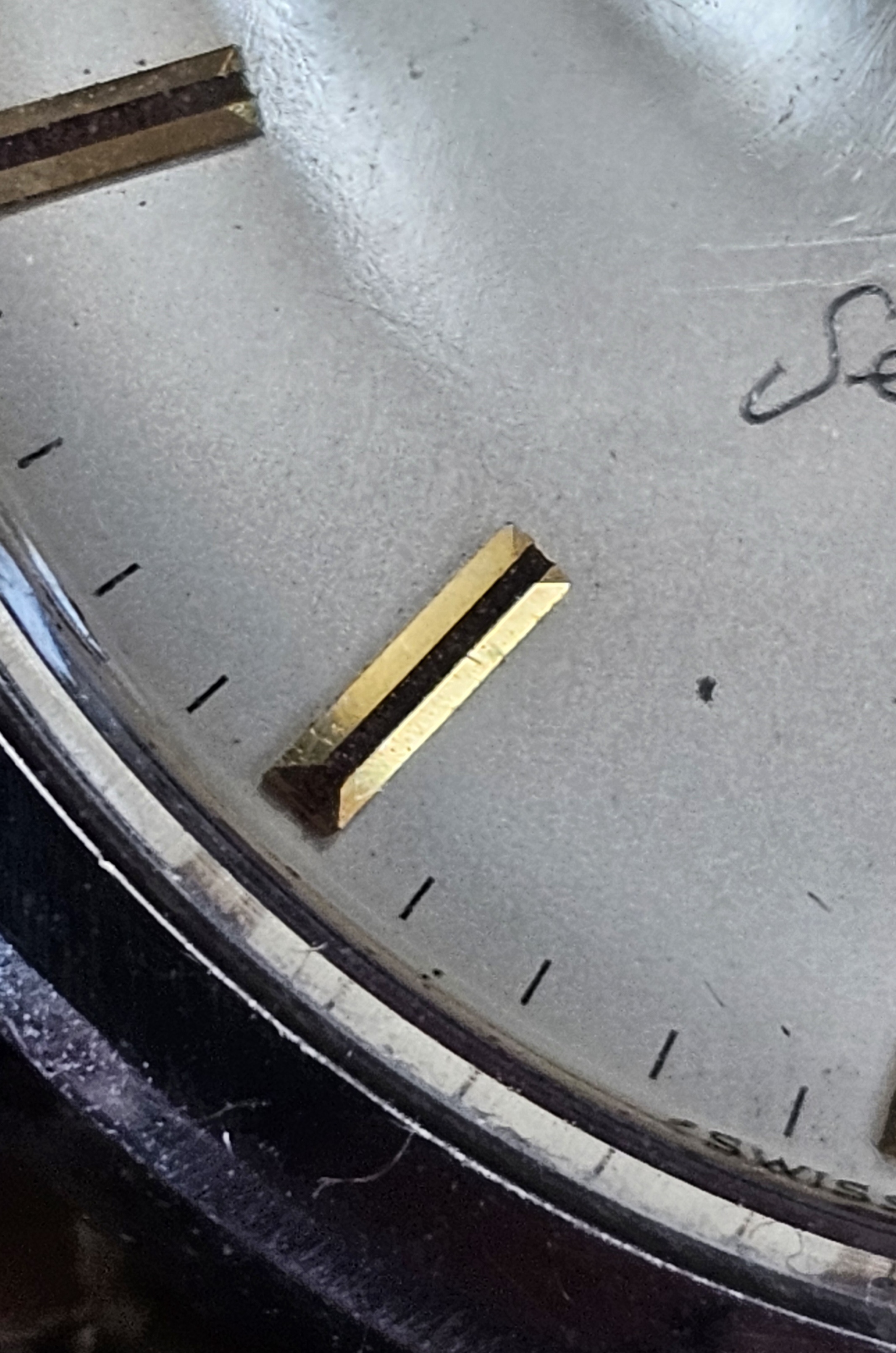

It looks clean and the fonts show no obvious red flags but the Ts are a worry. Unless this watch is from circa 1963 when some of the very first Ts were overprinted, that is plain wrong. What is the serial? If it isn't in the 20-21m region or thereabouts something is wrong.

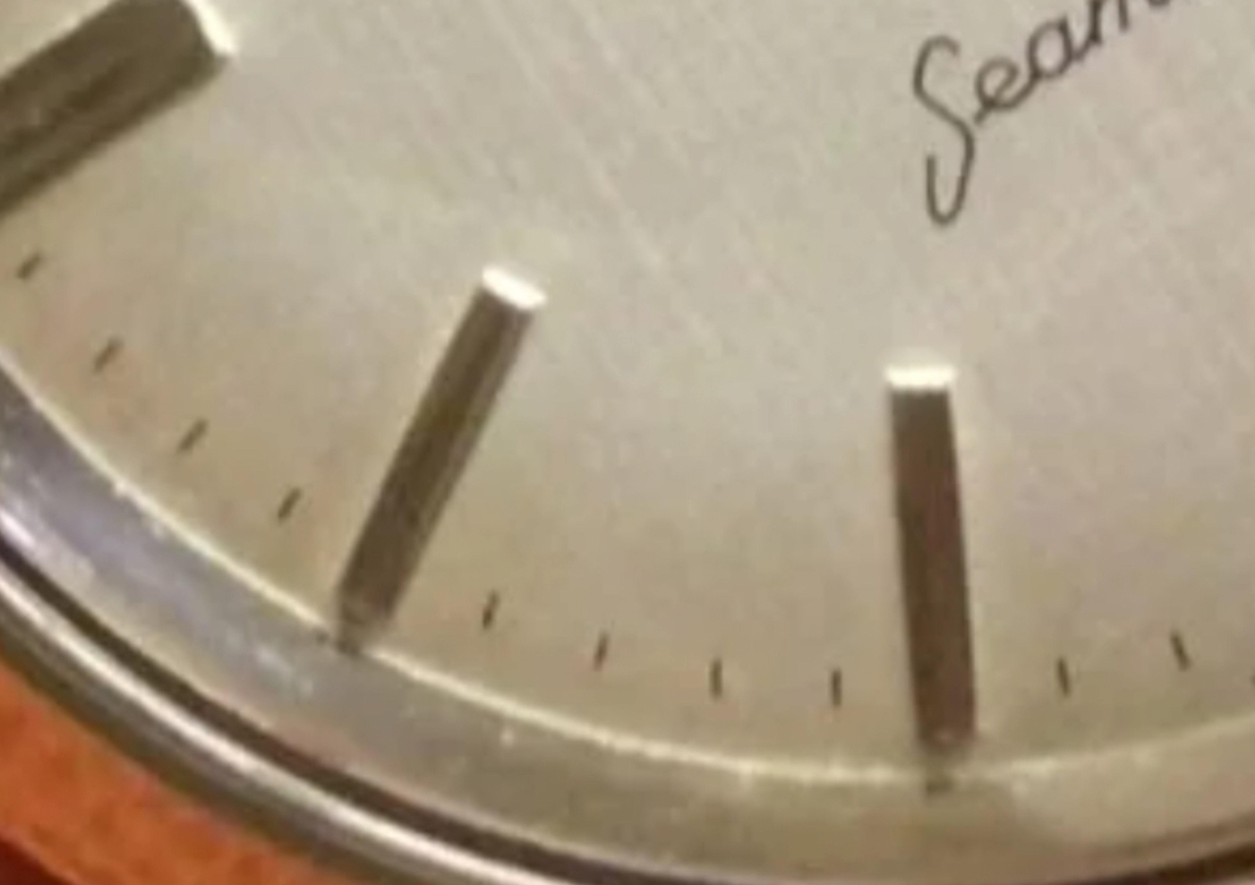

The whole thing looks redialed to me.
Thanks for reaching out!! That was going to be my next question, but refrained as I notice that the batons are different sized on both images, where one has a luminous dot below the long narrow baton and the other baton slightly fatter and shorter is filled with either inox or black paint insert. By that I have seen many dials with the seconds markers slightly away from the dial edge in those contrasting situations !!. Then again, those could have also been re- dials as I am no expert on this topic Is there anything else apart from the "T" s that would point it to a re dial as I know that some re dial companies have refused restoration linen dials in the past based that they were harder to restore.?
Interesting comment!!!n All the other watches from the same batch are all pre 1965 which is consistent with your comment, so I am inclined to believe that it is also pre 1965 as the information I received was that they stopped dealing in watches in the mid 1960's and focused more on gold and jewelry after the first generation owner passed away who was a watchmaker. This watch was the only watch amongst the batch of other watches that had band removed and was in a box with the rest of the accessories like as if it was to fit some personalized order!! Hence, my other theory is that if the dial is still pre 1965, it could have been a special request from the buyer to have some modifications done to it like replace leather band with a bracelet and it may have had baton hands instead of dauphine ones which was the very first red flag for me to post.
Other than that it is a very tempting situation as I got more higher resolution photos which I am trying to upload (unsuccessfully )showing that the case is very sharp and in incredible good condition showing no signs of any wear.
Based on all your help and comments, I am now not as keen on it unless they can accept a much lower offer than I had originally anticipated !!!
I dare to say that I have found in my journey with vintage Omega that there have been many variations of styles and dials mixed and matched, where one can only go by the balance of probabilities of seeing old advertisements featuring what the mainstream would be as un modified.
