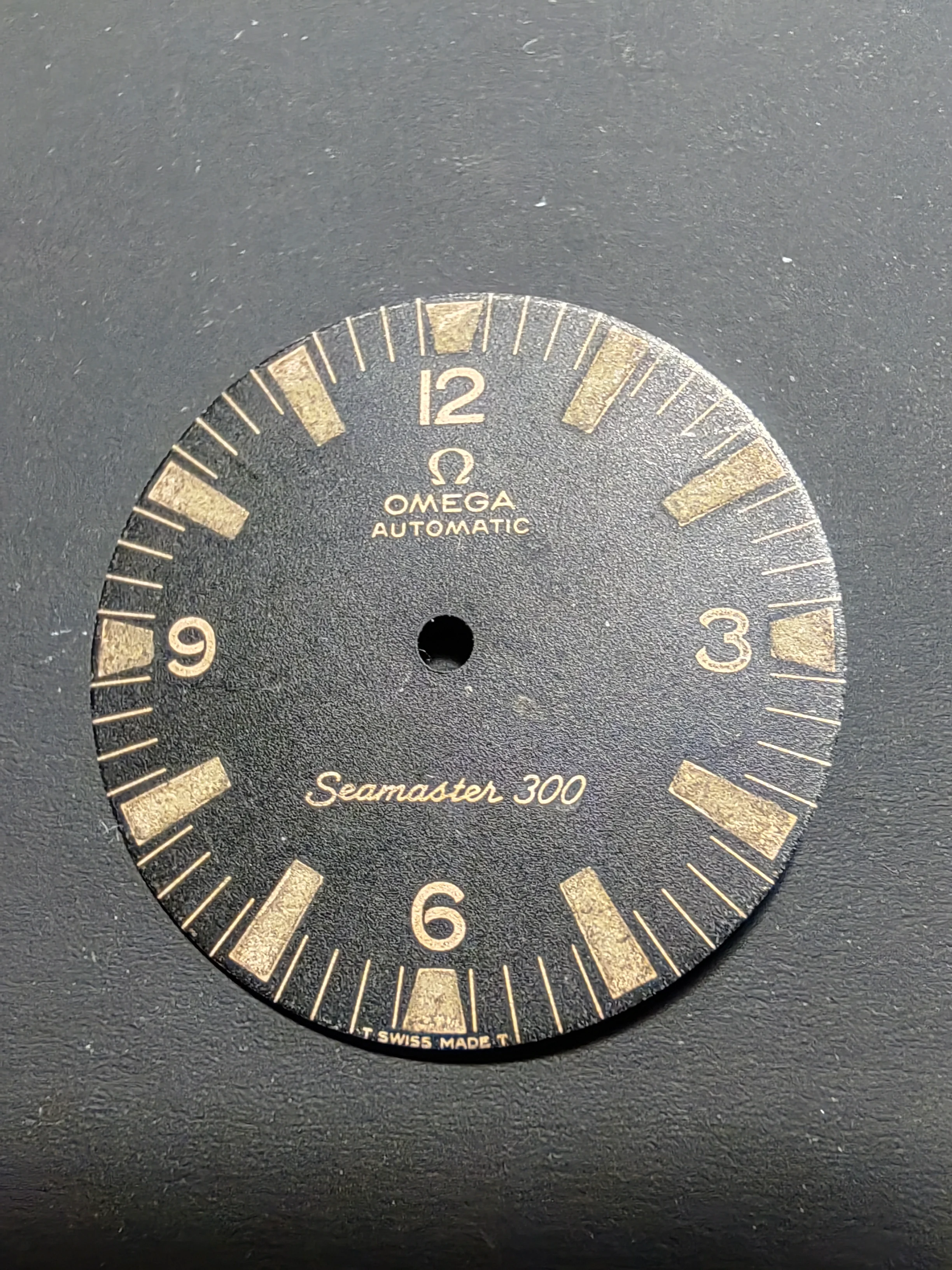

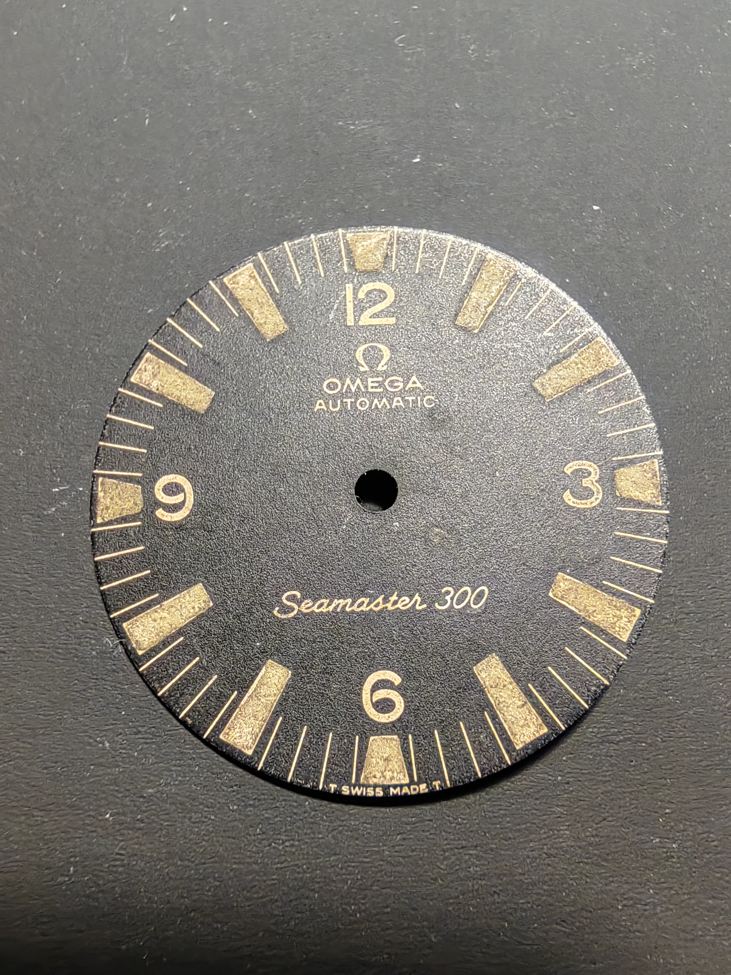

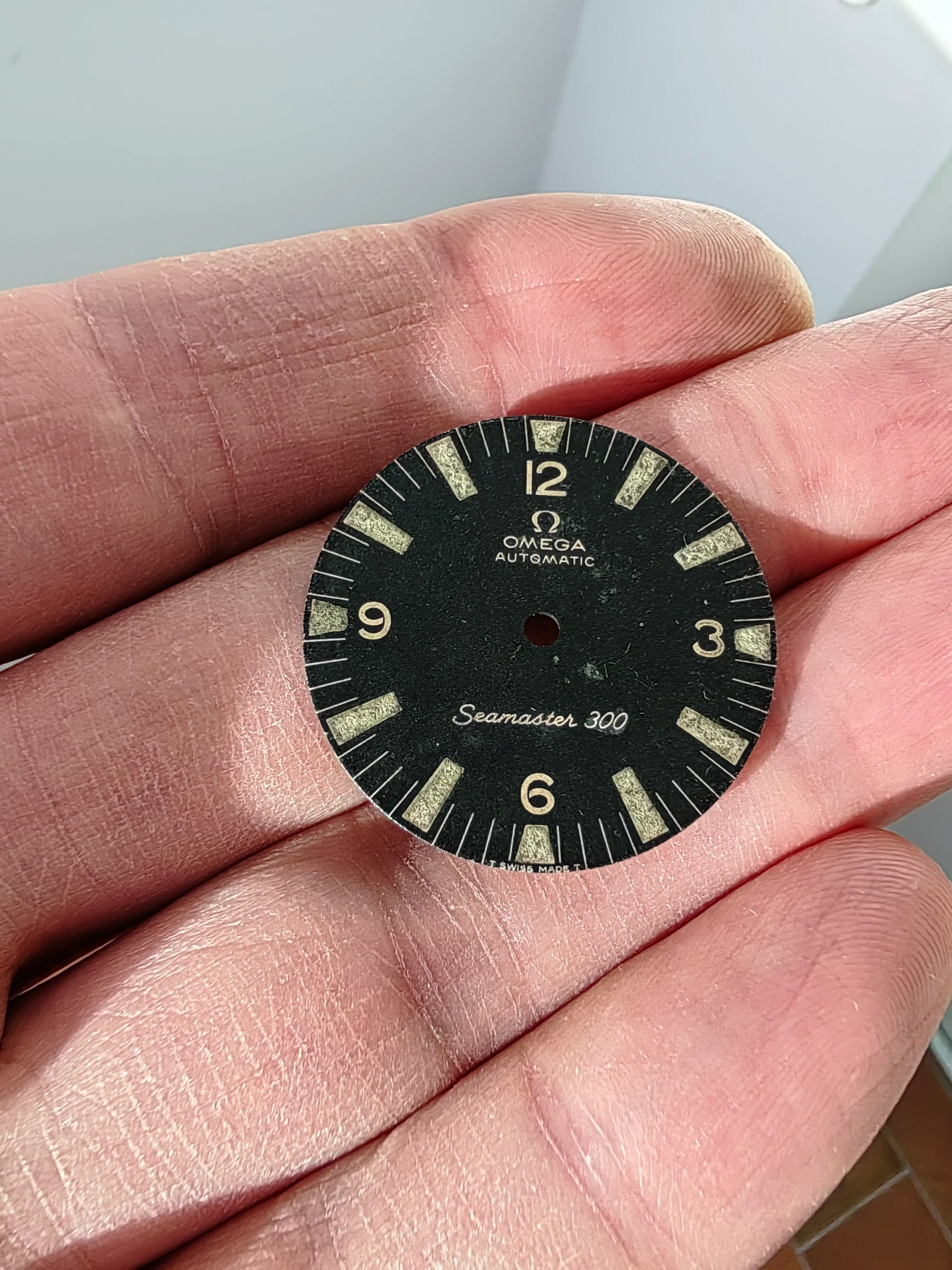

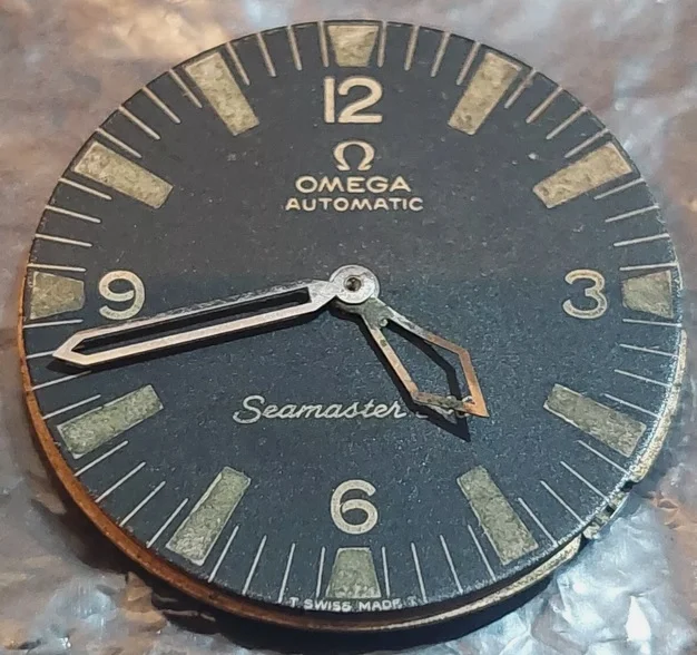

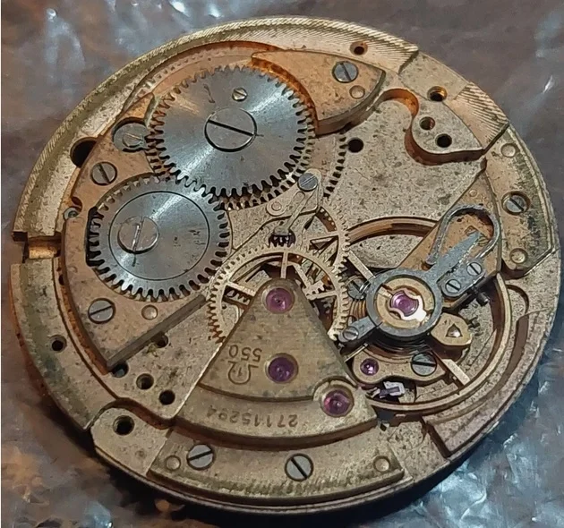

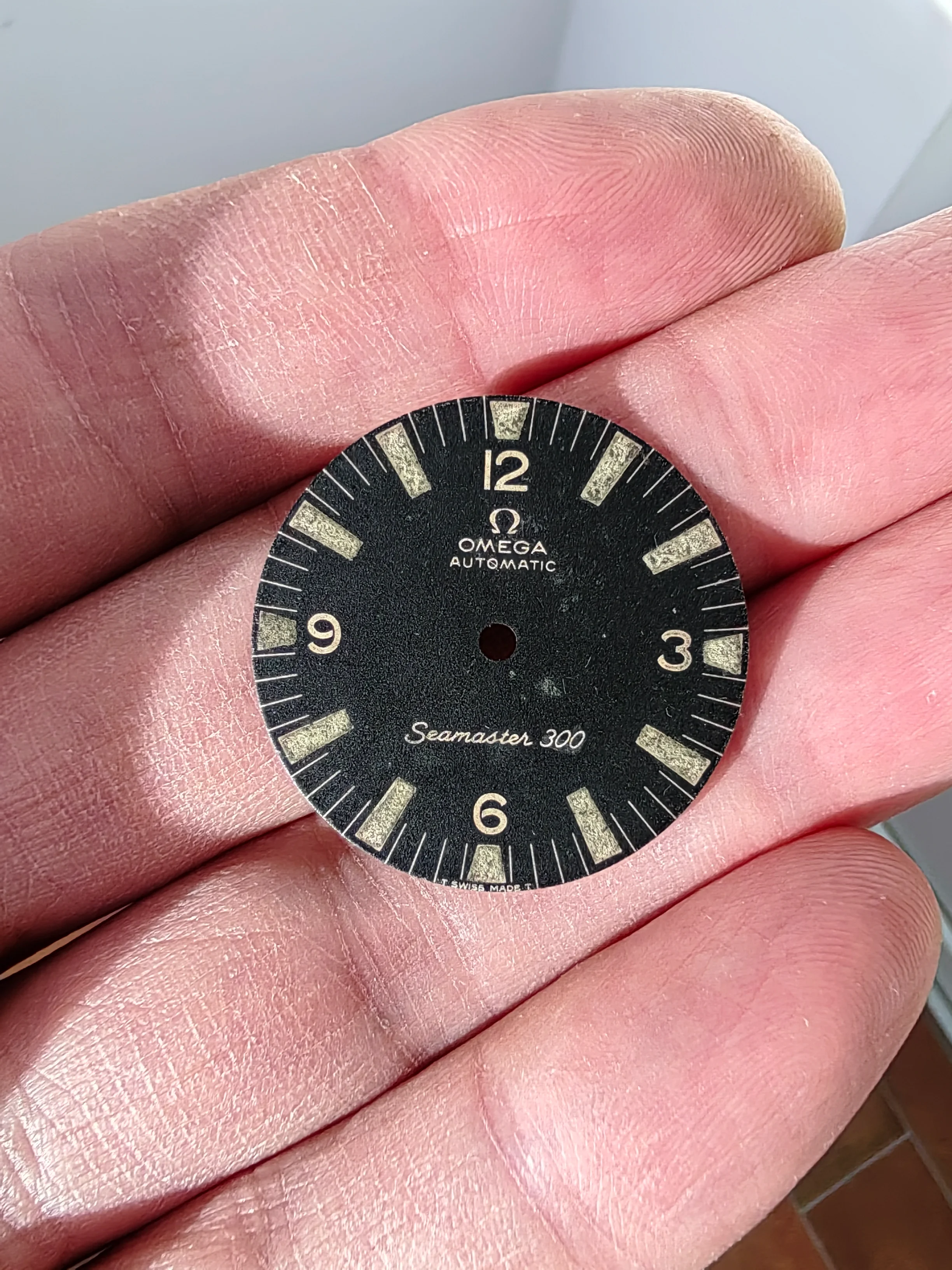

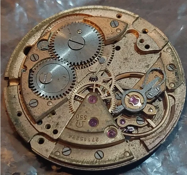

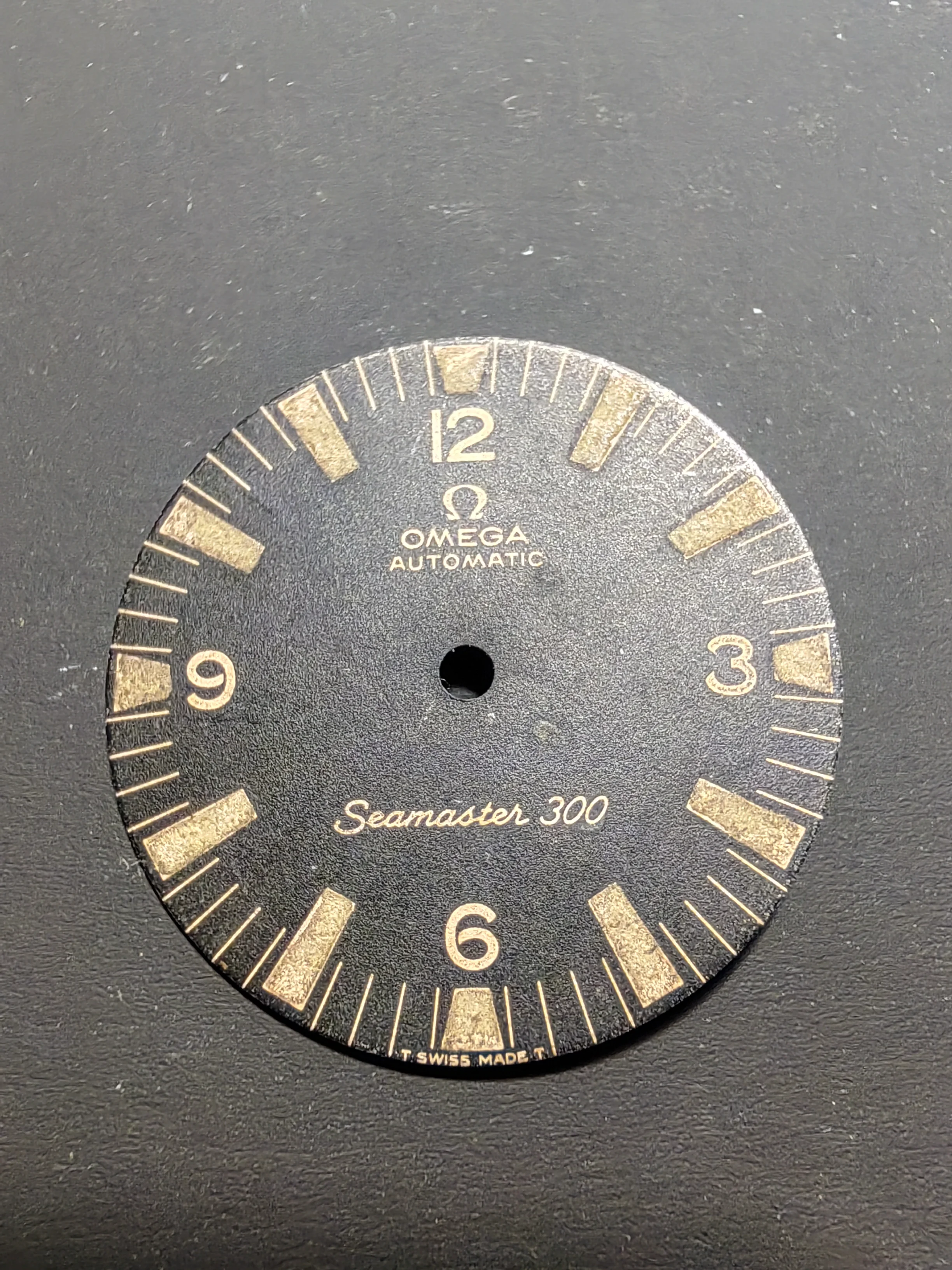

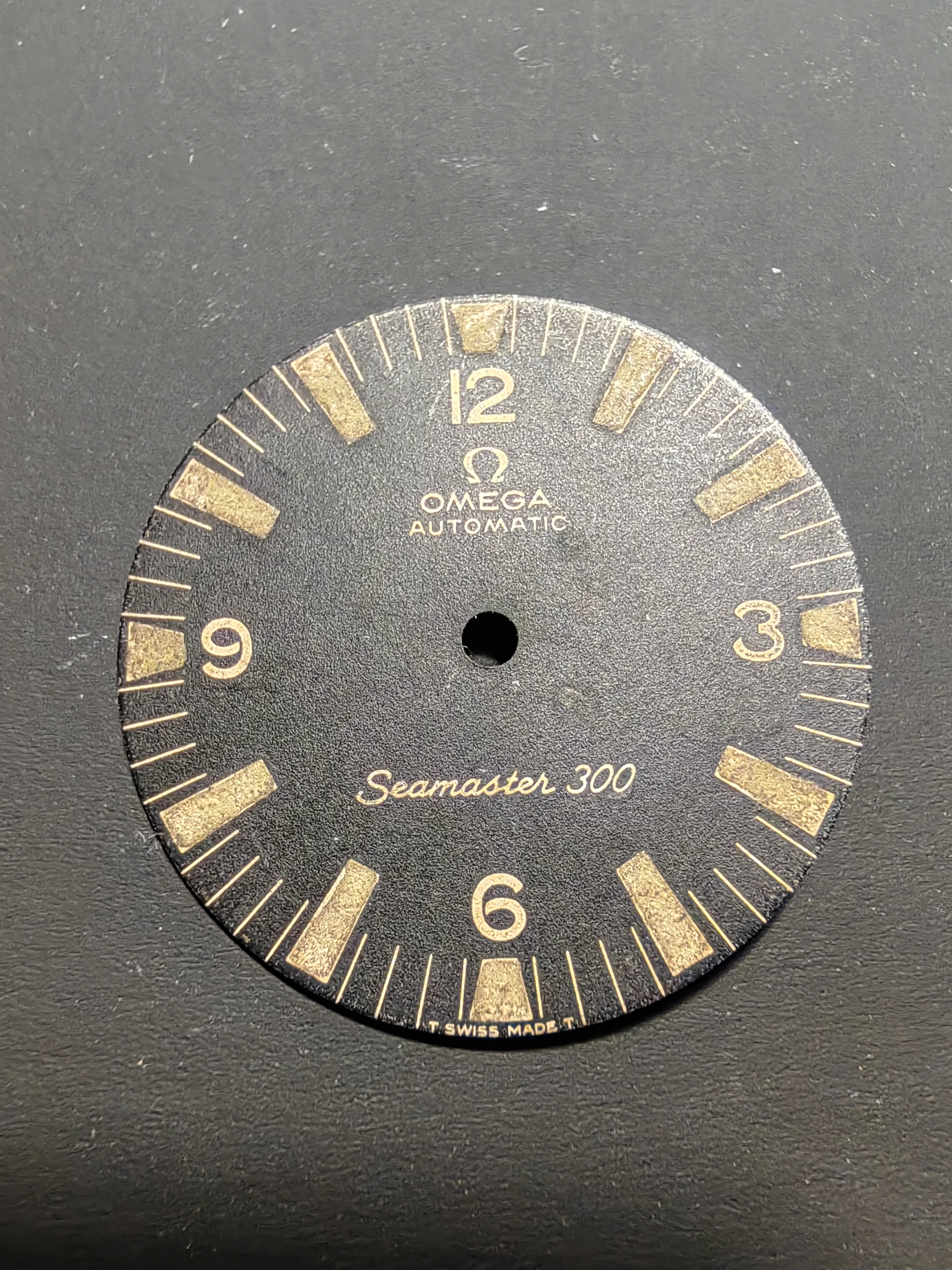

Is this a genuine SM300-set 165.024?
282
64
Please give me your opinion.
I doubt it because of the caliber 550 (not 552 as usual).
308
231
I`m pretty confident, that this set is okay. SN batch 2711 is know to me as US batch, so the cal 550 is a good sign here...
282
64
Thanks for the quick reply. What you mentioned sounds very good.

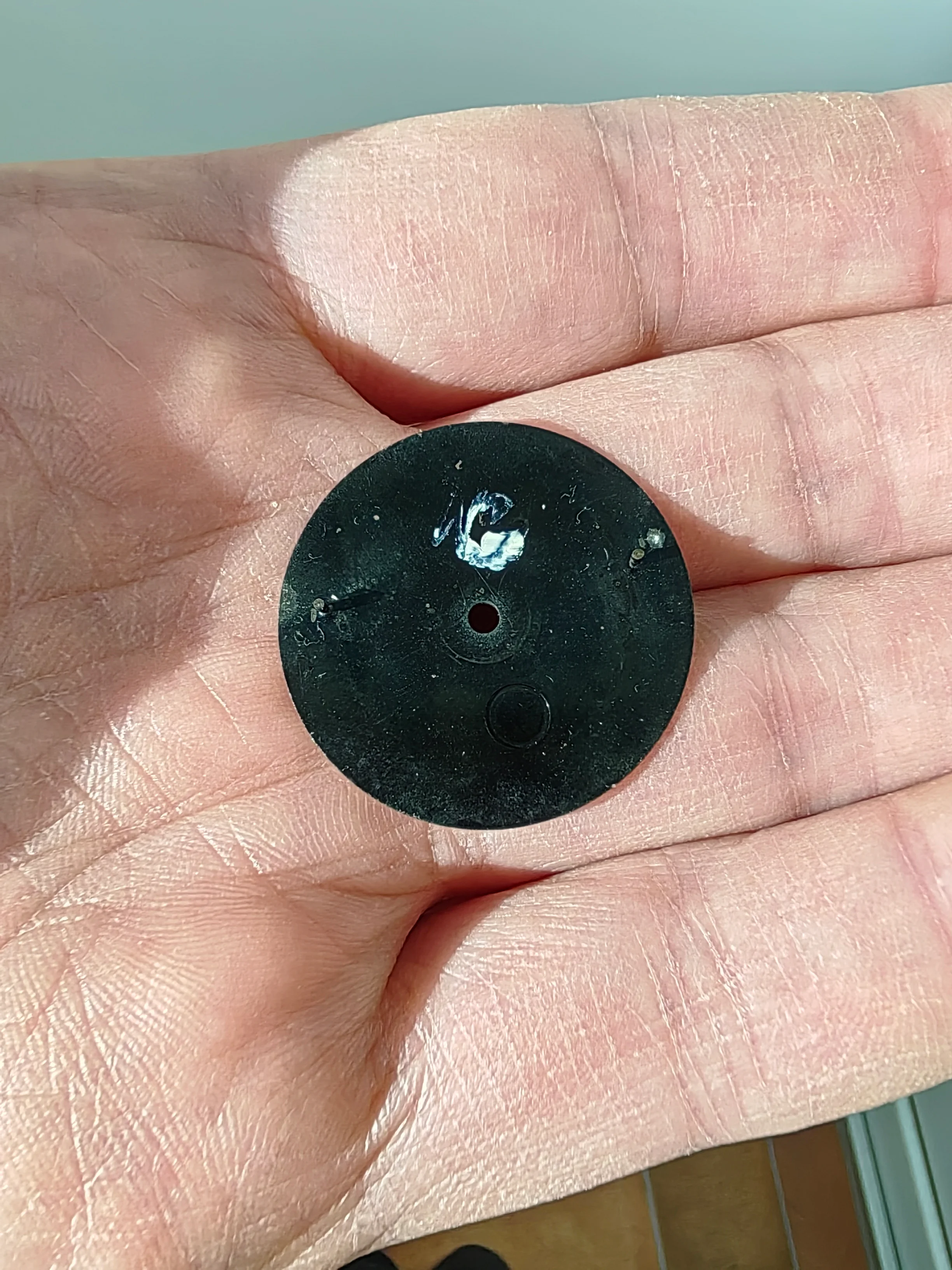

282
64

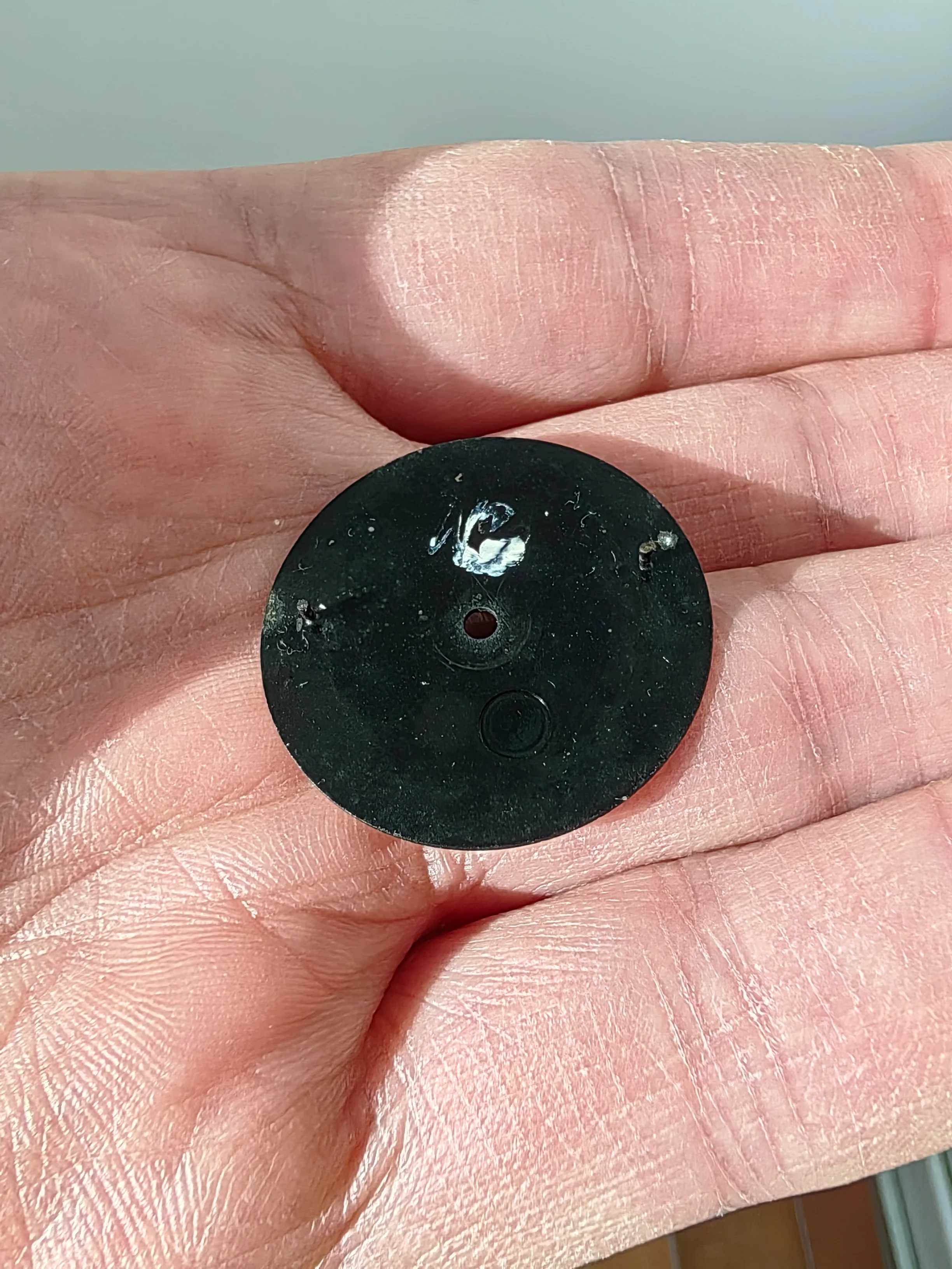

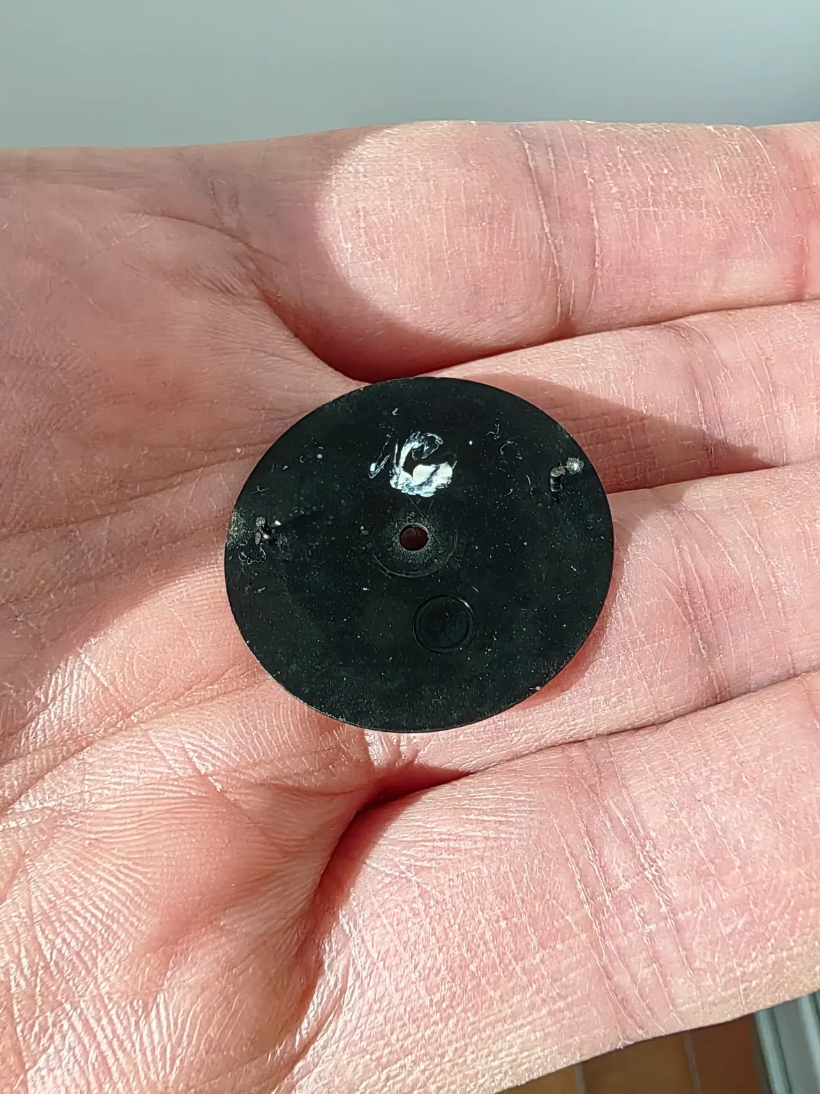

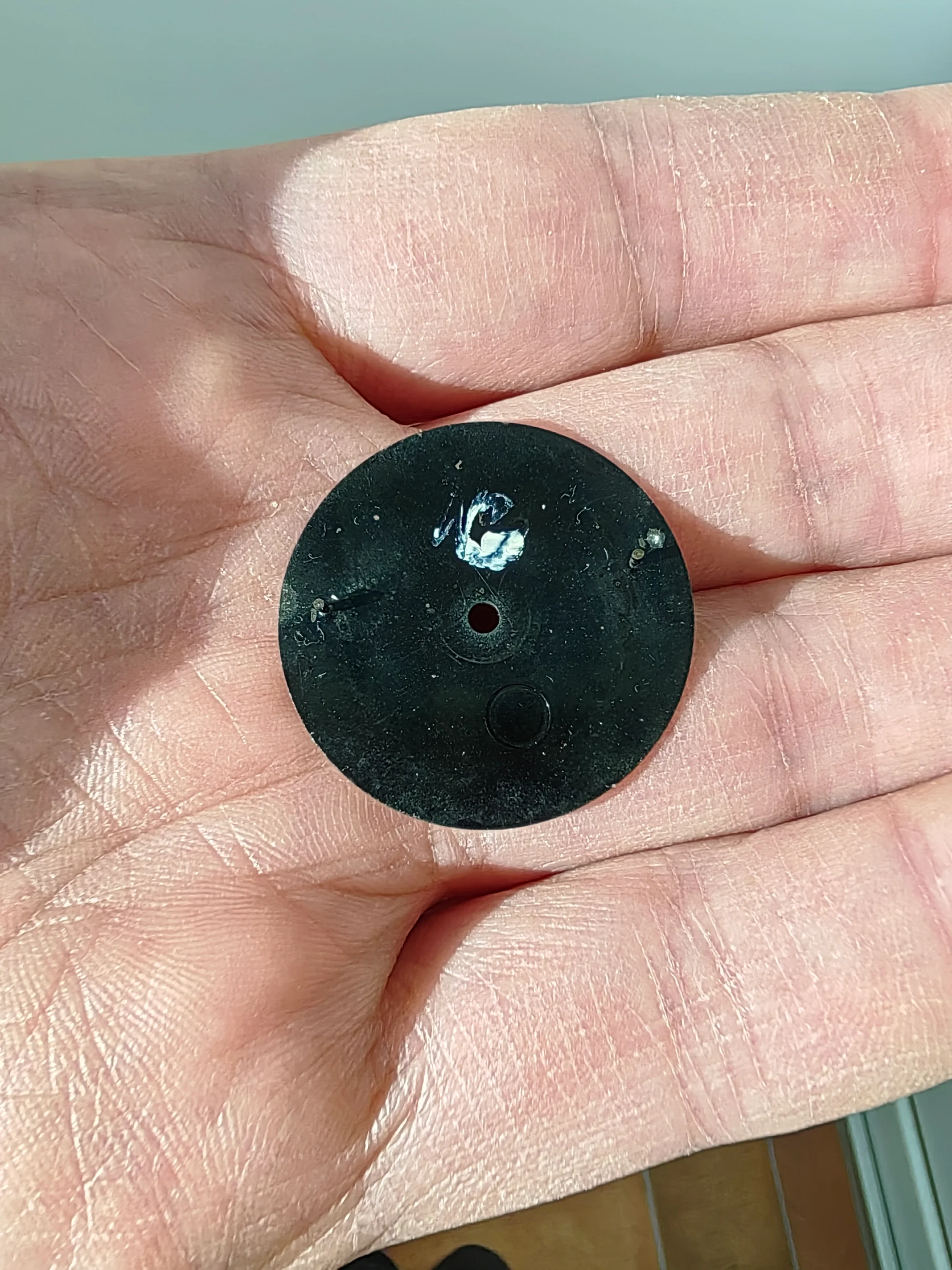

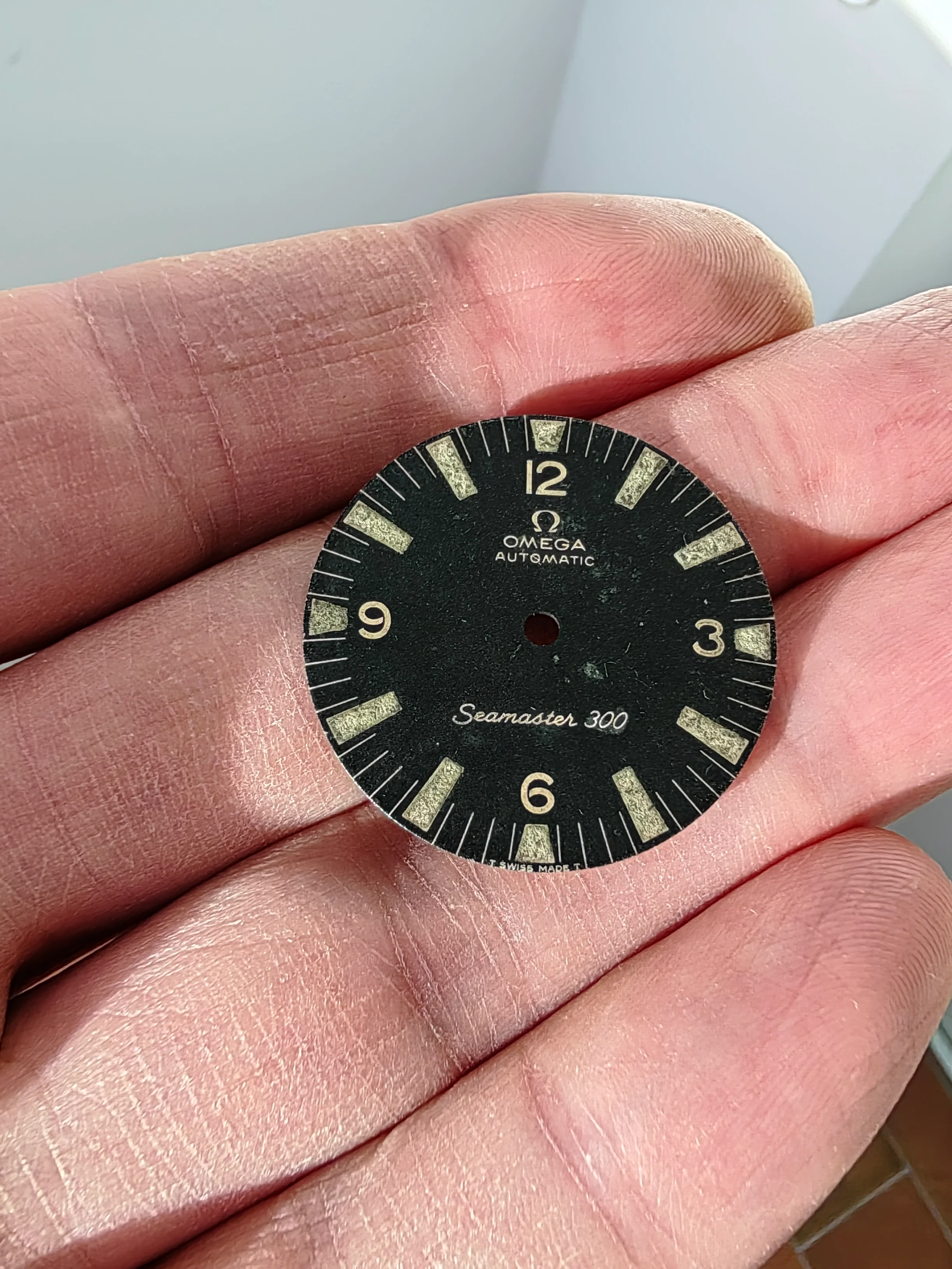

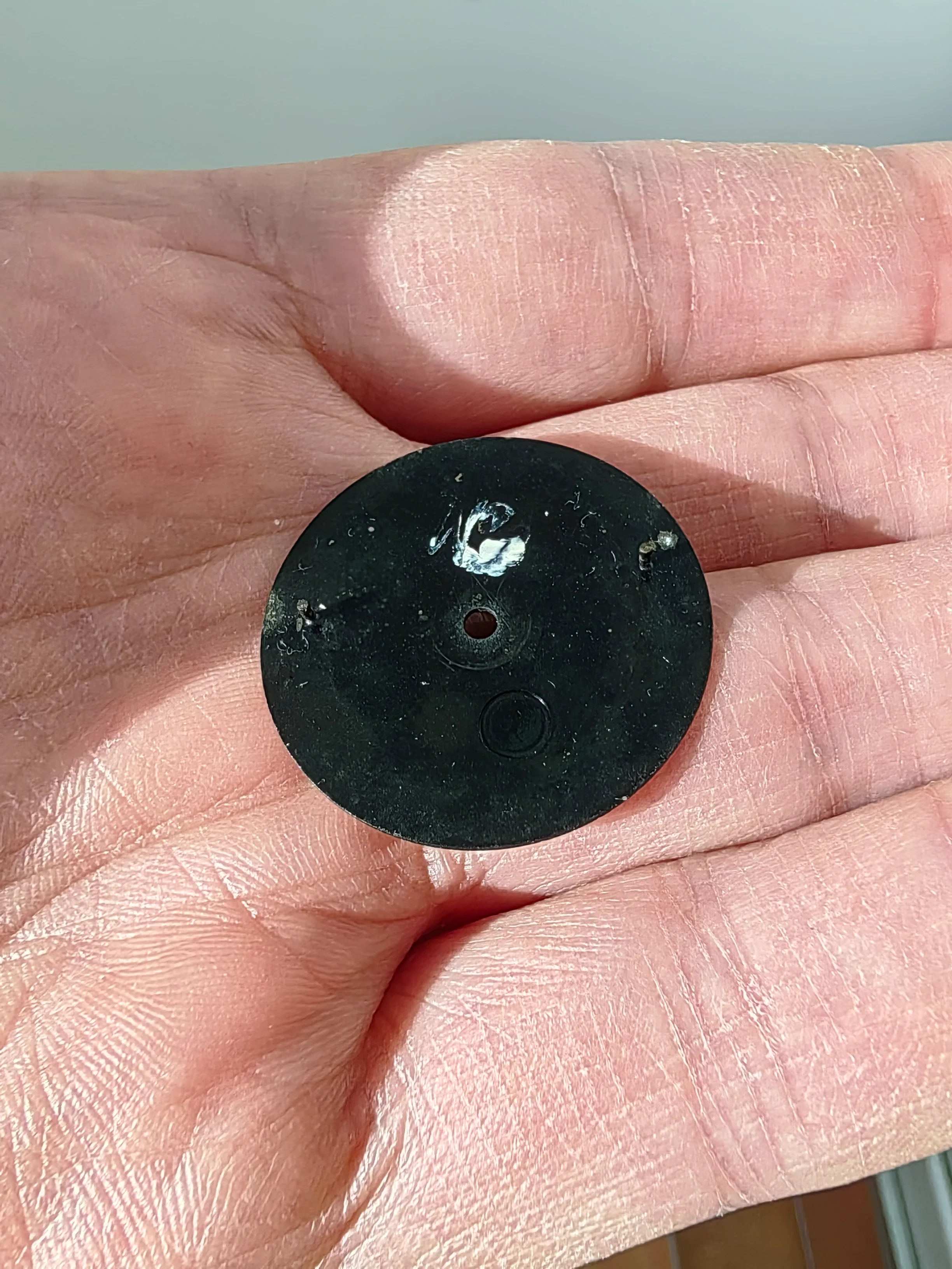

dial looks / is OK, if possible: show us the back....
Oh, I wish I had all the other components..
The kit shown is all I have at the moment.
282
64
-> back of the dial ;-)
Sorry. ))
The set is on its way, as soon as I receive it I will show the back side of the dial.

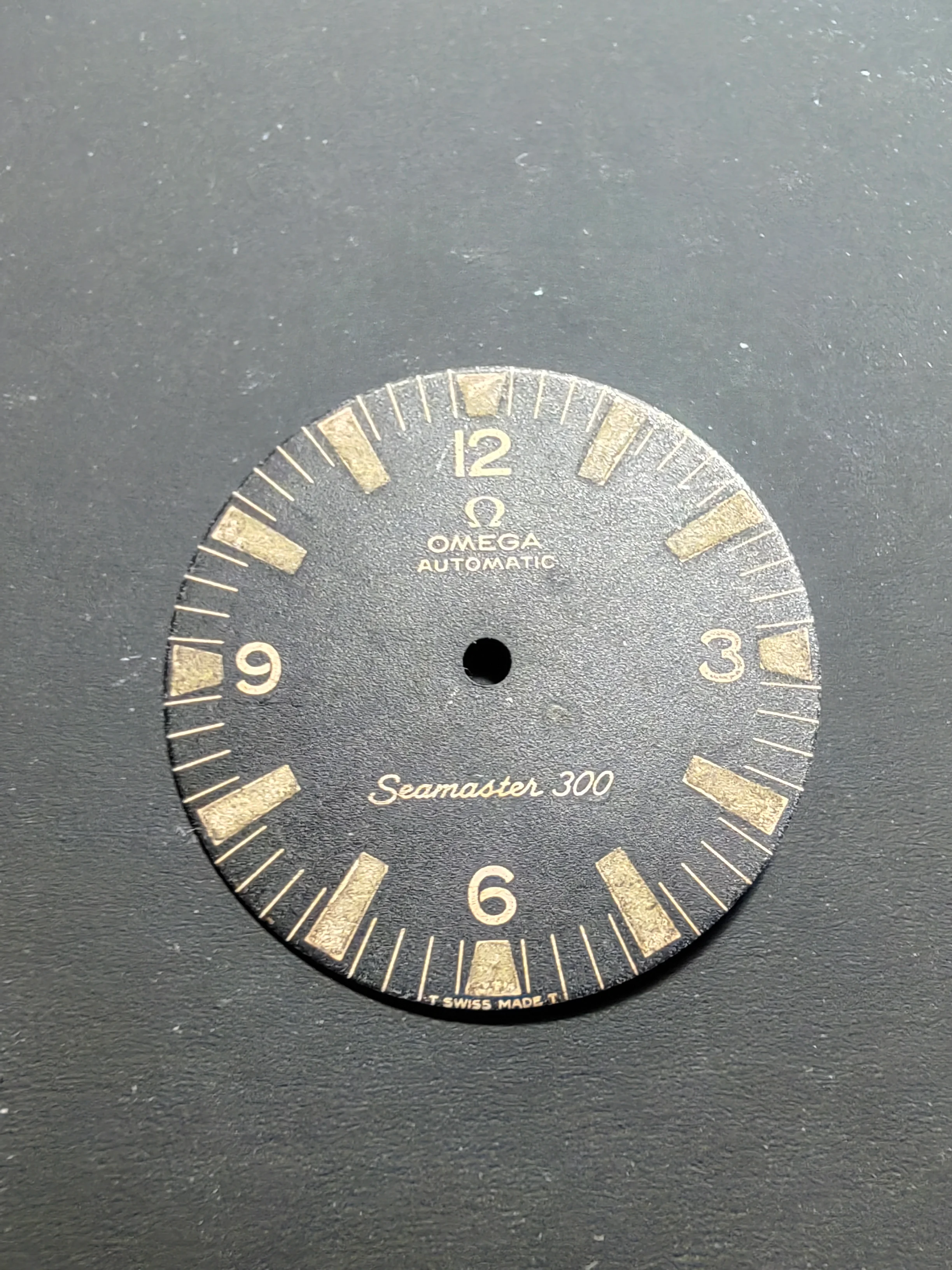

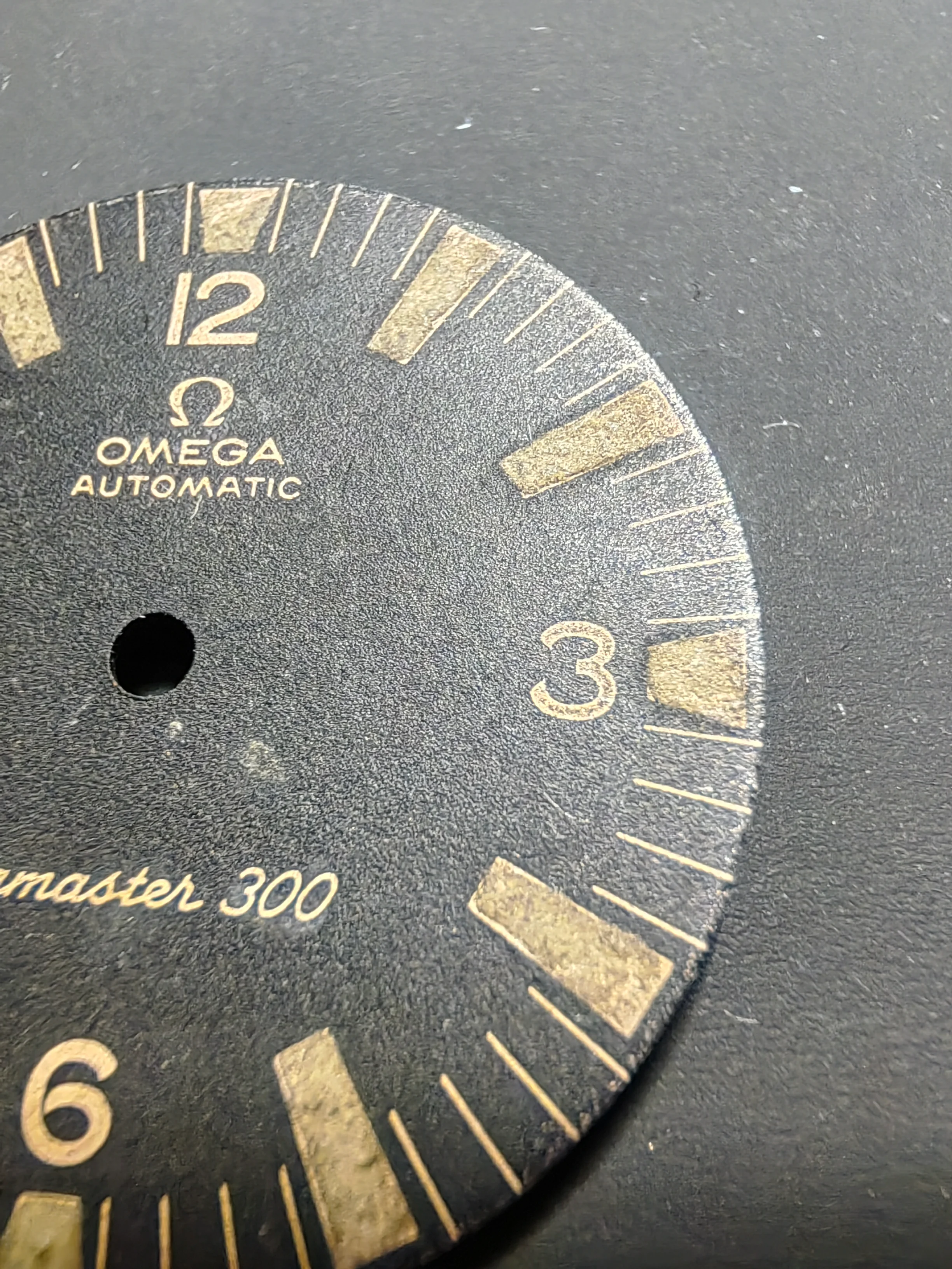

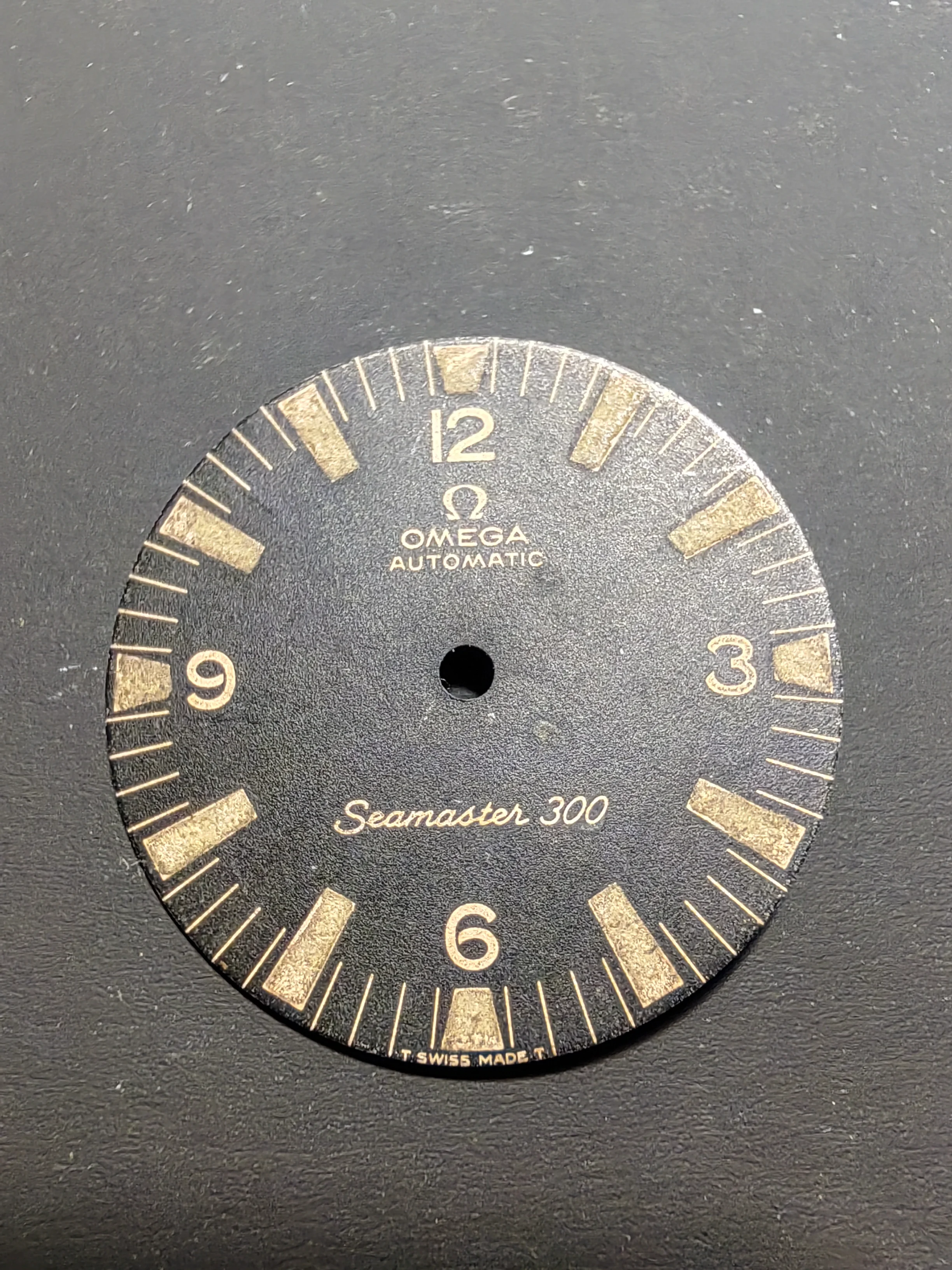

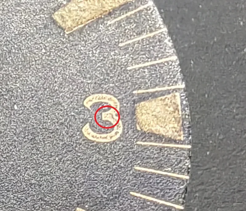

3,243
6,798

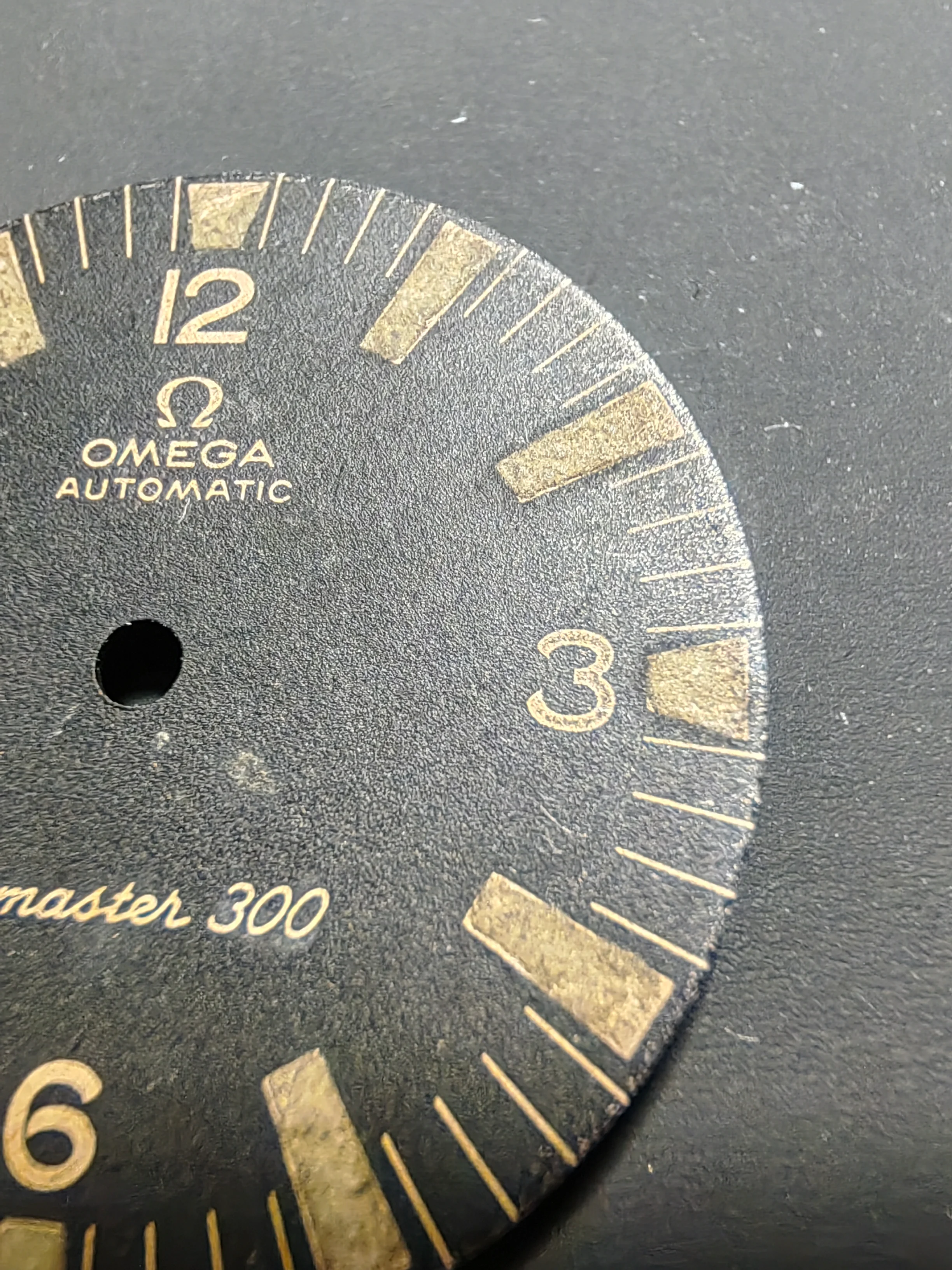

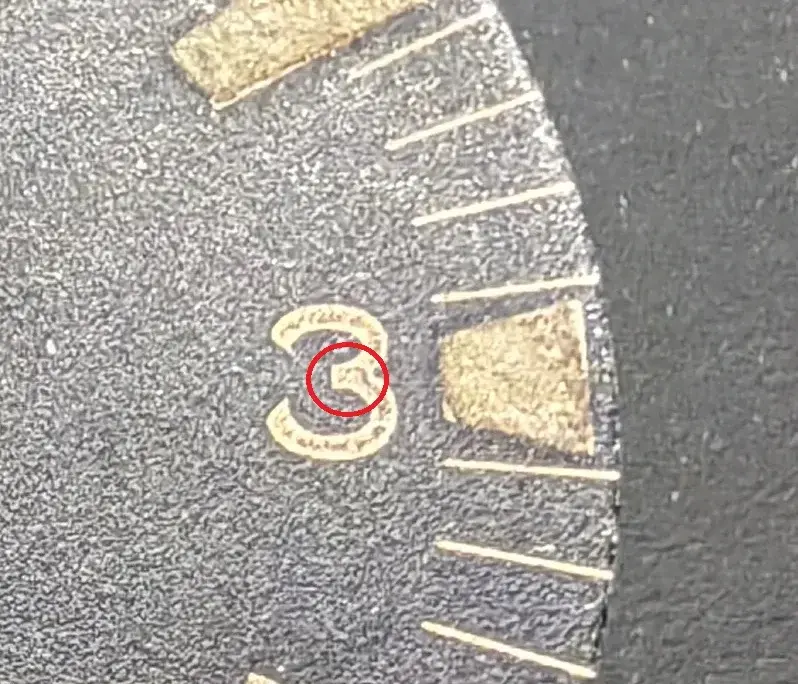

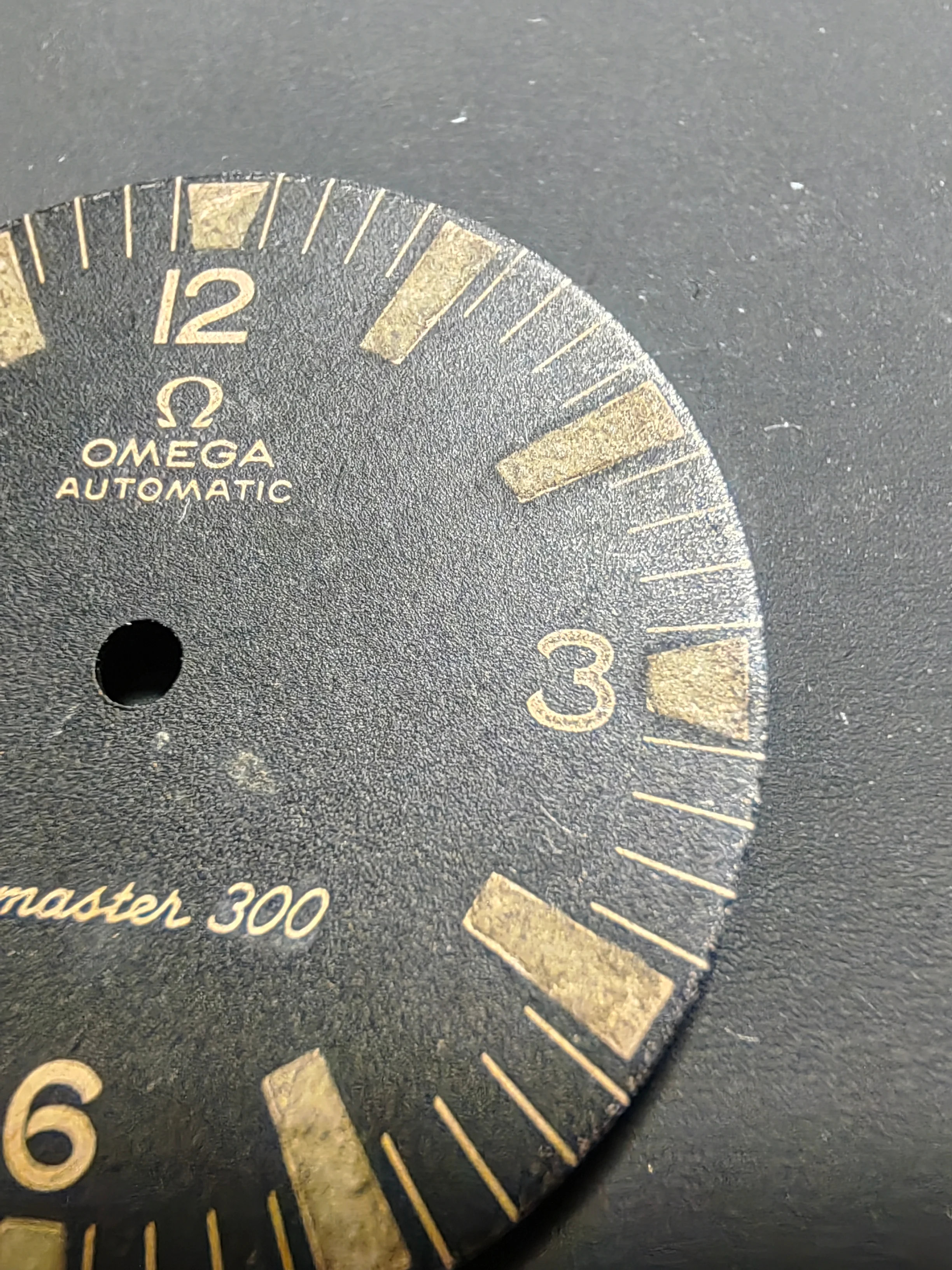

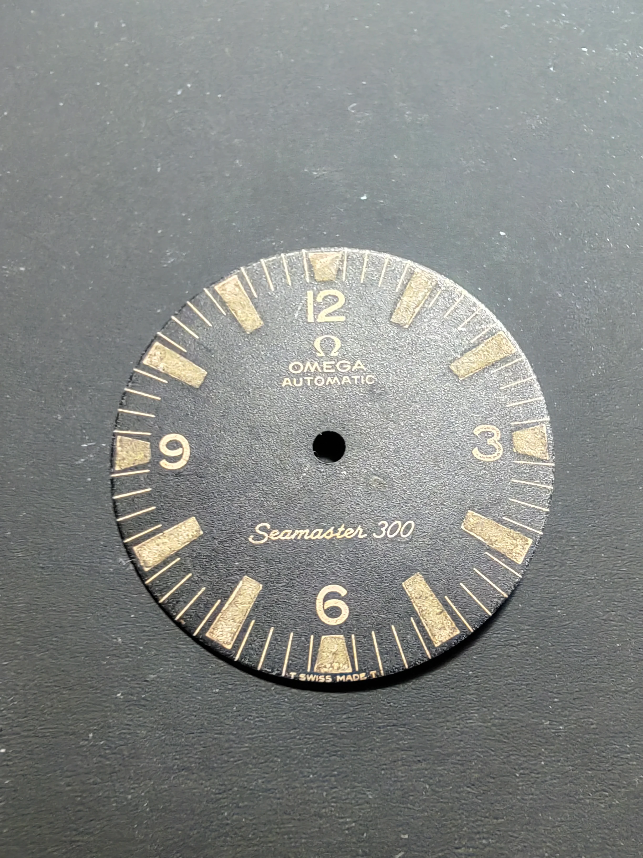

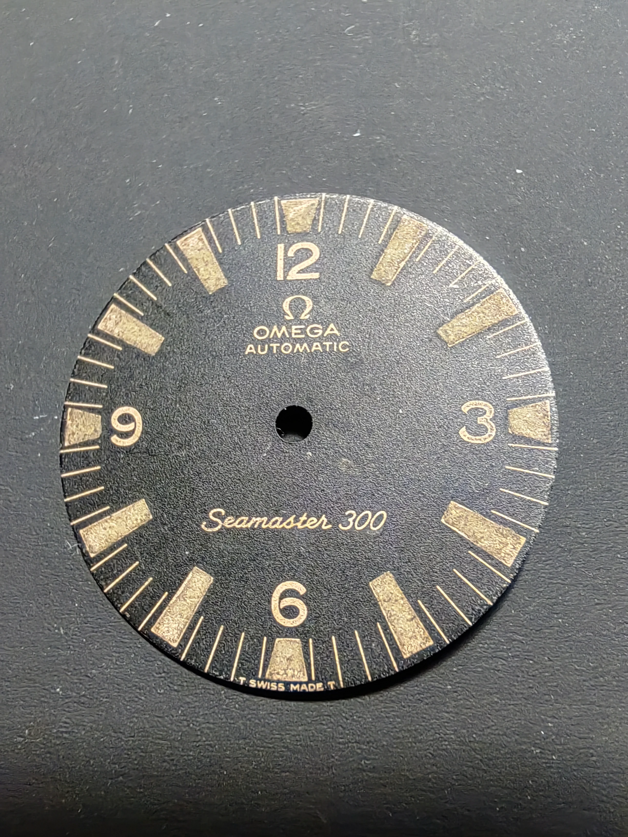

Imo repaintet/redone! You can see it on the (missing,3) serifs 3 or 6 e.g. and Seamaster
font to thick.... e.g.
and: take your time to make good pictures- this is not " free-hand tiktok" here to judge the value of a watch. my2cents
282
64
Thanks..
I will try to make better pictures..
3,243
6,798
as always: subject to other opinions and evidence - and: back-side should have markings
3,243
6,798
Let s wait for other opinions..... (the basic info for you from me is: I would not buy it.)

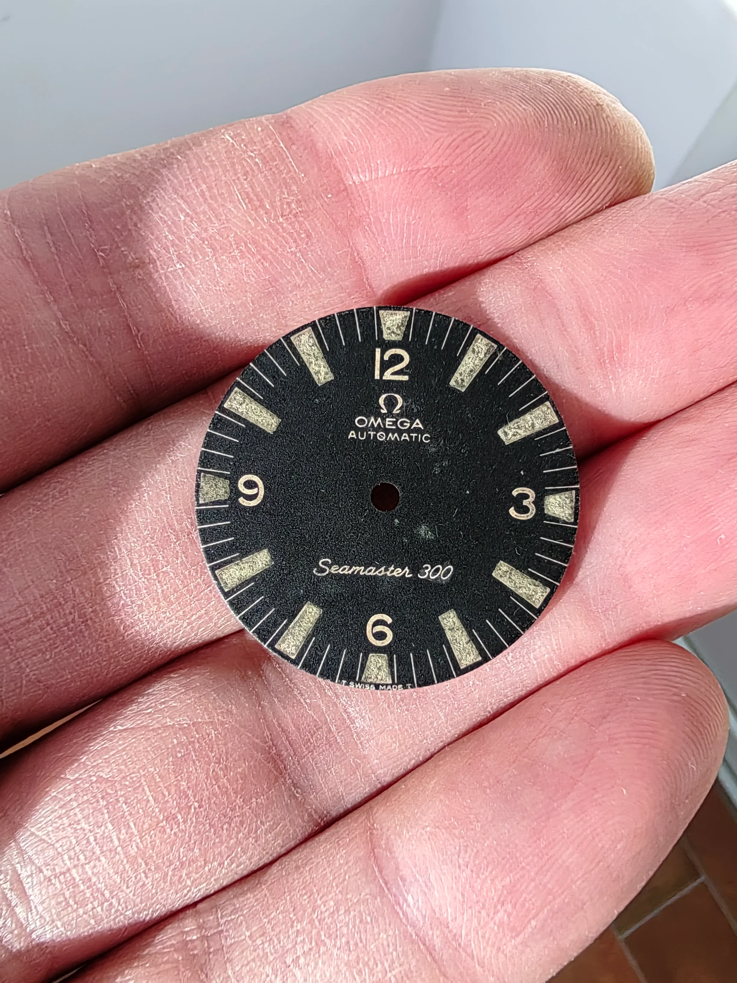

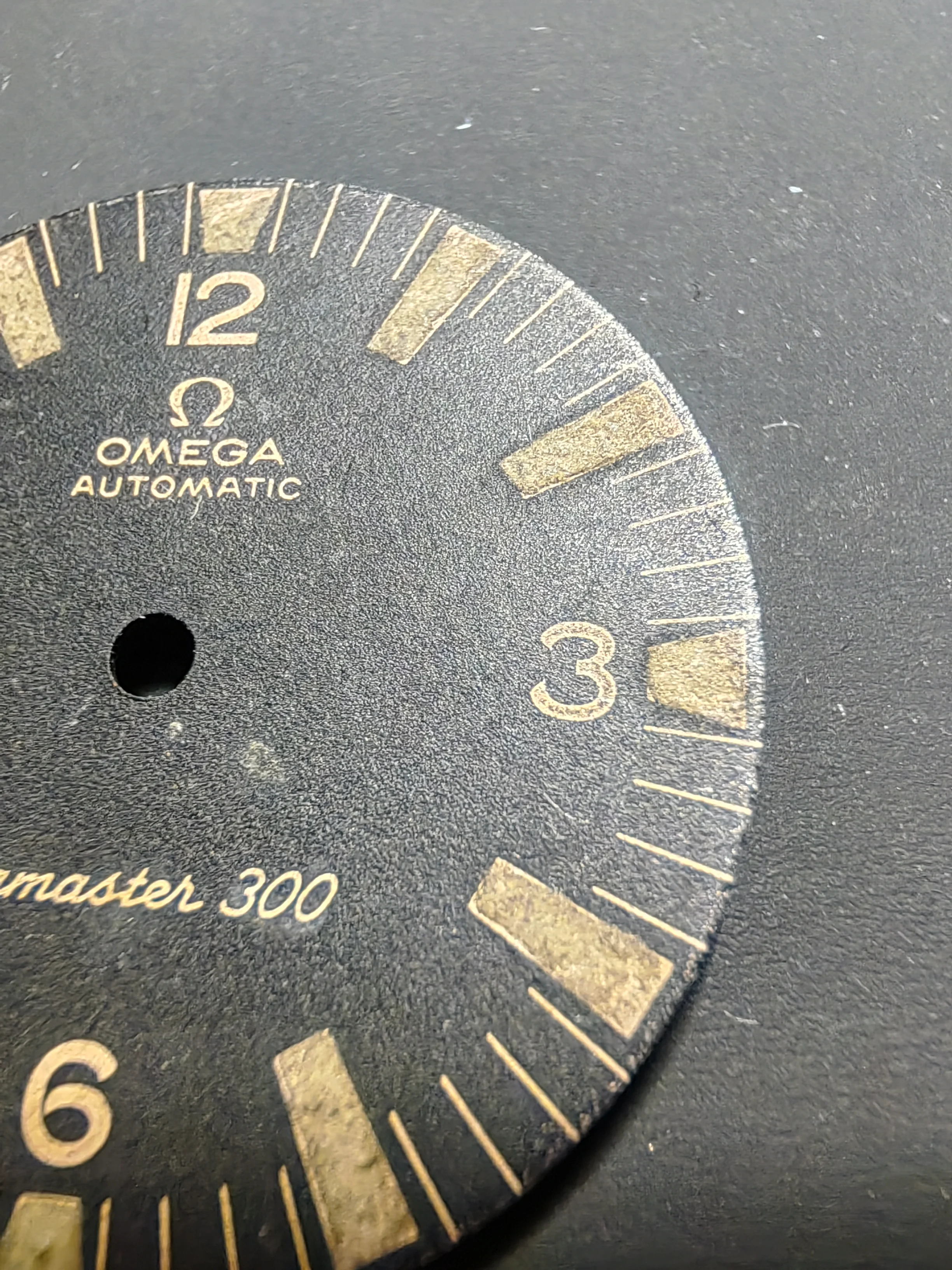

282
64

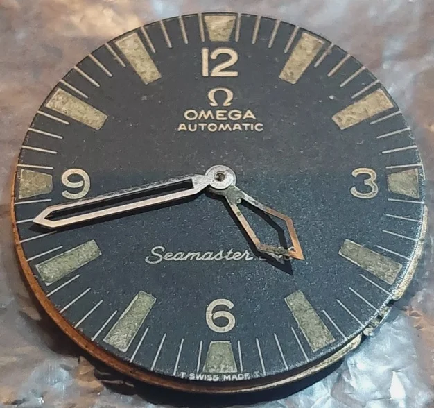

It’s actually a genuine dial, but not often seen.
Are you shure?
592
2,784
Are you shure?
Yes, he is 😎
A-ok dial, and on top also correct within that serial and with the cal 550
and read this:
