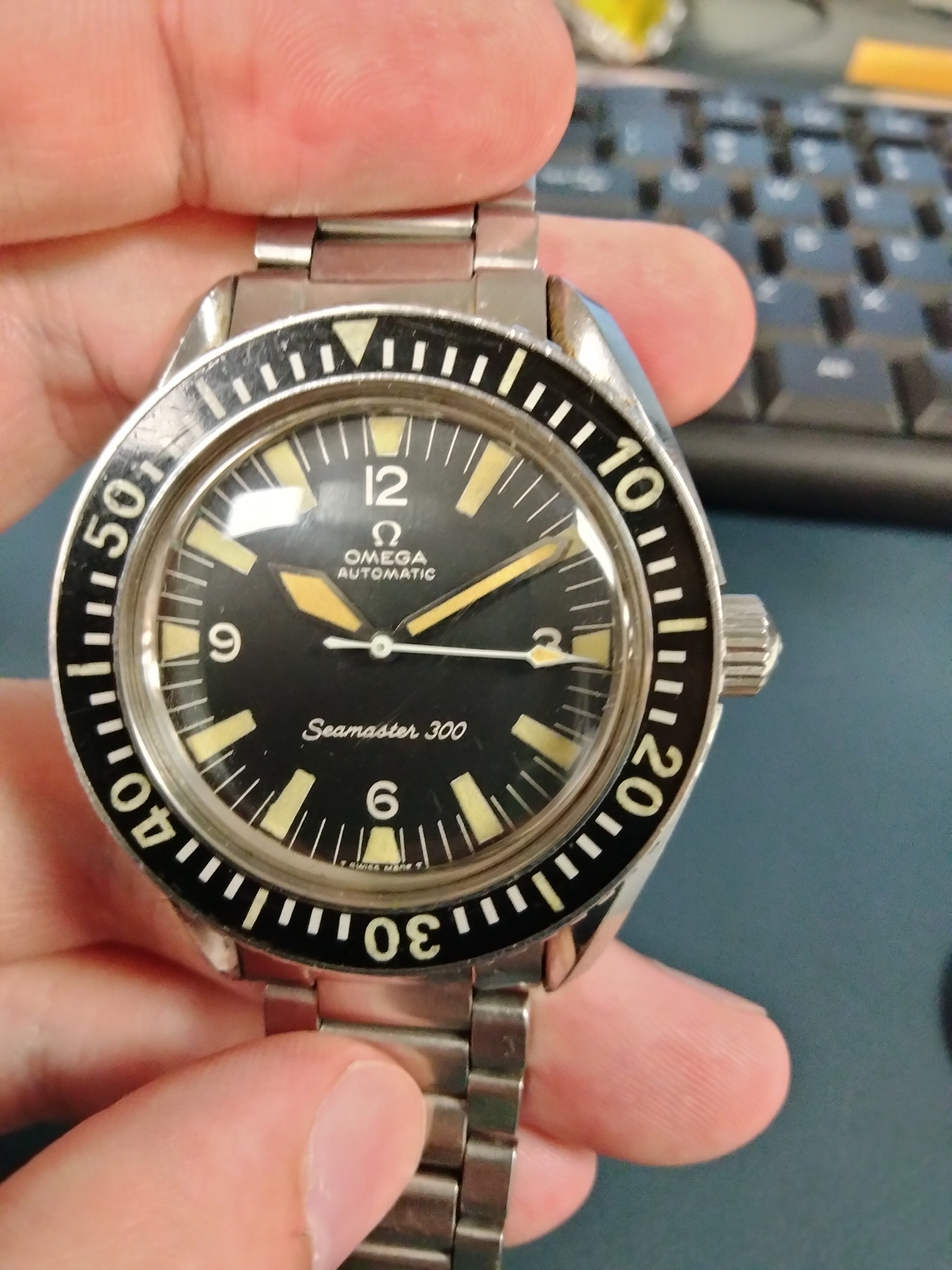

Hello everyone,

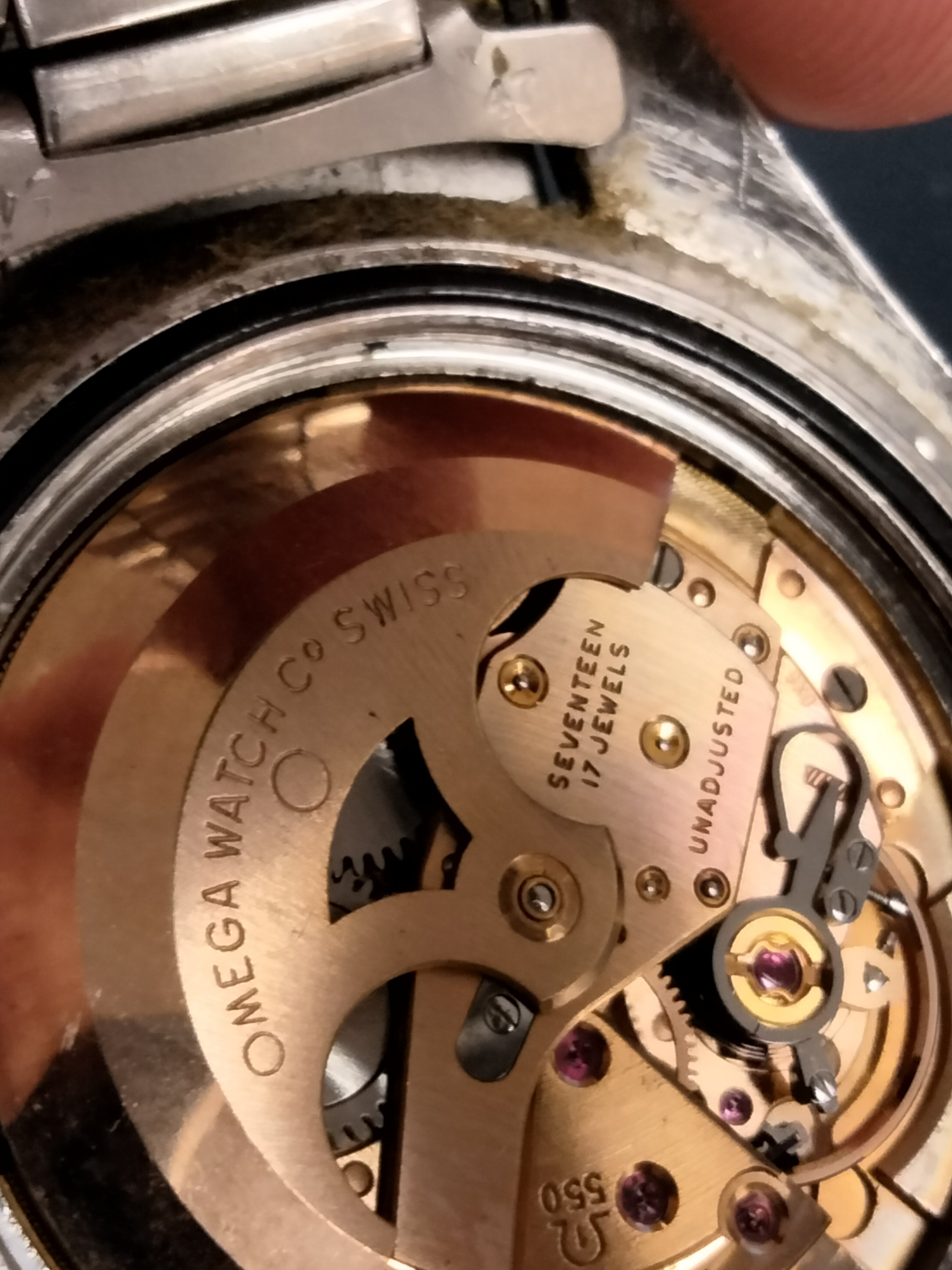

I just bought a Omega Seamaster 300, It has a 550 movement inside of it and I am unsure if this is all original or not. Any help on if this watch is been tampered with or what is original or not would be very helpful.
Thanks!

Could you take a clear straight shot of the front of the watch please?
I think the dial is fake.

The writing on automatic looks very off and the hands appear to have an orange tint I do not see in the indexes.

"Automatic" is not the only problem with that dial....

I'm sorry for you, but I confirm that the dial is fake

?black? hands are relumed (and therefor IMO destroyed)
tell us the s.n. of the movement

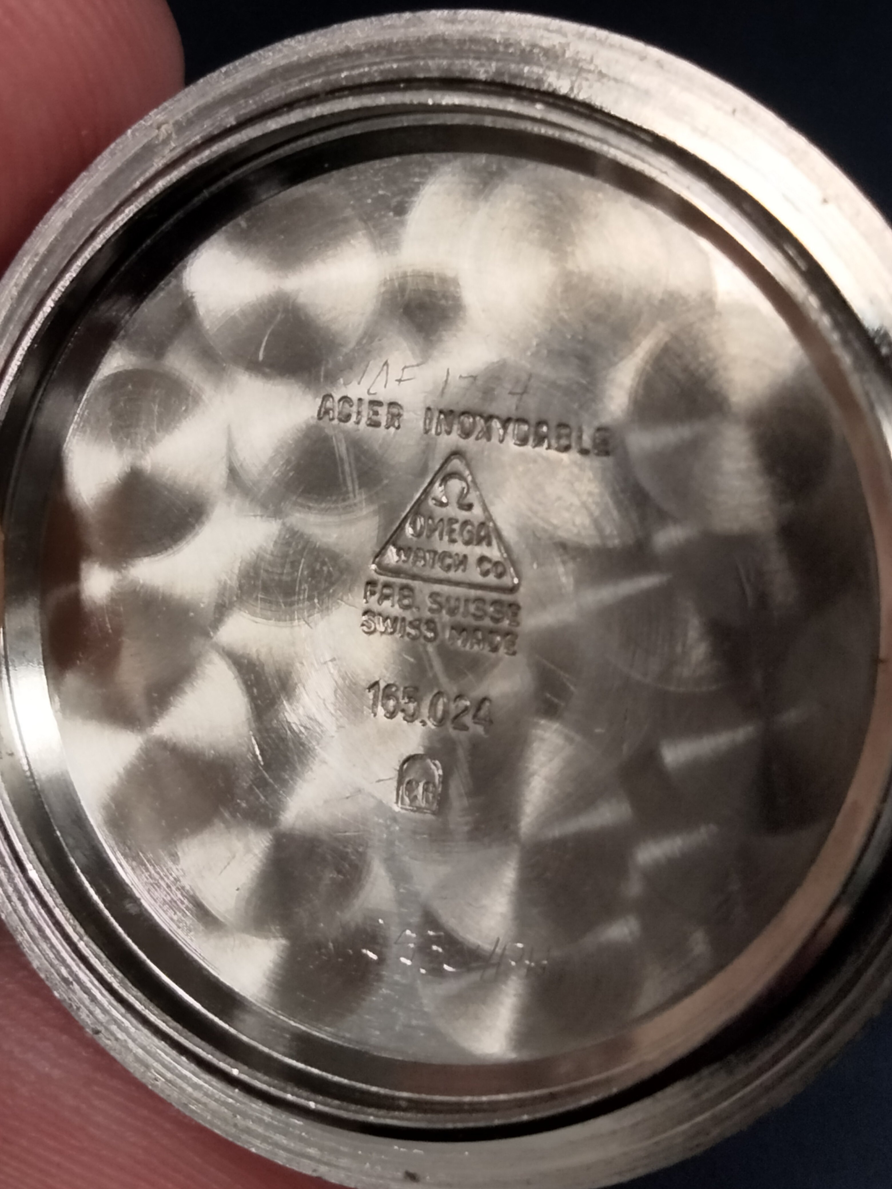

First of all, the case, movement, bezel and bracelet are original. This makes it more likely that the dial is also genuine, although based on your photos the dial does look suspect.
However, although I share some of the concerns above, I’d like to see a clear, well lit, focussed photo as I think this may show the dial to be ok.
The hands are either repros or have been relumed imo.

I'm afraid that even with an appropriate picture, the shape and font of the (at least) 6-9 markers seem wrong.

Completely agree they seem wrong on that photo, thickness, gaps etc but to my eye the overall proportions seem correct.
Same with the Omega logo and various fonts etc.
A better picture may well confirm the dial is bogus but I think there’s a chance it’s ok.

Guys, there are more variants of the 165.024 dials than meets the eye.
It's not fake IMO. It's a 'known' variant, typically seen in certain serial ranges etc. etc.

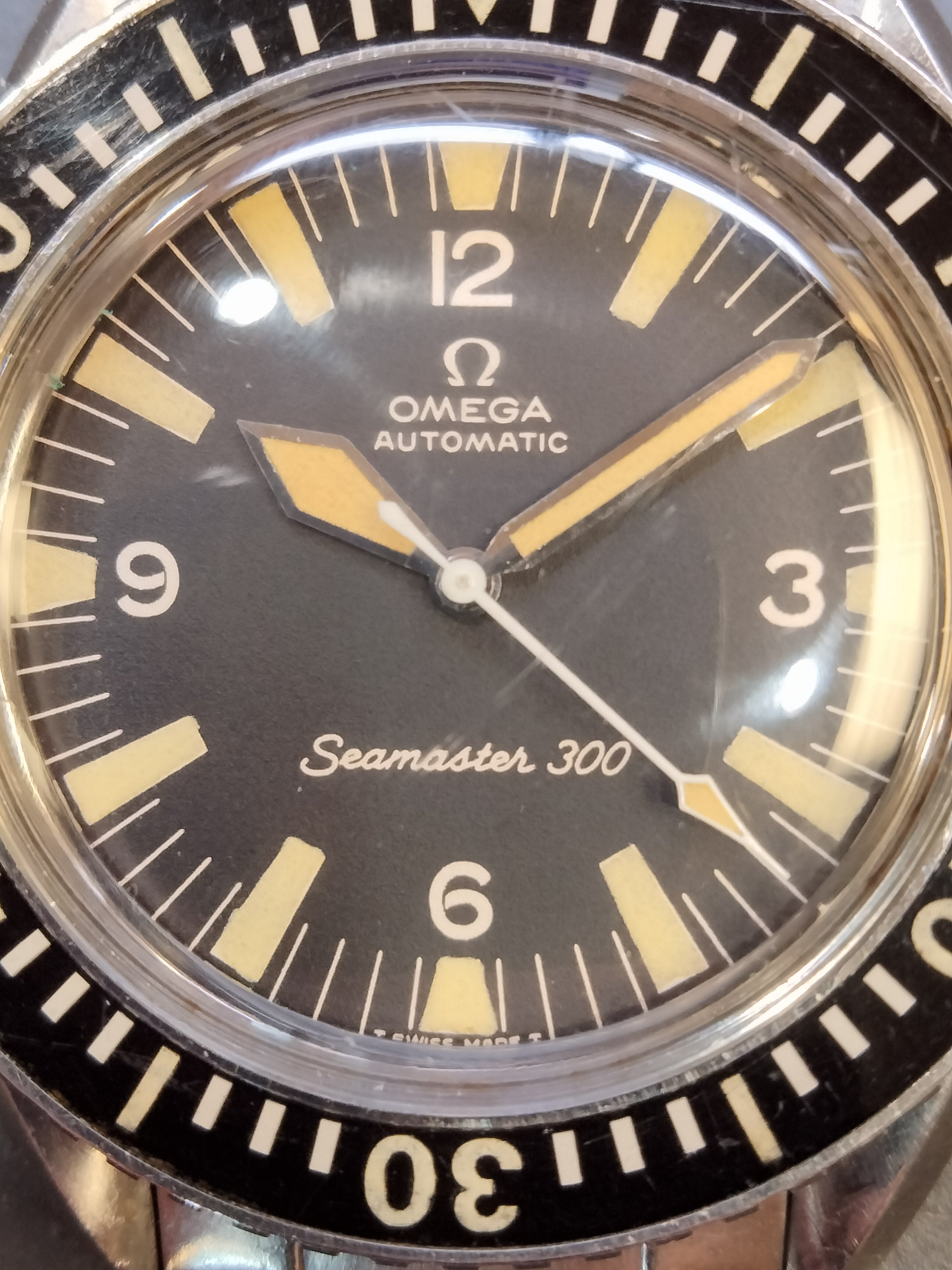

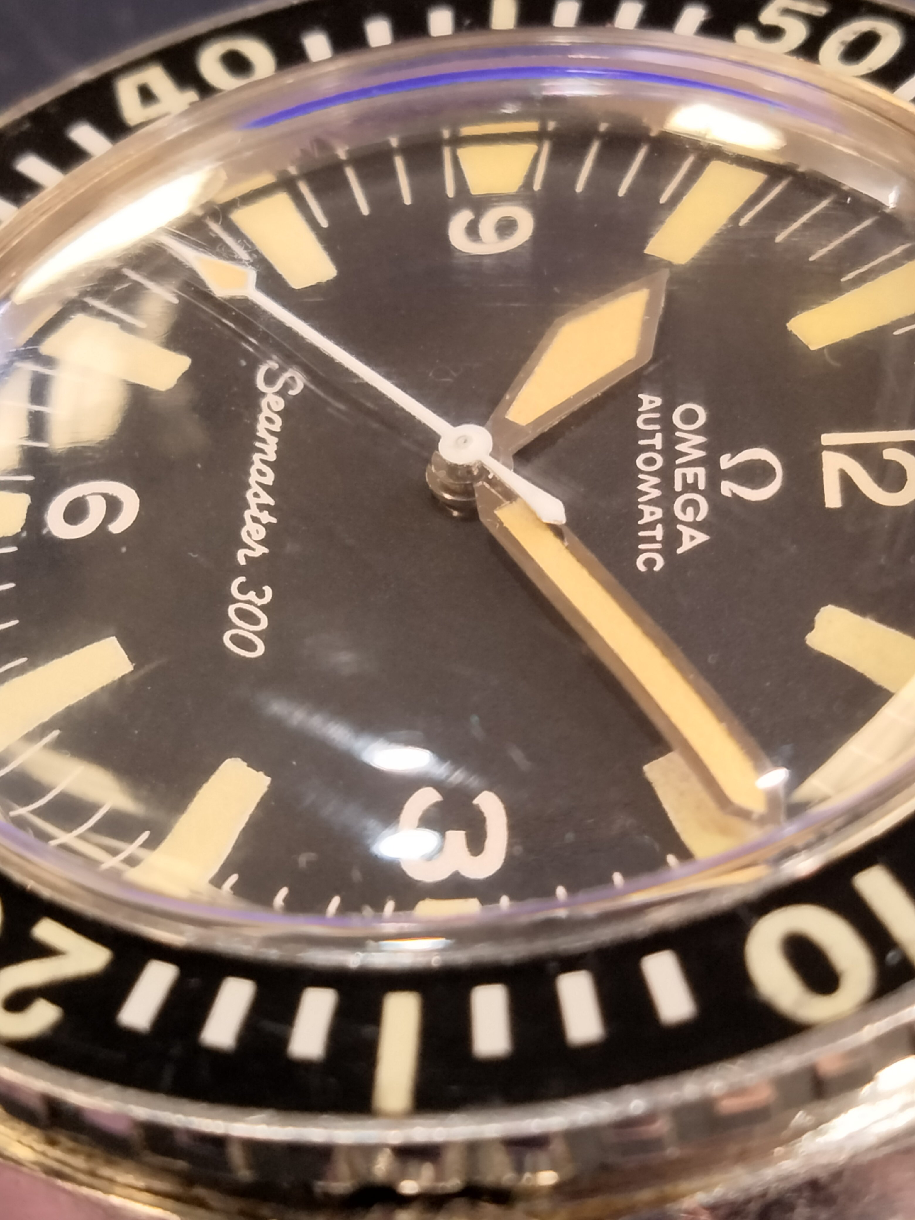

Thanks for replaying, Here are a few better pictures of the dial

The 6 and 9 definitely look off to me.
edit: and so does the 3 after looking at it more. I could be wrong though.

(narrow) gap at 6 ; serifs at 3 eg .
And font (thickness) of TswissT (this maybe because of the glass) 😲
sorry: fake / bad redial

I agree that the dial is fake. Having owned one of these in the past, the numbers and fonts are too thick and sloppy. The lume is also sloppy on both the dial and hands as well. If you decide to keep, this would be a good candidate for a service dial/hands.
But the bezel does look real. Depending on how much you paid, that could justify buying.

I would give back/return the watch. All subsequent decisions will end in disaster.
You will always look at a kind of Frankenstein-Dial.

Repainting that dial/hands would be throwing good money after bad. If you choose not to return it and decide to keep, then either keep as is or replace with the new service dial hands. If you try to source old ones, you are likely to just buy fakes again. If you want the bezel to match, you can also buy a service bezel.
This isn't a popular option on the forum, but it is an option, and better than having a fake dial/hands.
