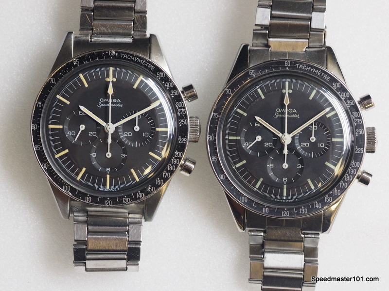

Your website shows one with short indices and applied logo also, Mr. Spacefruit. The differences are dome vs stepped and probably T markings.
Regards.
You are right !
I did not notice the short indices in the photo, thank you for pointing it out.
I do not know where this dial, (Short indices, AML, Non Pro) comes from as I dont think this configuration was on any factory built new watch.
See here for the full confession of my oversight:
http://www.speedmaster101.com/105-003-page-updated/
I wonder where these dials come from?

What reference does the dial of the second one belong to, if it's not a redial?
Therein lies the question....I have one too:]

I treat your website as my 101 textbook and did not know you did not know 😁.
Is this dial not mentioned in the bible?
No it is not.
There is a "Professional" version with AML and short indices, that is not attributed to a reference, just "Fitted in 1960's and 70's, Very Rare"
No it is not.
There is a "Professional" version with AML and short indices, that is not attributed to a reference, just "Fitted in 1960's and 70's, Very Rare"********
yes, it is very rare and it is a factory dial. I had a look at the back of these dials and the oxidation on the back shows clearly, that these are no reprints. I bought 4 of these over the years. all 003 references. if I remember correctly, I had 2 excerpts requested from the factory and both came up with sold to Peru. there is a long connection between Biel und Peru. see the FAP issued Speedmasters and the Rail/Flightmasters. Peruvian military started buying from Biel in 1958.then there are the later A.M marked dials. printed by the factory. my guess is, that they refer to the Andean Motor Club ( Andes motor challenge). there is a long history with swiss watchfactories and south American /African customers getting phased out/radium fitted dials after the cut off date......just the manufacturer using up old stock. like rolex did. I did not keep the factory records; all is just from memory. these were years, when omega and other brands did things as they came along; some not making sense to fussy collectors now. kind regards. achim
5,598
9,422
forgot something. to make things even more confusing: I`ve seen 2 of these dials from the early 60`s without the step ! Using up early speedy dials? more research needed. kind regards. achim

I also had one of these .003 with that dial, it is a first owners watch, but he could not recall if it was serviced in the early 70ties, in combination with the fact that the hand is not correct too and that the movement does belong to a 68 Seamaster,
i come to the conclusion that these are early 70ties service dials
