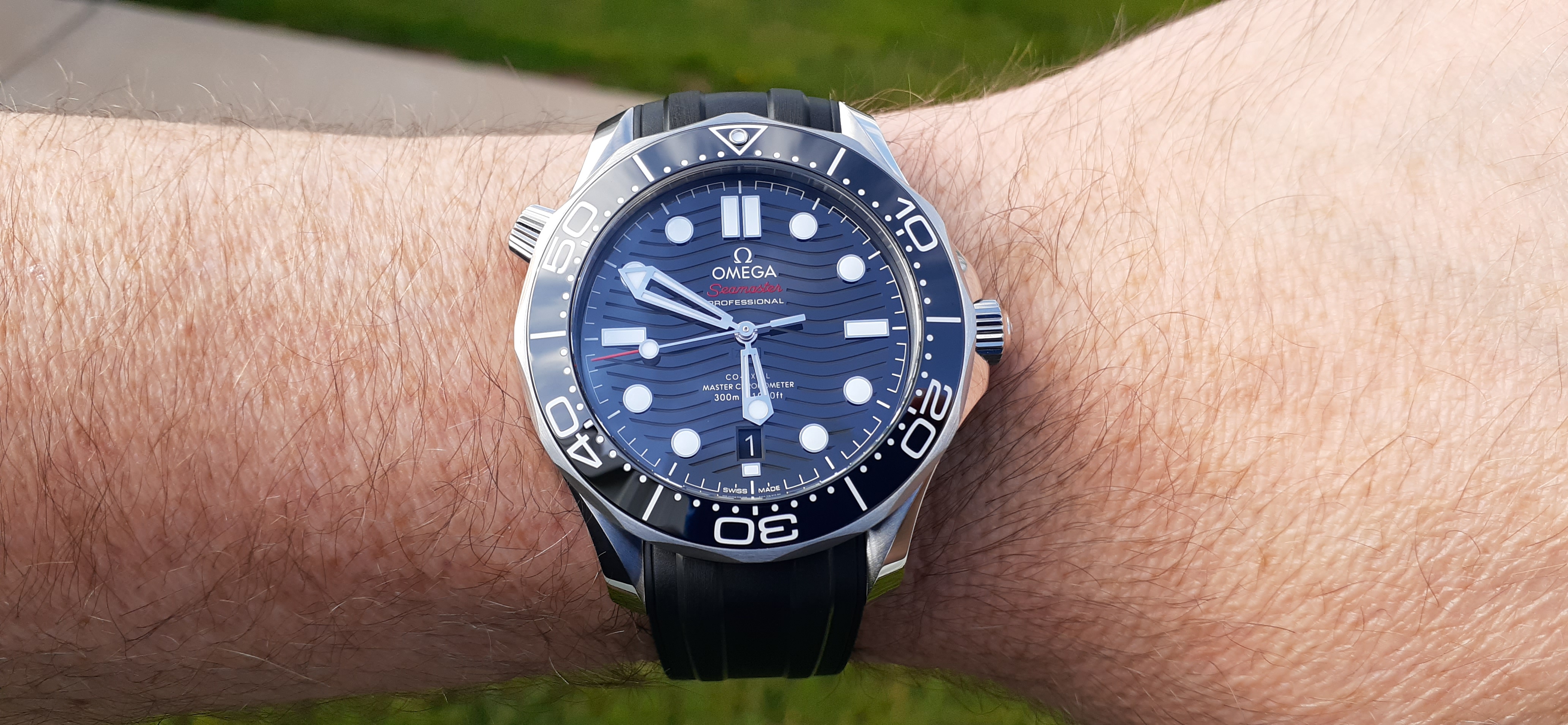

So I guess my questions are:
#1 Is this fixable under a service or warranty repair?
#2 Is this common?
I intend to drive to another AD and another, if there is hope of finding a perfect one.
If it is common that they come a little off like that, MAYBE I can just buy it and try to forget about it.

Frankly, I'm having a hard time relating to this level of pickiness, but we see similar posts pretty often, so I guess you're not alone.
I'm not sure that Omega would be willing to rectify it unless it actually falls outside their QC standards. I guess you could ask about those standards w.r.t. bezel alignment. Some watches will be perfect and some will be slightly imperfect, but there is no way to guarantee that a given watch will be better than Omega's standards. People often complain about a piece of dust or an imperfection on the dial that can only be seen using a loupe, but that type of flaw is acceptable to Omega, their standards involve naked eye viewing. The only way to buy a perfect watch is to take a loupe with you and inspect watch after watch until you find one that satisfies you. In practice, this might be difficult for desirable models.
An independent watchmaker might be willing to keep messing with it until it meets your standards, but you don't want to do that while the watch is under warranty.

After seeing the picture, I’m not convinced the problem even exists. It looks like the lens of the camera was slightly below the center of the watch, so that will distort everything slightly. You can only really tell if the camera is straight on to the watch. And even then, depending on the focal length of the lens, you can still get aberration.
remember, the picture is “flat” but the object is not.
frankly, as others have said, if this level of “imperfection” is too much for you, then I suggest finding a different hobby. I have yet to see a “perfect” watch.

For example, on the Seamaster, when the bezel marks are lined up perfectly with the 15 minute and 45 minute markers on the dial, the bezel lume plot is aligned, but the 25-minute bezel mark is just slightly rotated CCW from the corresponding mark on the dial, and the 30-minute bezel counter is also slightly off center.
I had the same issue on my 300M Nekton Edition, wacky alignments of some of the bezel numbers. I sent it in to Omega for examination and they installed a new bezel. Problem solved, all bezel numbers now align perfectly. I would also check the dial furniture. My 3 o'clock hour marker was slightly misaligned. You can view my post here https://omegaforums.net/threads/diver-300m-nekton-edition-6-month-review-with-service-update.131601/
Thanks for sharing that! That means a lot.
I had seen a picture online showing that one of the rectangular indexes had scratches on it. This is the reason that I took the loupe into the AD.
Once I was there, I figured I would check the bezel alignment, and that's when I realized it was off, and left.
Thanks for letting me know that it is fixable.
I will check out your thread!

Isn't it just a matter of removing the bezel, rotating it slightly and pressing it back on? Seems like it would be an easy fix unless I am misunderstanding something. Misaligned dial furniture would seem to be a much more difficult issue to resolve without causing damage.
I'm not sure.
I know that with a Seiko skx007 or similar, you have to remove the bezel, which the bezel insert is glued to.
Then unglue the bezel insert, then rotate it and reglue it.
However, with the bezel insert being ceramic on the 300M, that is easily a scarier job to do, and I don't know if it works the same way either.

I find it funny that Seiko gets a lot of hate for being known to have misaligned bezels but here we have a 50/50 split on unacceptable vs "you're just nitpicking"
I wouldnt accept it.
Although you do have to be careful to make sure you're not just looking at the watch from an off angle. Like that picture from IG, I think the bezel is actually fine based on the 3 o'clock markers lining up but its hard to tell.

The instragram one I am unsure of, I just saw it and thought it was a good example.
The one that I saw in person, I took my loupe to check the markers and stuff. Then I realized the bezel was off. And I spun it, tried to align it, like 10 times, and it was always off, no matter how I looked at it.
Remove the bezel, remove the insert, then realign - should be an easy fix.
#2 Is this common?
1. I am sure Omega will fix any manufacturing problems during warranty. However from your photo I don't think there is one.
2. I haven't heard many complaints on watch forums in last 20 years. Maybe there were, but by magnitude less than various Seiko issues.

Sorry it took me so long. This is the one from Instagram. If you look closely, the bezel is a little too far clockwise to be dead center
and it seems like it the person did one more click counter clockwise, it would go over
this is what I mean.
The watch is tilted.
