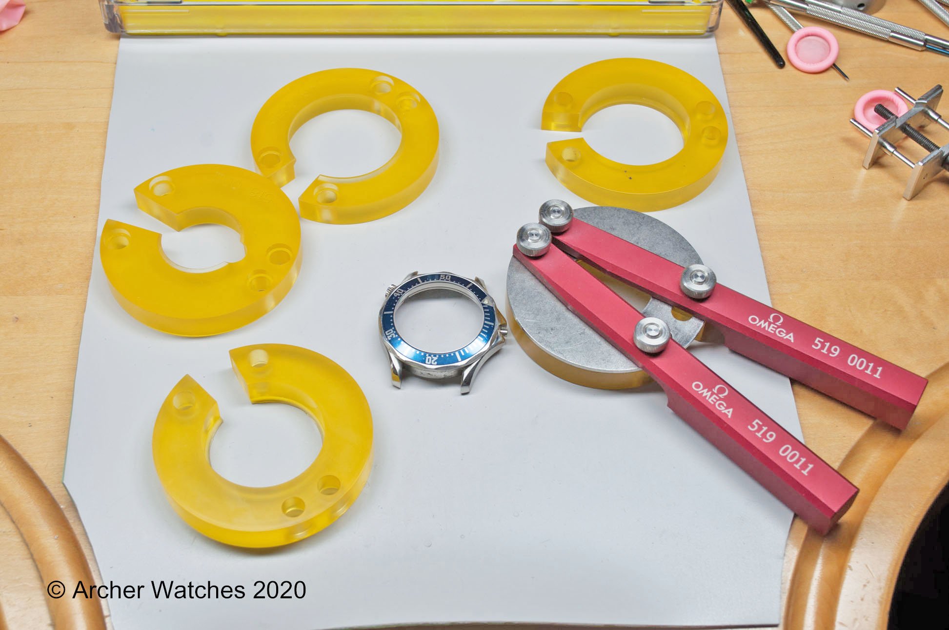

How are you removing the bezel? If it's the way I think it is, I believe that is the cause of the problem...please show the "custom tool" and explain exactly how you use it thanks.

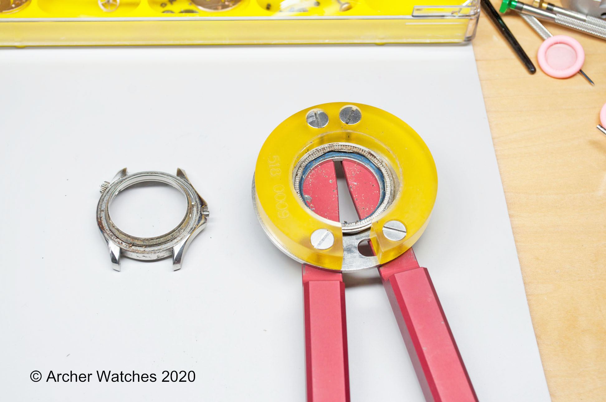

Hi @Archer, it's not the exact one shown but very close. A gap in the ring so I can slip it over the bezel, notch sits between the bezel and case, rest of the ring sits against the edges of the bezel.
To remove I apply a little pressure around the ring, allow the bezel to click counterclockwise and lift. I've based this on guides found online but as noted above, it appears the other guys are having the same problem...

Is the one you have the home made one by someone I think called Bry1975 or something like that? He was trying to sell them a few years ago and there were things about the design I wasn't crazy about.

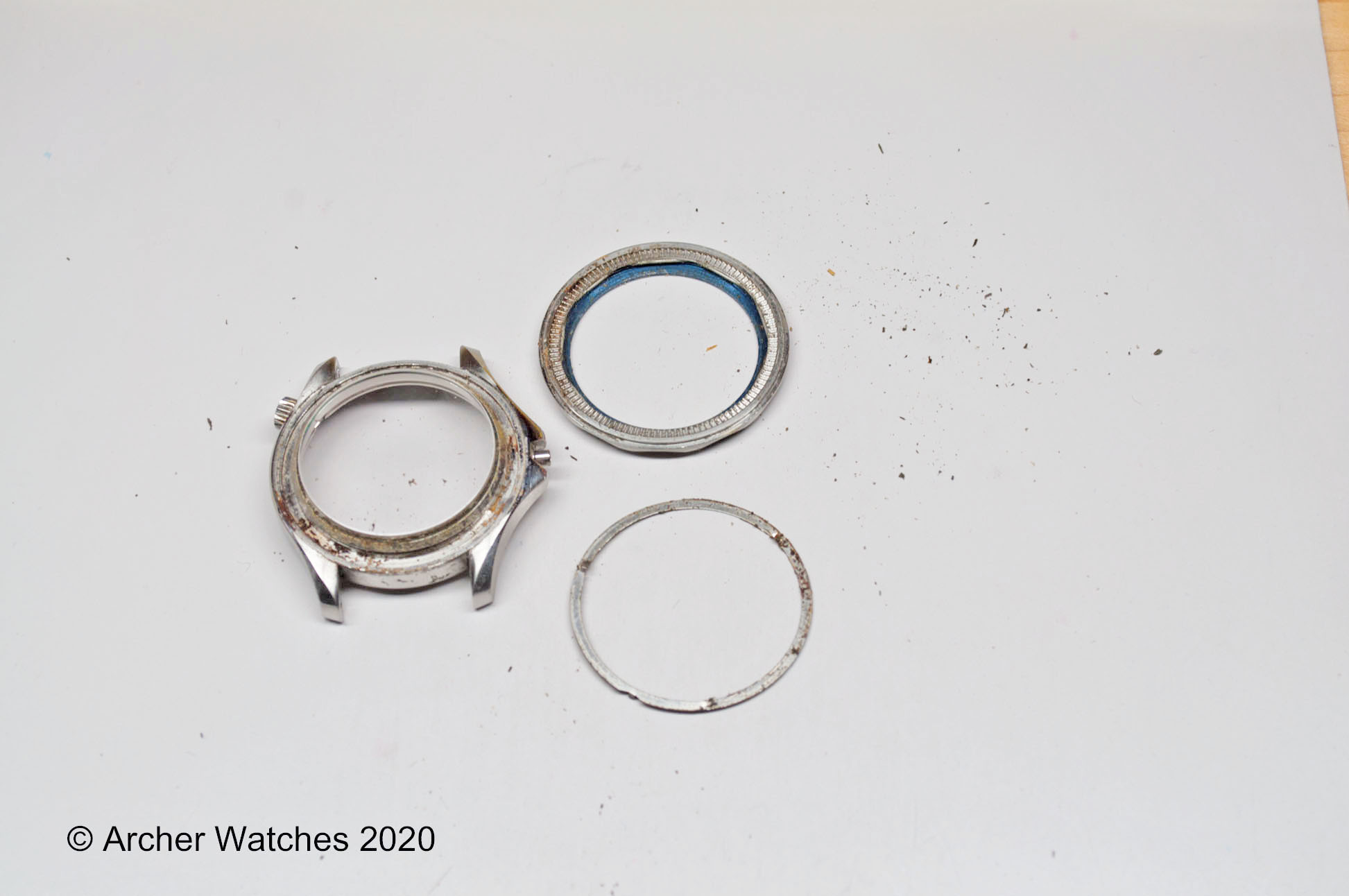

If the bezel is shifted alignment it's one of two things - the insert has moved relative to the bezel, or the click spring has moved relative to the case.
Anyway, you mention turning CCW - are you sure you didn't turn CW even a little? Because if you did, this can bend the click spring - either at the three tabs that stick up, or the one tab at 12 that goes into the hole in the case.
Look at the click spring to see if the tab that goes into the case is bent - that is where I would start. I use the Omega set that works on the same principle as the one you show, and I've never had this issue of it drifting, so it's either a technique issue or something about the tool that is causing this.

You don't install these with a press, so they always go back on by hand. Unless again you are somehow turning the bezel CW when you are installing it, and bending the spring, then installation shouldn't be the cause.
As I said above, if the bezel is shifted alignment it's one of two things - the insert has moved relative to the bezel, or the click spring has moved relative to the case. Is the new click spring you used a genuine Omega part?
If you are sure it's not the spring (which would make the most sense), then it has to be the insert moving relative to the bezel. I've never seen this happen from just removing and installing the bezel, so not sure there's much I can do to explain this. It could possibly be the tool you are using, but you seem reluctant to show it.
You are left with removing the bezel insert and installing it in a lined up position.
