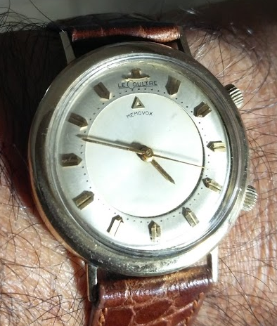

Or God forbid he gets to JLC memovox where you have to turn one whole 24 cycle and then back a quarter and go forth a half from 10 to 2 in order to ch e the date.
He would get an aneurysm
Perhaps not the JLC memovox your talking about... I was just about to throw this one in the trash because I accidentally moved the hands counter clockwise when I set the time.
