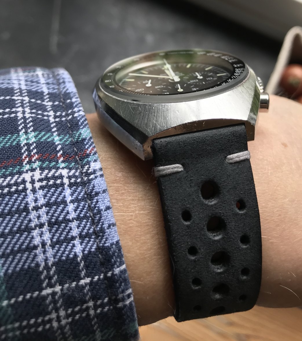

Alternatively, these look good on a Rallye Strap.

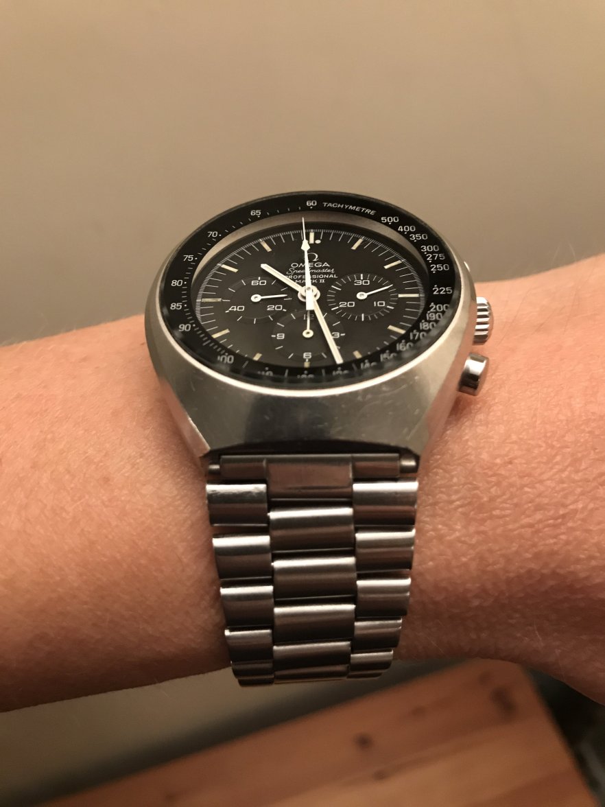

Here’s photos of mine with and without the bracelet, the case is in original unrefurbished condition which I think is the way to go with these if you can.

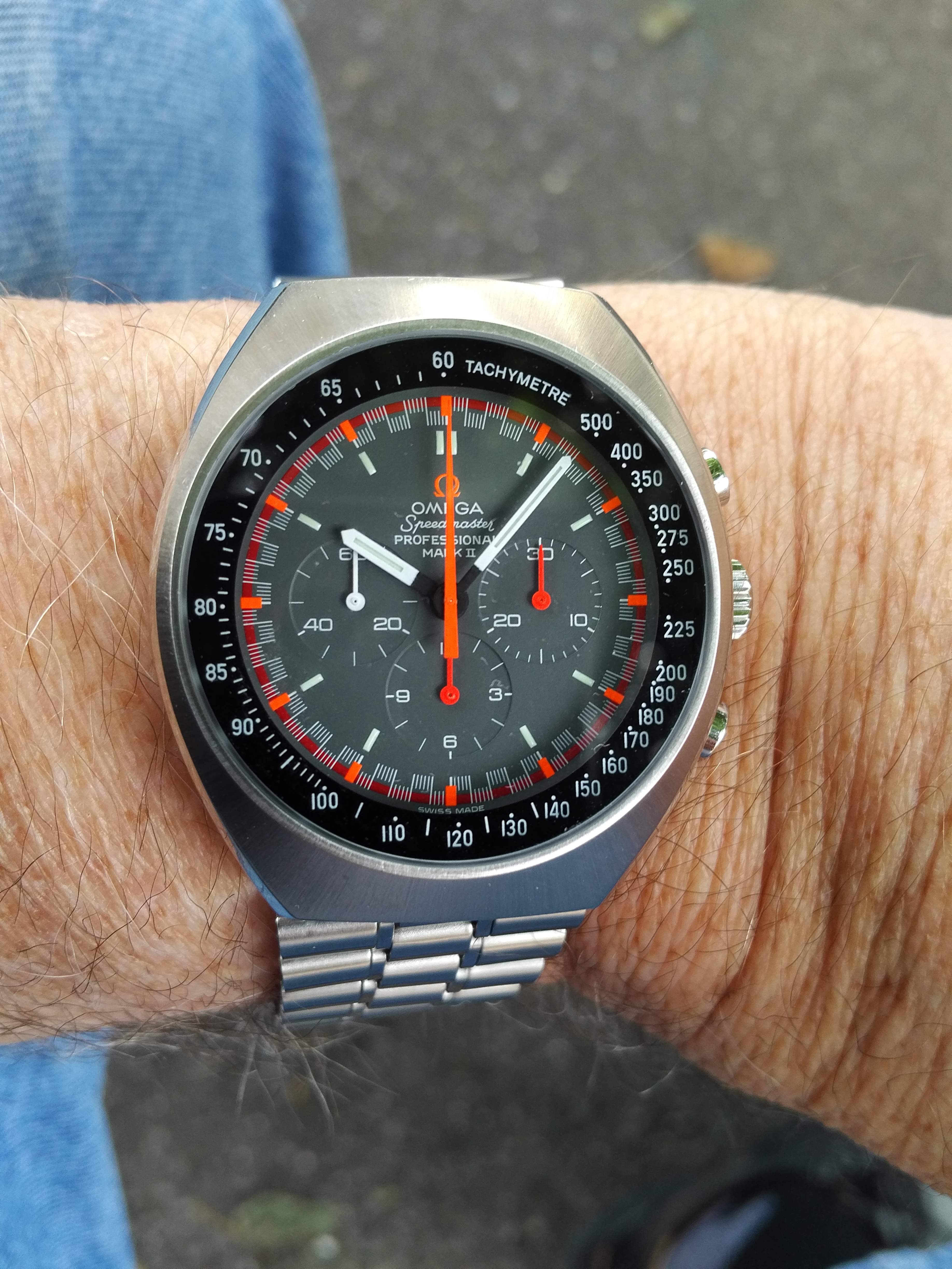

I just had my MK II totally restored for ~$1,000. US by Omega. The issue is the tritium dial and some will dispose of it and may legally have to. Independent shops may honor keeping the original dial if the tritium is not flaking . The movement may need some service and parts . I had mine since it was new and was long overdue for service. It lost all of the patina that it accumulated but is now set for the next 50 years. There is a replacement bracelet from OMEGA but it will look out of place unless you totally refinish the watch.

Depends on what you want to accomplish.If you want to restore or preserve! I had done preservation for years since I bought it in 1970 and it was looking sad. ( my opinion ) and some of the watchmakers along the way were using incorrect parts ( verified by a notable watchmaker in Lancaster PA ) I was told that the tritium dial was degrading and it had to be handled as a hazardous substance. ( private watchmakers as well as OMEGA said so ) I spoke at length with my OMEGA boutique manager about what I wanted to accomplish and despite their policy of sending MKIIs to Switzerland for a full restoration It was sent to Seattle Washington USA service center where they did an "a la cart" restoration. and they returned all the OLD parts. ( including the dial wrapped in plastic with flaking tritium. They tightened the bracelet as it was loose and links coming apart. They did a nice job and it is now back in the rotation good for another 50 years. While I would not repaint my classic air cooled Porsche on a whim I would do so if it looks bad. A matter of taste and preference. It is all original with ORIGINAL Omega parts yes it has a new crystal face and scale but they undid the years of WRONGS that reputable watchmakers were doing to it. There is still one battle scar at 8:00 on the case side that they could not fully remove and I told them that was acceptable.. ( I know exactly how I did it !! ) Looks great and I am pleased. which is what counts.

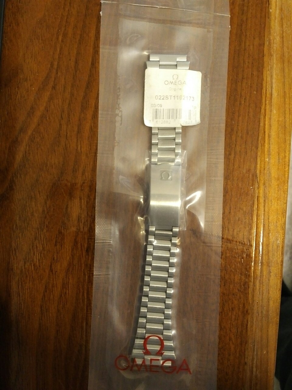

This is the OMEGA replacement Bracelet for a MKII I didn't have to use it as they fixed the original . the part number is 022ST1162773 hard to see on the label I got this from OTTO Frei. years ago The MKII has narrow portion that attaches to the watch and then widens to match the width of the watch. I suspect that one of my sons may use this some day when the original wears out completely ! NOTE the Clasp and links are different from the original BUT it will work looks correct but really is not an exact copy of the original. I think a good heavy leather strap would be very satisfactory and look great on this Classic !

Agree I would at least replace the crystal pushers and steam clean the case. I posted the OMEGA replacement bracelet ( and part number ) in this post BUT it may look too nice against the present state of the case.
