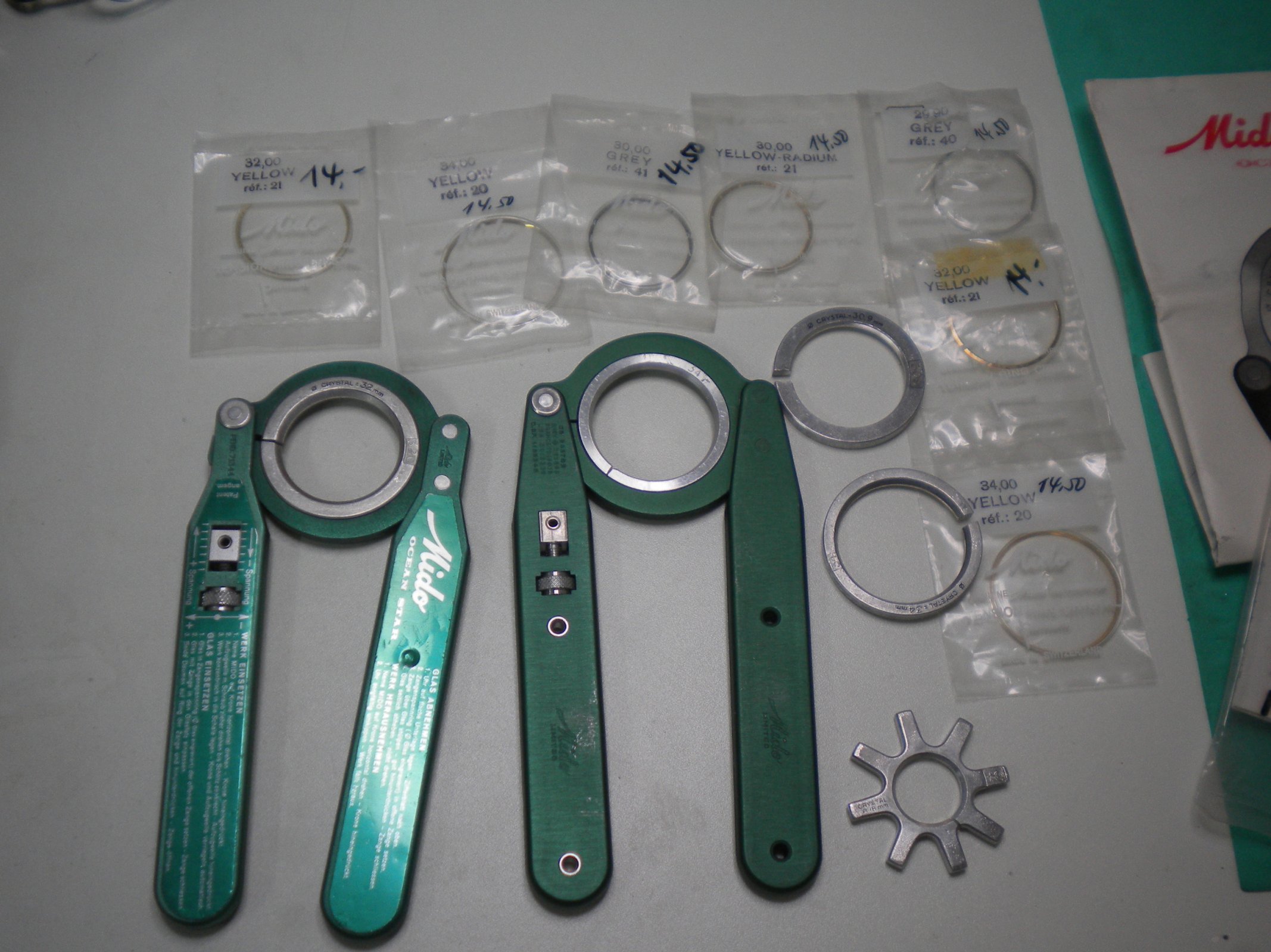

I`m late to the party but I want to congrat for your great work!
And ad an info for the needed crystal tool:
They`re out of production for decades now and AFAIK you can`t buy them new but they pop up from time to time on the net.
Just when you have the chance to grab one be sure to have the complete set of tension rings with it.
This tool is not from Mido itself but you need it for watches like Mido Commander and Zentra Savoy and others so this tool can have different brandings or no branding at all.
AFAIK there is a similar vintage tool from Citizen to.
EDIT:
I stumbled on this thread where Al is so kindly to show the original Omega tool:
https://omegaforums.net/threads/crystal-gasket-for-speedmaster-145-014.20134/
Which is sadly out of production to.

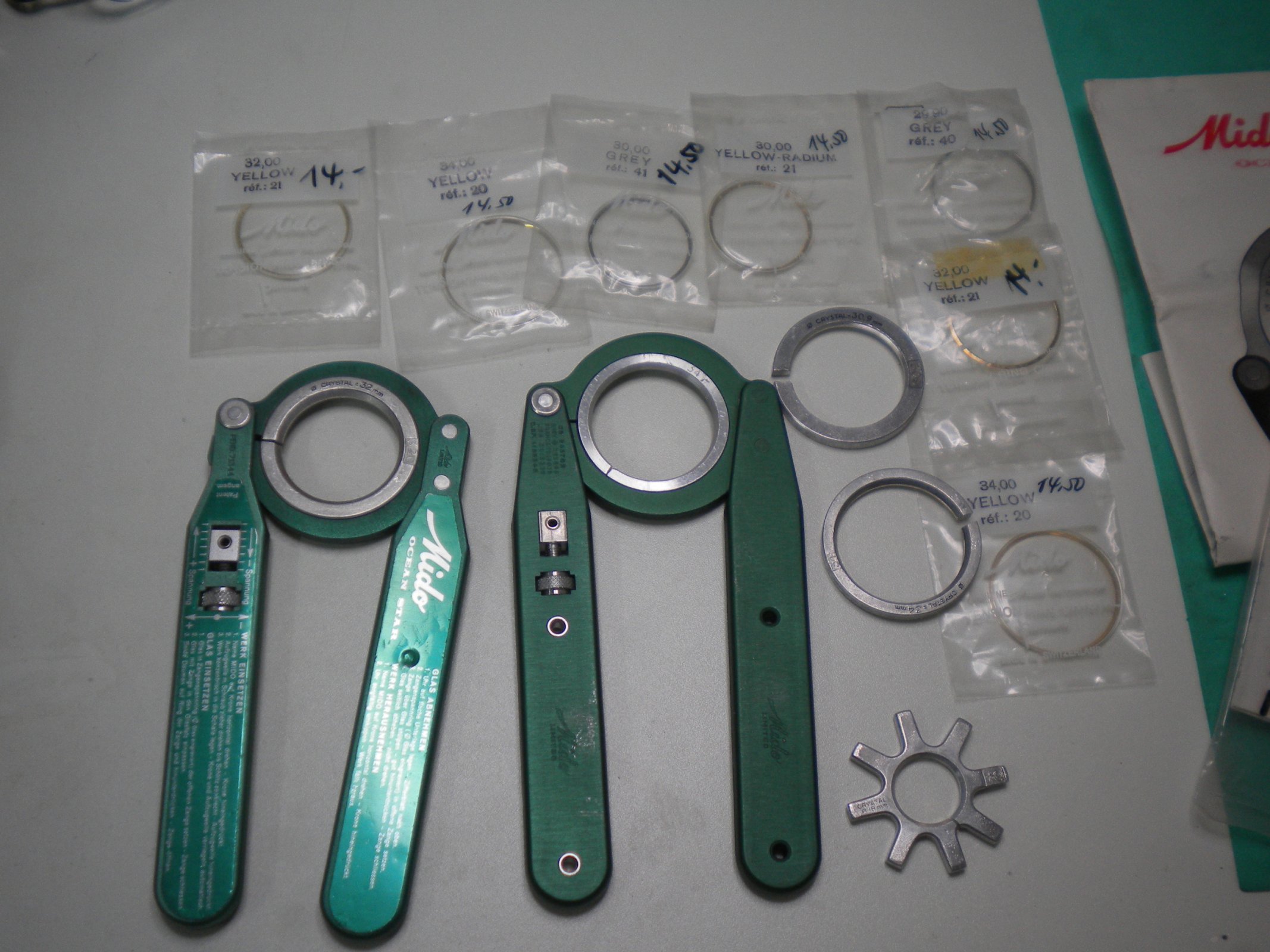

Does anyone have the exact dimensions of that Omega 9028 tool? As I want to see if our workshop can make me one. I am in the process of completing a Speedmaster professional ii with a racy dial. Any help would be greatly appreciated, thanks
212
315
Is it possible to deduce the dimensions from the crystal itself?
I had a sapphire glass replacement for the mineral crustal fitted to my Mark II after going through 3 of the mineral glass crystals.
The guy who fitted it didn't have the specialist tool, but used his own set up, that was 3D printed, I believe.
3
Hi all. I found the dimensions of this tool. Then I got a friend of mine to machine it out of a specialized hardened polymer. And it accurate to 2 one hundreds of a millimeter. I had him make me a few. So if any one wants to get their hand on an Omega 9028 tool, give me a direct message.
