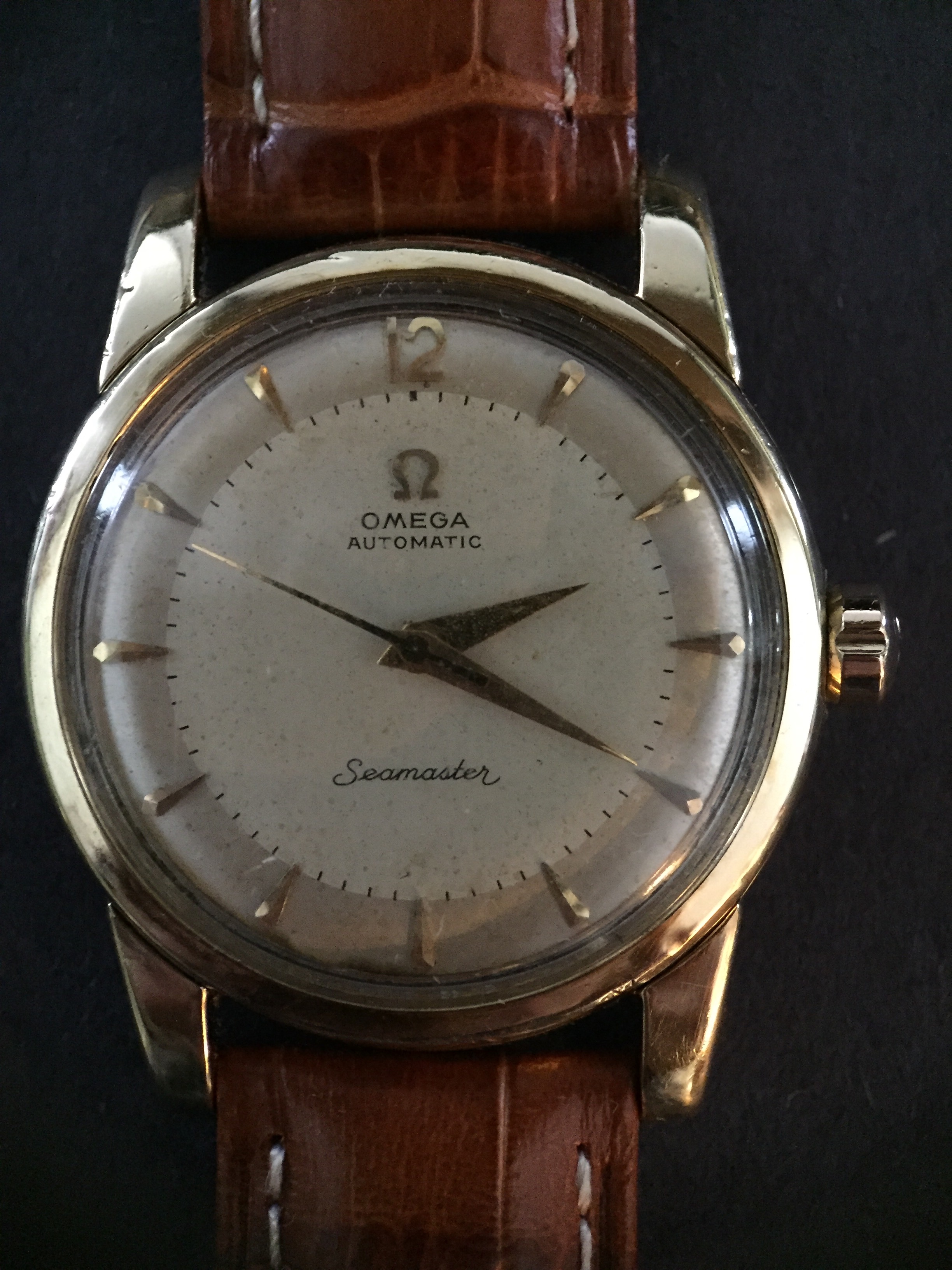

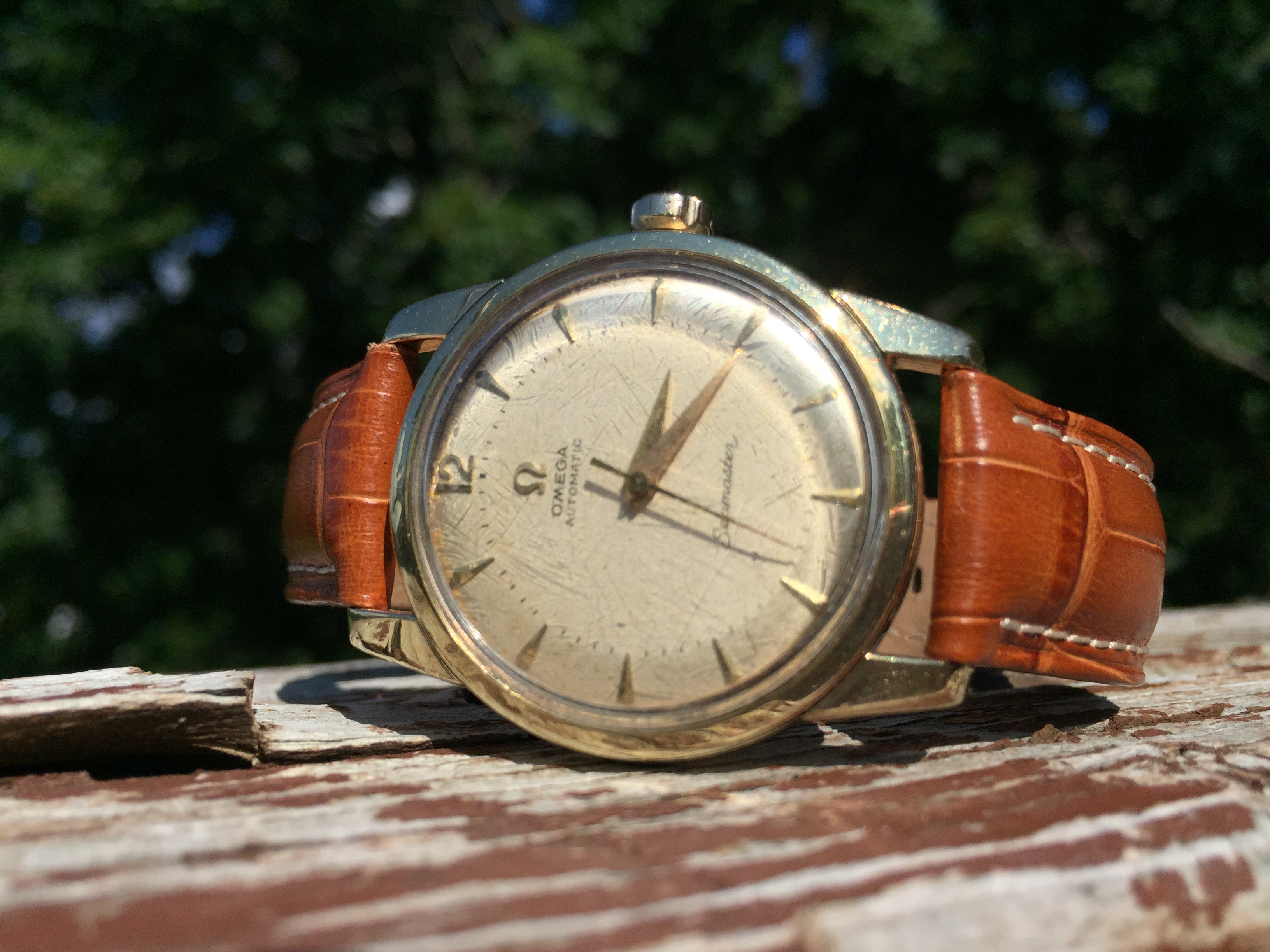

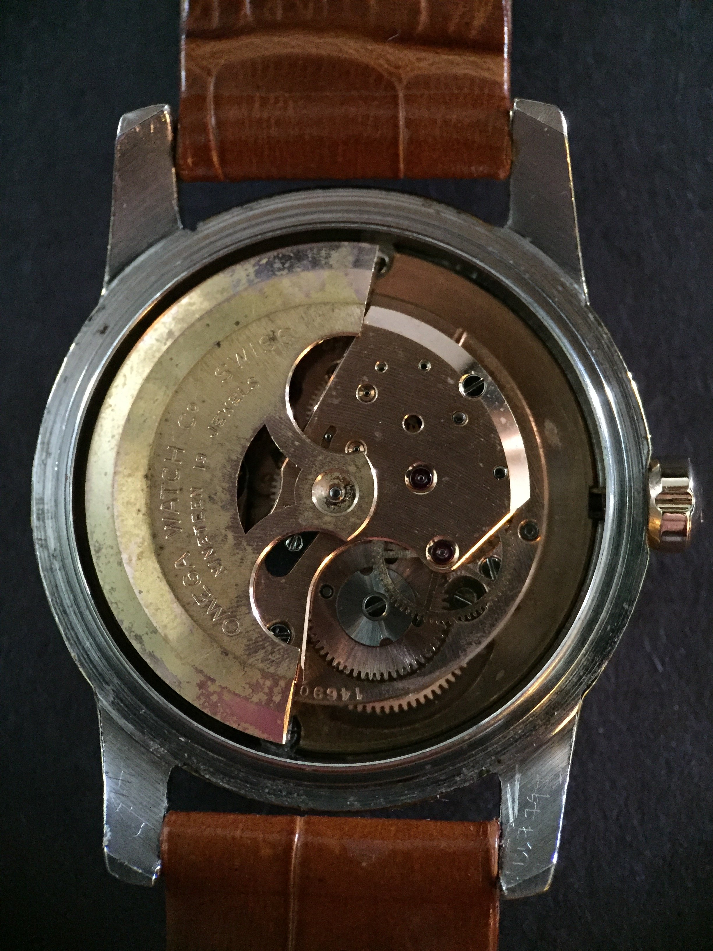

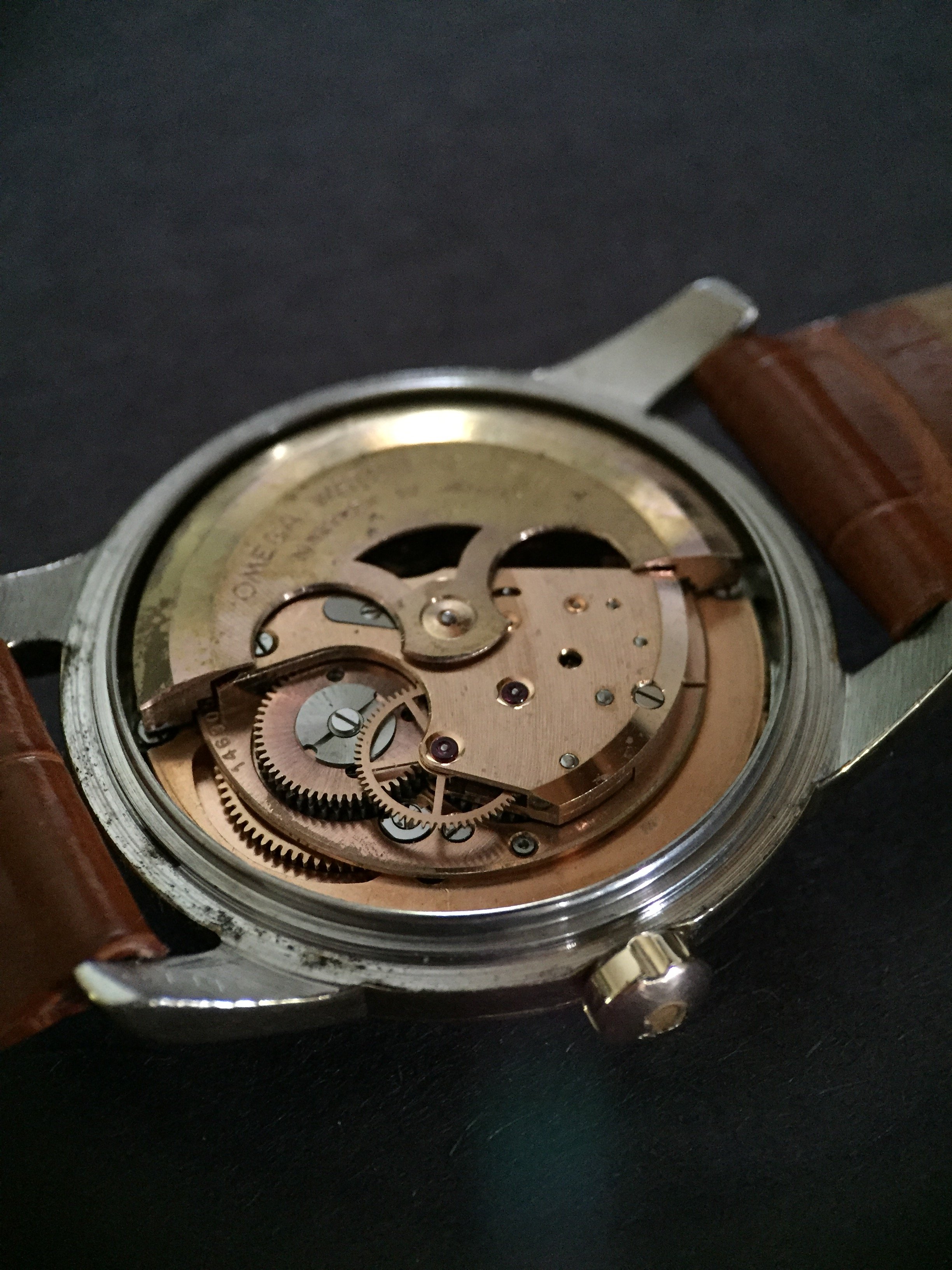

Is it in too bad a condition to be salvageable?

Do you mean they could do a cost estimate before they even have the watch in hand?
Just from the pictures?

@gbesq
No, you would have to send it to them to get a precise estimate. Tanner might be able to give you a possible range for the repair cost from the photos, but no guarantee. No harm in emailing him though.

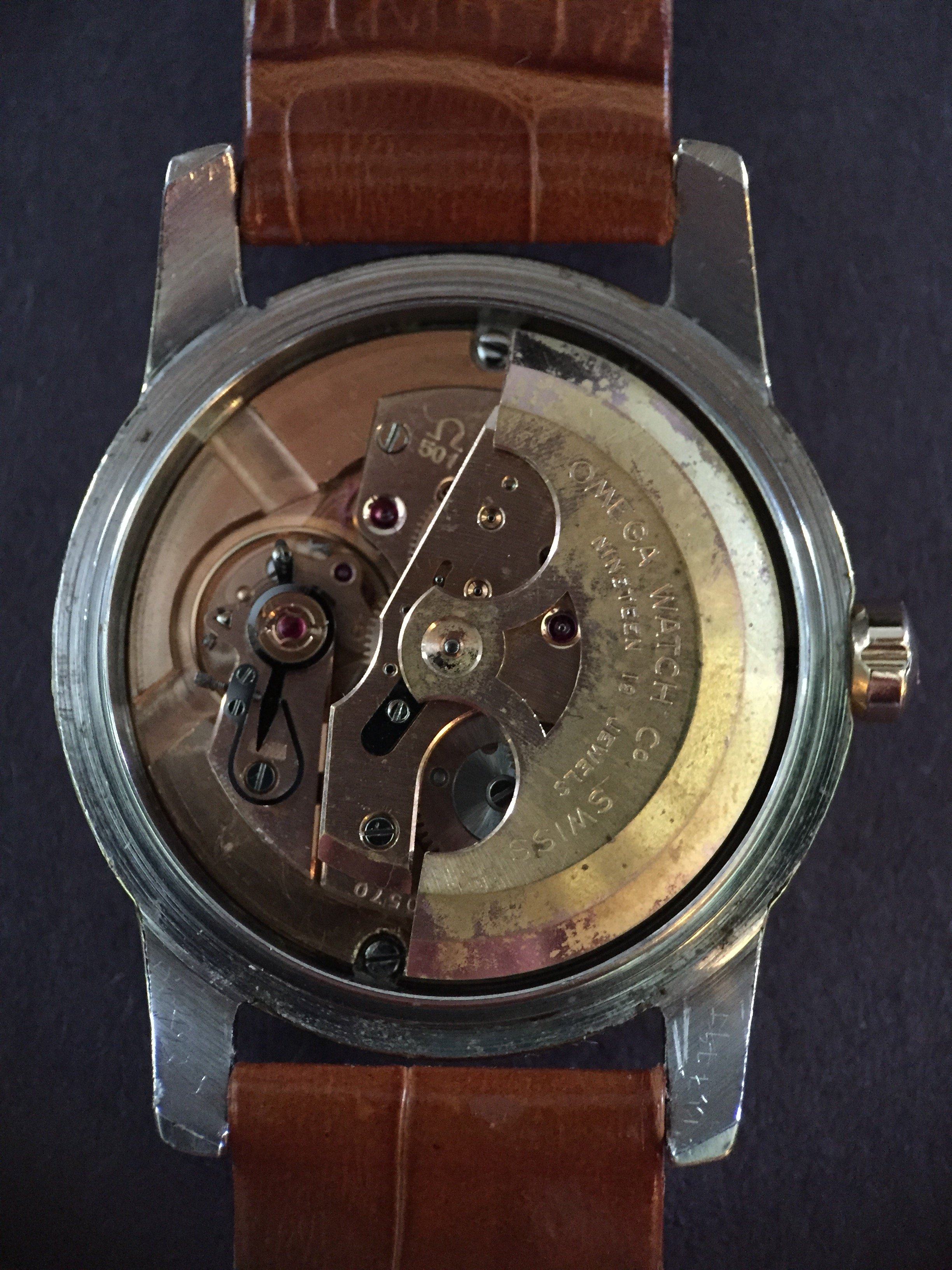

partswise Omega produced many watches so they are available still new for service of the mechanical parts. you should try to be certain he will not polish the case nor touch the dial. you can even come across a fantastic dial at some point in the future if you look thoroughly

I think you can get this sorted for reasonable money. My calibre 565 sat for years in non-working condition with a damaged hand (that was my bad) and the movement disintegrated when the watchmaker opened the case...
My watchmaker in LA was able to get the whole thing working again for $500 USD + 1/yr warranty.

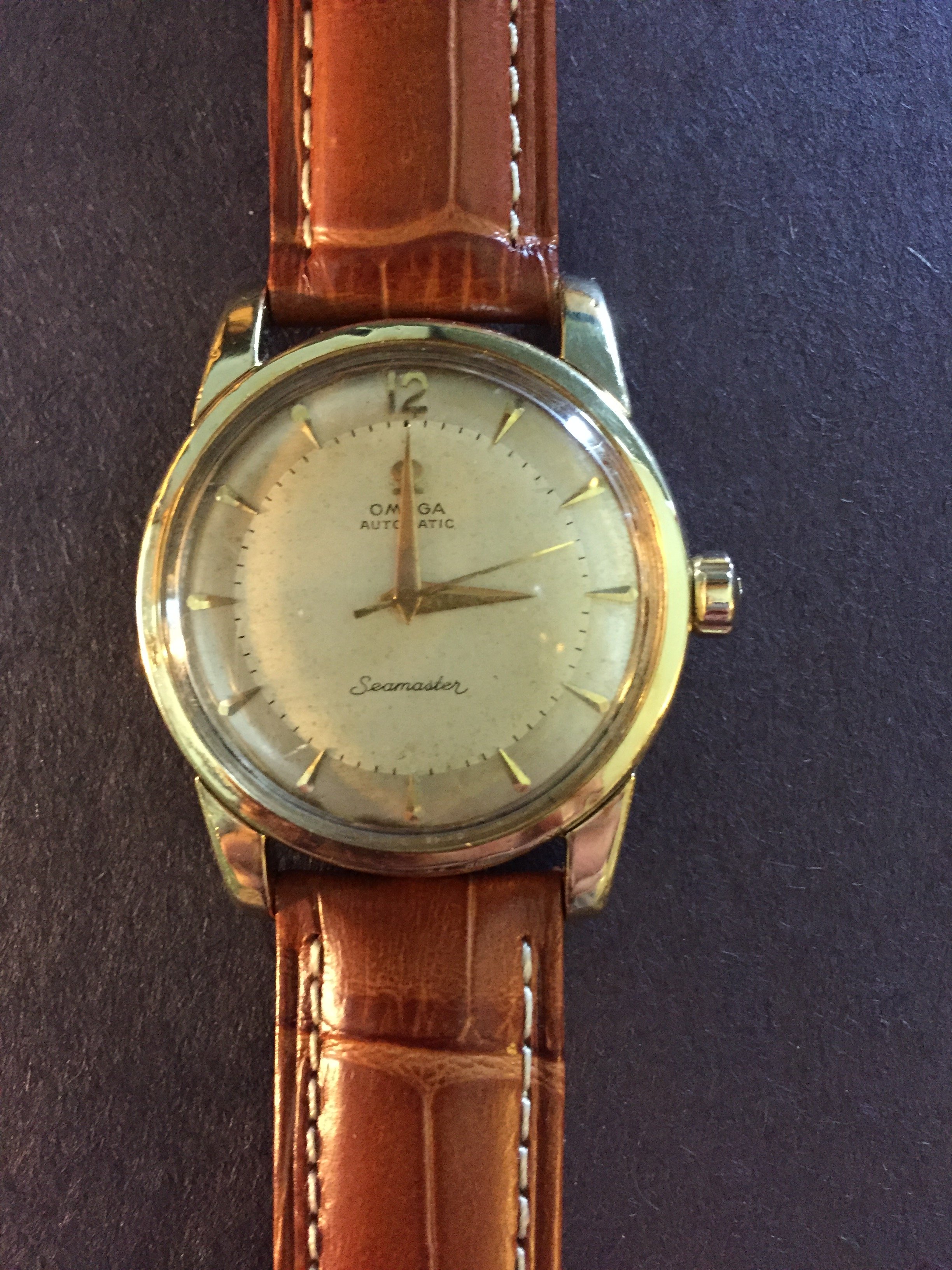

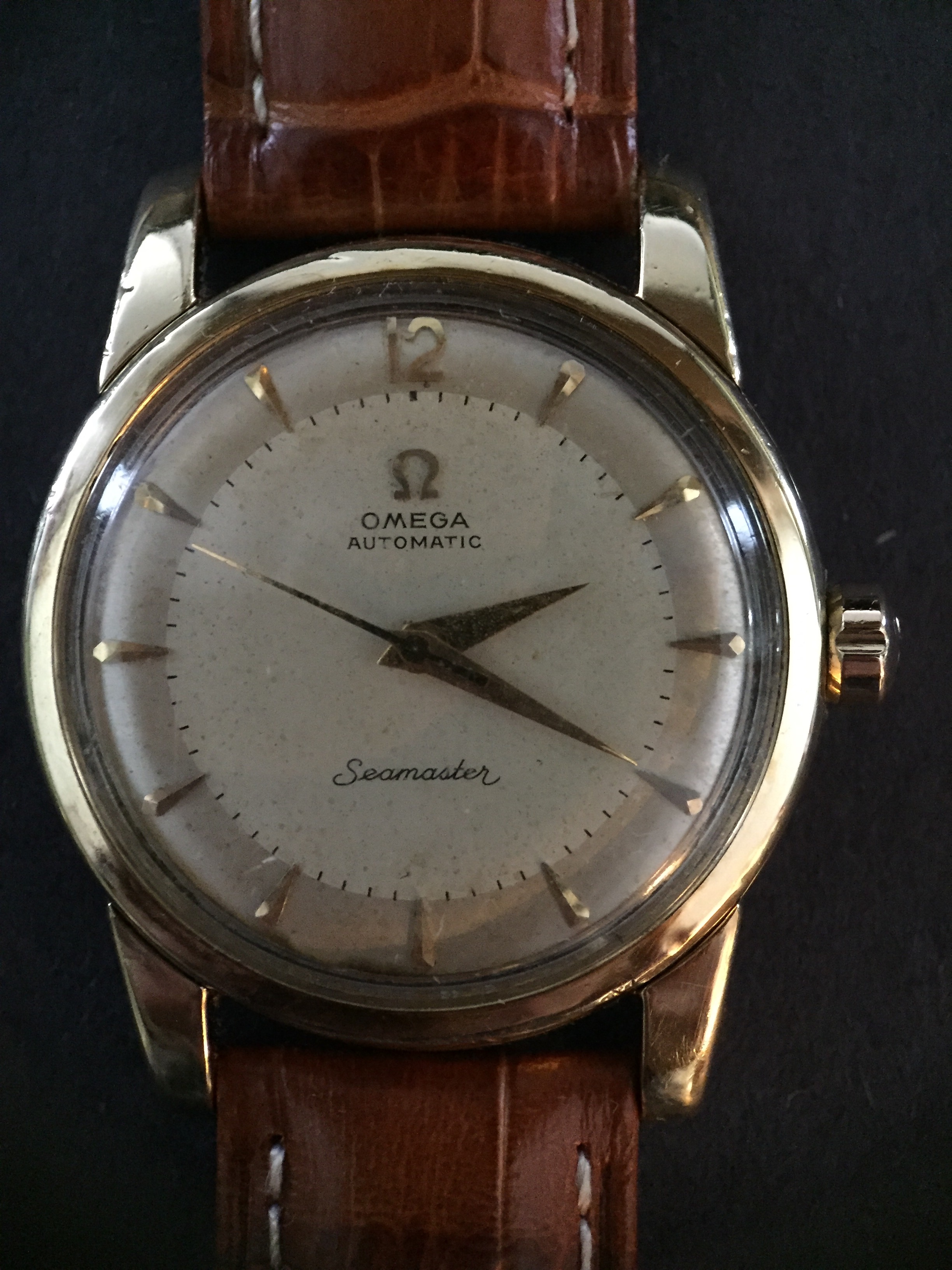

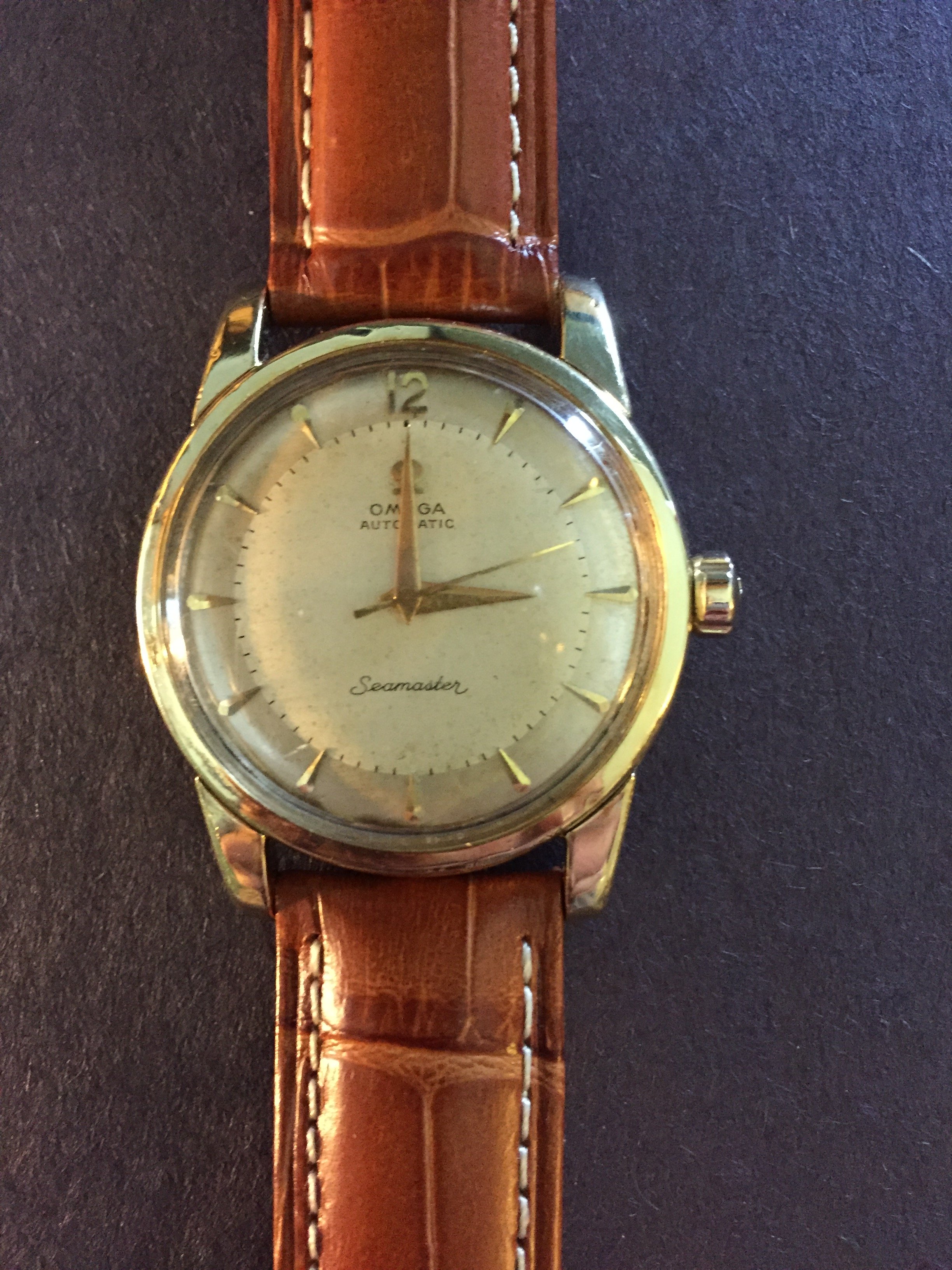

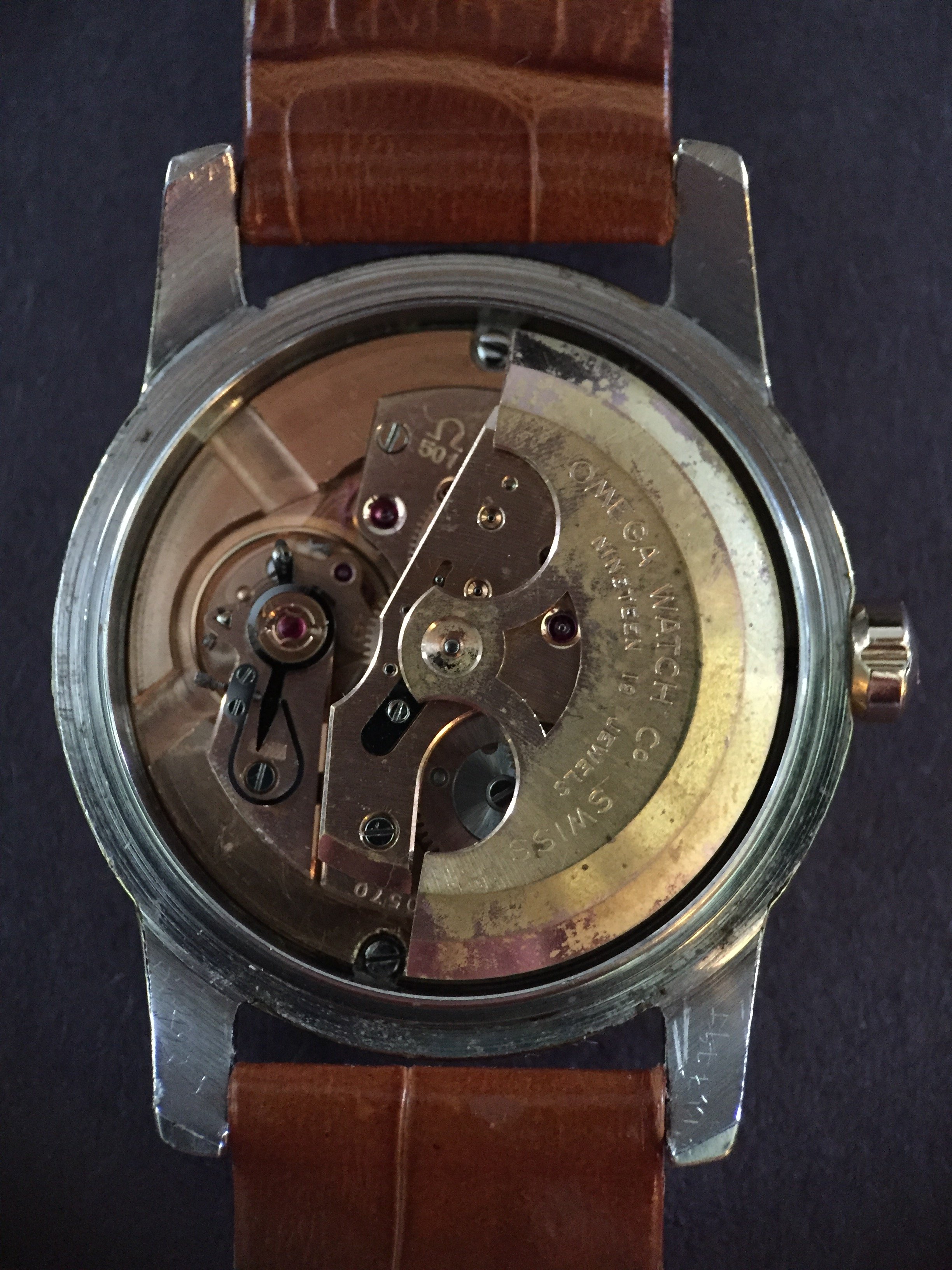

I finally had my watch serviced locally at the "Timeless Watches" boutique in Montreal. I believe the result is correct.
The watchmaker did not polish the watch case (that was the understanding), but I am a bit surprised that he did not polish or replace the glass which was and still is quite scratched (I would have thought that would be implied). The crown, which is missing a piece of the gold plating, has not been replaced, which is what was agreed.
The internal mechanism was dismantled, cleaned, oiled and adjusted. I was told that it was not necessary to replace any parts.
All the corrosion that was in the watch seems to have disappeared. The winding balance is still very much stained or discolored, but I believe this is of no consequence.
I was told that the watch failed the water resistance test, this is very annoying; I can't see myself having to take my watch off every time I want to wash my hands... it's a shame because it's going to put a damper on my desire to wear it on a regular basis, it won't be able to be my everyday watch in every situation.
As I have just received it, it is too early to know if it will hold the time accurately, but the work is guaranteed for 2 years.
I think this (limited) maintenance service cost me quite a bit; $850 canadian + taxes.
Overall the watch is clean and I am very happy with it.

Mmh. Might be just me, but I’d expect the regulator to sit in the middle after a service to leave room for small adjustments both ways in the forthcoming years…
I’m not surprised it failed the water resistance test, especially if the old crown was kept. You’ll have to decide yourself how careful you can be in everyday life. I’m wearing vintage, non-waterproof watches all the time and do not take them off when washing my hands. At the same time, I do so carefully and make sure they don’t get wet. I also don’t expose them to rain or steam during cooking etc.
A bit of care and you’ll enjoy this lovely piece for decades to come. 😀

Glad this has ended reasonably well. A couple of thoughts.
1. I would absolutely expect the crystal to be polished or replaced at service (or at least a discussion around your thoughts on how to progress). However, if it’s just scratches a combination of wet and dry paper or most abrasive polishing compounds, followed by a finer finish such as polywatch or even toothpaste should have the crystal looking better.
2. I’d also have kept the crown if I couldn’t source a period replacement.
3. Don’t be too concerned about the waterproof test. I wear vintage watches most days, many of which failed the waterproof test. I simply exercise common sense, be careful when washing hands, washing up/whatever. It could be worn most days with a small amount of care and attention

Thank you letouriste for reporting back on your watch. It has a good home with you and I would approvingly notice it if I spied it on your wrist.

Well at least the watchmaker didn't do anything you didn't want done. Sounds Iike a very basic service, which should hopefully be sufficient for you. You can always polish the crystal yourself. If you want them to do it, just take it back.

The watch is beautiful. One of the joys of these old birds is style and patina. One of the downsides is that to maintain originality, like the crown, one sacrifices water resistance. You will adapt. I’m so glad you had a great outcome!

Looks great! Polish out the crystal and you’ll be good. I also wouldn’t worry too much about the hand washing, unless you’re going into surgery. It’s nice to see a success story.

Congrats on the recovery of your precious heirloom, and don’t be disappointed, no vintage watch is water resistant ever. You just need to get used to being careful and wear a cheap quartz « beater » watch for rainy weather, gardening or sports activities which may involve shock or water.
Well worth bringing back to life though, the dial is very charming with its patina, and the original clover crown is beautiful so always nice to retain.👍
