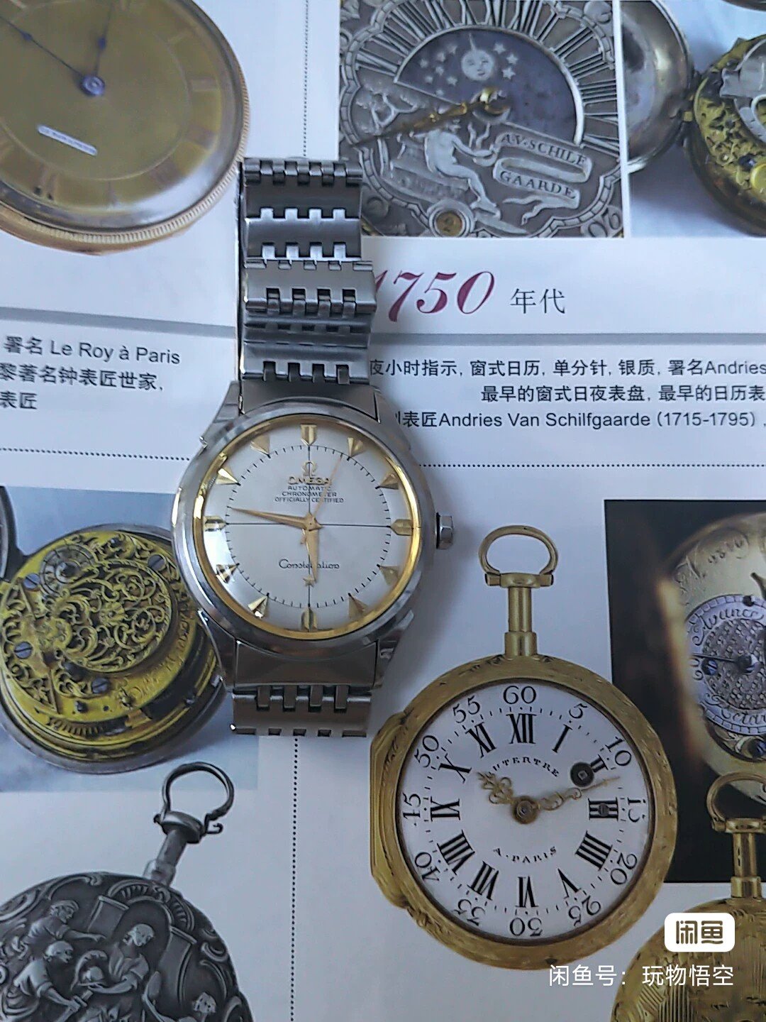

Posts 562 Likes 2,735 cqing ·Oct 20, 2023·yolo Hello fellows, I came across this connie today. Does it look legit to you ?

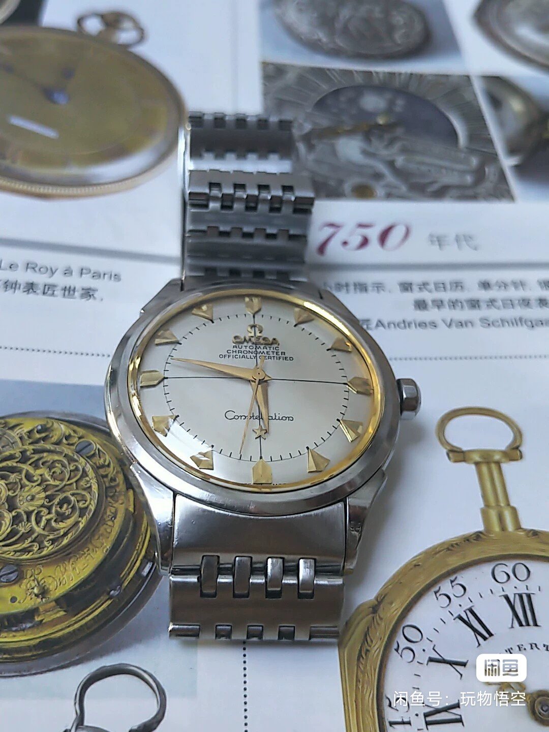

Posts 24,837 Likes 55,260 Dan S ·Oct 20, 2023 Dial is poorly repainted, in addition to some other weird things going on.

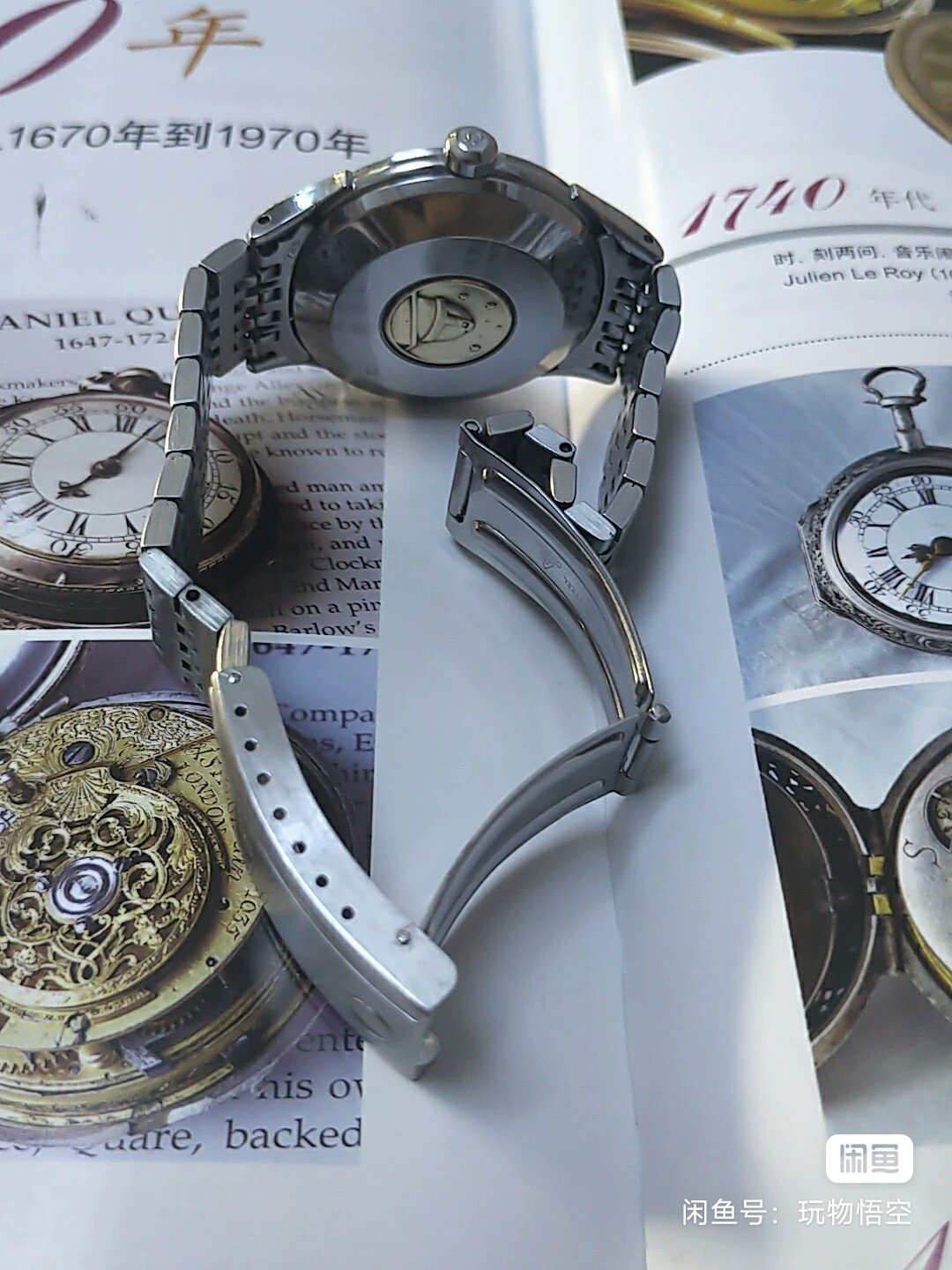

Posts 500 Likes 966 pmontoyap ·Oct 20, 2023 I guess it depends on your definition of legit. The parts are authentic Omega. Bracelet is adapted, dial is refinished, the crystal has the wrong colored tension ring.
Posts 562 Likes 2,735 cqing ·Oct 21, 2023·yolo Thanks for your kind input. There is indeed a long way to learn. Actually I thought the printing looks ok to me... Thank you again!
Posts 907 Likes 1,742 Bruce235 ·Oct 21, 2023 The first redial tell is the heaviness of the crosshairs. There are more after.
