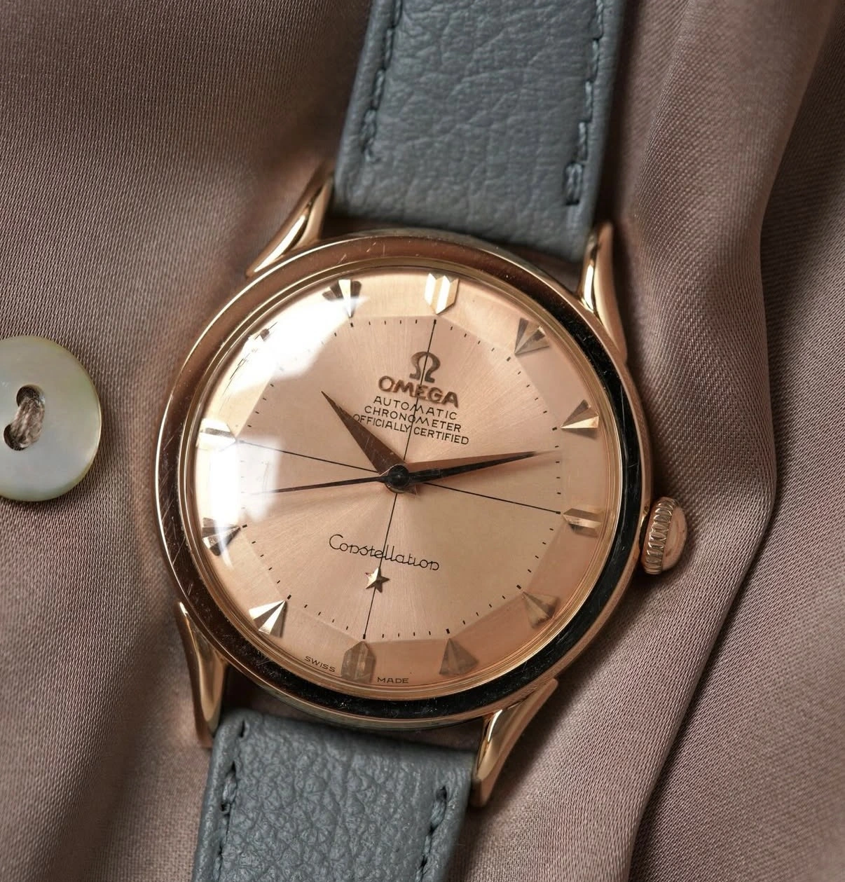

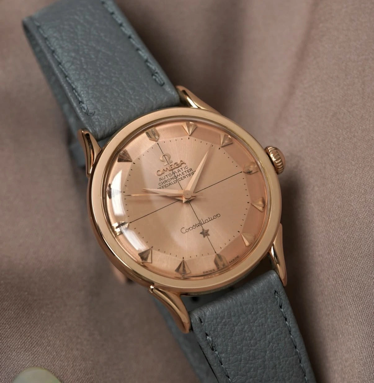

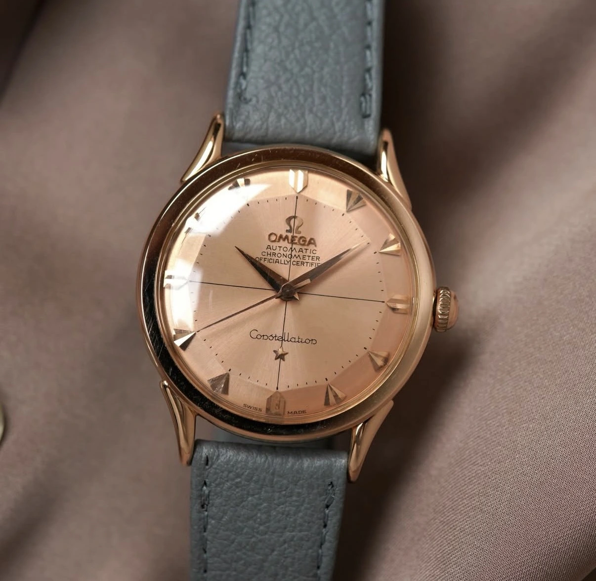

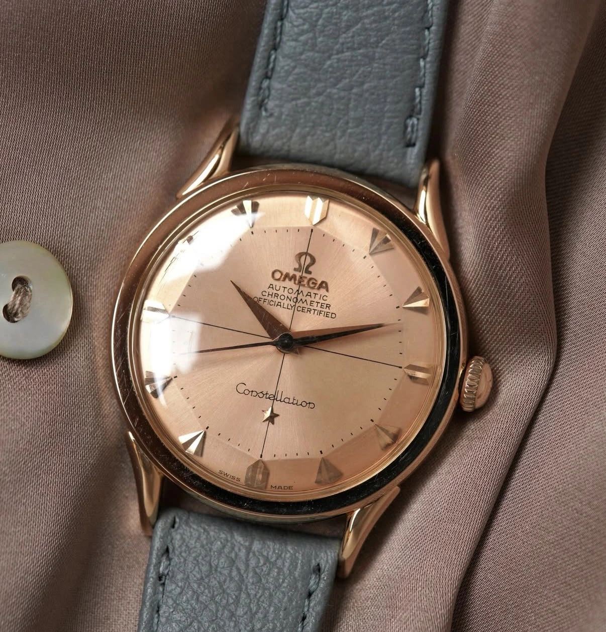

Hey folks,

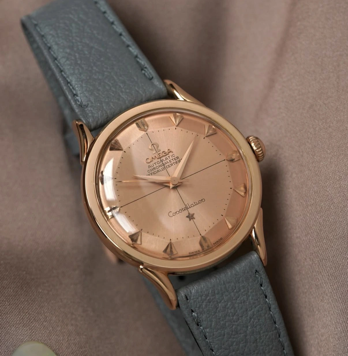

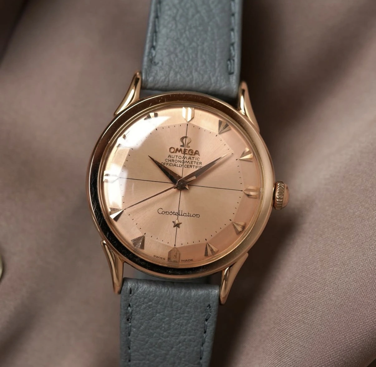

I figured this one might be an appropriate training exercise, as it certainly combines a few uncommon features. Just to be clear: I‘m not purchasing it, it’s simply for practice / discussion.
The watch is currently available from a dealer who I’ll leave unnamed. Pics are all from them.
Share your thoughts, what do you think - is this one legit?

Hmmm, not a FAB SUISSE dial?.........🤔
6,836
10,508

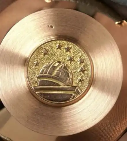

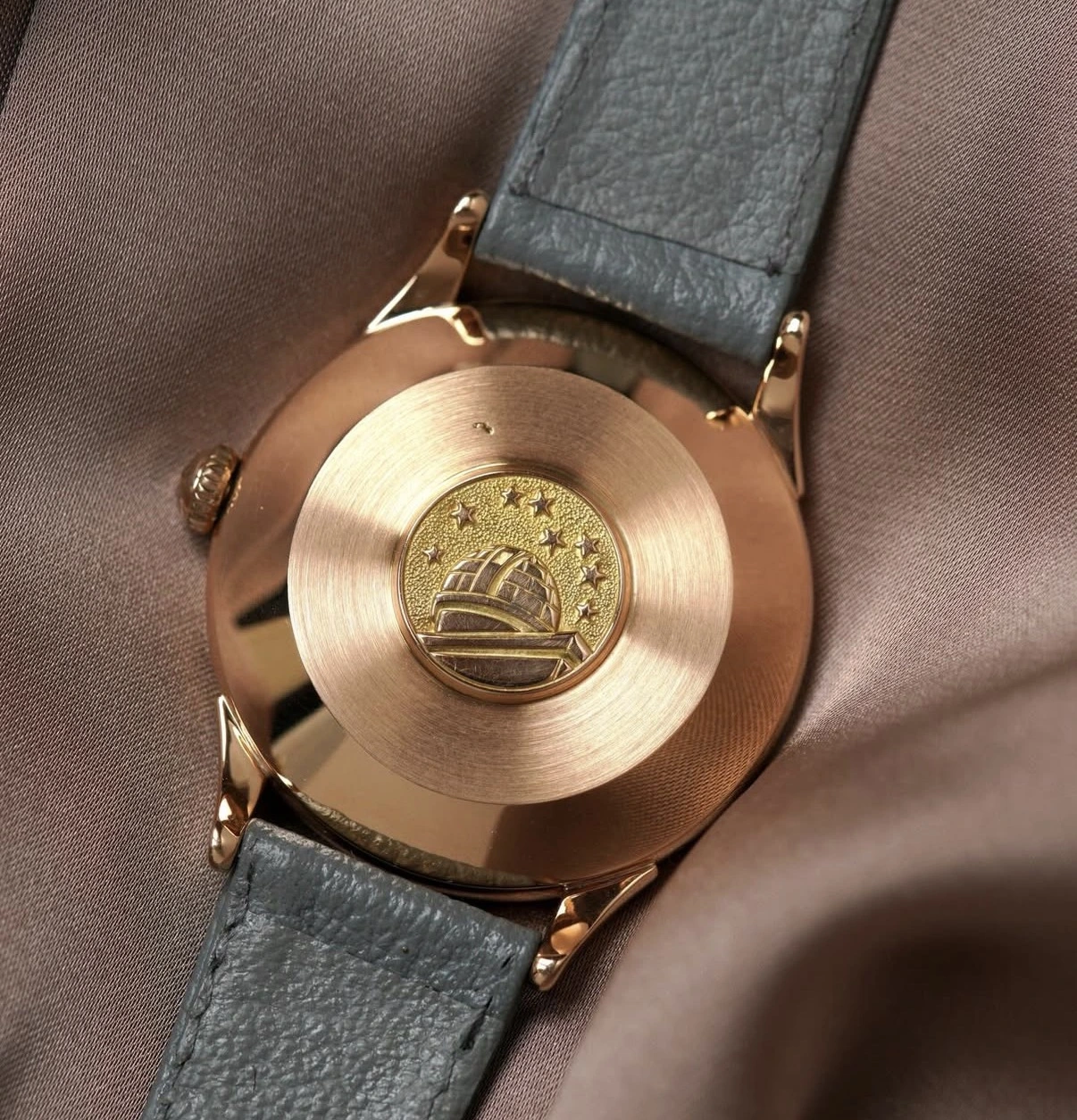

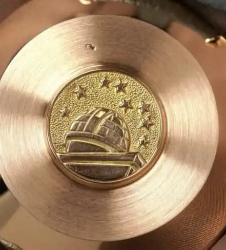

Interesting subject matter @MtV.

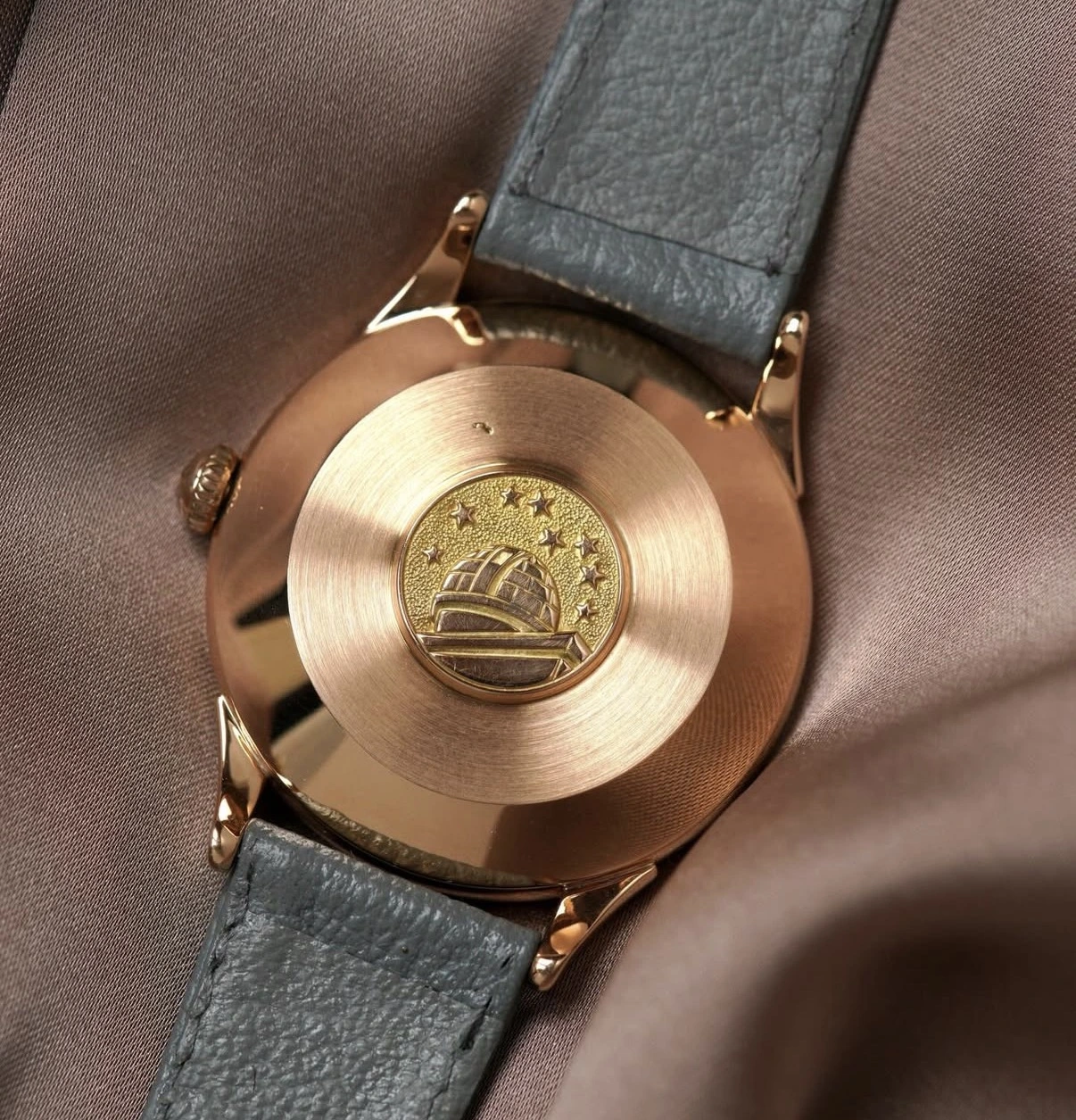

Assessment not made any easier by being a French production case - so (if anything like English Constellation cases) the case style could be anachronistic compared to Swiss cases.
However - Doesn’t explain why (or how) there appears to be a (correct looking) yellow gold medallion in a solid pink gold case.

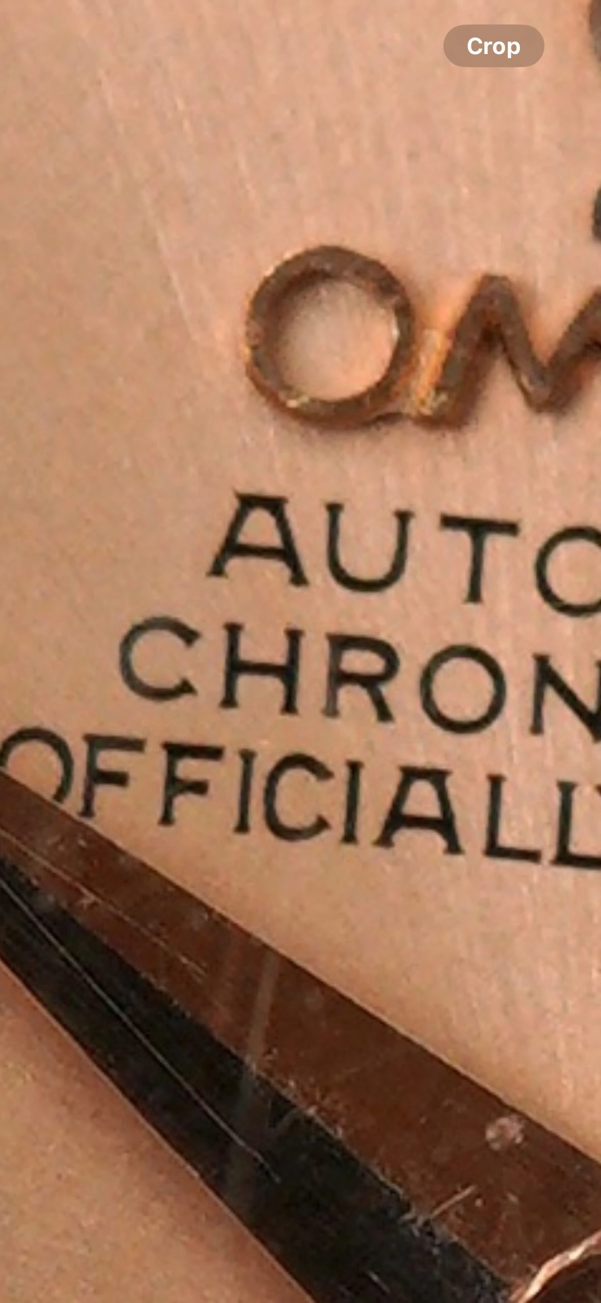

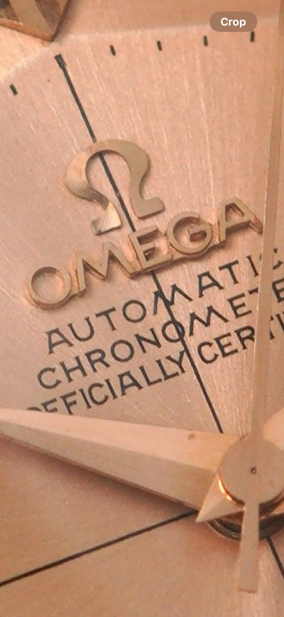

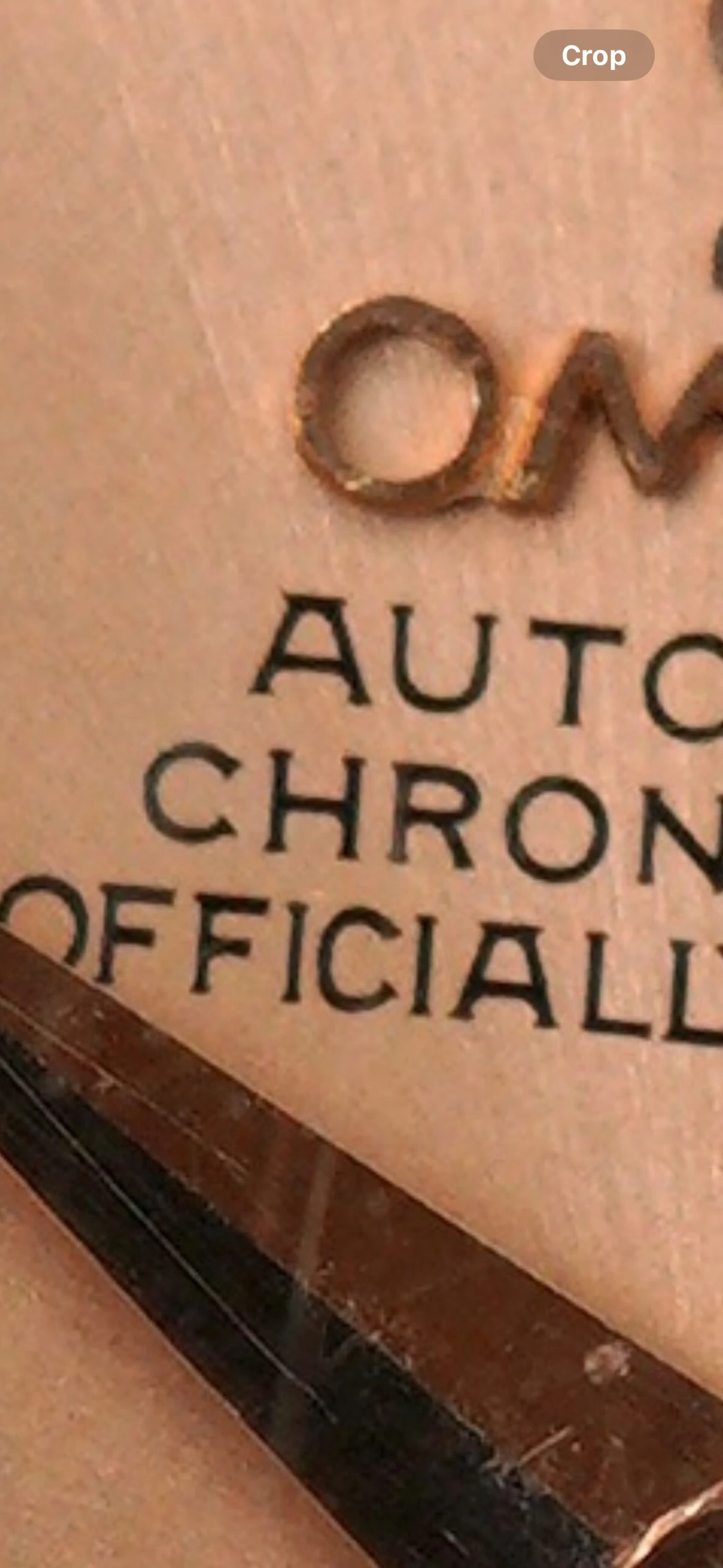

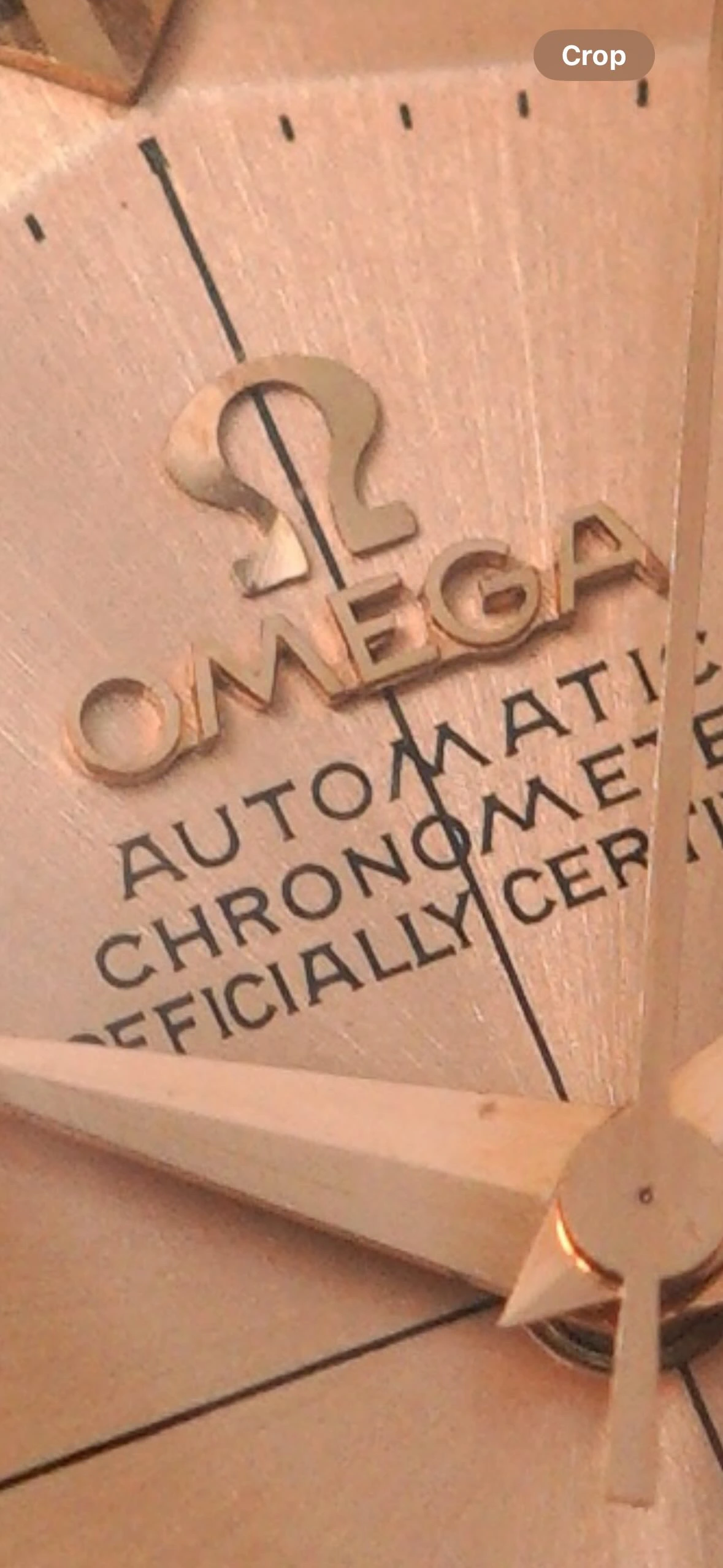

IMO the dial was redone:
Crosshair is too thick
"Chronometer" instead of "Chronometre"
Missing I-dot
6,836
10,508
The vertical cross hair shouldn’t touch the ‘e’.
In fact, it may be the angle of the pics but all of the script looks to be up slightly on the right hand side.
The minute haches look a little ‘mean’.
The dial looks to have been stripped - and presuming it is meant to be a pink gold dial, I can’t remember seeing a solid gold dial with a sunburst effect.

It's being marketed as a "salmon dial"...
Ah!
‘Special order’ - obviously….
1,414
13,633
Not a spécialiste at all here but comparing with my constellations : the y of officially is closer to the crossline and the e of constellation too…
And I have no RG one but indeed I am surprised to see à Yellow gold médaillion here.
If I were to buy I would check those
Can you remember seeing ANY 50s pie pan dial with sunburst effect…?
6,836
10,508
Nope!
8,883
62,943
Redial
The “n’s” in Constellation are uniform, which should not be the case.
325
511
redial. Crosshair looks a bit off, and that yellow gold medallion doesn’t make much sense.
2,671
2,856
I'm sad it isn't legit. It looks great from a little distance.
That said, the MOY test plus the 12 oclock marker being cattywompus immediately made me suspect a redial.
Since it isn't an Omega cased watch, I can't make conclusions on the medallion itself, its a bit odd, but who knows what the french were thinking (said comment applies to... forever I guess?)?
That said, a rose-gold Pie-pan case + dial (though I prefer date!) is IMO the nicest configuration.
