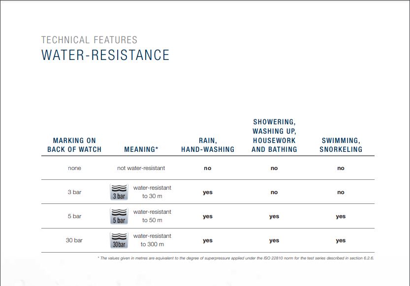

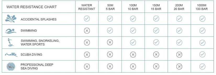

Found this other brilliant chart

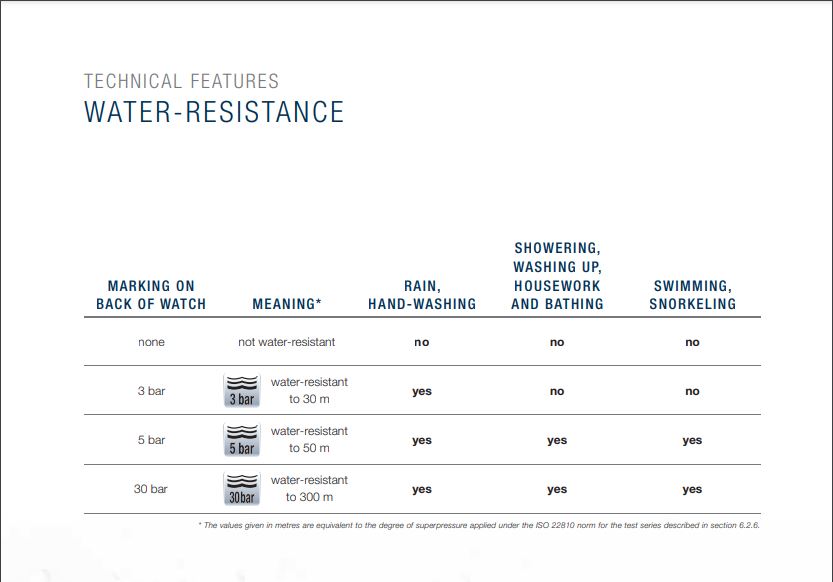

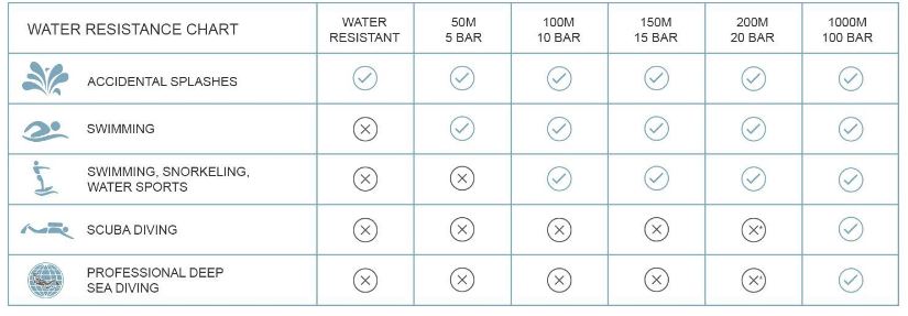

Here's the link to Longines' online .pdf
https://www.longines.com/uploads/customerservice/userguide/technical/pdf/EN_Screw_down1.pdf
But generally if i understand correctly, (i can already feel Yoda standing behind me with his light-sabre drawn) a 50m rating does not mean you can go swimming about 50m beneath the waves then come up and expect the watch to be ok, the pressure exerted on the seals at this depth is quite something, and your arm movement will help force water molecules through the seals, then upon surfacing the heat from your wrist will cause them to condensate on the inside of the crystal, so a 50m rating is if it's static and no extra pressure is exerted on the seals with movement, tidal or otherwise, which is why the manufacturers usually prefer to use atmospheric pressure as a guide, although this is not as attractive to their dive-watch buying market, who like to imagine their watch being robust at a depth who most recreational divers don't even go near, 25m is the bsac and padi standard for most divers with the open water type certification, my maximum permitted depth is 18m and i consider myself a novice diver with only 23 dives in my book, i went to 20m once in thailand and visibility was greatly reduced so i can't imagine what 50m would look like, but you can feel the pressure increase even in those two extra metres, so it's considered that swimming on the surface with a 50m rated watch exerts about the same pressure on the seals, (once all the arm movement is taken into account) as if it was sitting static 50m down with no movement of water around it
