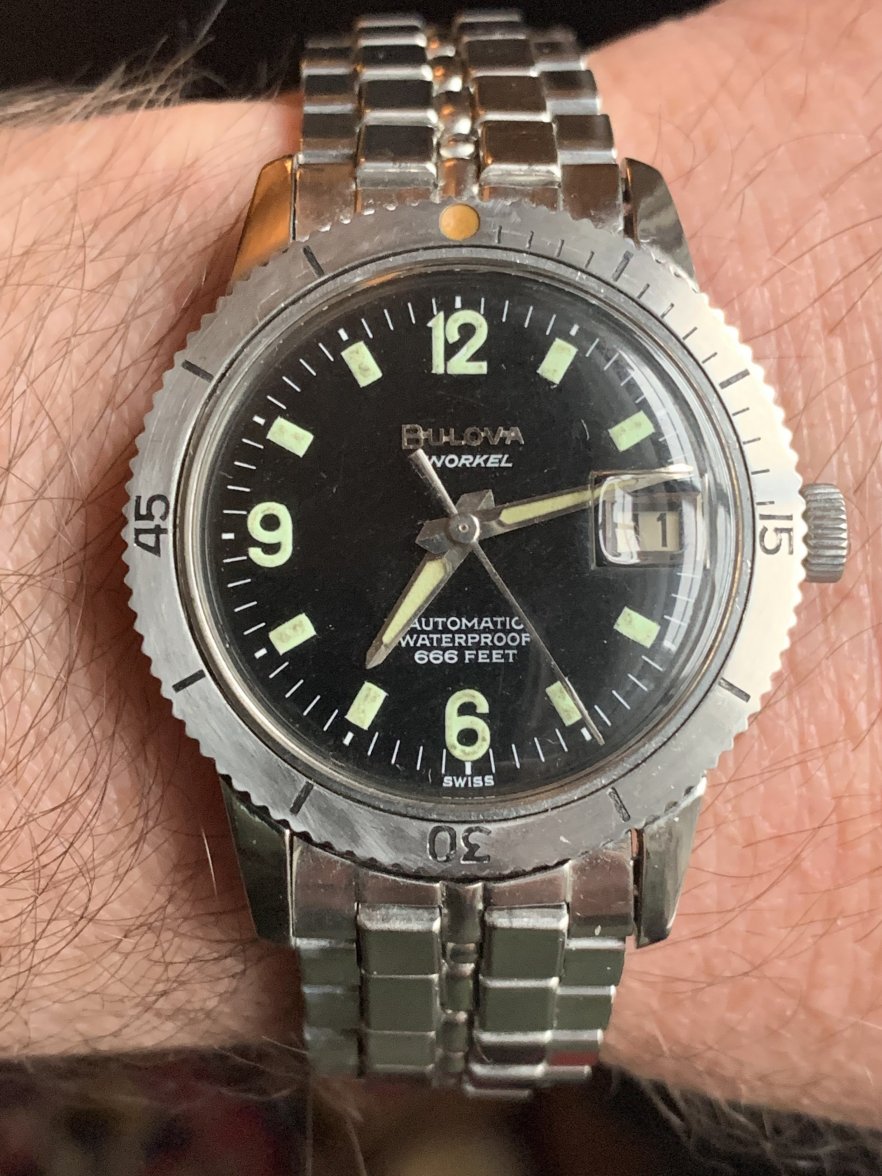

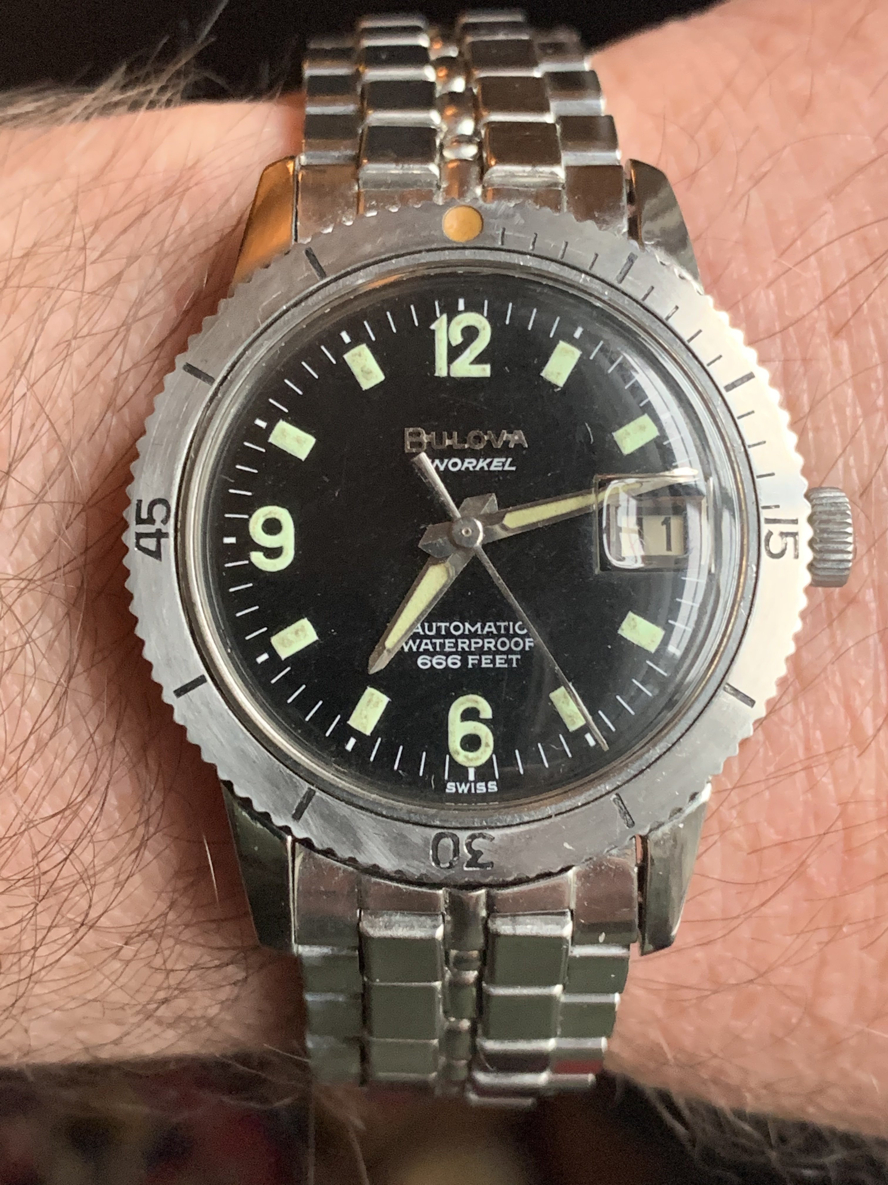

Now I will say, do not attempt to Snorkel with any watch that is not specifically rated for the activity! 😗
And now everyone Snorkel!!
