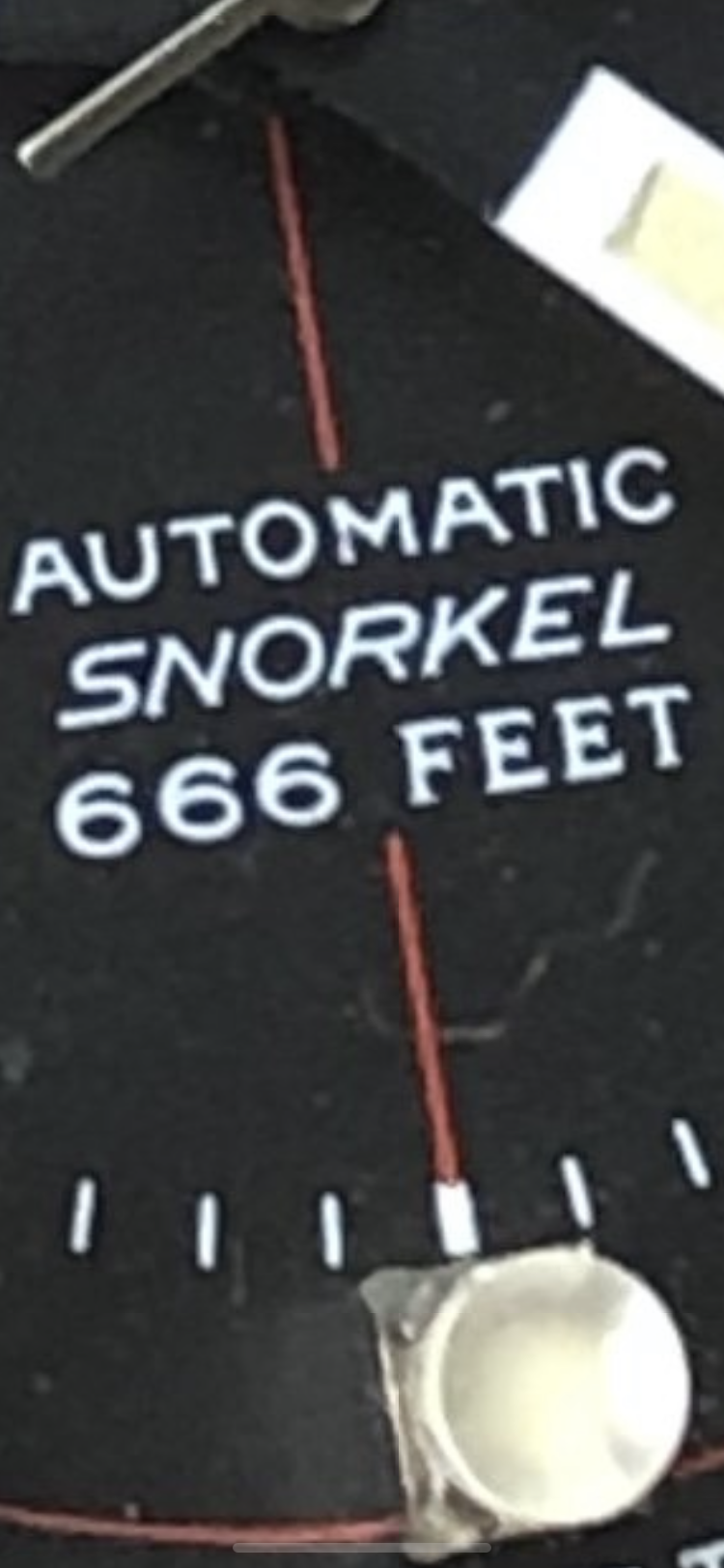

There is only 1 depth rating that matters, and it’s not in meters.
6,473
31,881
Of course, all of the foregoing assumes that 50 meters is indeed 50 meters.
Well I heard the international foot will be the standard and US foot won't be used anymore from 2023 on, but haven't heard of meters having different measurements.
