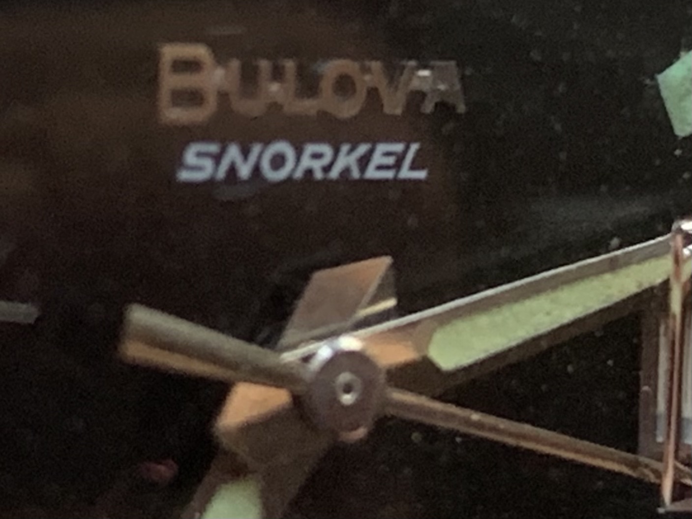

@fc3861 - welcome to the forum BTW, you may already see there is much history around this topic- and it involves drinking and snorkeling.
As a 20 year owner of a 49 year old Speedmaster- who regularly serviced and replaced all seals on my watch, I can tell you that I have taken spills in rivers, been caught in rainstorms, sweated through my clothes, and vigorously washed my hands- all while wearing my Speedmaster. My watch has never leaked. That said, I have never been so cavalier to think that my Speedmaster could be considered a watch that was designed for watersports so exercised intelligence when approaching any activity in which I was planning to submerge the watch. Sure, it could probably do it- but do I want to risk that?

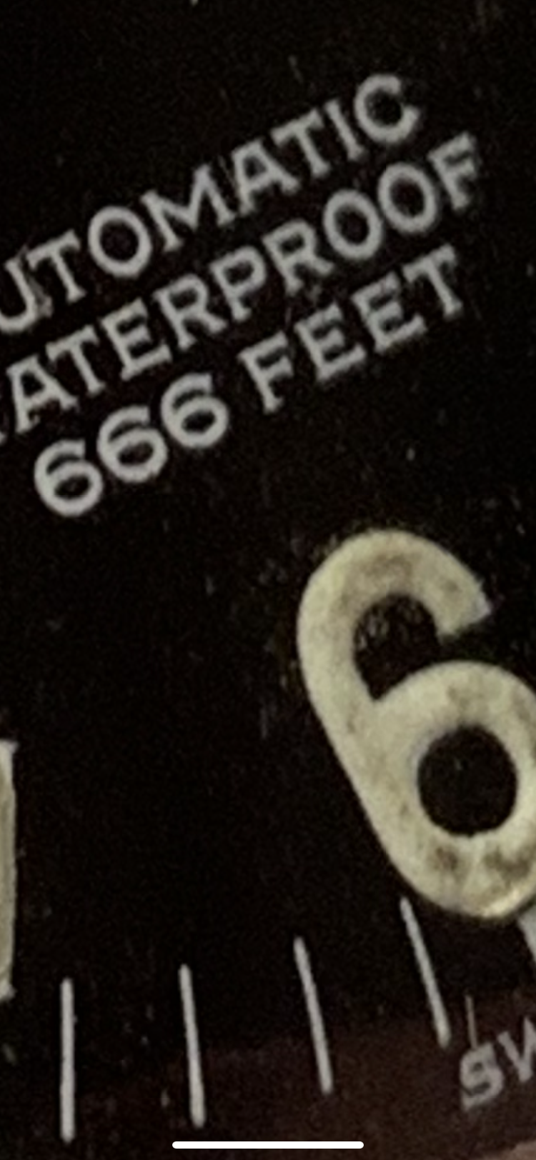

In preparation for the continuation of these endless arguments, I present the following...
If you look at the ratings of the watches, and the depths they go to, and the modes of failure, it is safe to assume that there is a significant safety factor built into these watches that aren't going to be exceeded by dynamic pressure from any activity a human is likely to survive.
