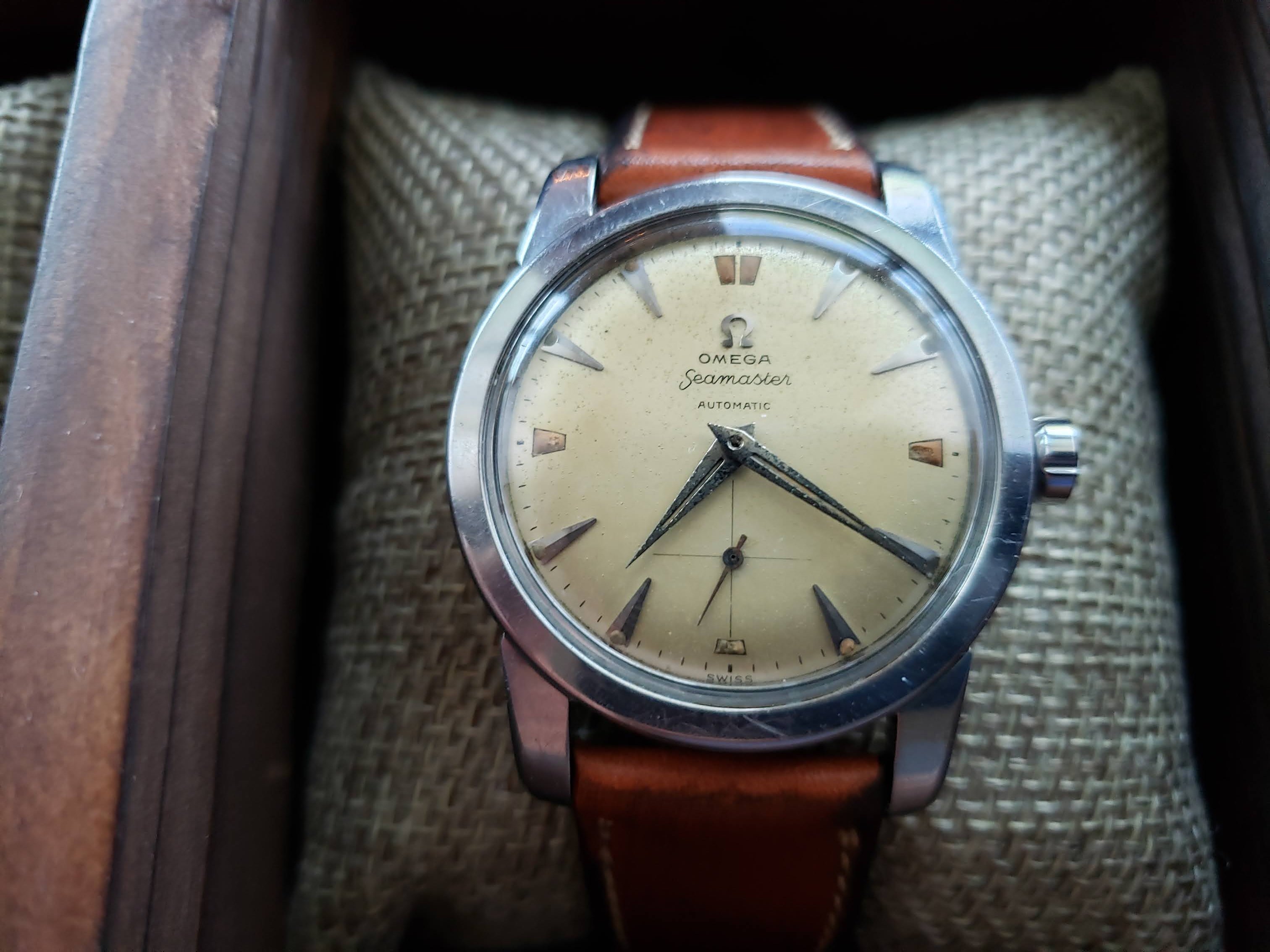

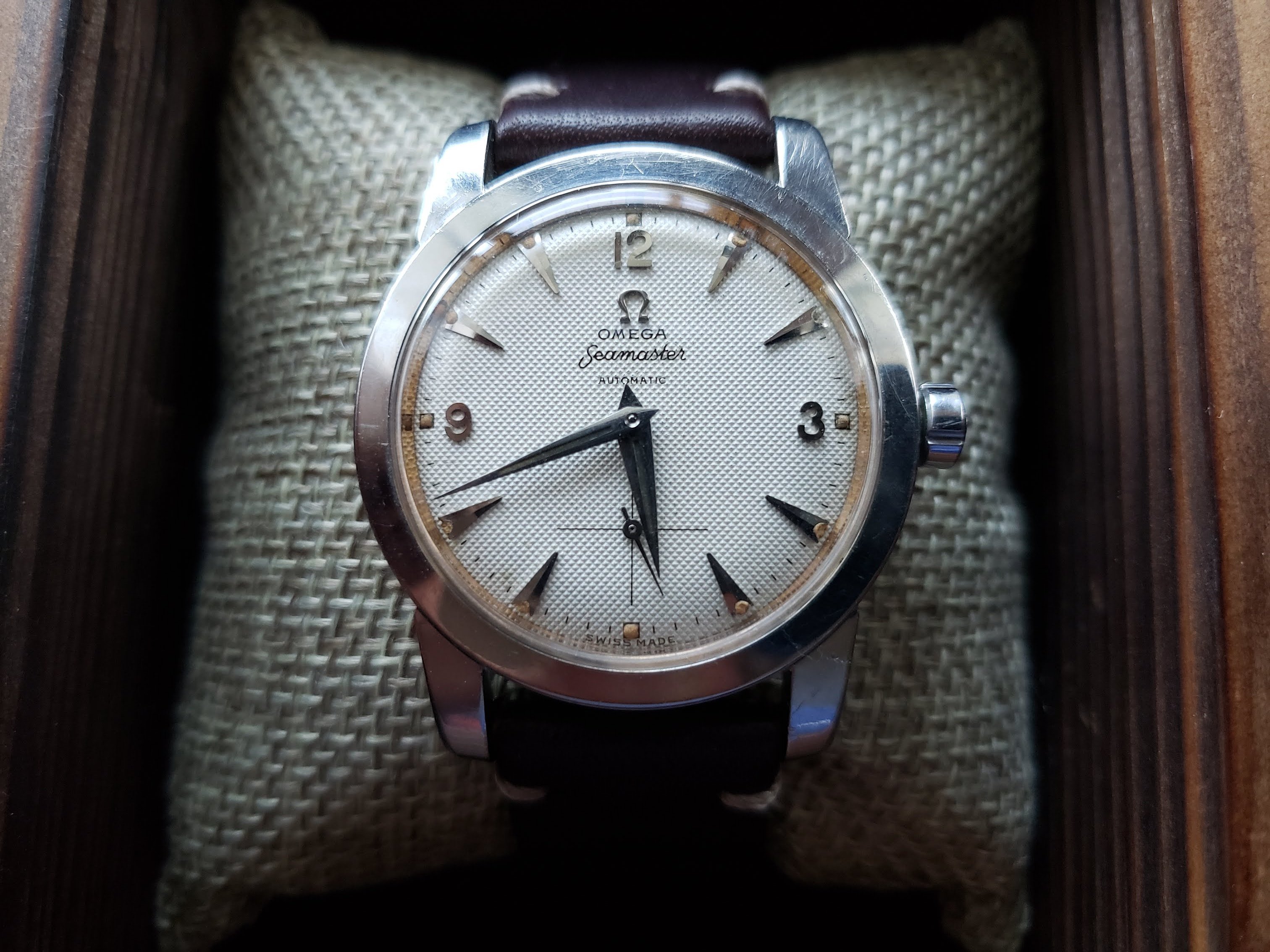

On the vintage side, I'm a huge fan of the beefy-lug style Seamasters. I've hauled in two 2576's that I like alot:

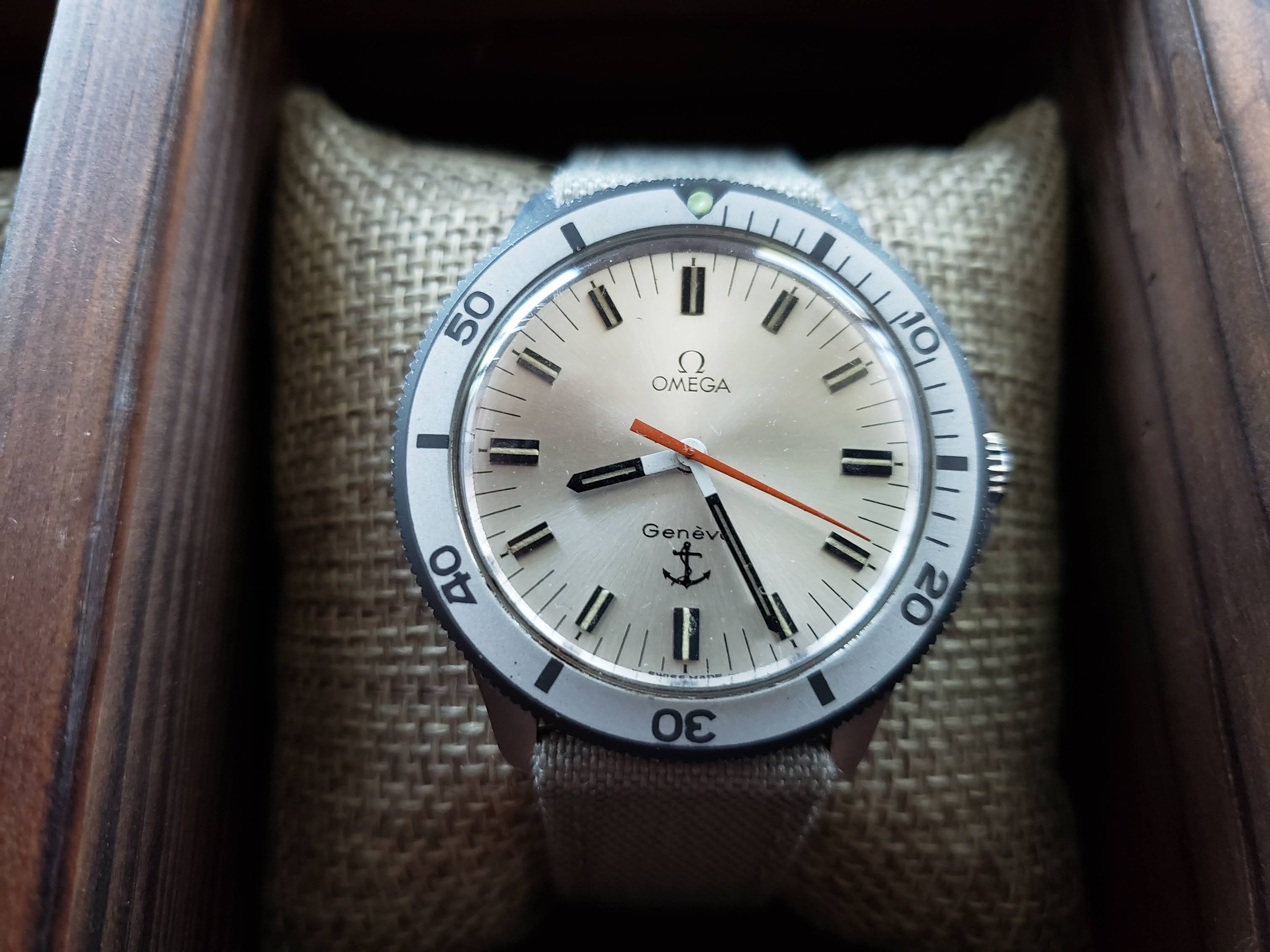

I've also got an Admiralty that's a really fun watch to wear:

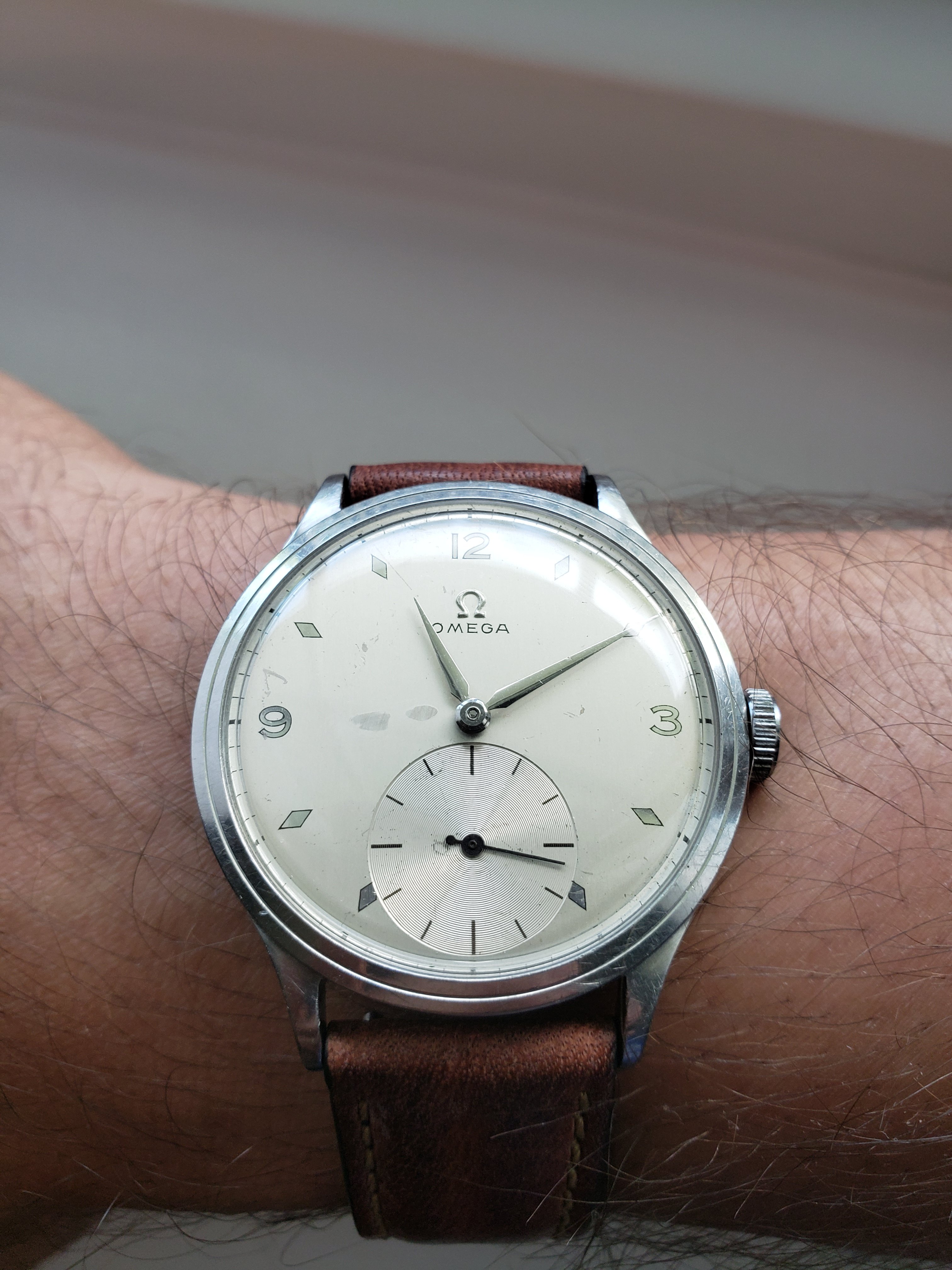

and lastly I've got a 30T2 that was the first vintage Omega that I really fell for. Lately, though, I've been wondering if it was my noob-tax...

-The original signed crystal on the honeycomb 2576 was scratched up pretty badly, and my watchmaker replaced it with a generic. Well now I've gone ahead of scuffed up that one too, so I'm back in the market for a new crystal there. Can anyone point me in the right direction of the correct Omega replacement crystal to use there?

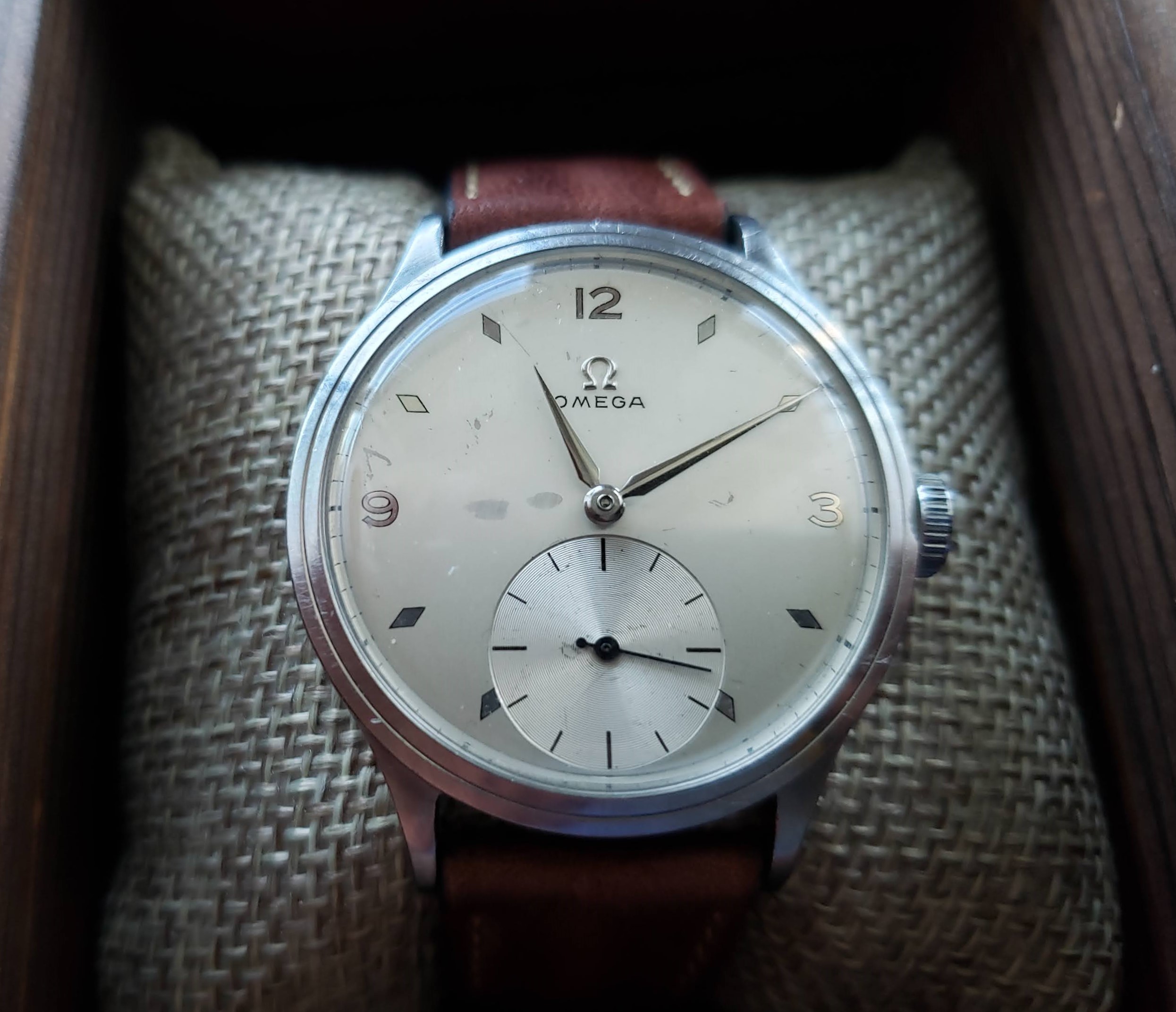

-Second: Any opinions on the 30T2 and whether it was my noob-tax? I got it on ebay several years ago from the seller "Mr Shrekman", and his description said that everything was 100% original. I didn't have much experience at all with omegas back then, and figured, "well, if it's on the internet it's gotta be true..."
So I send it out for a service and my watchmaker is like, "the other parts seem okay, but the hour and seconds hands are straight up generic otto frei blues." I ended up replacing them with Omega NOS lance hands that I thought went well with the dial, but looking back, leaf hands might have been "correcter."

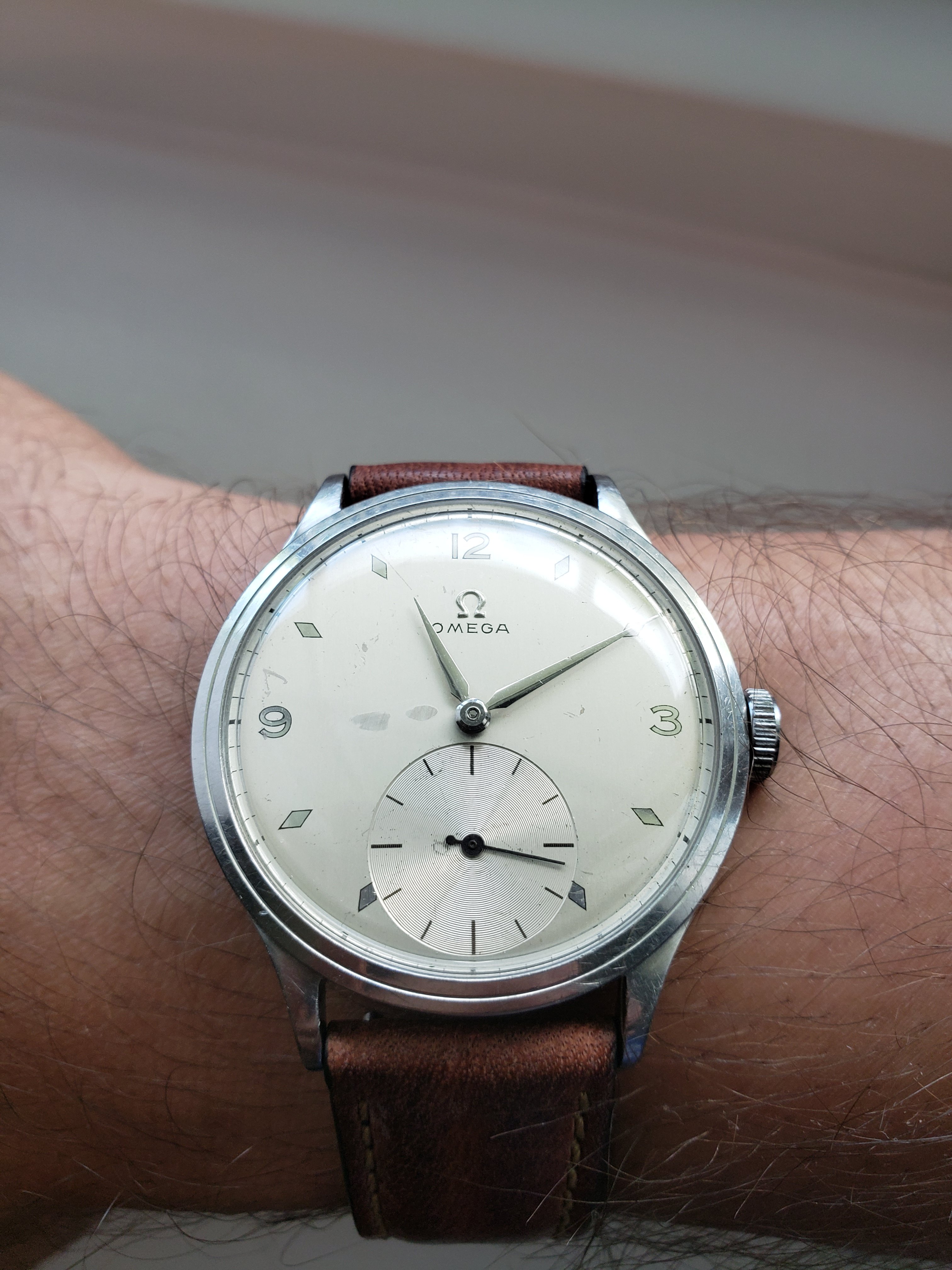

So now that I know the hands were wrong from the get-go, I've got this nagging feeling that the watch might be a complete franken. Here are a few things I've been questioning:

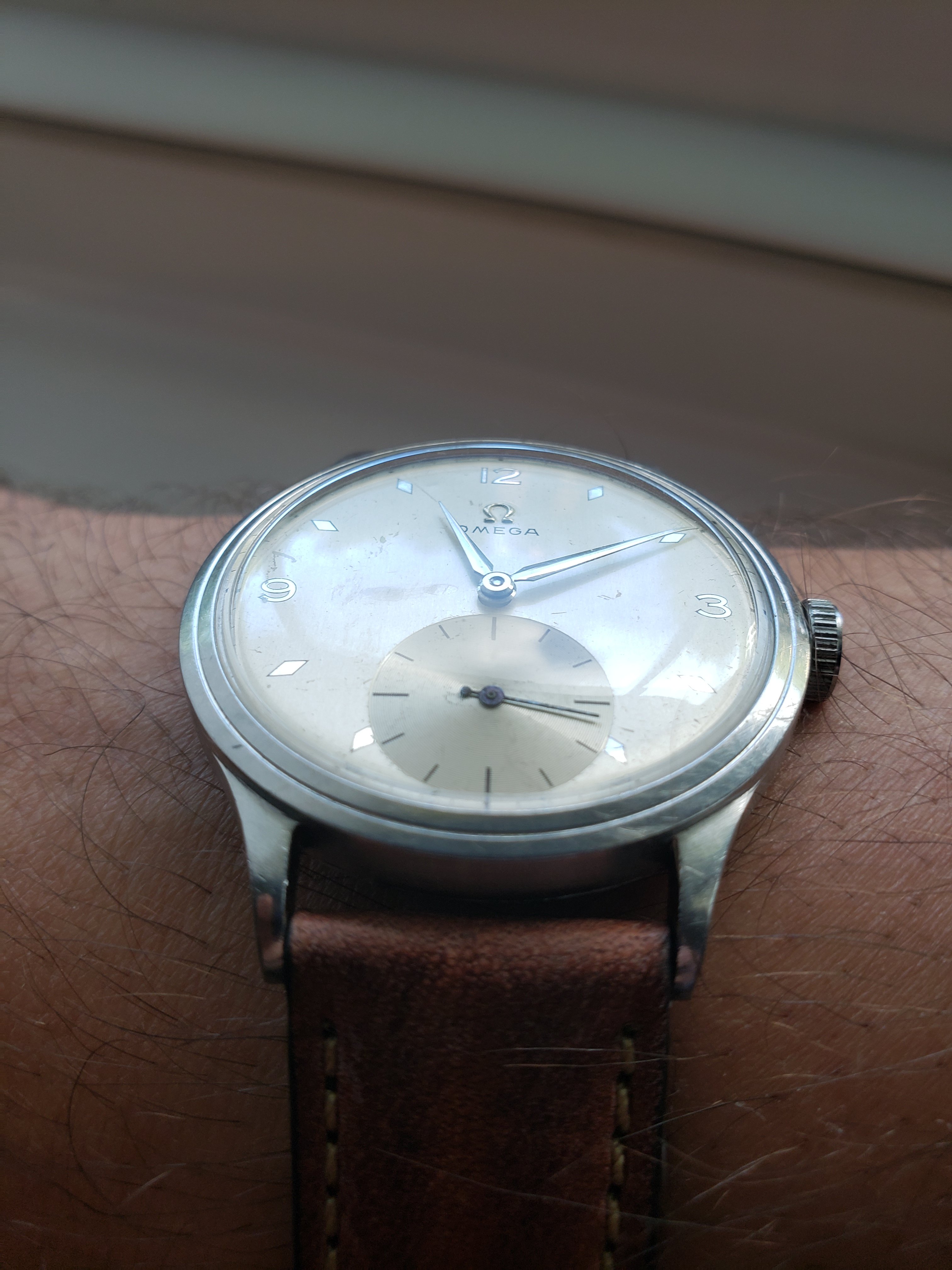

-The outer chapter ring is very visible at the edges of the case. My watch maker changed out the scratched high-dome crystal that the watch originally had for a low-dome and he believes that the low-dome makes the edge details less visible than the original would have. I have no idea.

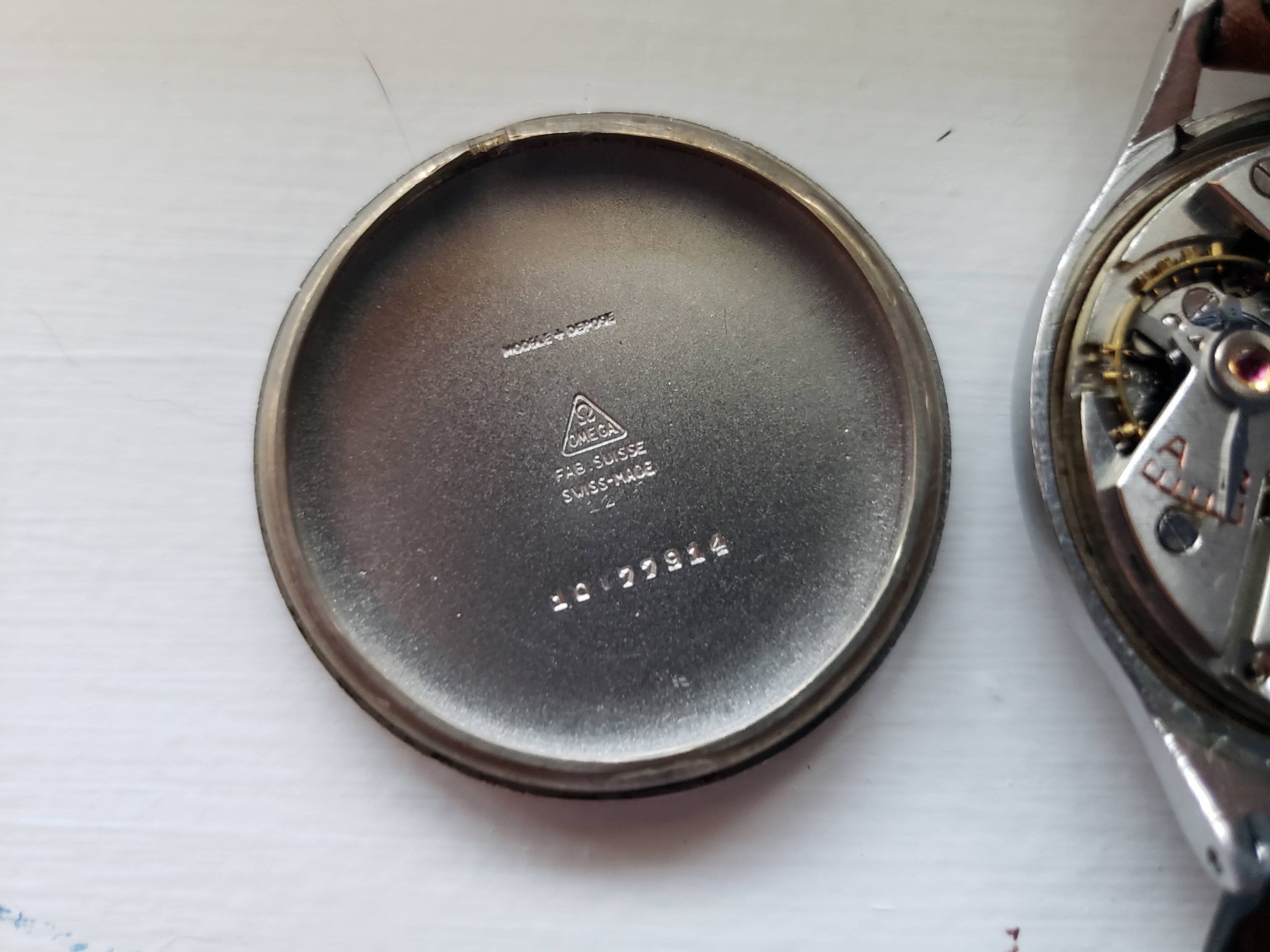

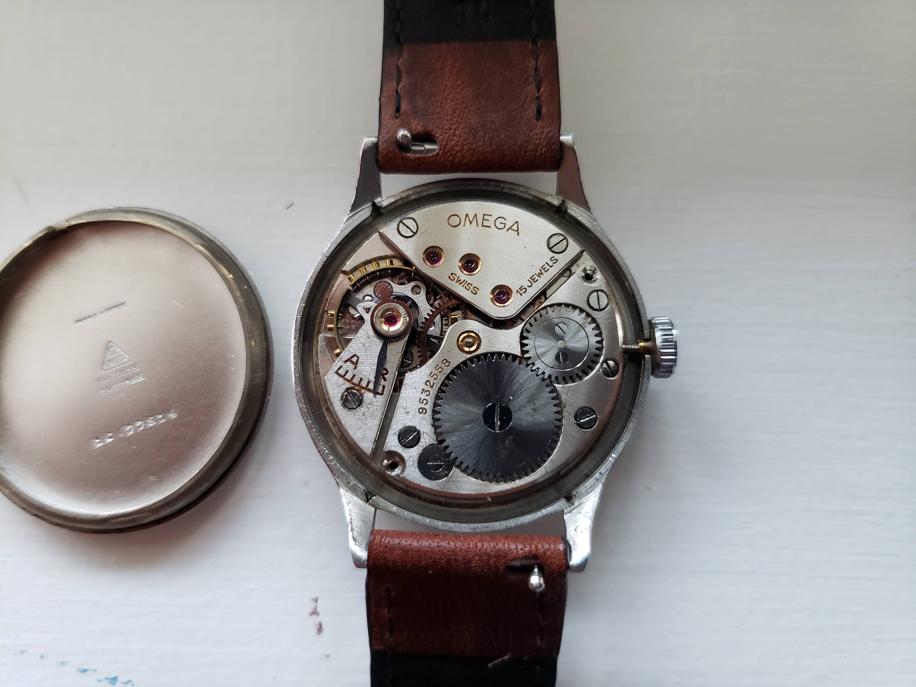

-Whats up with those divots in the case near the lugs. I've never even seen that before. Seems a little weird.

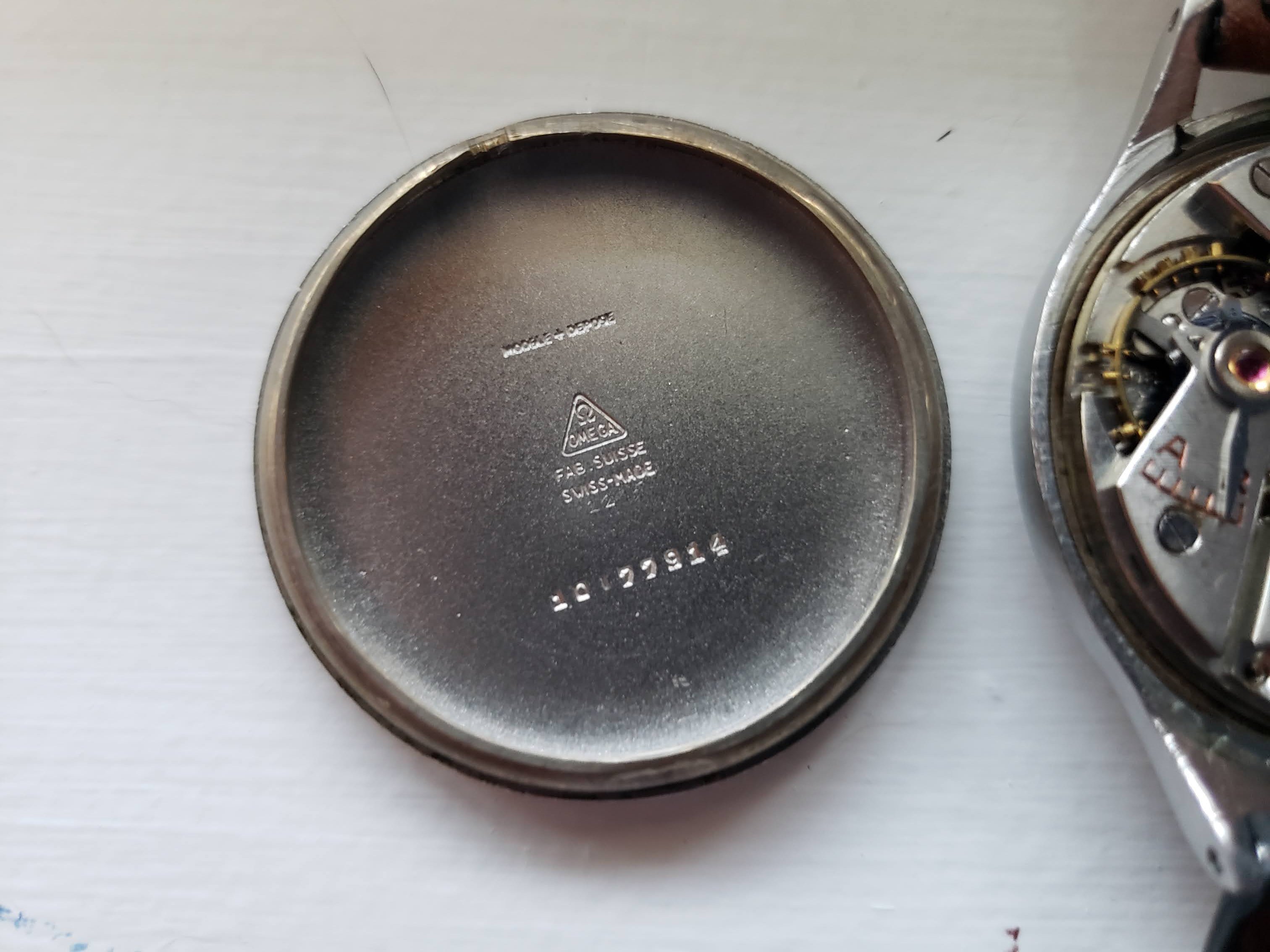

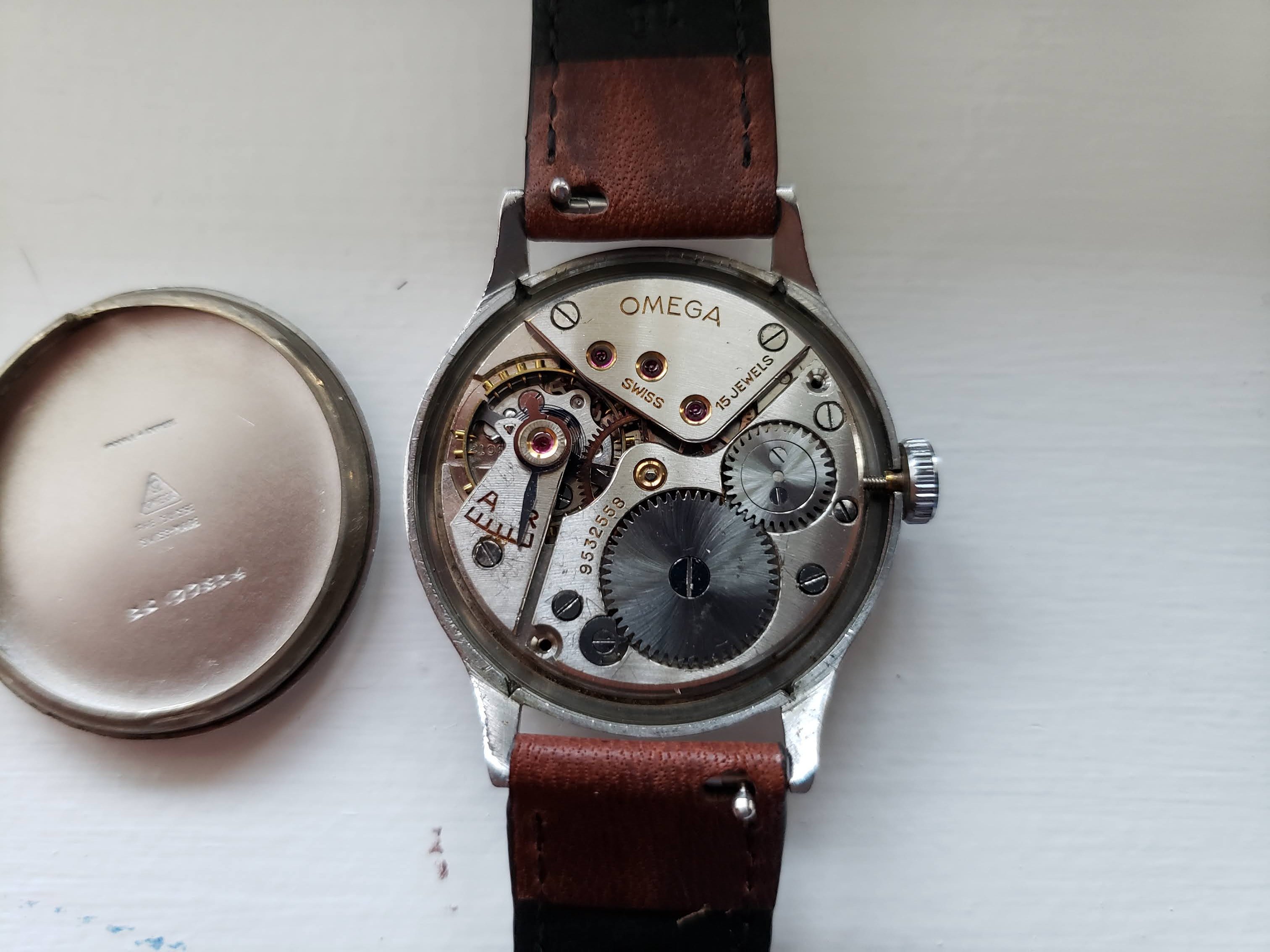

-Missing movement screws. Again, I don't really know if it's a smoking gun, but again seems a little suspicious.

This case does not require case screws as the movement is kept and held in place in the deep caseback which is built like a tub.
Yes, leaf hands would look nicer on this dial
I am afraid the crown is a wrong replacement
Other than this it looks authentic.
I like the current hands. Sort of matches to the diamond indexes
Low dome have a more curved edge which distorts and hides the outside chapter ring. Low dome is proper, but if visually better with the high dome. Can switch back
Probably created with the stamping dies to make sure case is properly oriented for each progression of stamping
As mention. These are for securing the movement in 3 piece cases which are loaded from the top. Screws with wide heads then hold the movement in place. You movement is a bottom loader and back holds the movement in place
