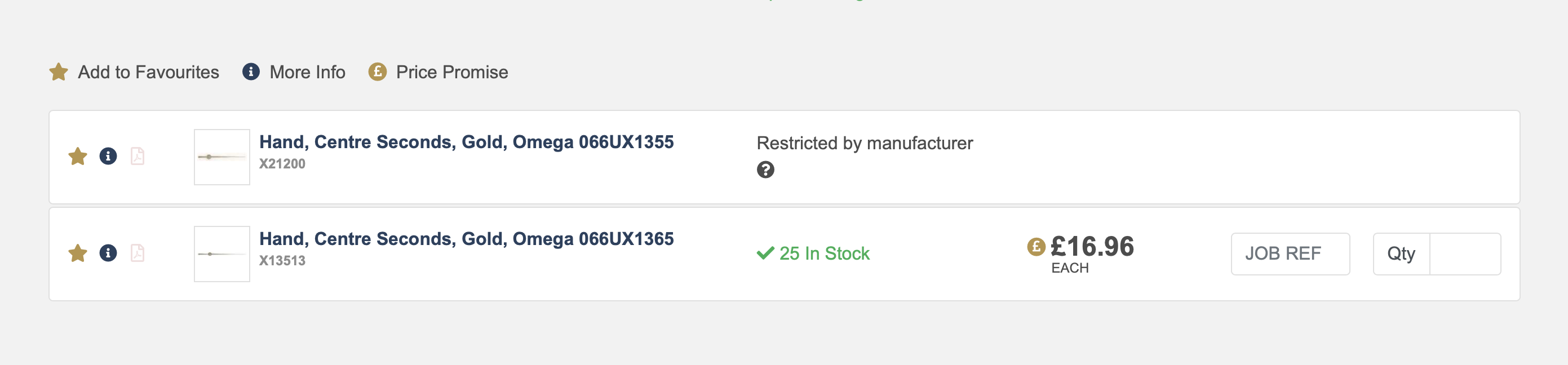

I've just looked on Cousins UK
the same hand is £16.96
However - and I'm going to caveat this by saying that I have never ordered any kind of hand for a Constellation

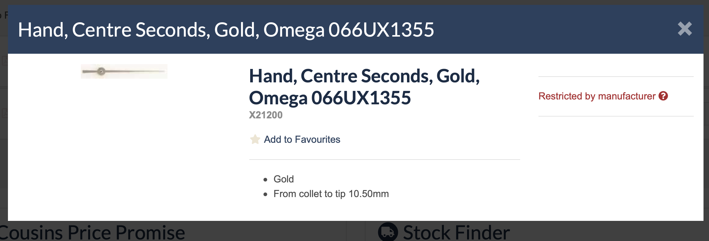

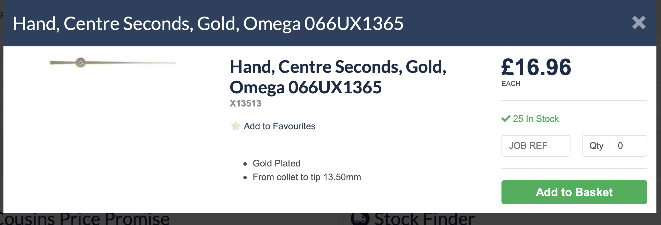

If the measurement is from the centre post-hole (collet) to the tip, then I think the 1365 looks to be too long at 13.5mm and is likely for a dome dial
the 1355 is 10.5mm long and looks to be about the right size for a pie-pan dial but is an Omega account-holder only part
Since he was kind enough to help in the first instance, perhaps @Archer could shed some light? - because as I said I'm whistling in the dark here.
REF : 066UX1365
LENGTH L1 : 12.70 MM
Again, this is the only hand Omega lists for this 168006 case reference. The only dials they show are domed dials.

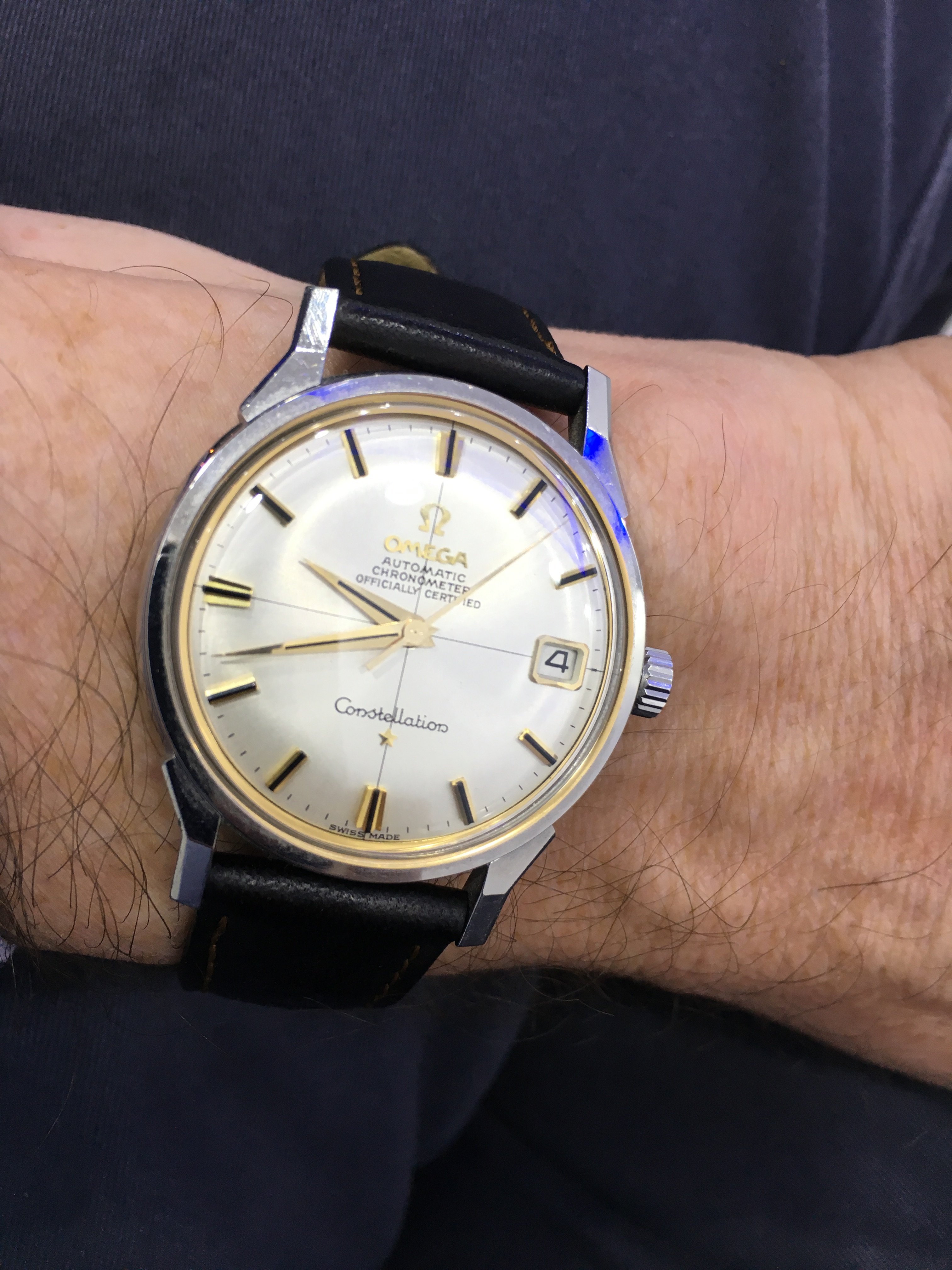

How do I confirm the case number? According to the watchmaker it said 168.005/6 on the inside. What does a "domed dial" mean? The dial does not appear to be flat, it looks angled "outside the piepan" if that makes sense.

12.7mm looks to be significantly too long for a pie-pan dial
The hands I showed above from Cousins were for a 168.005 (they don't list a .006) and it rather looks like the shorter 10.5mm 1355 hand is a more likely fit. (if indeed that is the correct length given the Cousins length discrepancy with the 1365 hand)

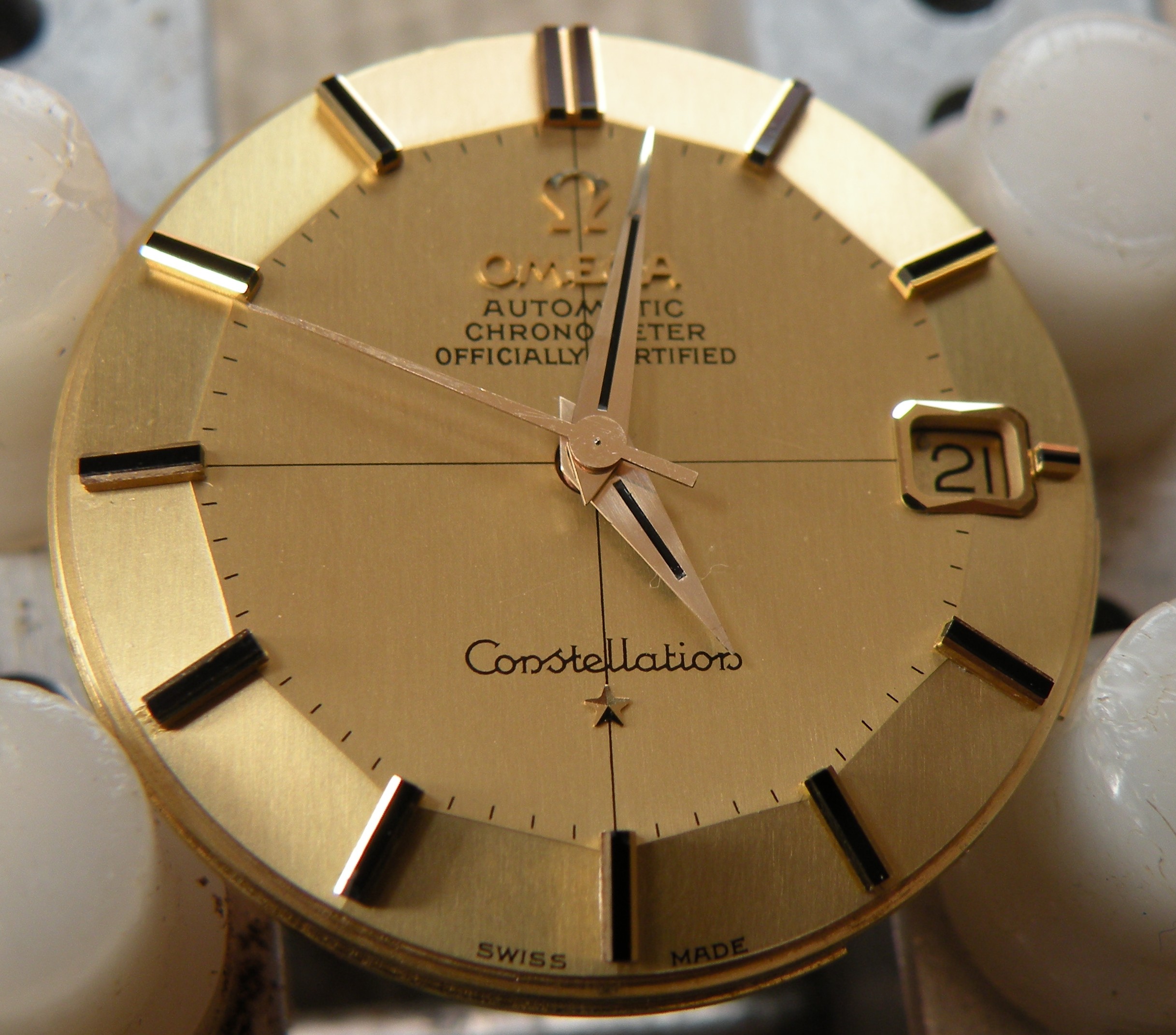

a dome dial is a different kind of dial - as per the dogleg I posted illustrating the replacement crown
the minute haches are at the outer edge of the dial and so the hands are longer than on a pie-pan
here it is again

The 1355 is indeed 10.5 mm, so that is likely the correct hand. Even for the 168005 case, no pie pan dials are shown. This is the fun of working on vintage...

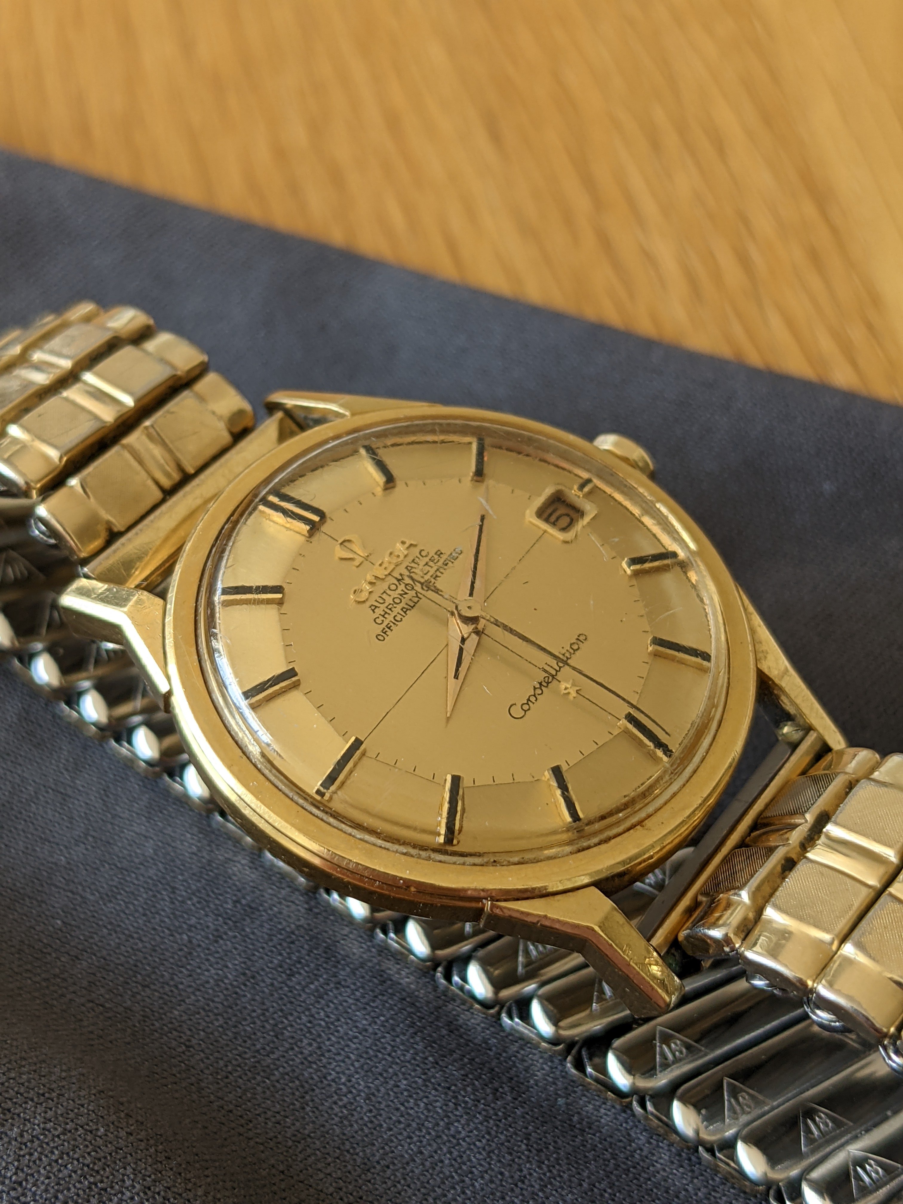

Sadly I don't have a good camera, I just use my phone. I also think the scratched up crystal makes it difficult for the camera to focus on the dial. Here is a new pic, not sure if it is any better though.

much better thanks.
you can see the gold colour of the dial properly and the flat, broad, inserts.
I think we can confidently say your watch has a deluxe solid gold dial and therefore the case reference is 168.006. (As @hoipolloi suggested on page3)
however, the seconds hand should be the same for a pie pan dial in either reference (168.005/168.006)
@Archer has pretty much confirmed that the seconds hand you require is the 1355, which is only available if you have an Omega parts account.
