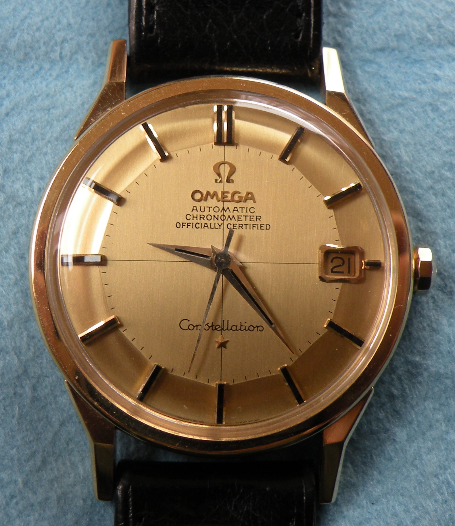

Why not the watchmaker you already have a quote from? Seems like he knows what he's doing. Those crowns are hard to find, you don't want to lose it if you can... ask him if he can replace the gasket inside. The second hand is an easy fix. Not that he is necessarily expecting you to come back (a lot of people don't) but I like to support small business when I can.

I am all for supporting small local businesses but if they are not able to fix the seconds hand I have to fix it somewhere else, for me that is a bit inconvenient. It feels somewhat reassuring to do it at an AD. These might not be the best excuses but with my very limited knowledge I want to minimise the variables that potentially could go wrong.

If you want to keep your crown and crystal, you might want to stick with the independent. Those second hands are easy to find, and, heck, your existing one could be cut to the right length, too.
But a piece of advice I read in a book I have taken to heart... "Never second-guess the man on the ground." You are there with watch in hand and the rest of us are elsewhere with a picture. I am confident you will make the best choice for you.

Keep the crown . Have only the seal inside the crown replaced. From your reports, I'd say you will be fine with both watchmakers. Just don't let them polish your case at all. And take very good pictures of the dial before you leave the watch. You don't want to find a scratch after the service, if that is a 18 karat dial. Your local guy can be visited and he will not want to make a mistake in the community..... And the second hand can be easily adapted. The crown is more important.

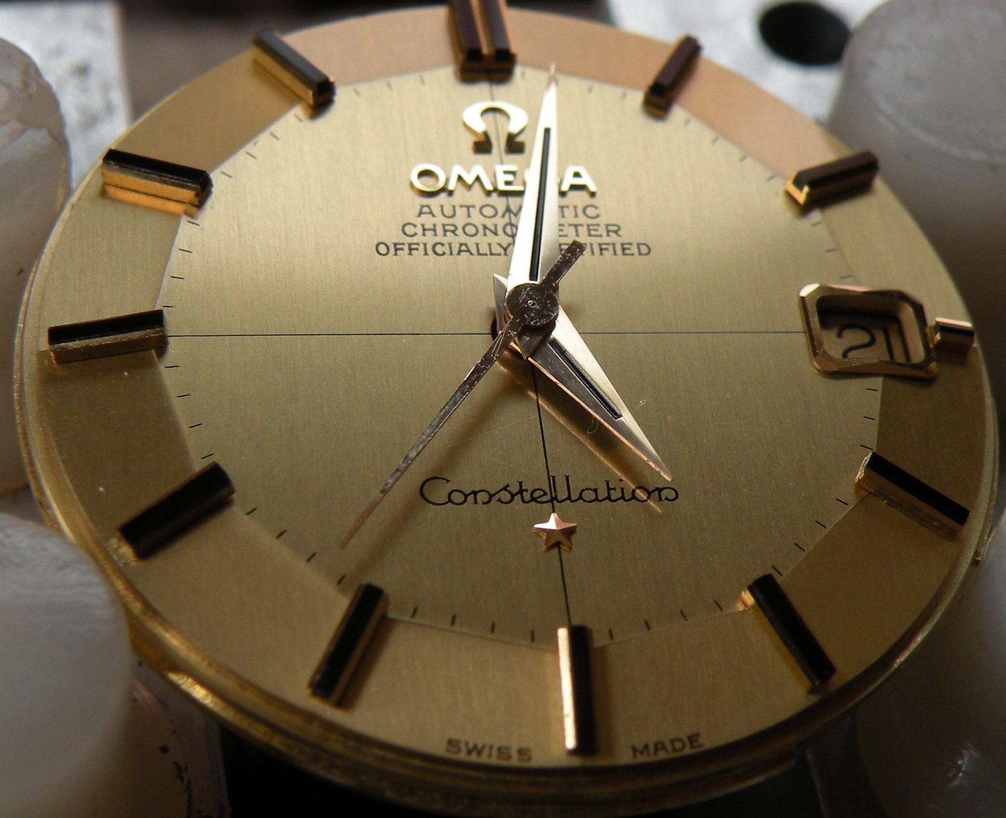

I have now been to the local watchmaker and collected the watch. They are really helpful and knowledgable so I really want to service the watch there, as you might be able to tell I am very indecisive. I browsed a bit trying to find the seconds hand and came across this site with what seems to be the correct seconds hand: https://www.watchandclockparts.com/products/omega-hand-centre-seconds-gold-omega-066ux1365
Does anyone have any experience with "watchandclockparts" in the UK?
I've just looked on Cousins UK
the same hand is £16.96
However - and I'm going to caveat this by saying that I have never ordered any kind of hand for a Constellation
If the measurement is from the centre post-hole (collet) to the tip, then I think the 1365 looks to be too long at 13.5mm and is likely for a dome dial
the 1355 is 10.5mm long and looks to be about the right size for a pie-pan dial but is an Omega account-holder only part
Since he was kind enough to help in the first instance, perhaps @Archer could shed some light? - because as I said I'm whistling in the dark here.

I just got an answer and according to him it is genuine. It is a bit strange that "cousins" and "watchandclockparts" claim different lengths for the same part number.
