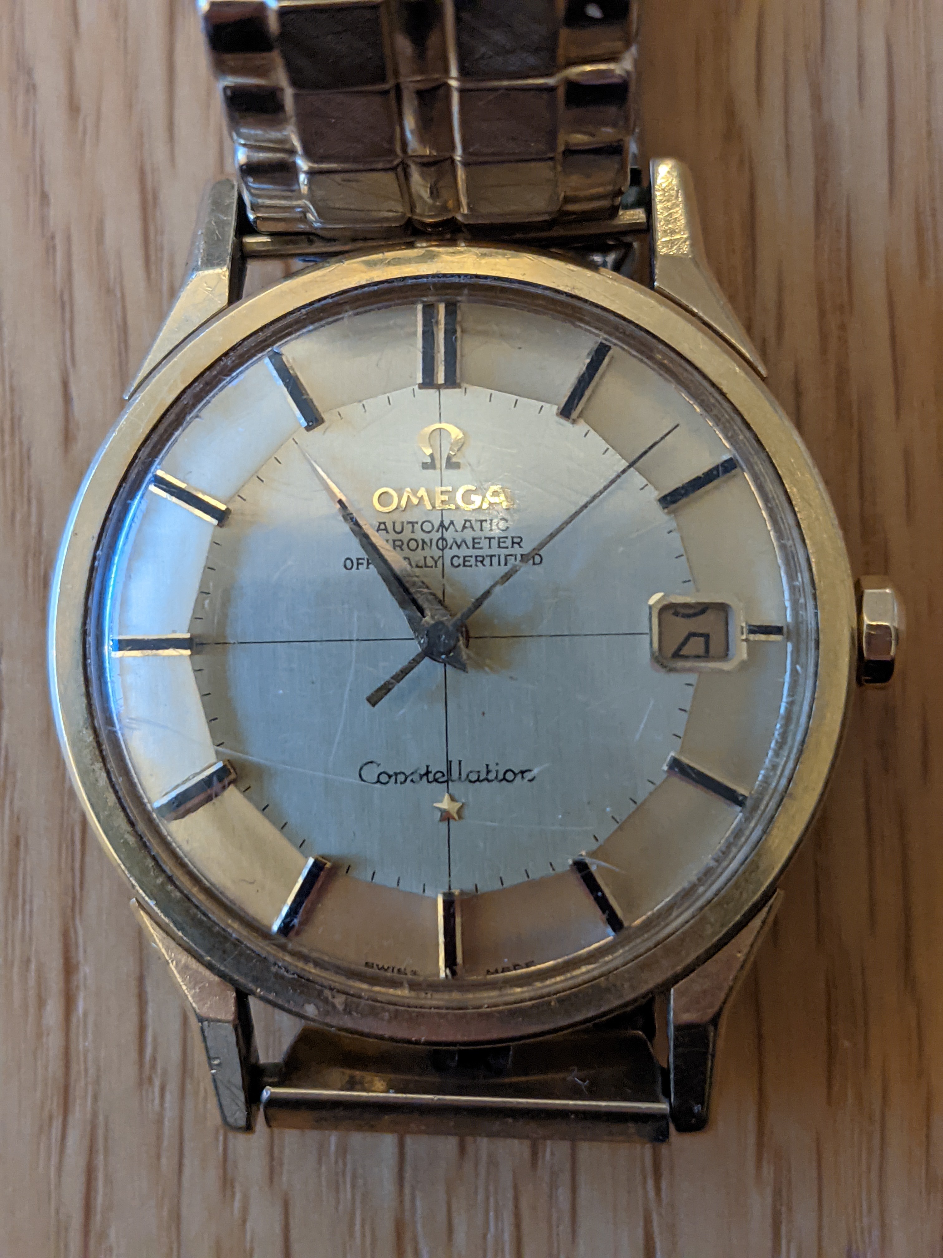

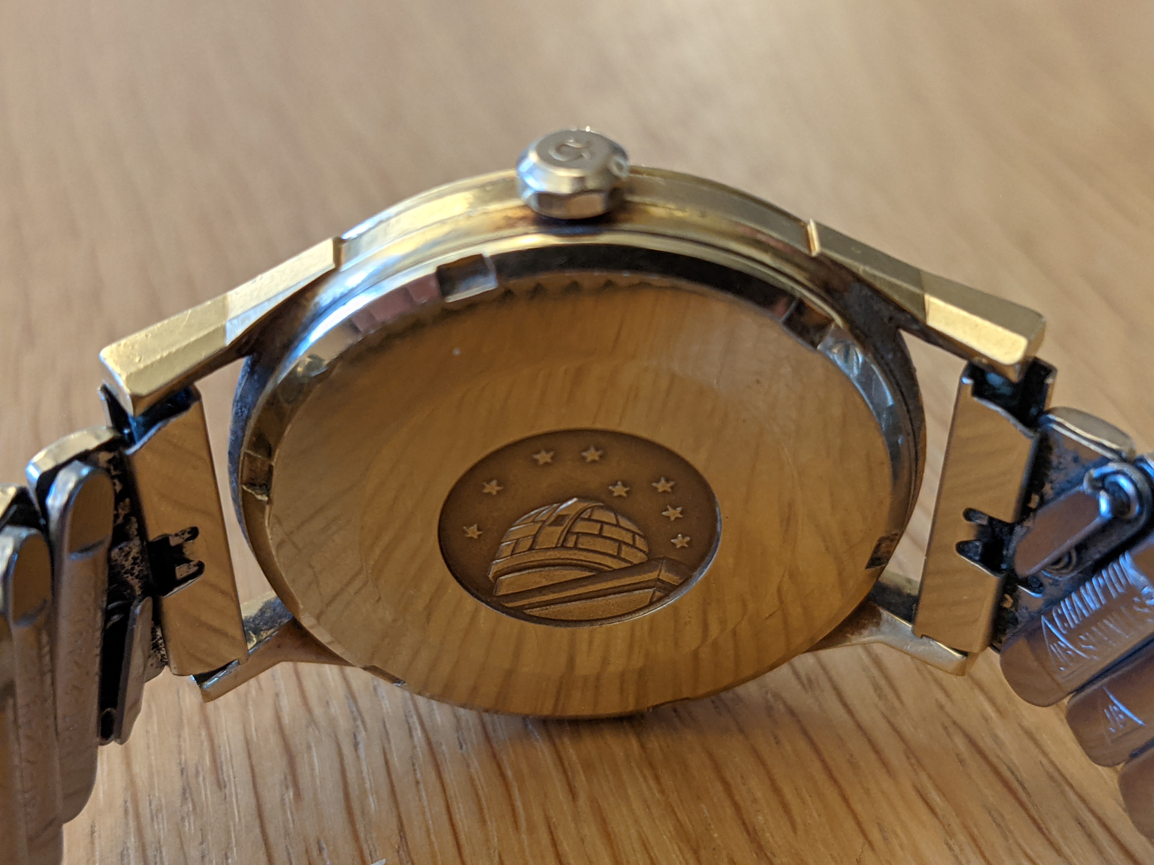

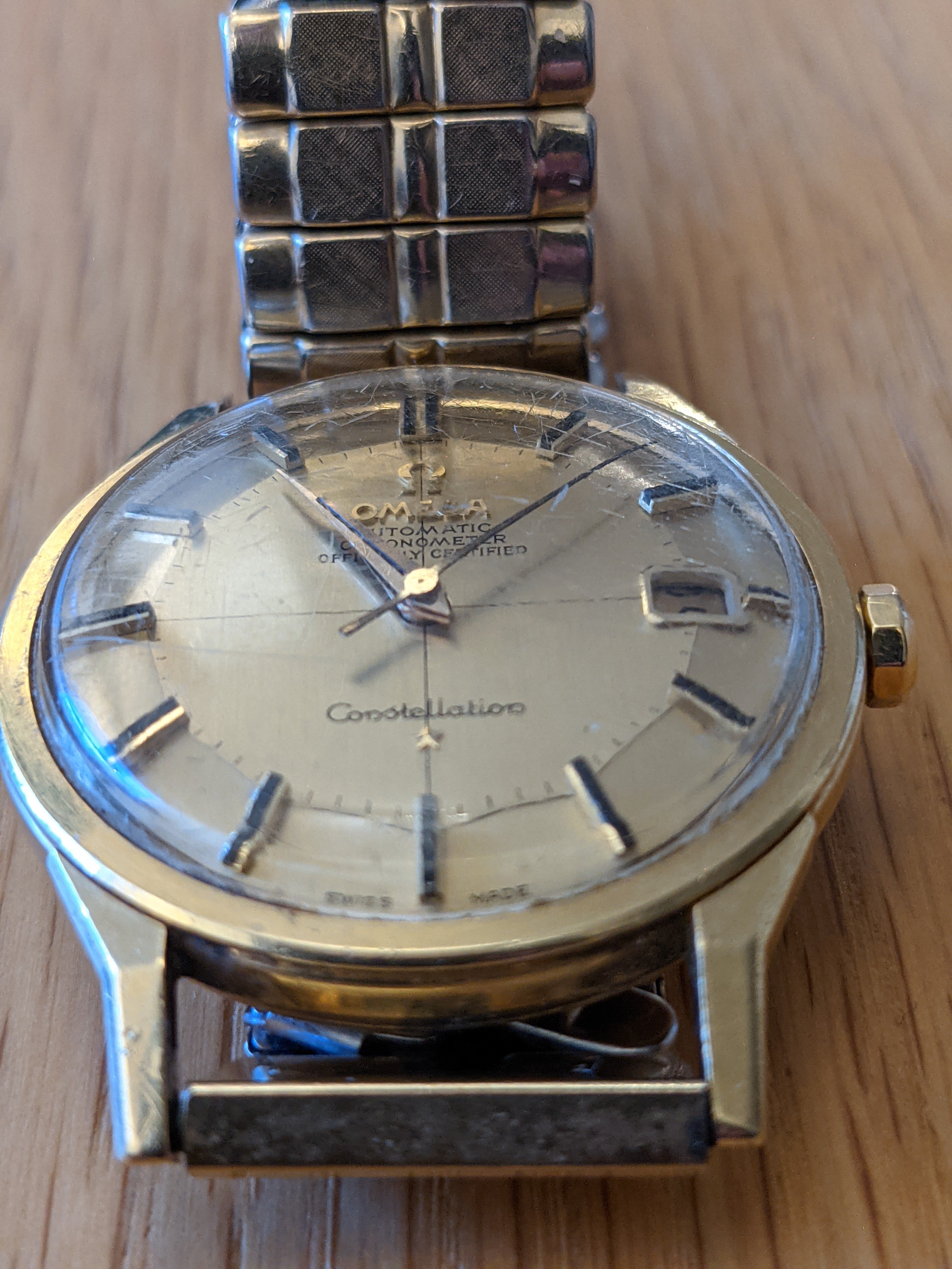

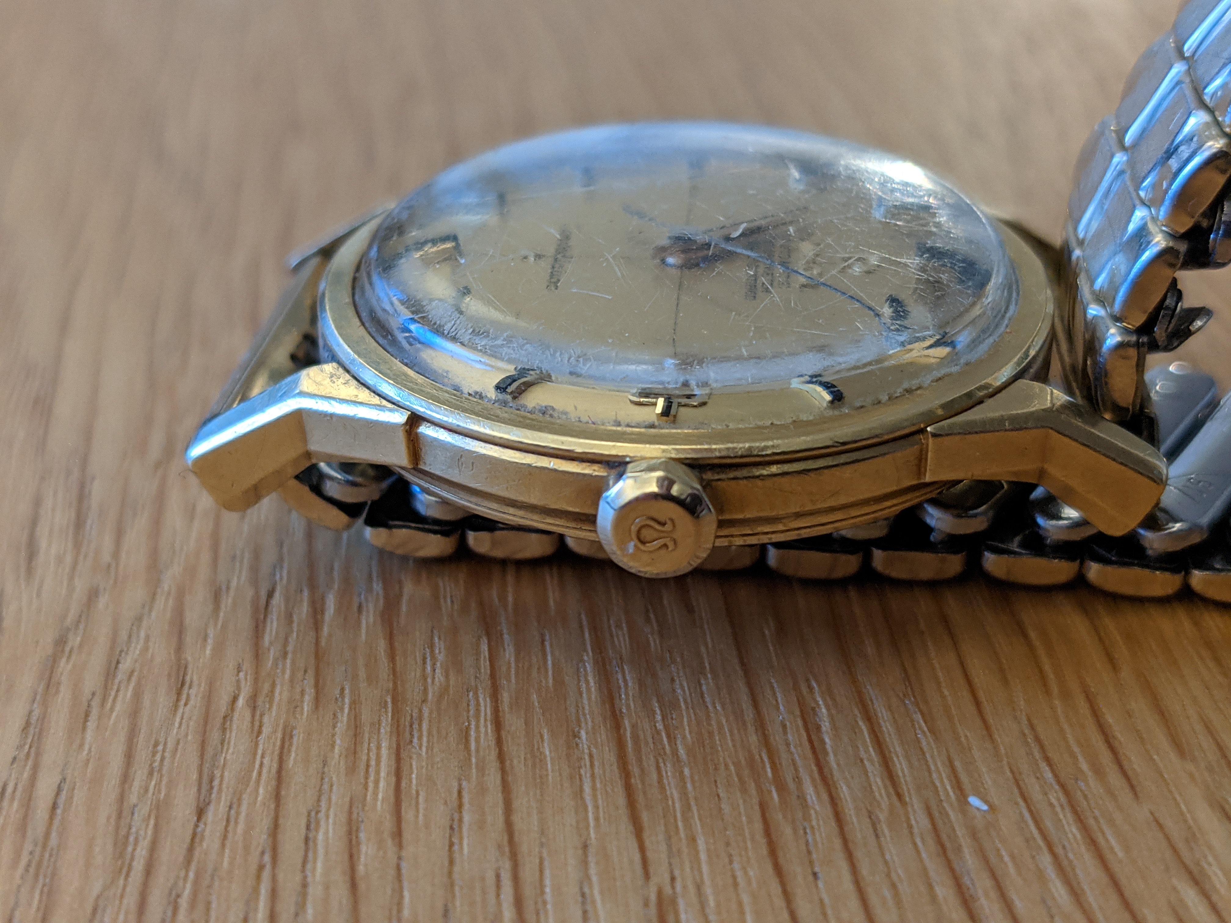

First of all I would like to excuse my lack of "watch language", I have done some research but my previous knowledge about watches is lacking to say the least.
From what my father told me the watch was bought for my grandfathers 50th birthday in 1969. He used it as his daily driver until he passed away early 2000s. Since then it has been stored away until just recently when my father gifted it to me.
I have tried to do some research and think it looks quite a lot like the Omega Constellation 168.005, I haven't dared to open it up yet but could that guess be correct? As you can tell from the pictures it has some wear. The bracelet is not original (I will swap it out) and I don't think the "crystal" is either since there is no Omega logo in the centre. The dial seems to be in good condition, any reason to suspect it is not original?
I am planning to take it to a reputable watch store tomorrow that are hopefully capable of servicing it. What are the dos and don'ts? The "crystal" is really scratched up, can I swap it out or is that a big NO. Is my assumption about the crystal not being original correct or could it be original even without the Omega logo? The second hand has some discoloration, could that be cleaned by a proffesional or should it be avoided. I really want to treat the watch with respect and not potentially ruin it.

Welcome to OF - that’s a fantastic family heirloom! It’ll clean up very nicely. The seconds hand is a replacement (too long) so you can replace it with one that is the correct length. An original Omega crystal won’t set you back very much either. Otherwise, all the watch needs is to have the movement serviced by a reputable watchmaker. No need to mess with the dial or case, both appear to be in well preserved condition.

Neither a new Omega crystal nor a replacement seconds hand are expensive or difficult to source (yet). So I’m not sure you need an Omega-certified watchmaker.
But for sure you don’t want to give it to anyone randomly selected. If you post your general location, someone will point you in the right direction.

If you go to a watchmaker without a parts account, it’s not uncommon to bring spare parts with the watch. I’d suggest you seek someone who’s used in dealing with vintage watches, though and clearly discuss what you would like to have done. A service of the movement is a given, but people here would advise to emphasize that you do not want the watch polished. The lugs might lose their distinct shape. Also discuss with him what parts he wants to replace. Mechanical parts from the movement that are worn out are fine, of course, but you wouldn’t want him to replace the (correct) crown on your watch for a generic one, for example. You’ll also have to ask yourself what you expect from the watch - is it ok for you if it’s not waterproof? That would make it a lot easier to keep the crown you have - you’d need to be cautious when washing hands, though, and maybe shouldn’t wear it in the rain.
If your watchmaker can’t source the correct second hand drop me a pm. I’m pretty sure I should have a spare one for that ref / cal 561/564.

not sure why @timecube deleted his post - it seemed to make sense to me.
your watch will require a full service if it hasn’t been serviced in say the last 5 years.
This means dismantling it down to its component parts, cleaning, reassembling, oiling and regulating.
The instructions should be ‘no polishing of the case’
It can be cleaned in an ultrasonic bath.
the dial should receive no more cleaning than that of the breath of an angel.
You should only use genuine Omega parts if at all possible.
this includes the crystal as it forms part of the water-tightness of the watch.
You don’t need an Omega AD and members frequently send their watches overseas for a suitable trusted watchmaker.

Hi again! Today I got a message from the dealer saying the watched needed to be repaired and the estimated cost for this was around 500$. I assume this price did not include new crystal/seconds hand. Does anyone have a general idea of what the watch might be worth? Sadly I don't have the exact reference number, I will ask for it tomorrow. I really want to get the watch working but at the same time I don't want to pay more in repairs than what the watch is worth. There is no reason to suspect a redial for example that would devalue it?

Since you live in Sweden, I can say that a similar steel pie pan dog legs Constellation sold for 10.000 SEKK yesterday on a Swedish auction platform. It, however, had a re-dial and engraving on the back so yours would be worth more IMO.

Thanks for the research. So there is nothing, in your opinion, to suspect a redial on mine? I have no reason to suspect it but it would be a real bummer to spend a lot of money on it and later find out that it had been redialed.

You’re welcome. There are no red flags to me but I’m not an expert on Constellations (nor am I on any Omegas) so wait for other opinions. But as you can see, even with a redial Constellations are worth some money - especially the case and dial type that you have.

It's not a redial. $500 for a service without parts is a bit on the high side. But it really depends on your location. I live in a big city so enough availability of watchmakers.
