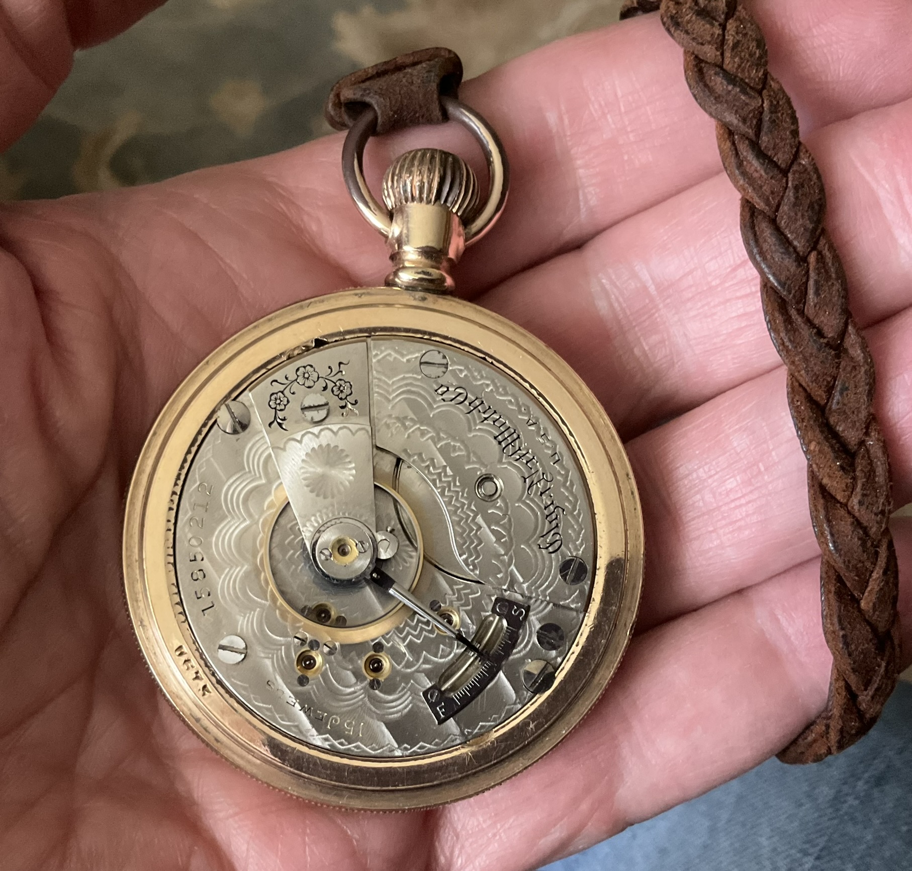

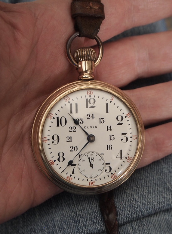

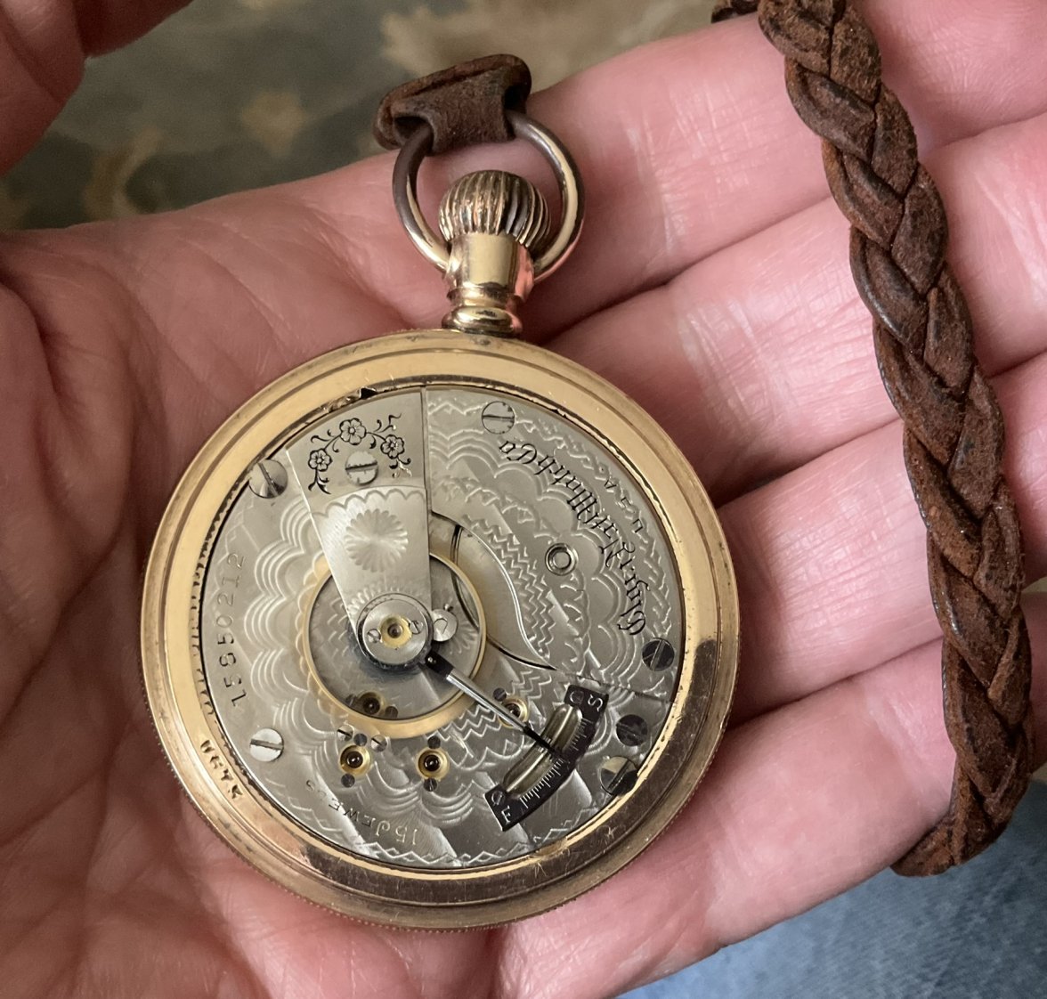

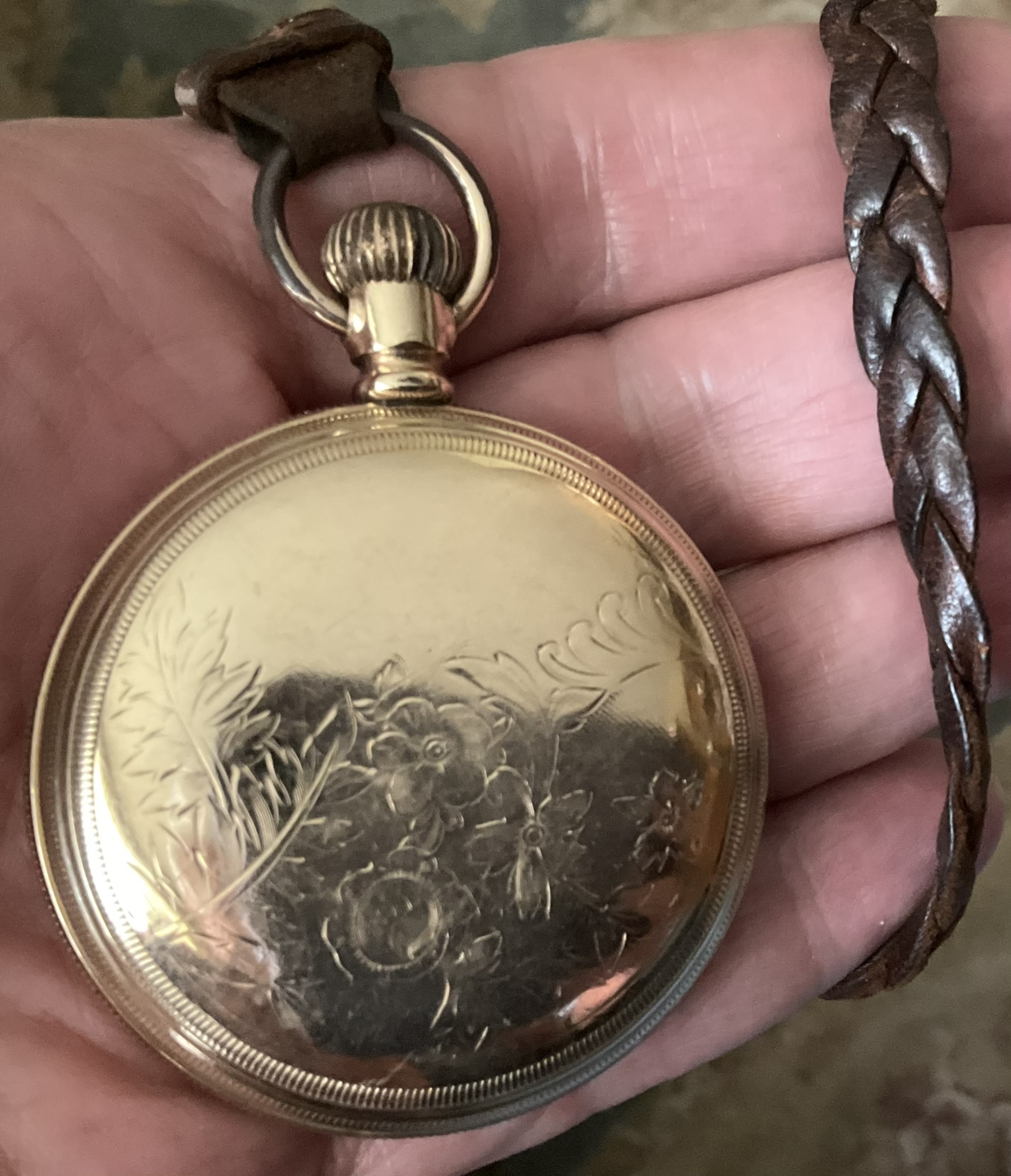

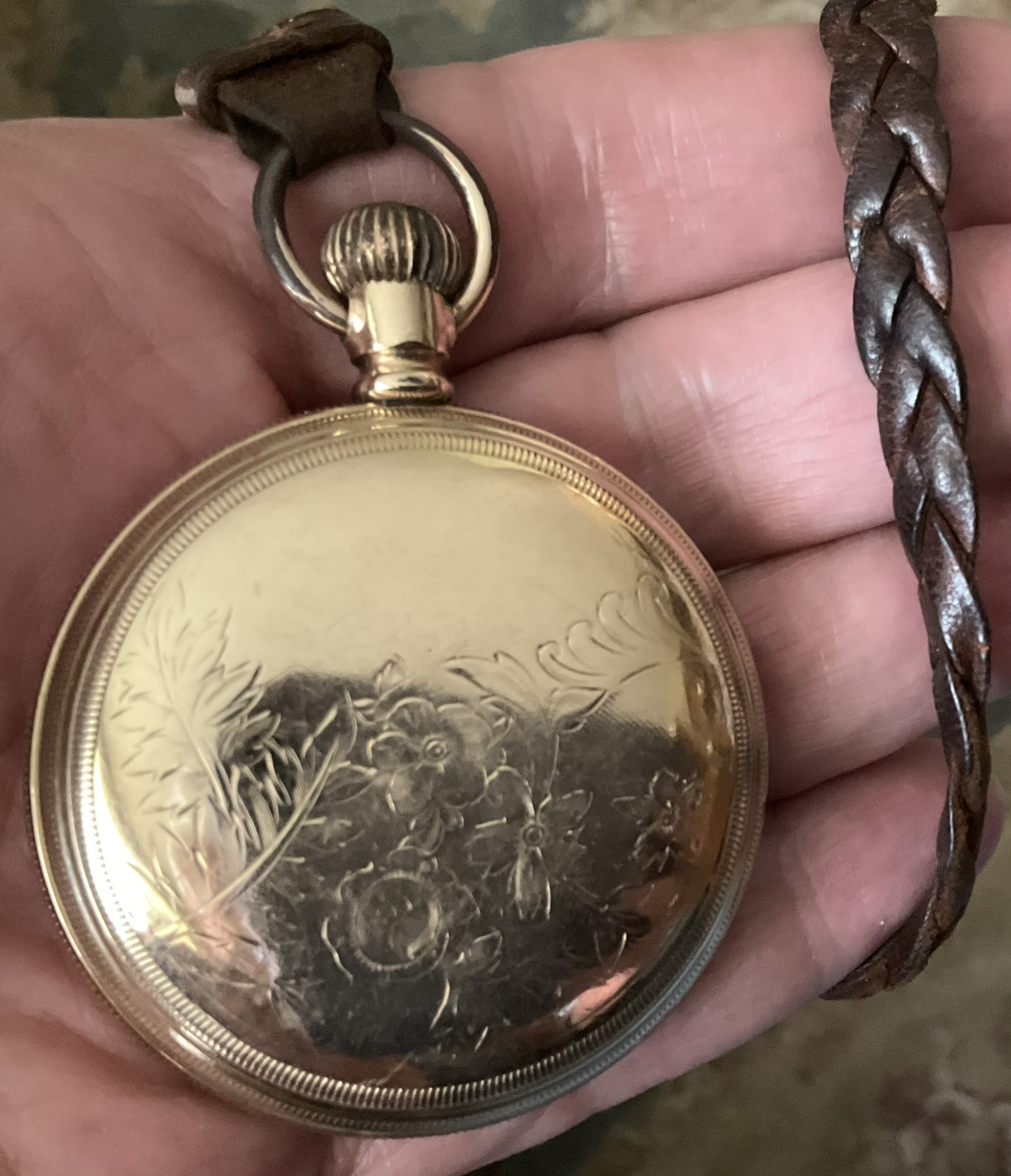

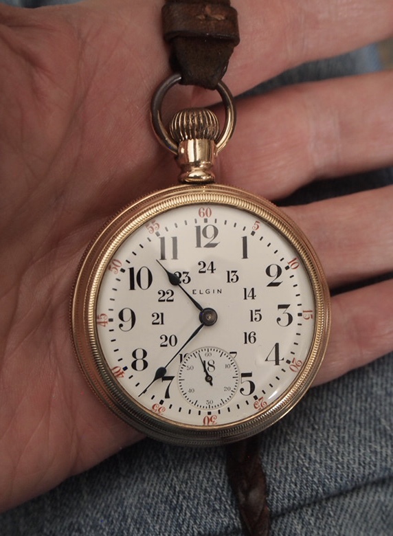

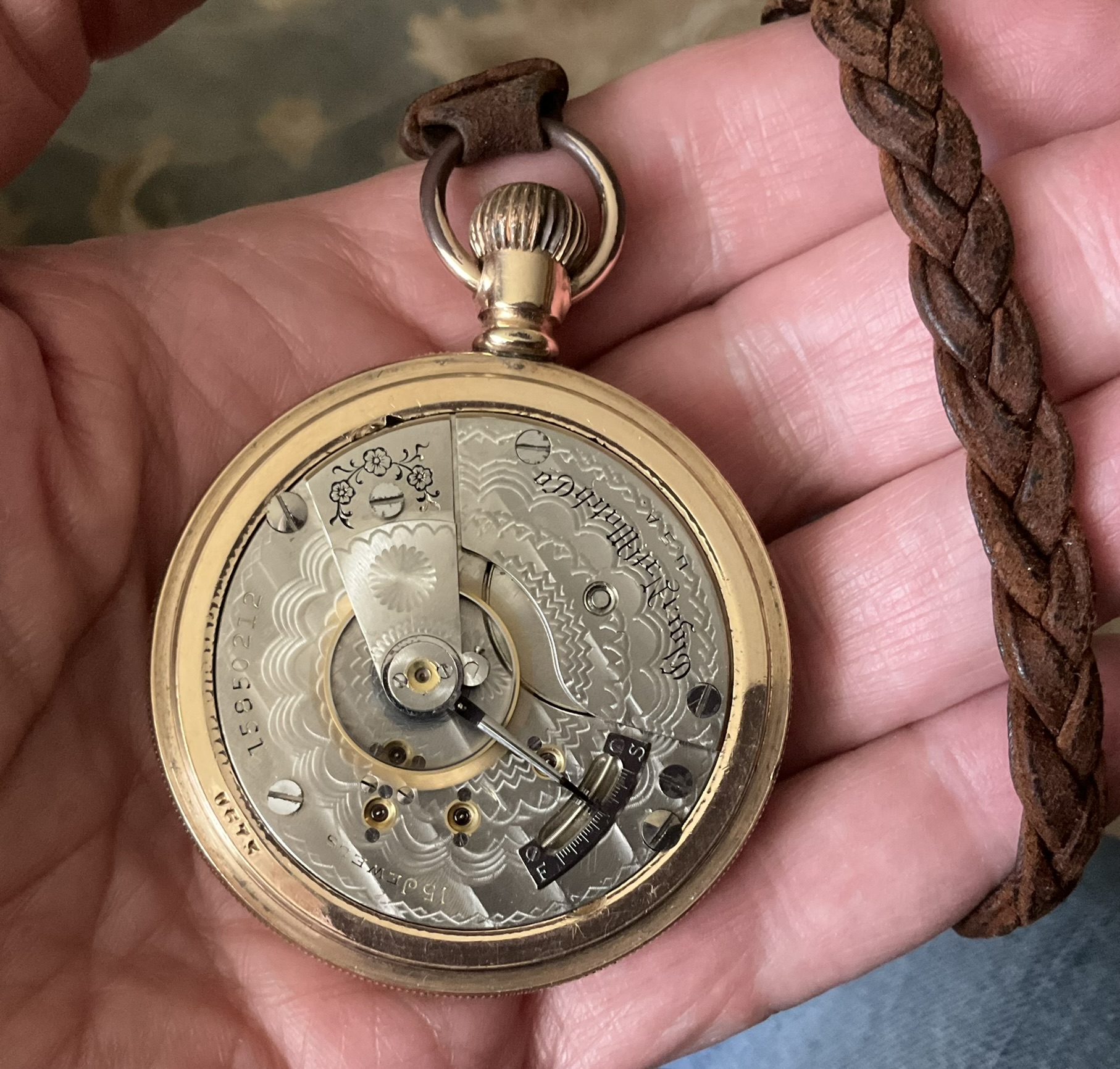

I recently was approached by someone who is a hobby railroad telegrapher. He asked if I had a railroad watch for sale. Lotsa railroad watches, but none for sale. So I went to my stash and found the subject watch, an 18-size, 15-jewel Elgin with a perfect 24-hour vitreous enamel dial. It needed a balance staff, mainspring, balance staff foot hole jewel, a glass, a recondition, seconds hand, and a better case. I have a lot of very old NOS watch material, likely bought 50 or so years ago. I had a staff. Price on the envelope said 70 cents! I had a NOS genuine Elgin mainspring. Cost? Dunno. I bought an assortment of NOS Elgin jewels in settings for very little, close to 40 years ago. I had an exact original hole jewel in the right setting. I had a glass watch crystal, seconds hand, and an excellent gold filled case in my stash. I cleaned it, staffed it, fitted the mainspring, glass, and seconds hand, and this is the result. Cost? Under $20 plus sweat equity. Sold the watch for a good buck!

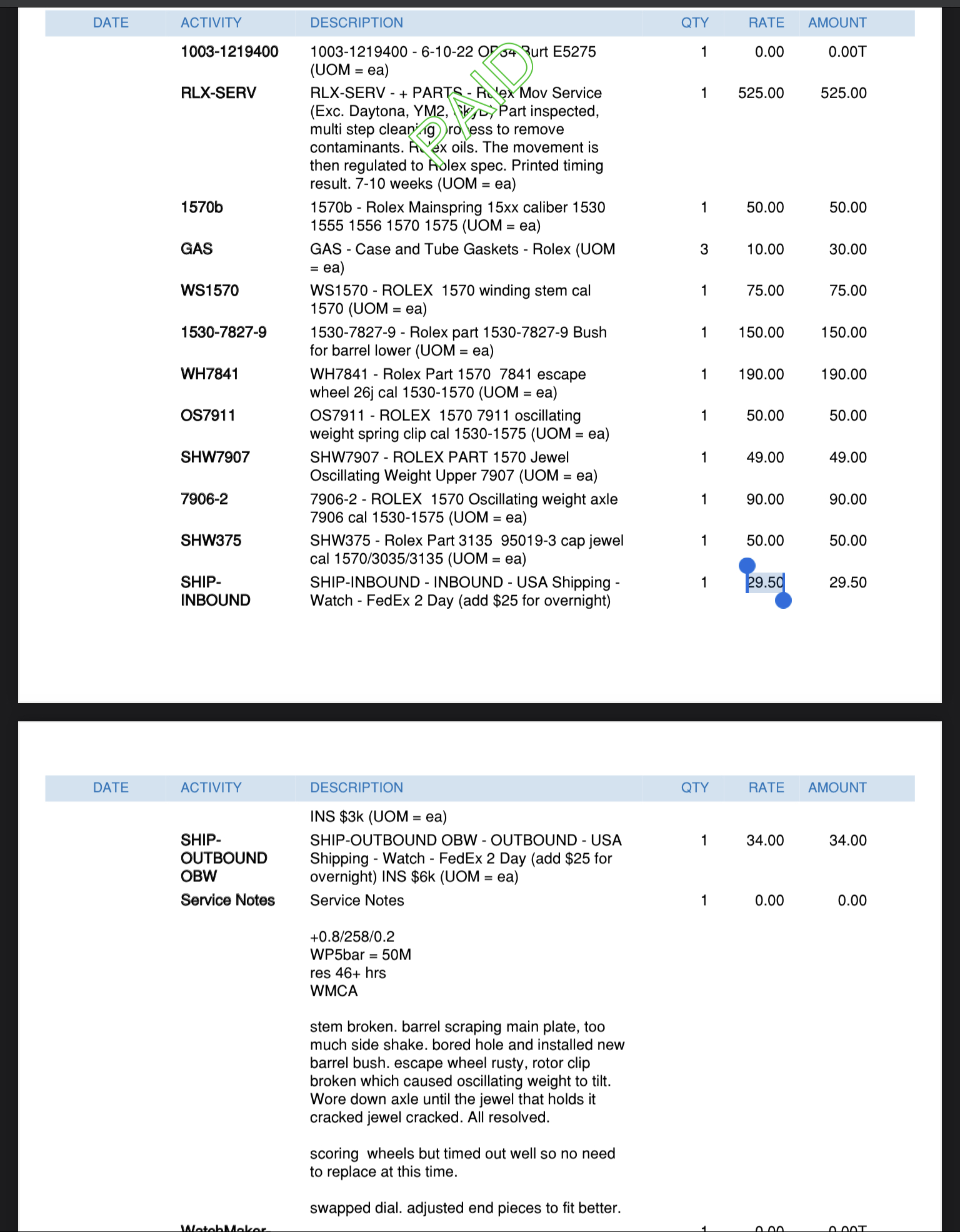

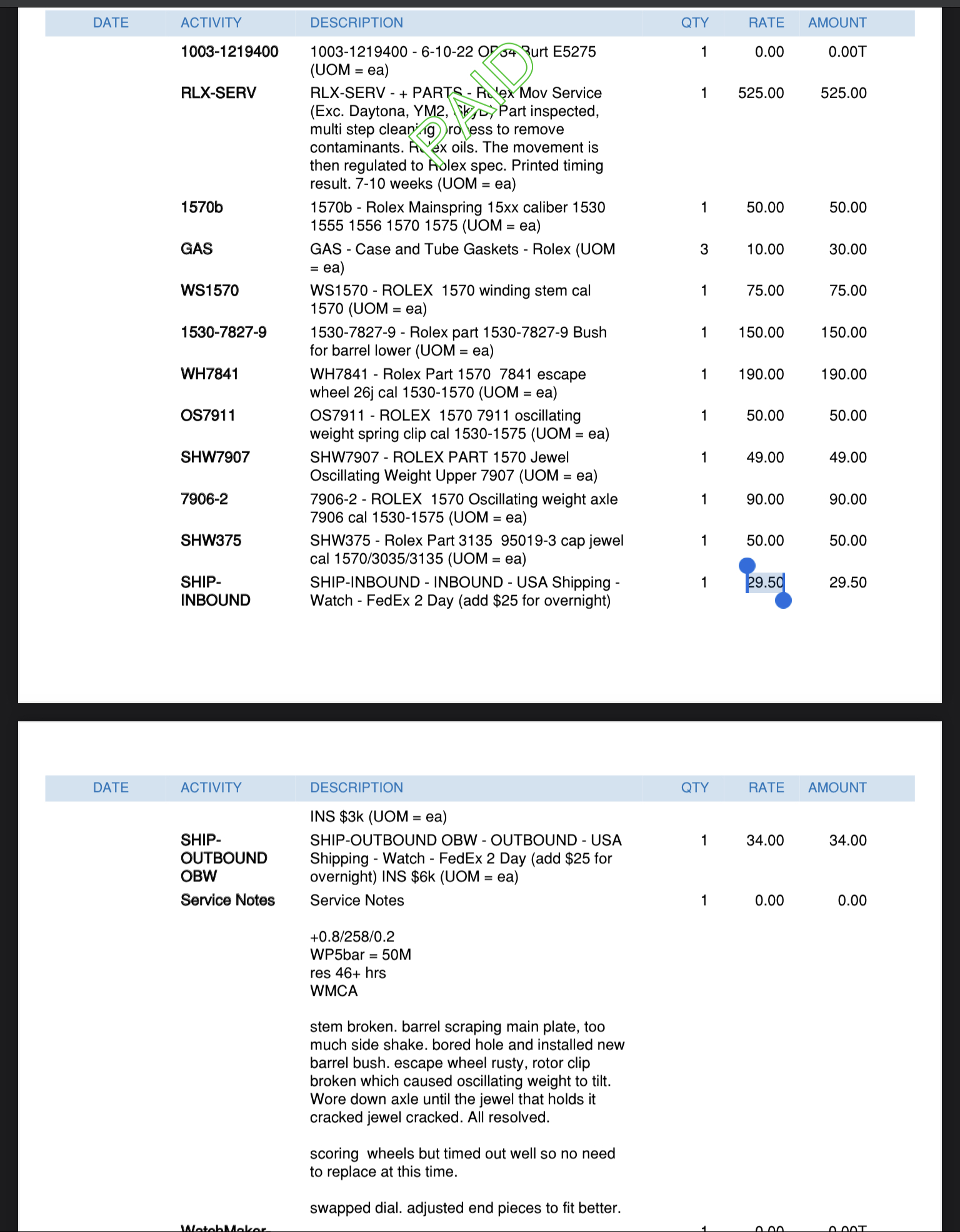

Been down this road plenty of times. This was a lowly Rolex 1003.

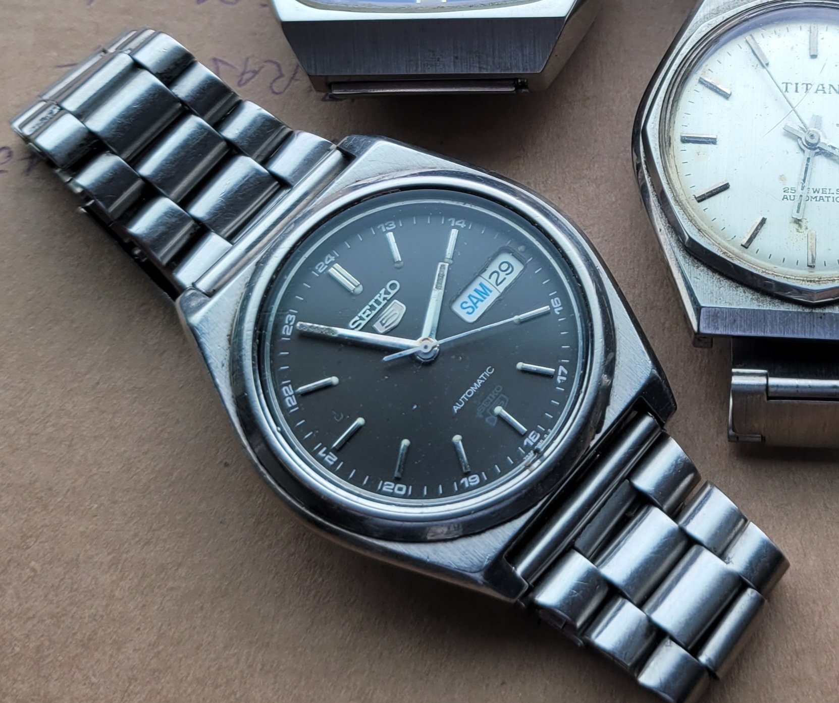

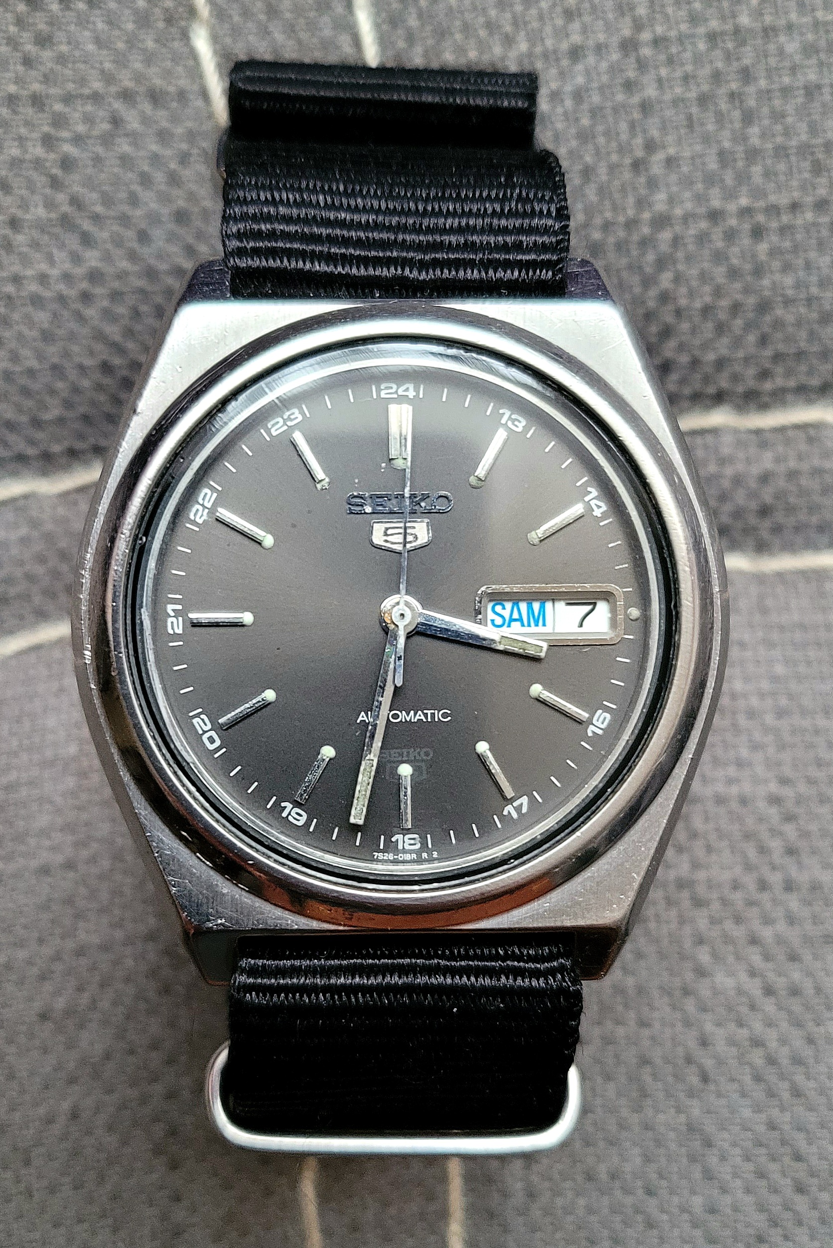

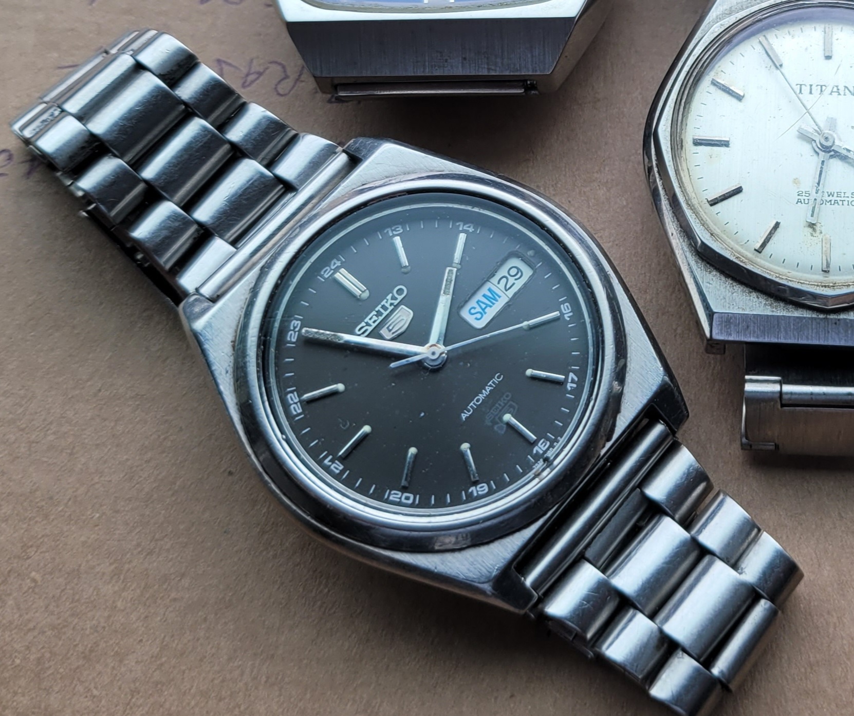

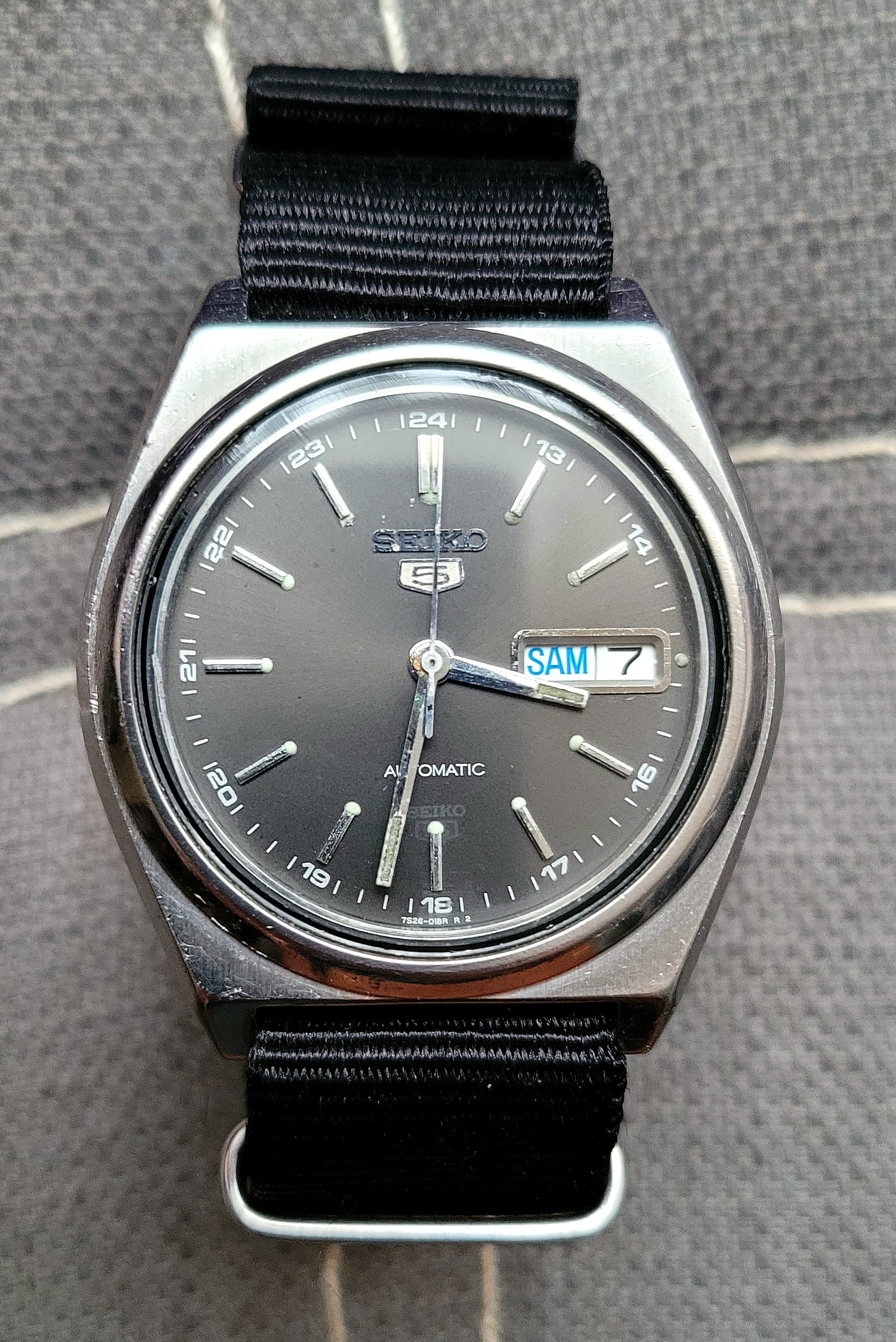

I bought this (stuck) SEIKO 5 in a thrift store for around 18 USD (with bracelet!) and thought that it would only need a date window and a service. But then noticed that the minute hand was set to conveniently hide the missing hour marker at 11:00. Amazingly, my watchmaker returned it to me, cleaned, serviced, with a new hour marker and date window for 40 USD. Without this kind of pricing, I couldn't justify this madness.

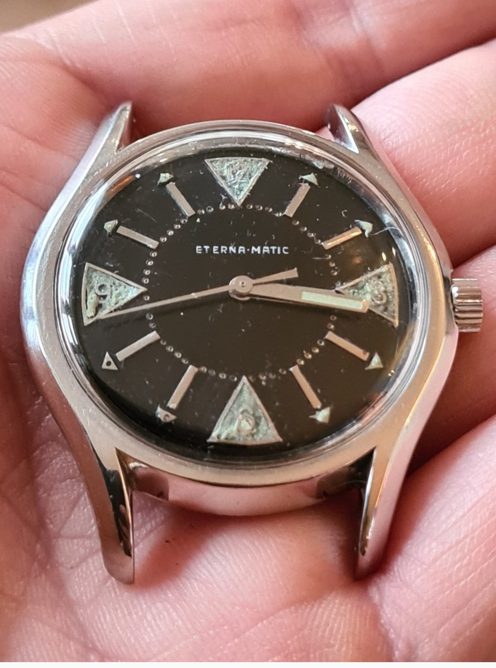

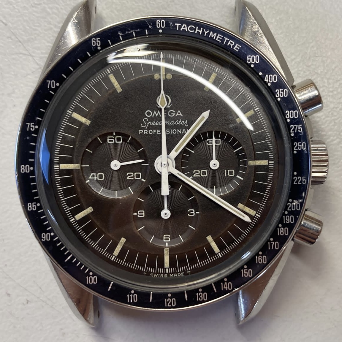

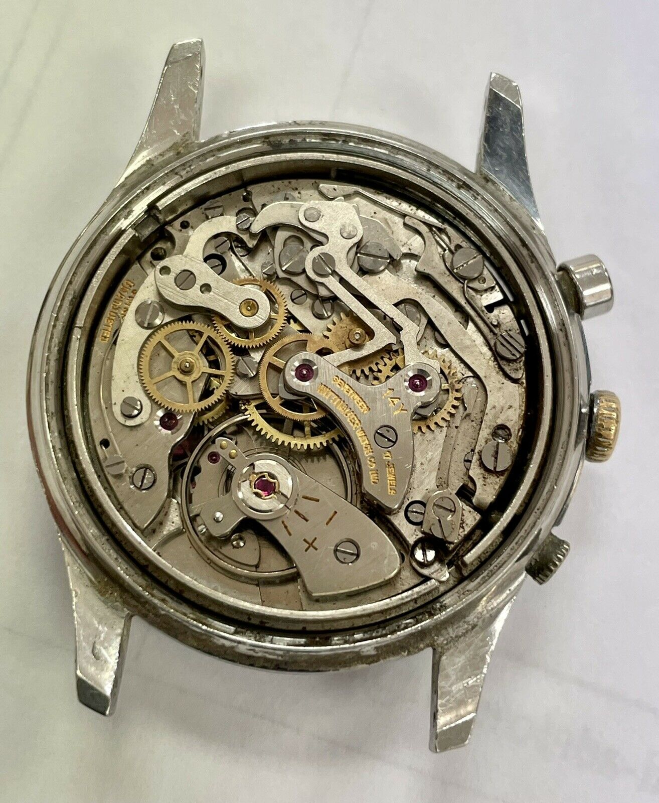

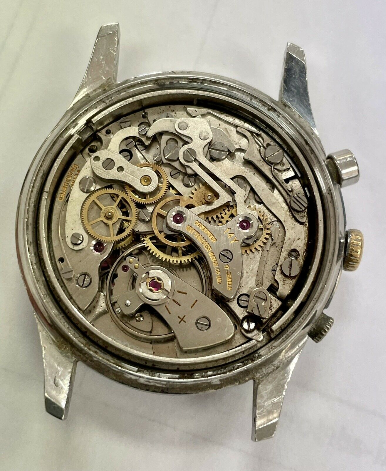

This is one I need to plea guilty too as well. 😁
From this, bought relatively cheaply, but certainly not for just a penny...
img_0211-jpg.1470714
img_0212-jpg.1470713
To this:
cd9cef10-9f9d-457f-927b-7fad91800e2b-jpg.1470723
And work is still in progress. Details can be found in this thread: link

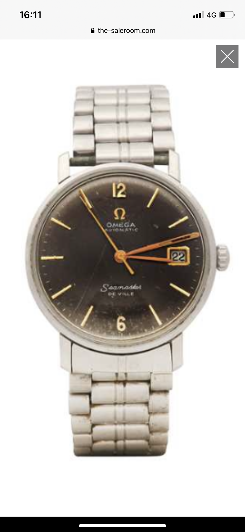

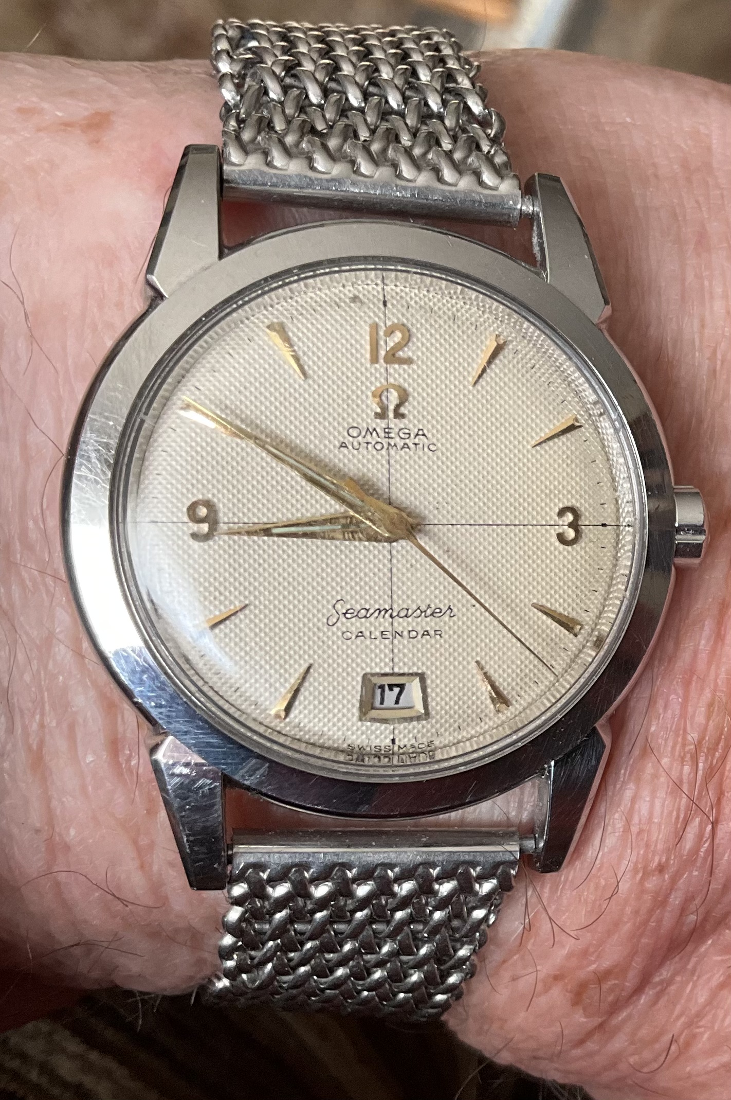

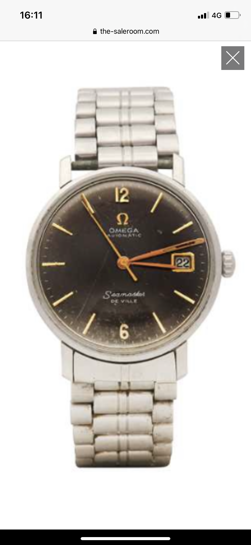

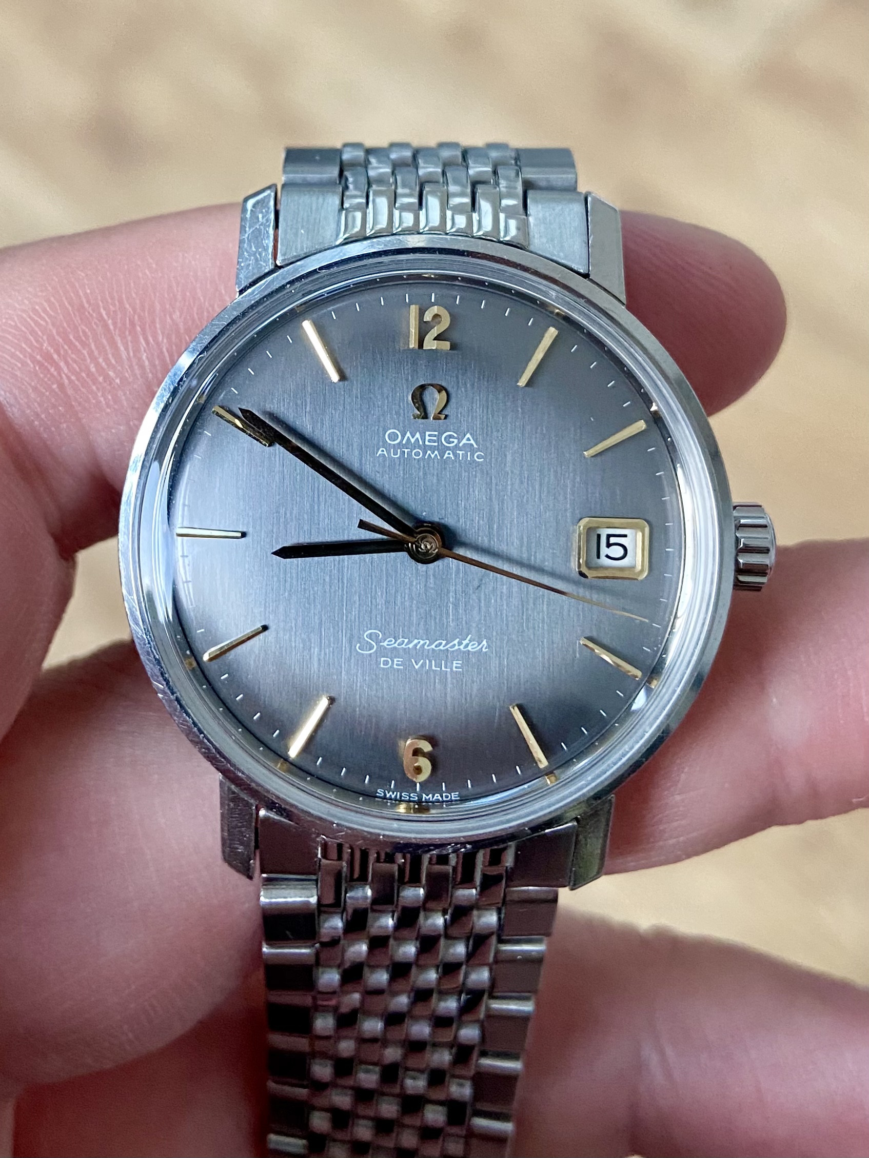

Here’s one of mine:
60’s Seamaster DeVille ref 166.020 with unusual grey dial
Bought for £500
Correct NOS hands £72
New crystal £72
Full service £450
New crown £included
Mint BoR bracelet £220
Before

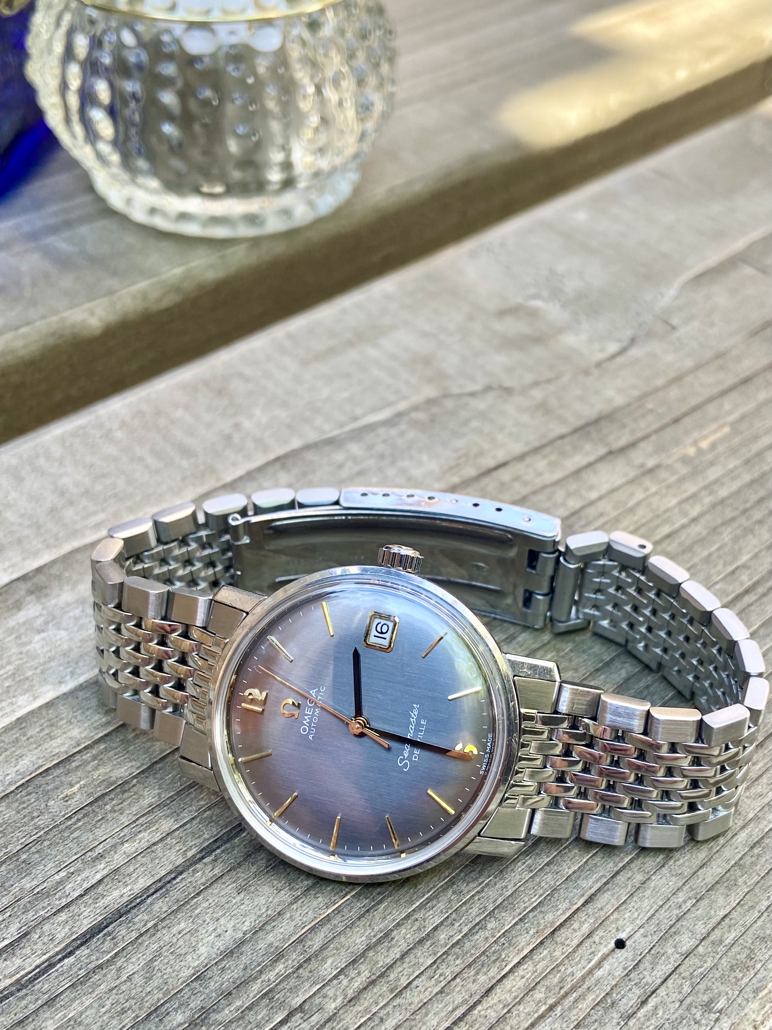

After

Looks like it came with a 1069 missing an endlink- that was a bit of a bonus.

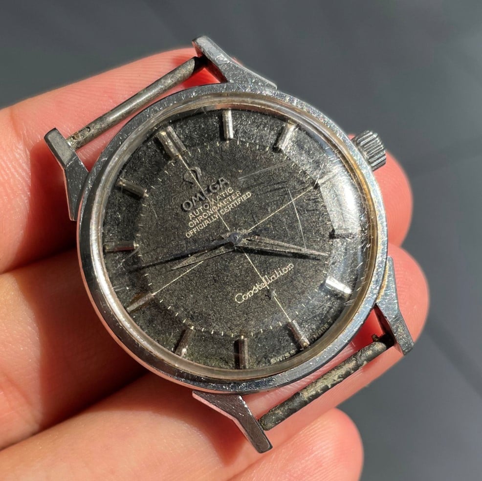

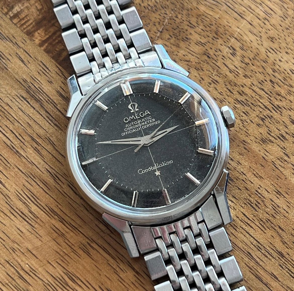

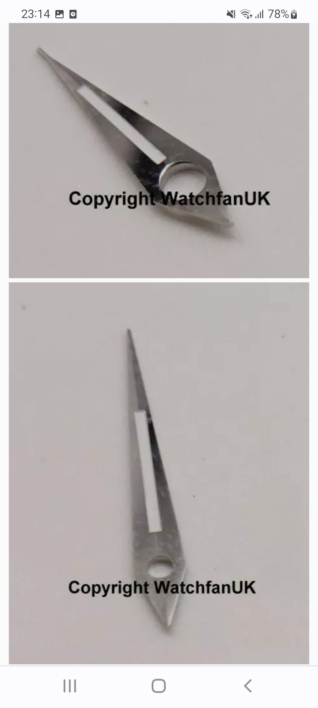

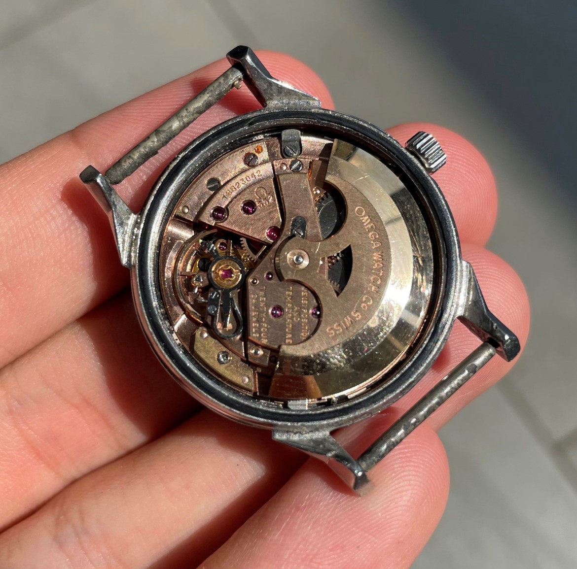

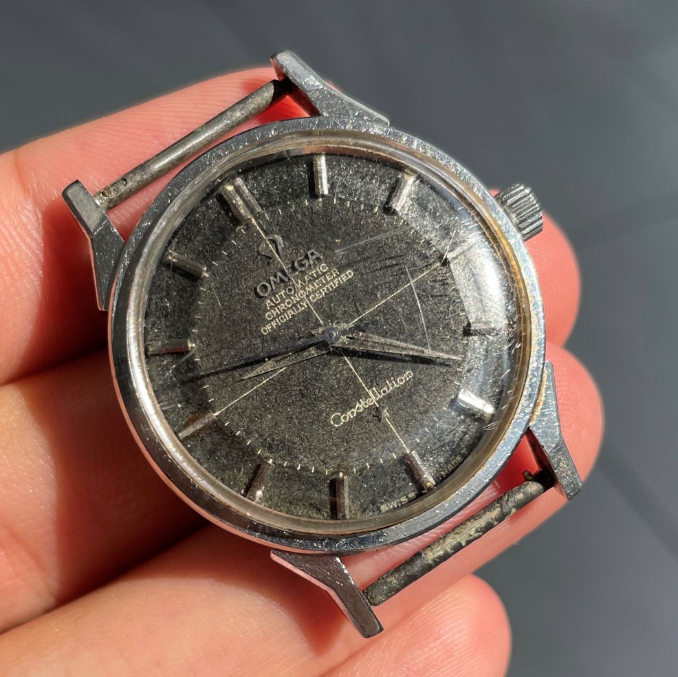

I can definitely relate. One of my projects as an example:
I'm a fan of this kind of patina and it was offered to me for ~1100€ if I remember correctly. Doesn't sound too bad for a pretty sharp, black pie pan dogleg Constellation if it just needs a tiny bit of work? Well.
It needed:
-the correct flat foot thin decagonal crown (50€)
-a new plexi (it was cracked) (50€)
-a correct second hand (20€)
-aaaaand a cal. 551, as, unfortunately, it came with a non-COSC-552. (200€):
It didn't stop there, though. I liked the case - it had obviously been worn, but the lugs were pretty sharp. Except the top right lug was more worn than the others and, most of all, had a major ding. At about that time I got to know a case restorer who offered to fix just this part of the case and I figured great, good opportunity to give this a try.
Of course, on the way to him, the parcel with the case got lost. At least I had kept the case back... So, the search for a spare case began. I ended up finding a 168.005 case, which should've been identical, or so I thought. 500€ later I found out that there were minute differences between the products of different case manufacturers, and my 167.005 caseback wouldn't actually fit. The search continued, I found another case (400€) and finally got the watch assembled and serviced (300€).
In the end, the total came to ca. 2220€ and it took a year or so until all the parts were sourced and I had the finished product:
Luckily, the insurance paid for the lost case, and the costs for some of the spare parts were comparably cheap because I had them anyway/due to the help of some generous fellow OF-users. Still, the initial invest was roughly the purchase price of the watch itself.
I'm not regretting this in any way, and often the process is actually quite fun. But I guess this thread is definitely one that we should link to every now and then when someone joins, asks about a watch and figures "I'll just need a new hand, a crown and a new bezel".

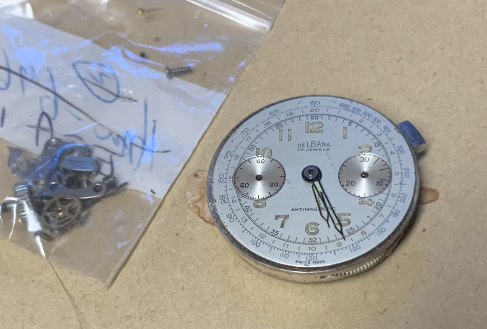

This one langoured in a tin box, in pieces, for about 50 years. It was all there except for the case. Minor rust damage to the dial train components solved with a fibreglass brush. OB member @Tritium made a case (with Omega crystal and crown) available. I conditioned it and put in a new mainspring, and here it is. Total investment about $250.00 plus the mainspring and sweat equity. Calibre 355, date at 6:00, bumper automatic. The un-used mesh bracelet came to me, gratis. No previous owner could use it as it is XXLONG. But shortened to the max, it fits my large wrist just fine.

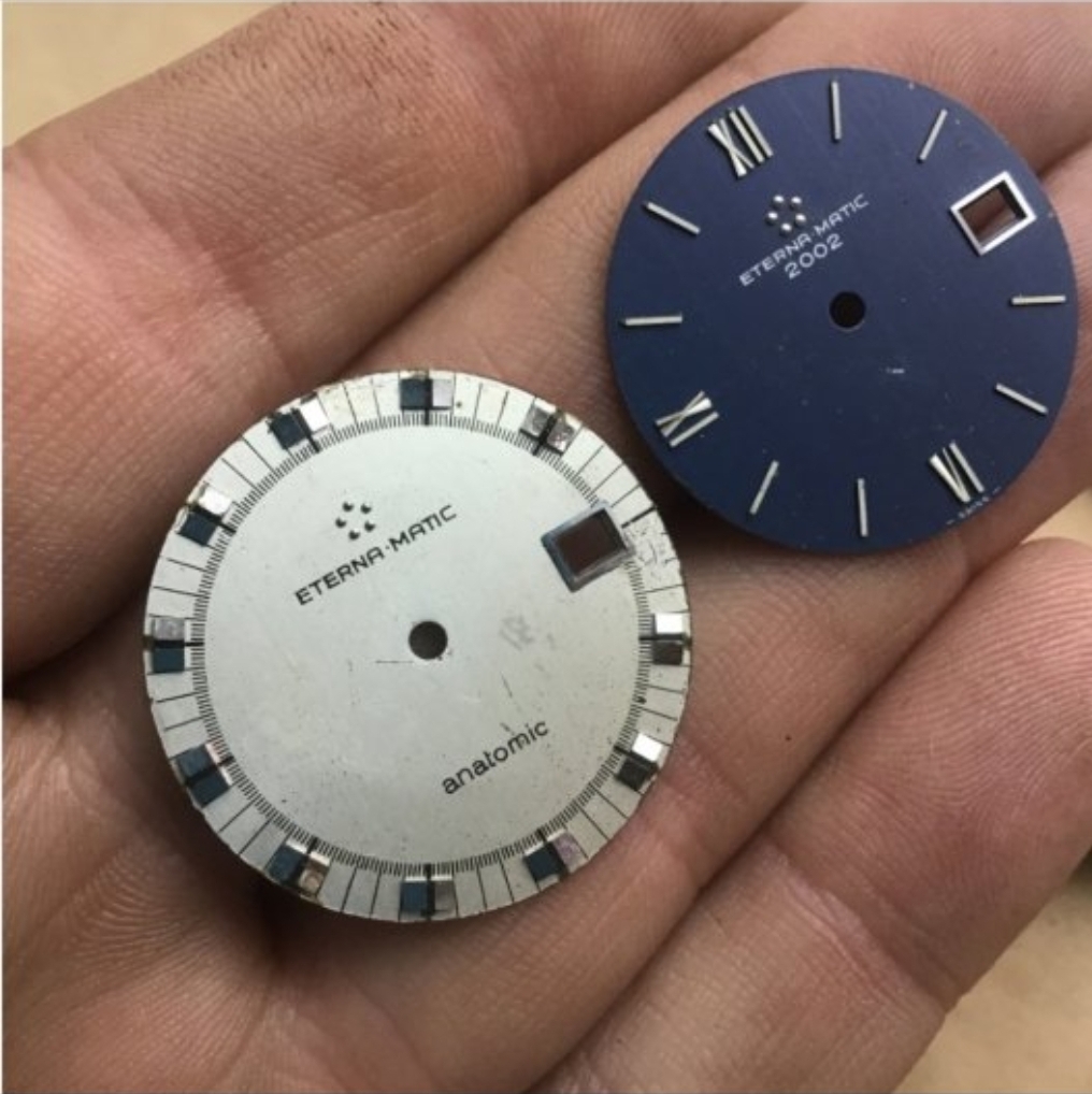

Arrived over the weekend. Only need the dial. I had to get 75% of a watch at fair market value (66USD +S&H) just to get the dial. Now I have most of a spare movement with the same markings on the bridges. I previously purchaced replacement wheels (15USD) and springs (11USD), some of which are doubled apart from the minute jumper spring. These invariably never have a minute jummper spring, A part which can cost as much as a watch movement itself.
At least I already had the case.

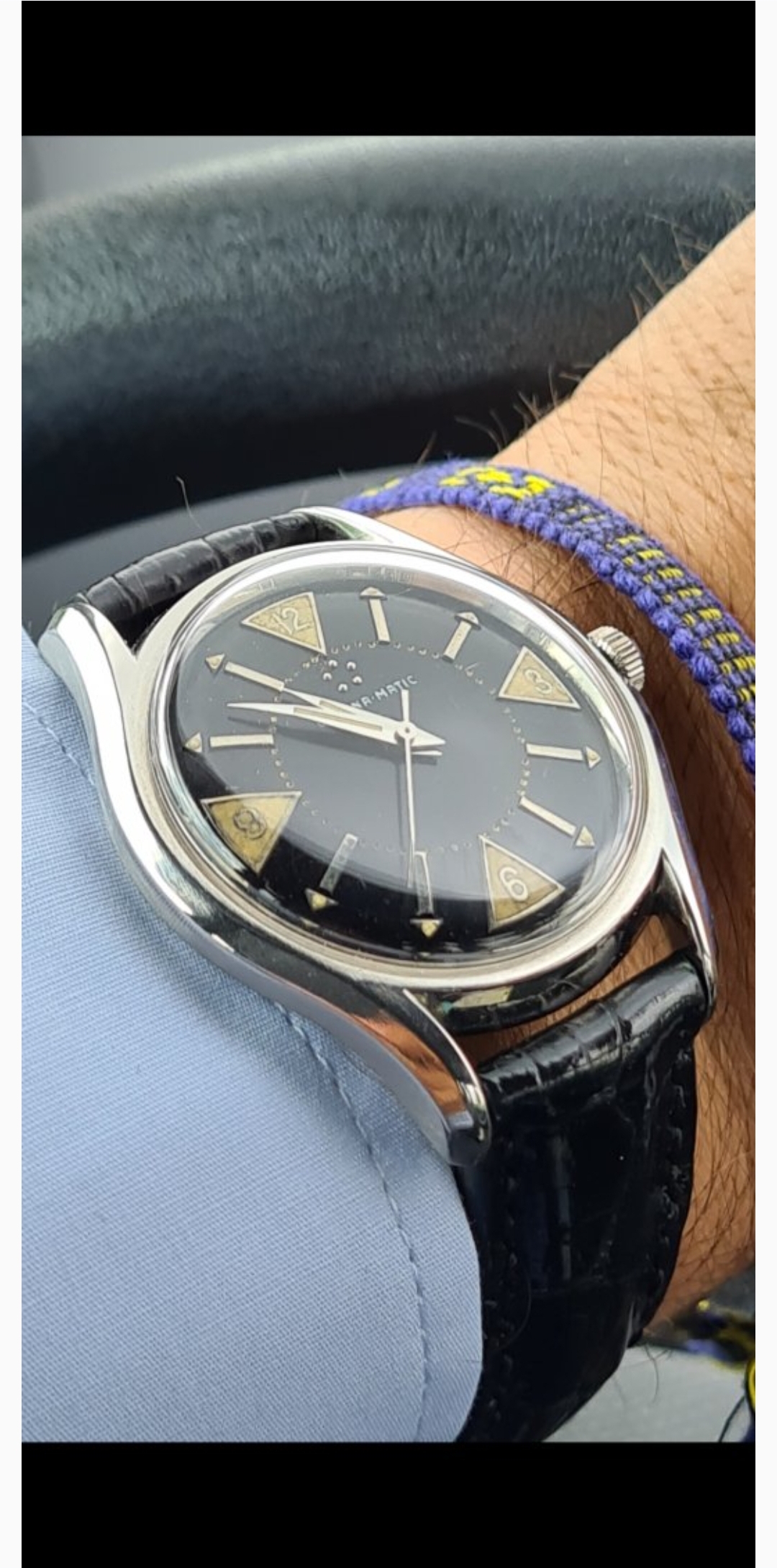

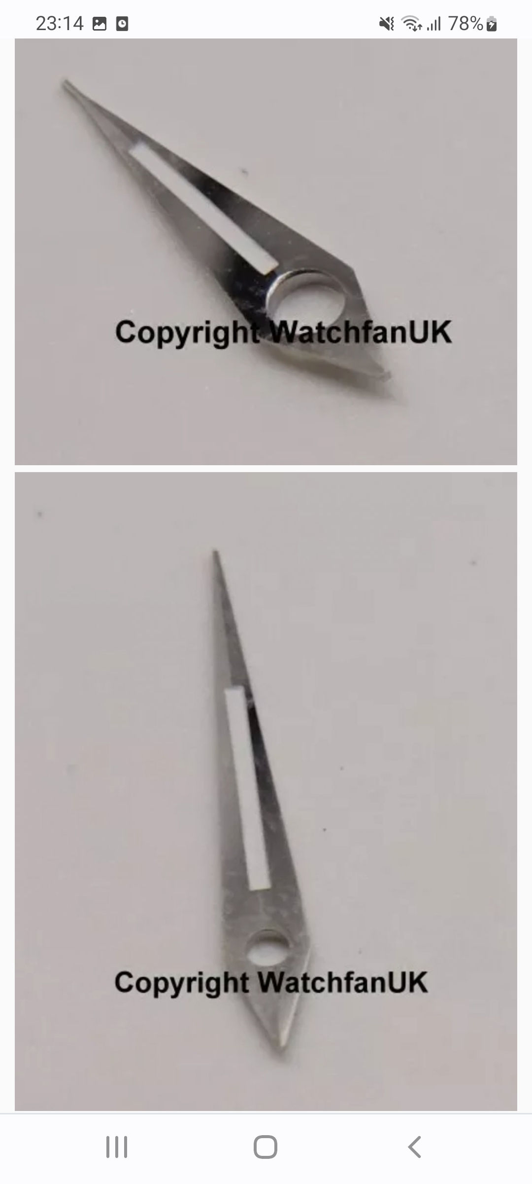

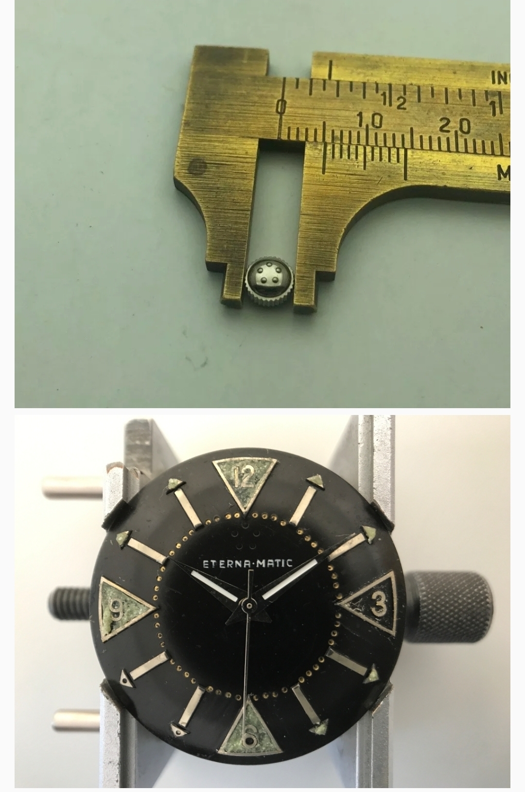

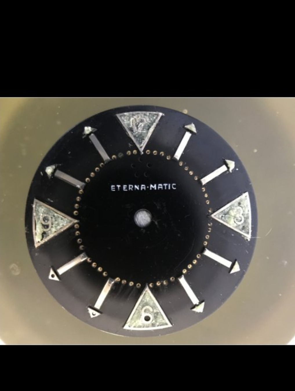

5,026
18,608

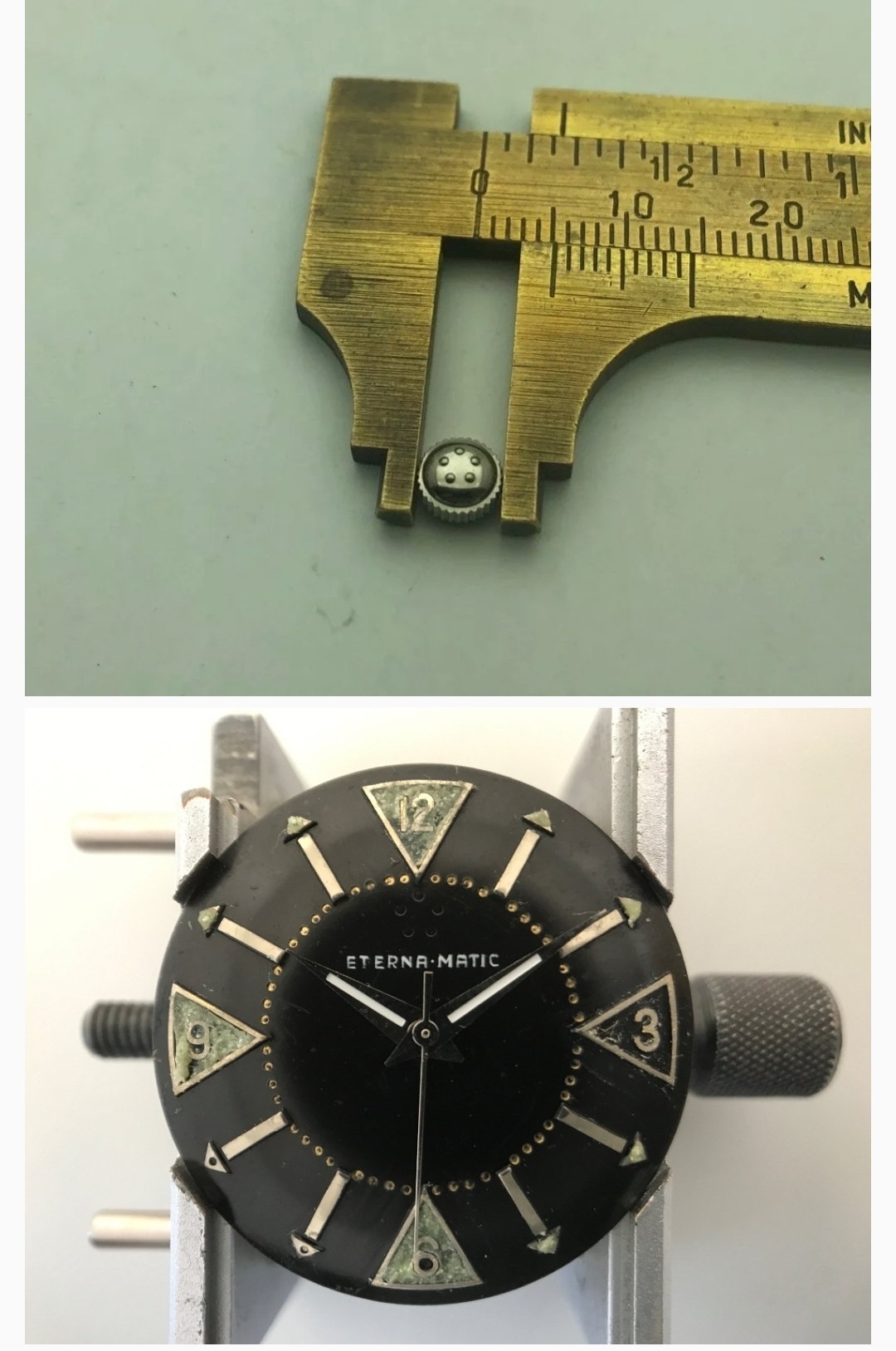

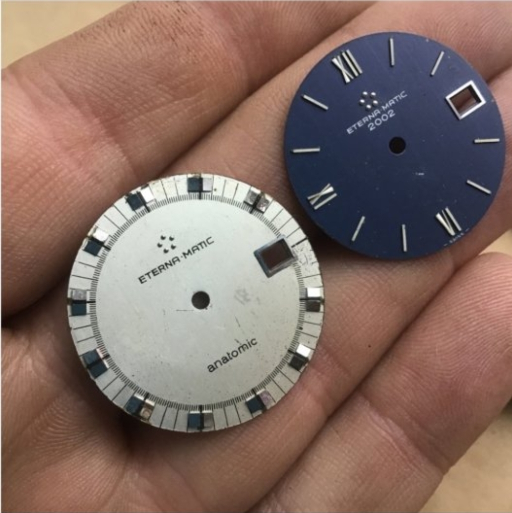

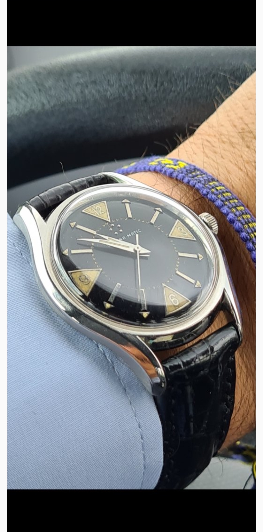

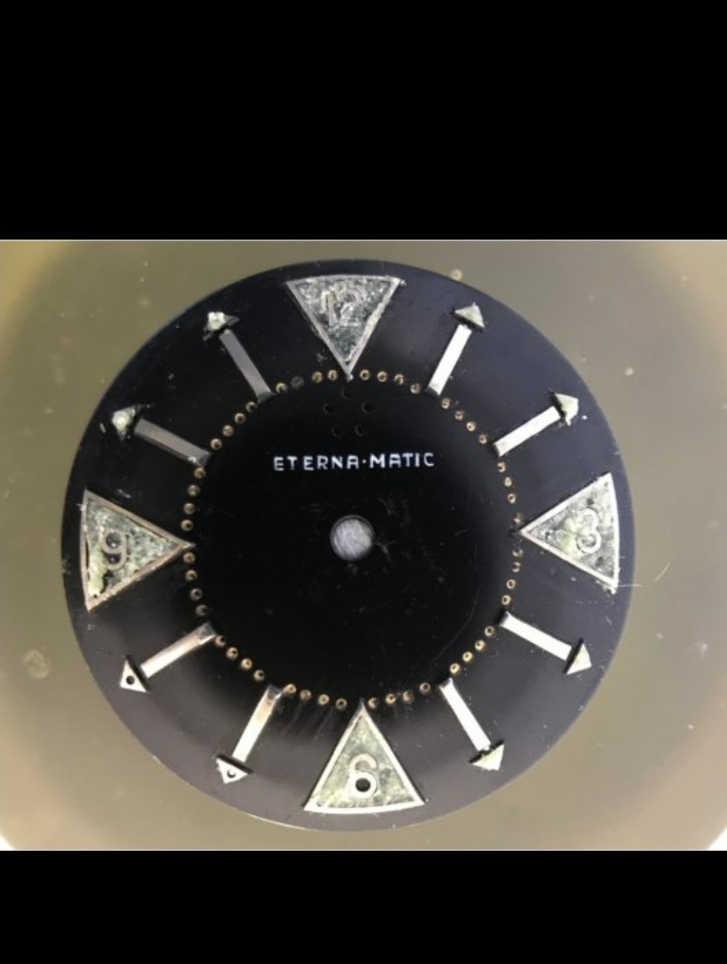

1. Watch EUR 525
2. Hands EUR 25
3. Crown EUR 55
4. Donor dials EUR 40
5. Lume and metal ball job EUR 120
6. Service EUR 245
Total EUR 1.010

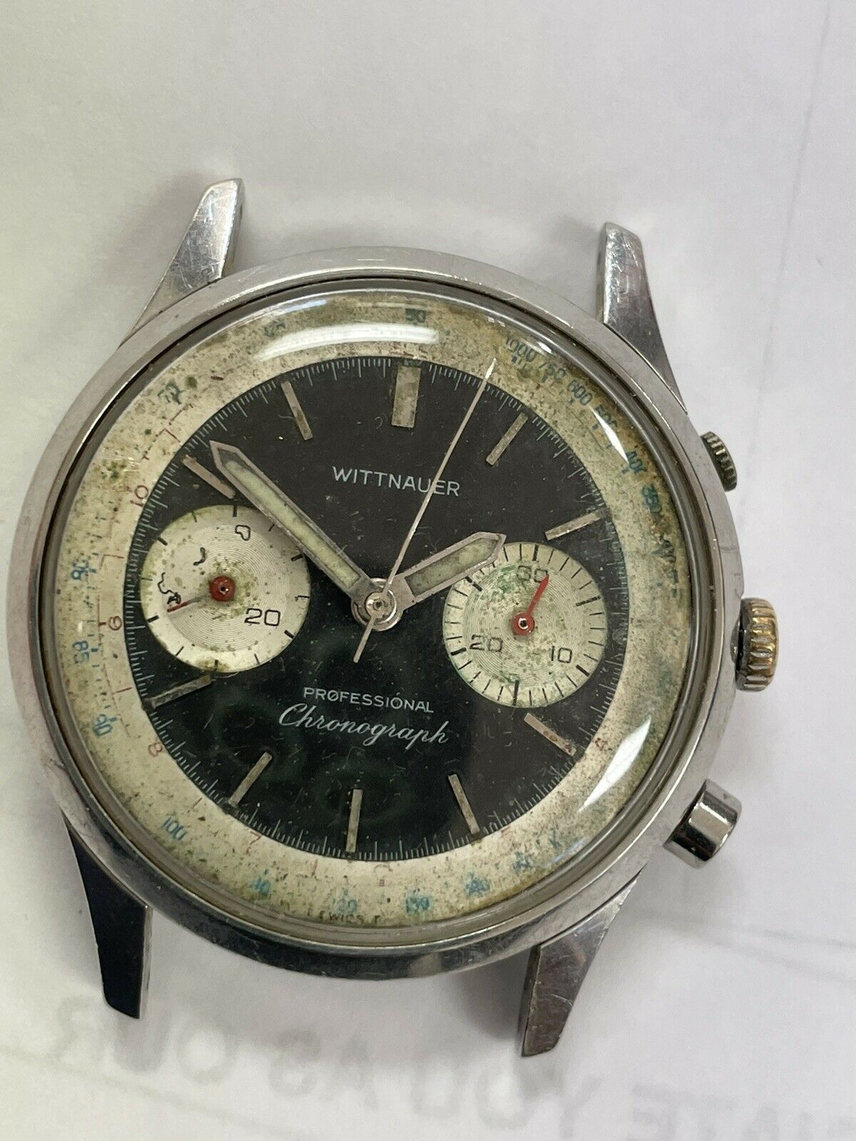

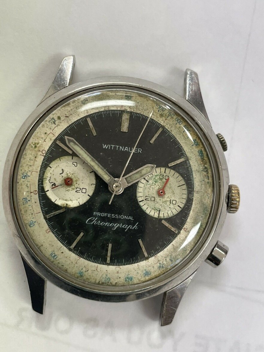

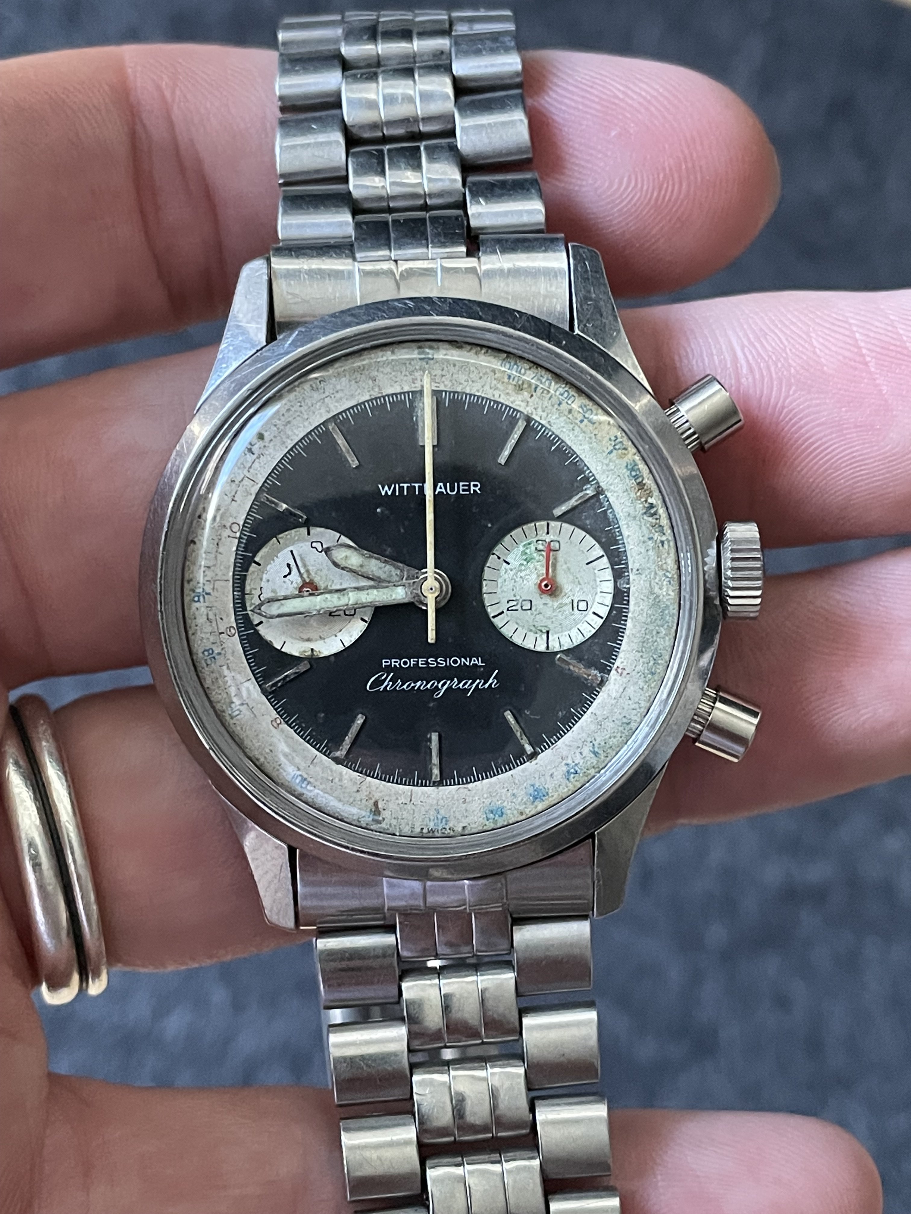

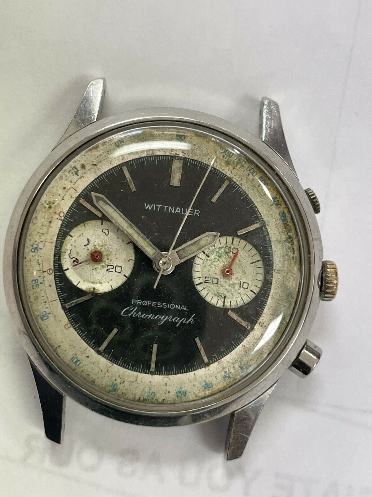

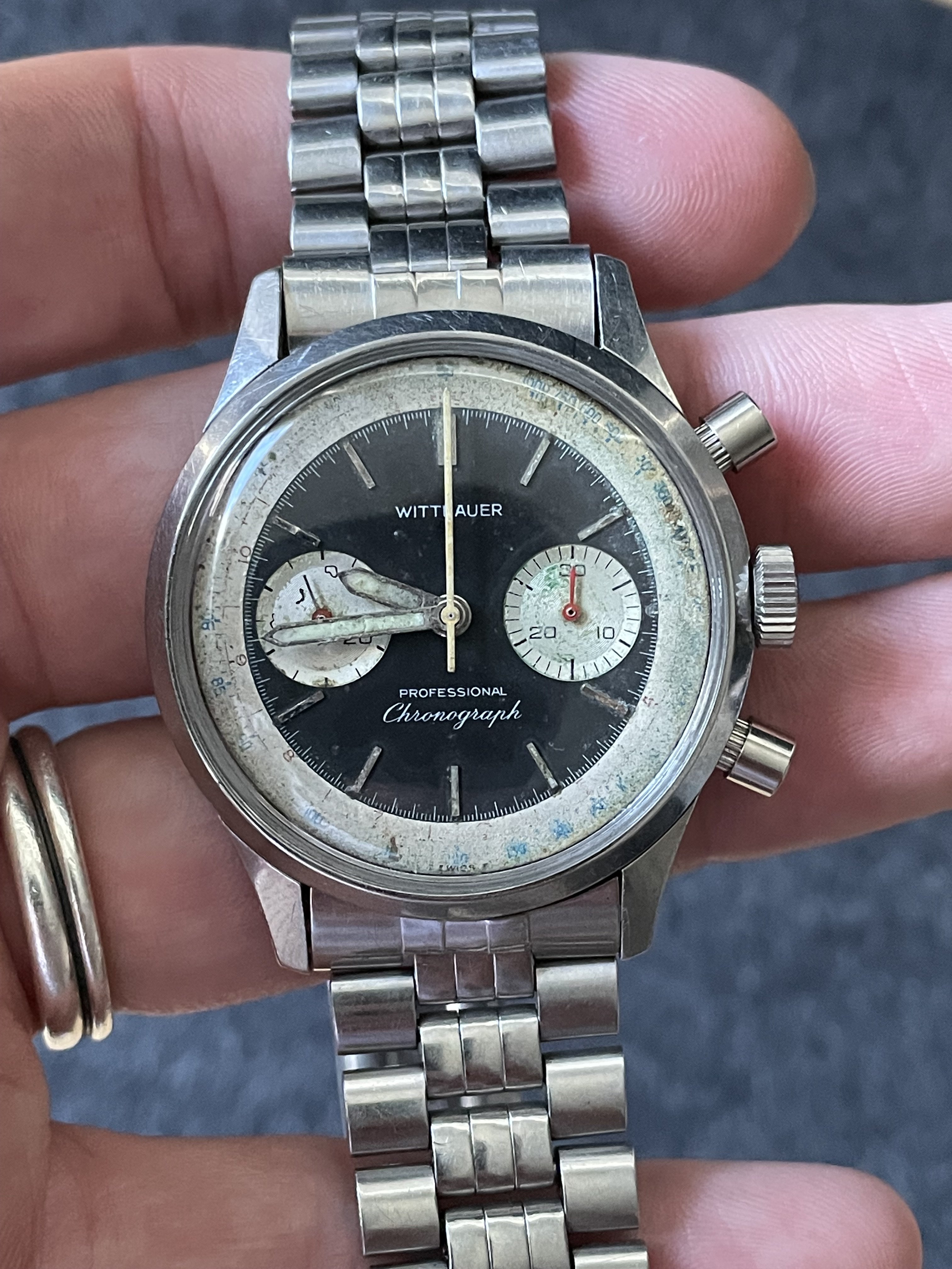

Ha this thread is helping me feel better about my Wittnauer 8023-241T "project" and also reminded me that I'm in good company when it comes to having a soft spot for the watches needing a little love.
The state it was in when I purchased:
The movement was pretty rusted out and needed some replacement parts:
Back from Watchmaker and functioning perfectly:
And the costs through the lens of those old credit card commercials:
Watch purchased - $ 321.91
Signed Crown - $ 176.00 (probably way more than I should have paid but I wanted it to be signed)
Overhaul Service - $1,200.00
All in total - $1,697.91
Feeling when on the wrist - PRICELESS

Nice! Who made the bracelet!
