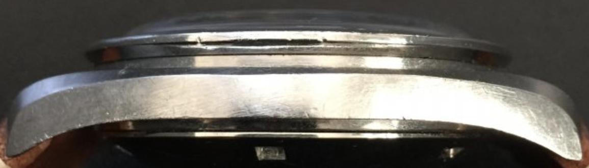

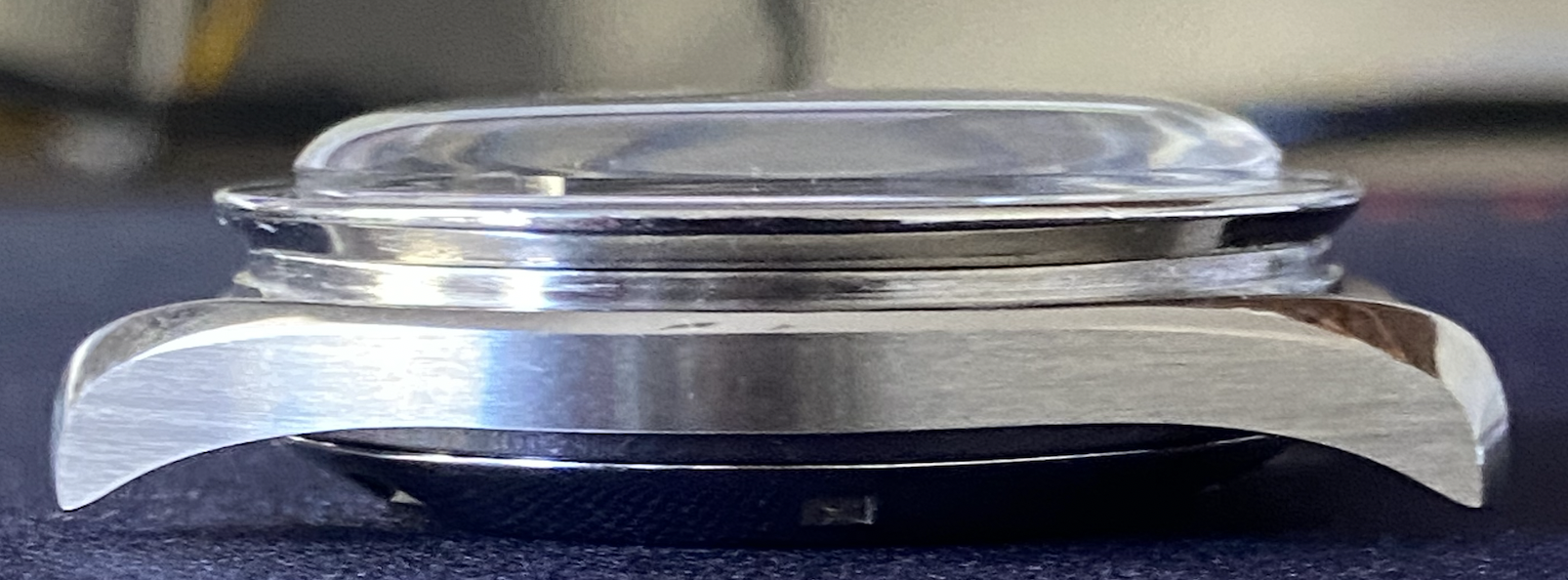

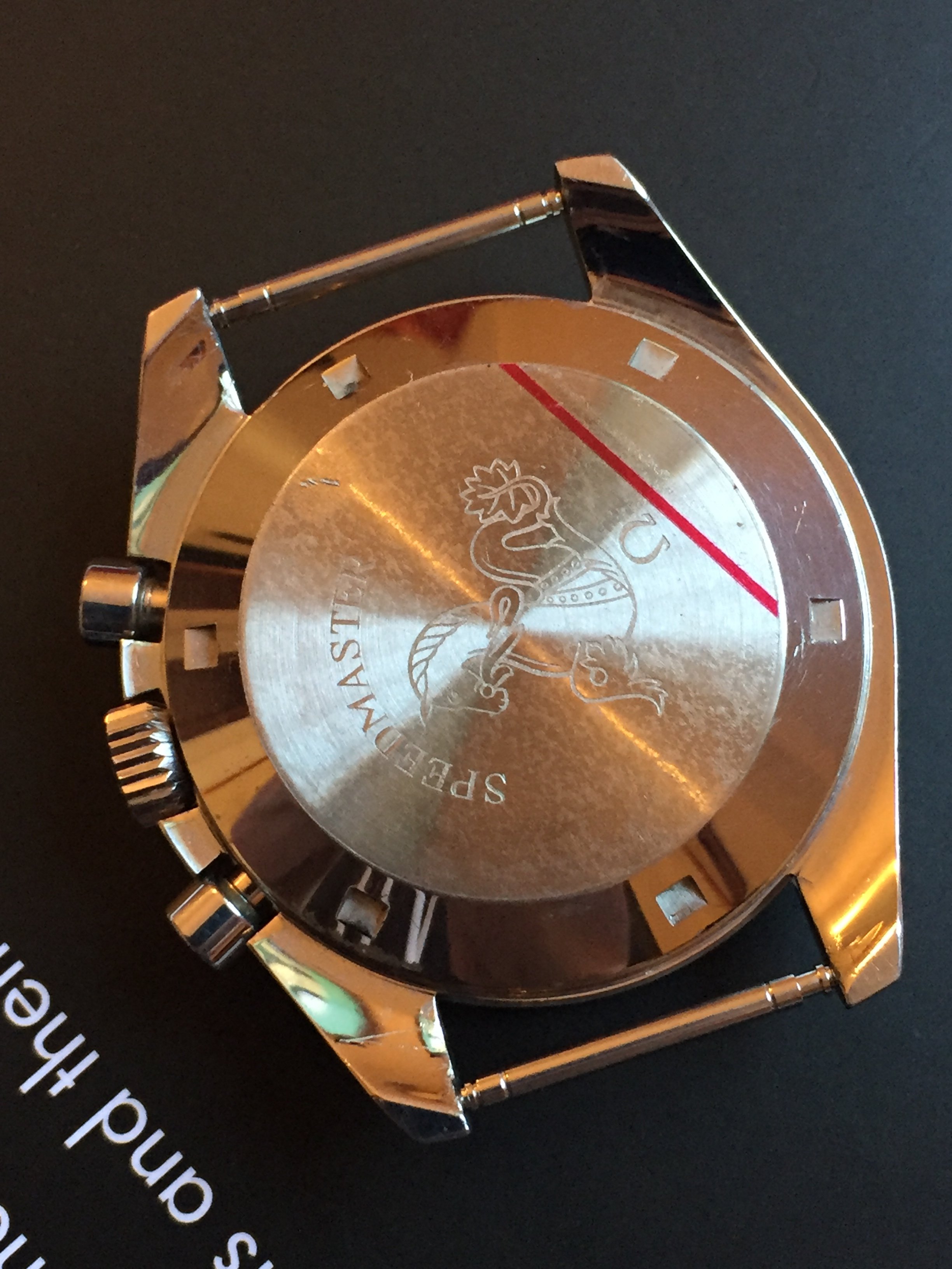

For those who wanted to see the flat facet under the ends of the lugs… here are two; one shows the backside of a CB case( bottom image) and the other a March version of the 145.022-68 ( top)

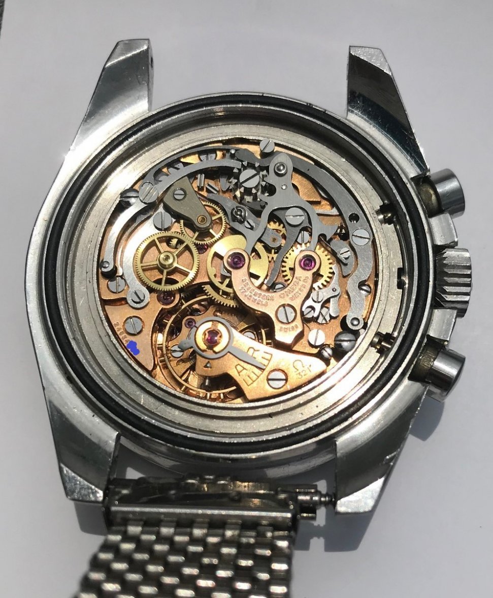

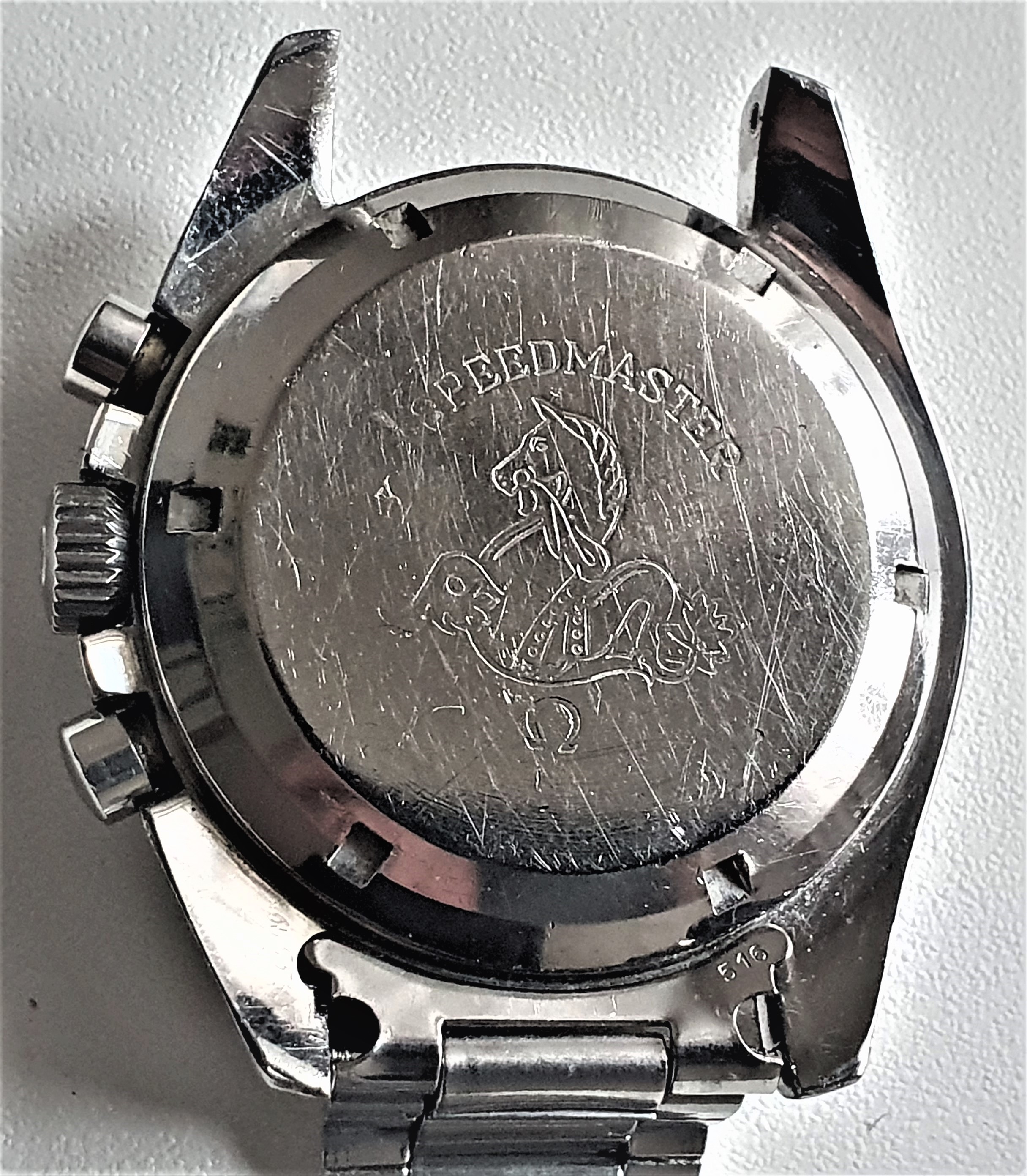

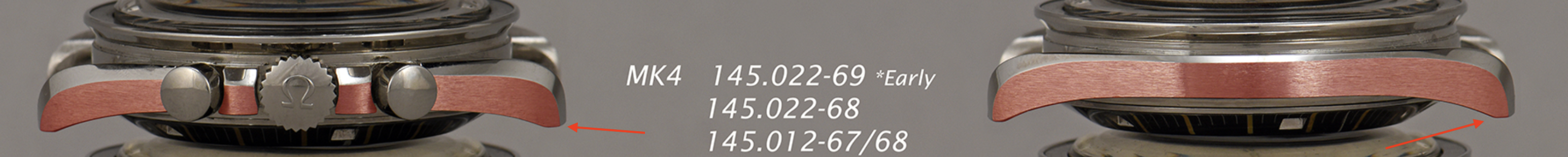

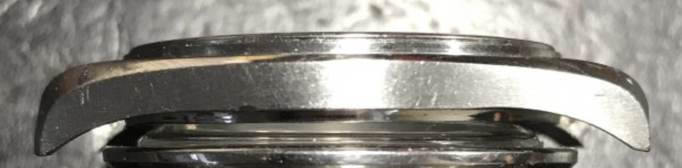

So what midcase type is this? all photos are of 145022-68 Transitionals (all 26xxxxxx serials) previously posted on the ΩF. Notice the more pointed lug tips. The bottom photo has screw in pushers, suggesting it is a Mk4?
Might be the light, angle of photo or just my old eyes, but the tips of the M4 look at if there is a small flat foot.
The top two seem to have the flat "feet" at the bottom of the lugs.
The third one looks like it has been polished, but need more pictures to confirm).
Yes, I believe that's the case as well (whoops...no pun intended, I think) now looking at it more carefully 😀

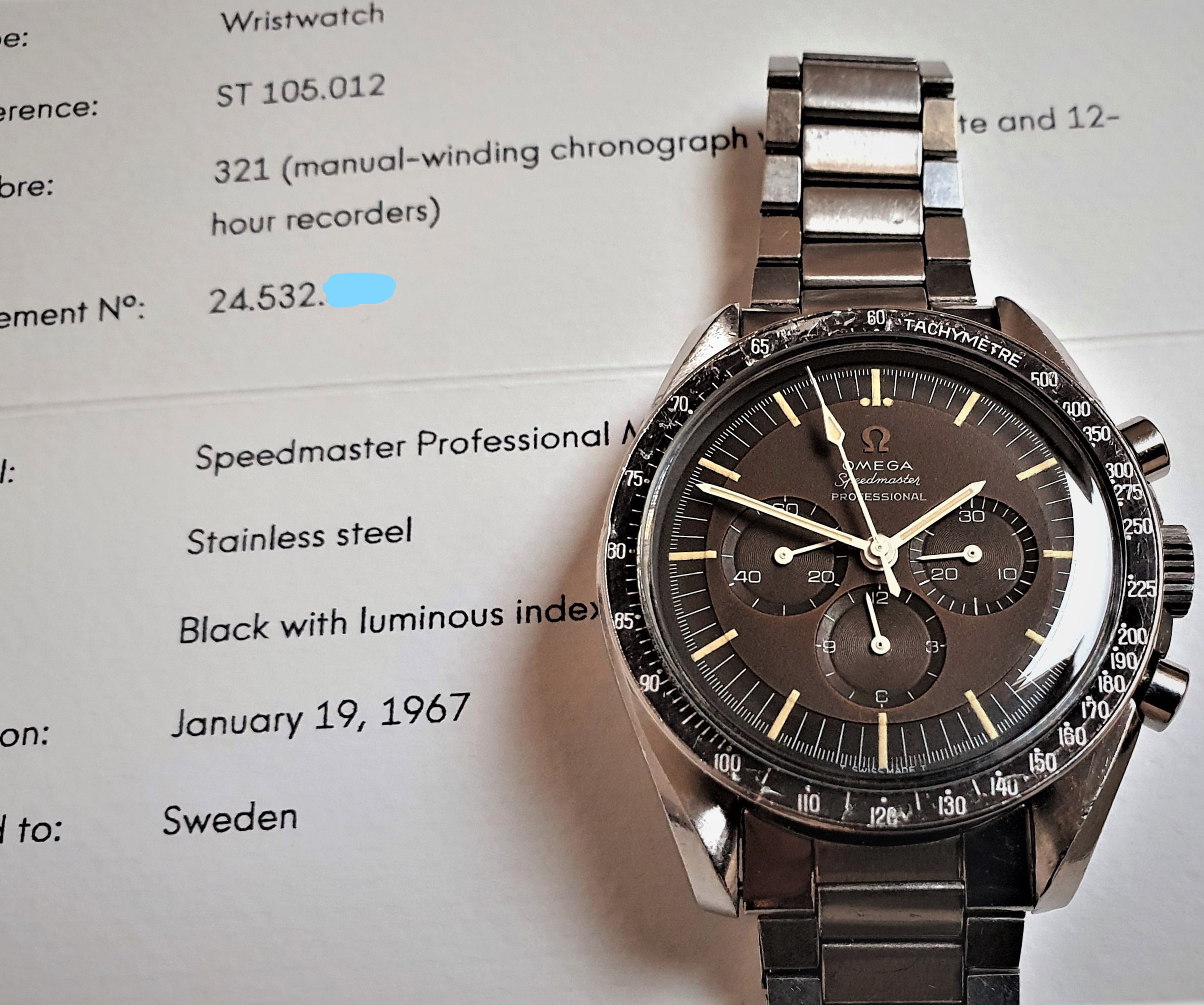

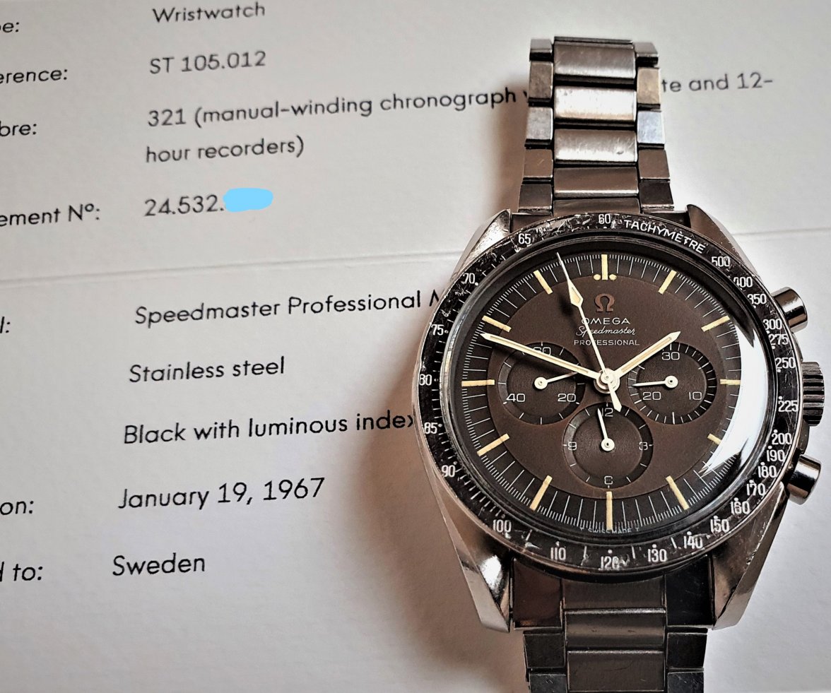

It is true that January 1967 belongs to the MK1. Mine is one of the last 105.012-65?
