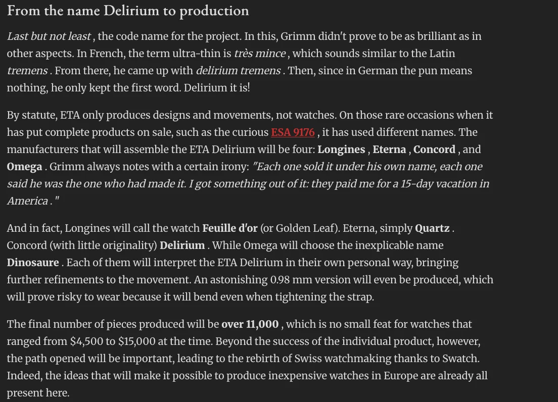

I found this marketing image on an old thread here. Thought it might make for an interesting reverse image search.

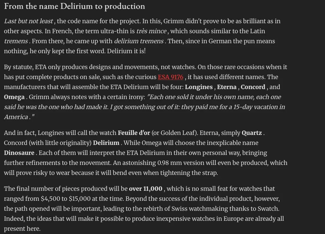

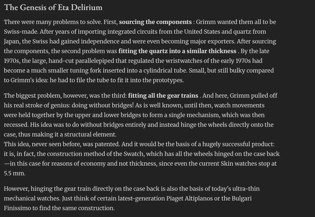

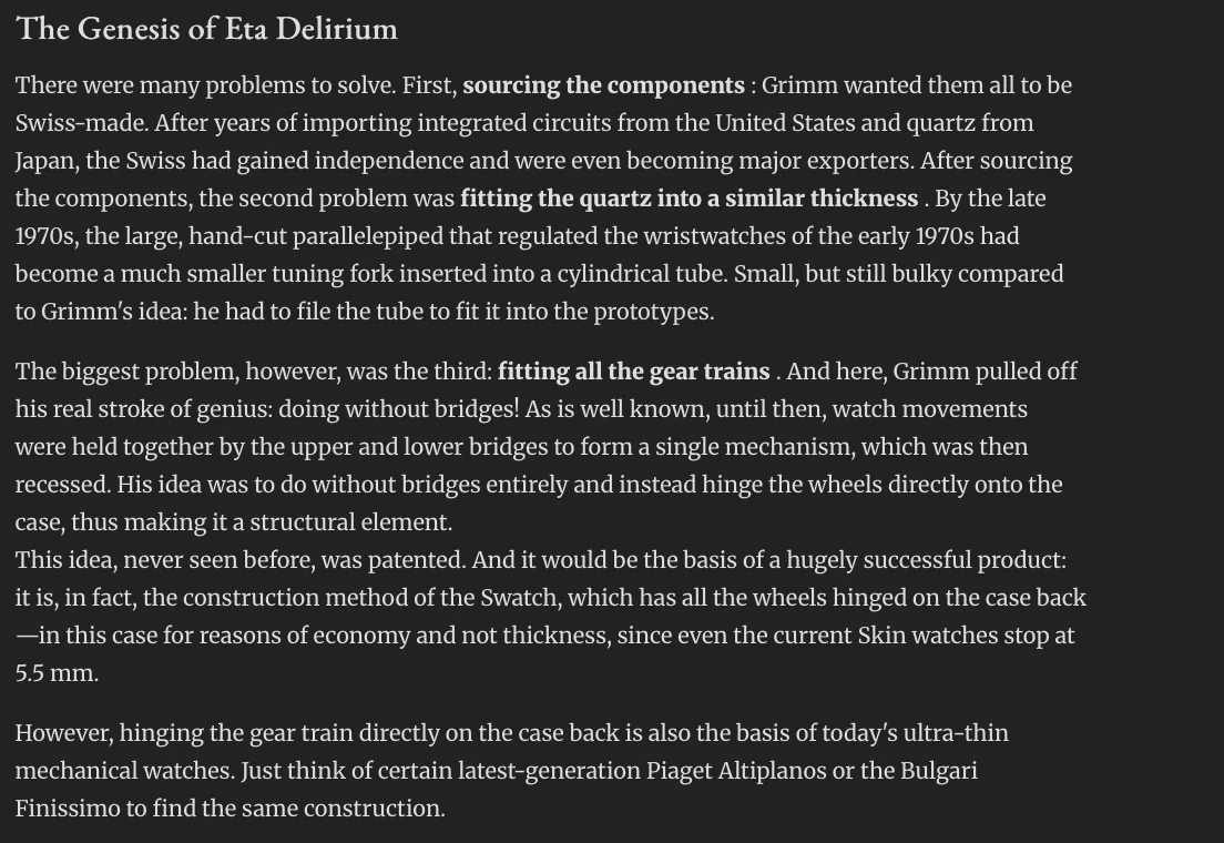

This lead to an interesting Italian journal site. I copied some of the translation.
I love the name Delerium. So fitting. reminds me of the name of my own website delectra. Which is short for Delectra Jouet & cie. This document also answers a lot if questions regarding the names of this style watch. Also who designed it.

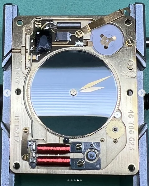

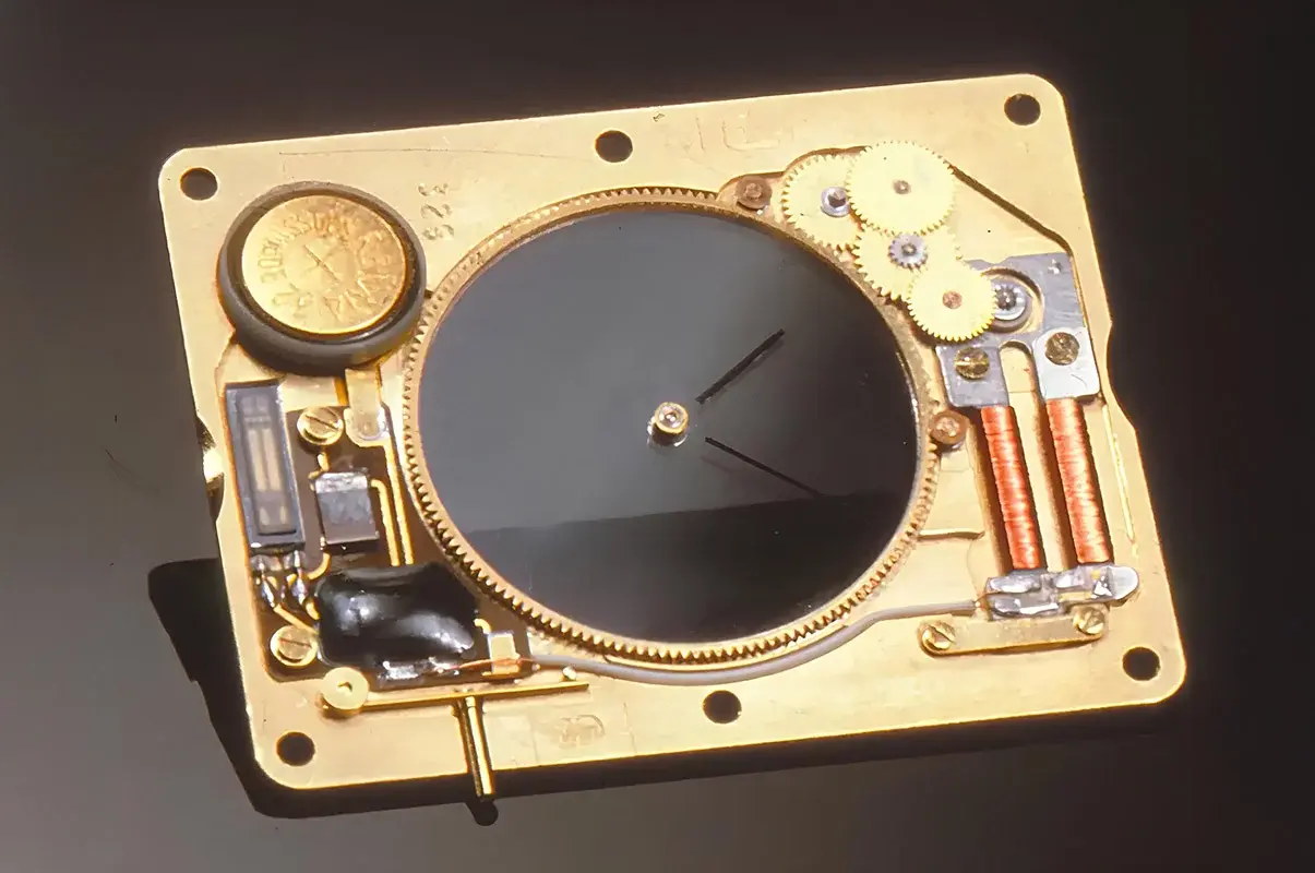

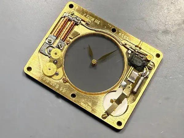

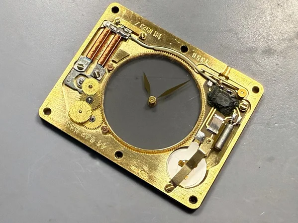

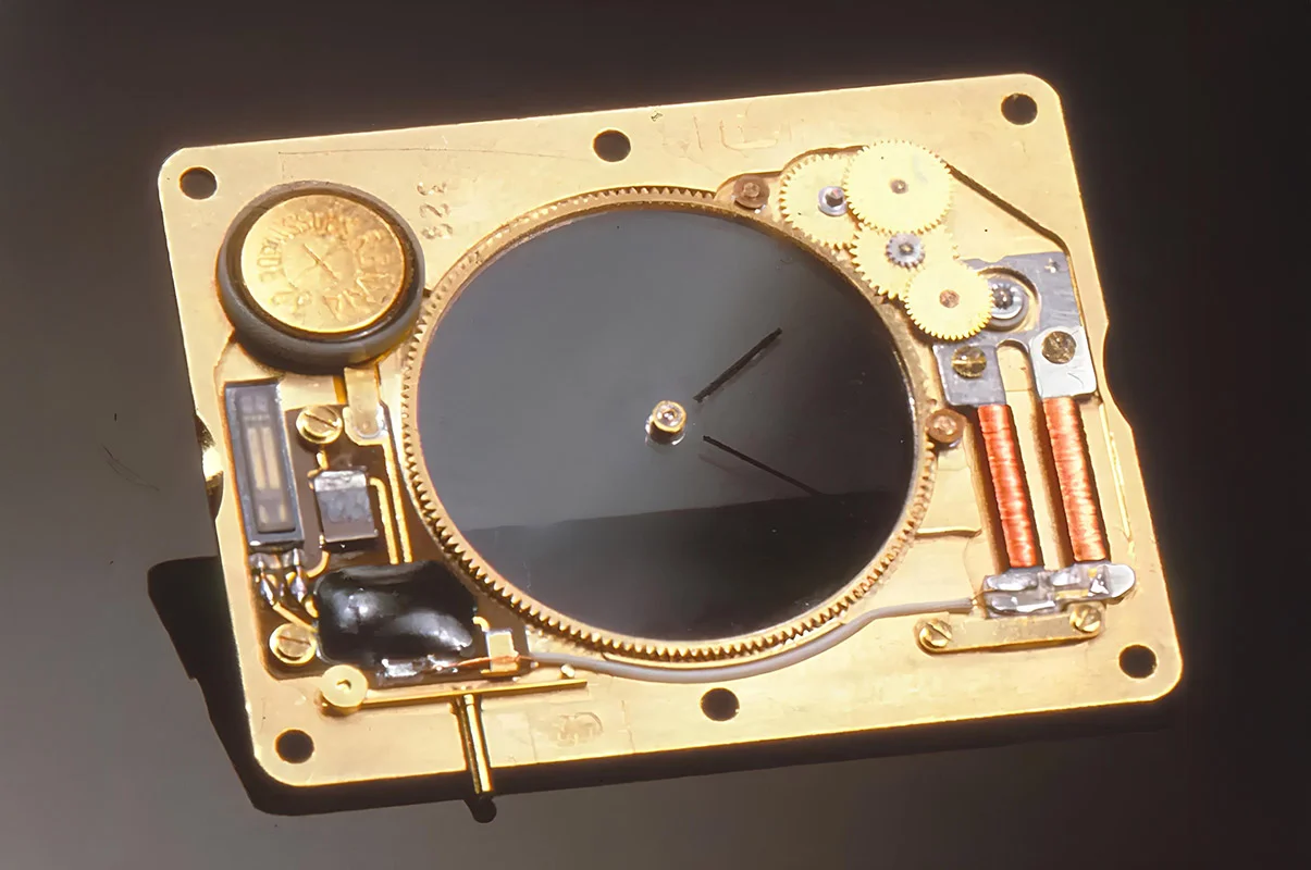

Curiously when I looked at other reverse images I found these

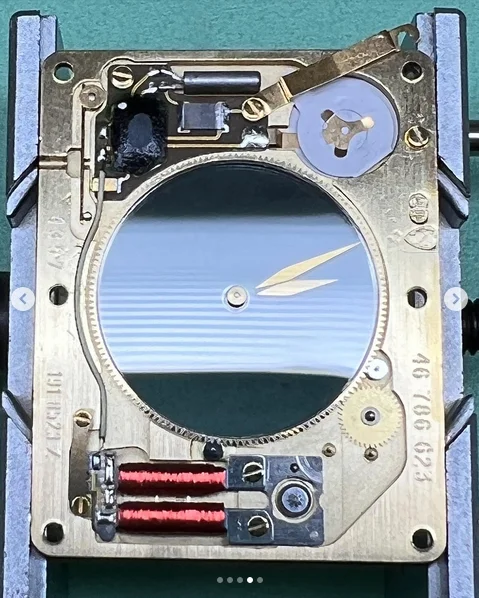

I could not find higher resolution although it seems like out Friend Simon Freese who posted stuff on Instagram (which can not easily be found as there is no way to forward through the reels.) So it looks like he may also be looking at this rare stuff (instead of fixing watches.)
So this indicates that the movement is really from ETA, and is the source of most modern quartz watches. Also opens up the search parameters quite a bit.

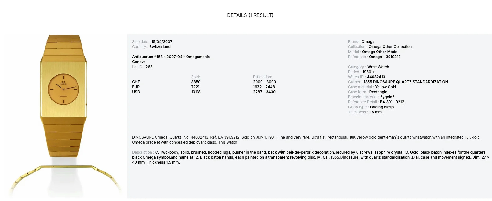

This also clarifies the differences with the Dinasoure and the la Magique which seem to be two different models. Using these source references there are many more case variations.
191.0084, 191.0114, 391.9212 and so on. This also seems to follow the 3 digit numbering where 1 is gents and 3 gents integrated bracelet. 2 is a jewelry watch.

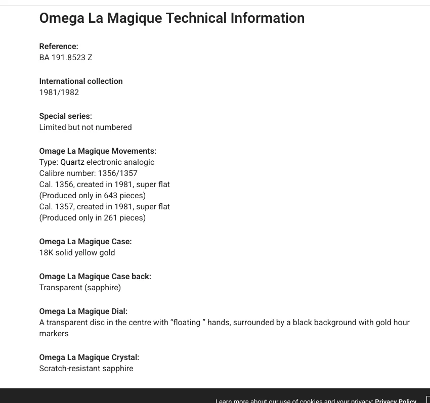

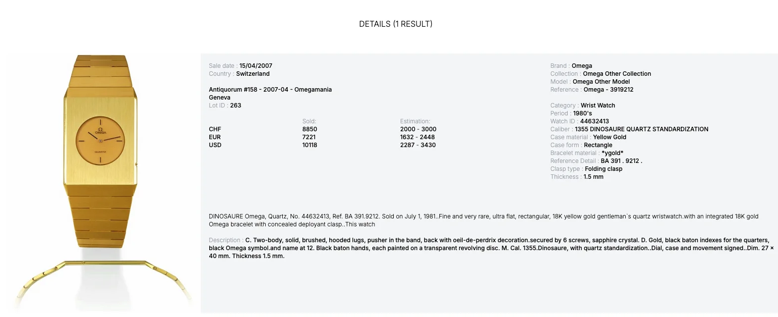

This is from another scrape of the old online data base or sales catalog
It is curious as to why the current data base does not have the photograph, which does appear in other reverse image lockups.

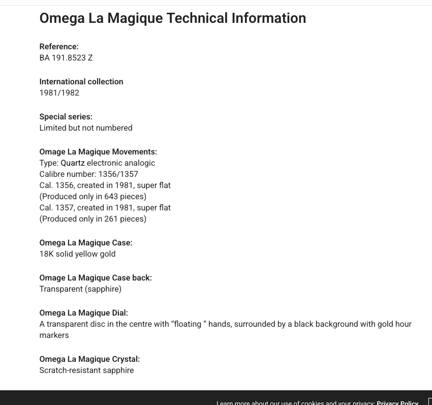

The movement calibers do seem to be 1355 1356 and 1357. The main difference seeming to be the height.
There is no indication that such a watch was never produced in anything other than gold. So would be wishful thinking to find a Stainless version of this case.
There is also suggestion that these were prone to being so thing they broke when flexed on the wrist.
