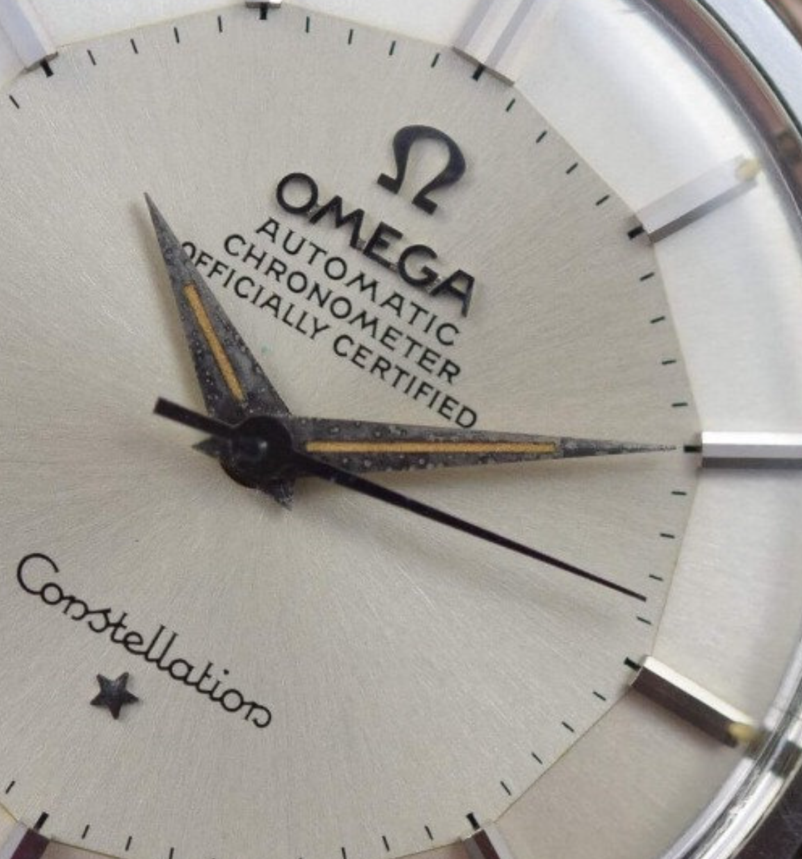

Well, the texts on the dial are very obvious reprinting. It's always easy to tell - no proper serif fonts!
This is correct:
Oh, but on the original the G is also bigger then the sorrounding letters. So at least here I was wrong.
285
221
In my "defence" I just want to say that in the ad pictures were not very clear..😀. In conclusion I wasn't lucky 😀 and as a conclusion for me.. I still have to learn. Thank you OF lesson was learned.
6,834
10,503
This is a positive attitude to have.
However, it would be worthwhile you looking further into Constellations if you want to acquire one as there are a number of tells that would have confirmed that all is not well with your kit (even with crappy pics) - the fact that a 167.005 is not a date watch being the most obvious.
Unfortunately, even if you wanted to assemble the watch for your own amusement you will (fortunately) not be able to use an Omega movt as the date window is in the wrong place as @nanjingcigaretes pointed out.
So you will likely need to find the Chinese movt these fake dials were originally designed to accommodate.
For me, if you can't get your money back, then personally I would take a hammer to the whole shit-heap and consign it to the bin - or alternatively frame it as a reminder that, to quote the Bard, "all that glisters is not gold"

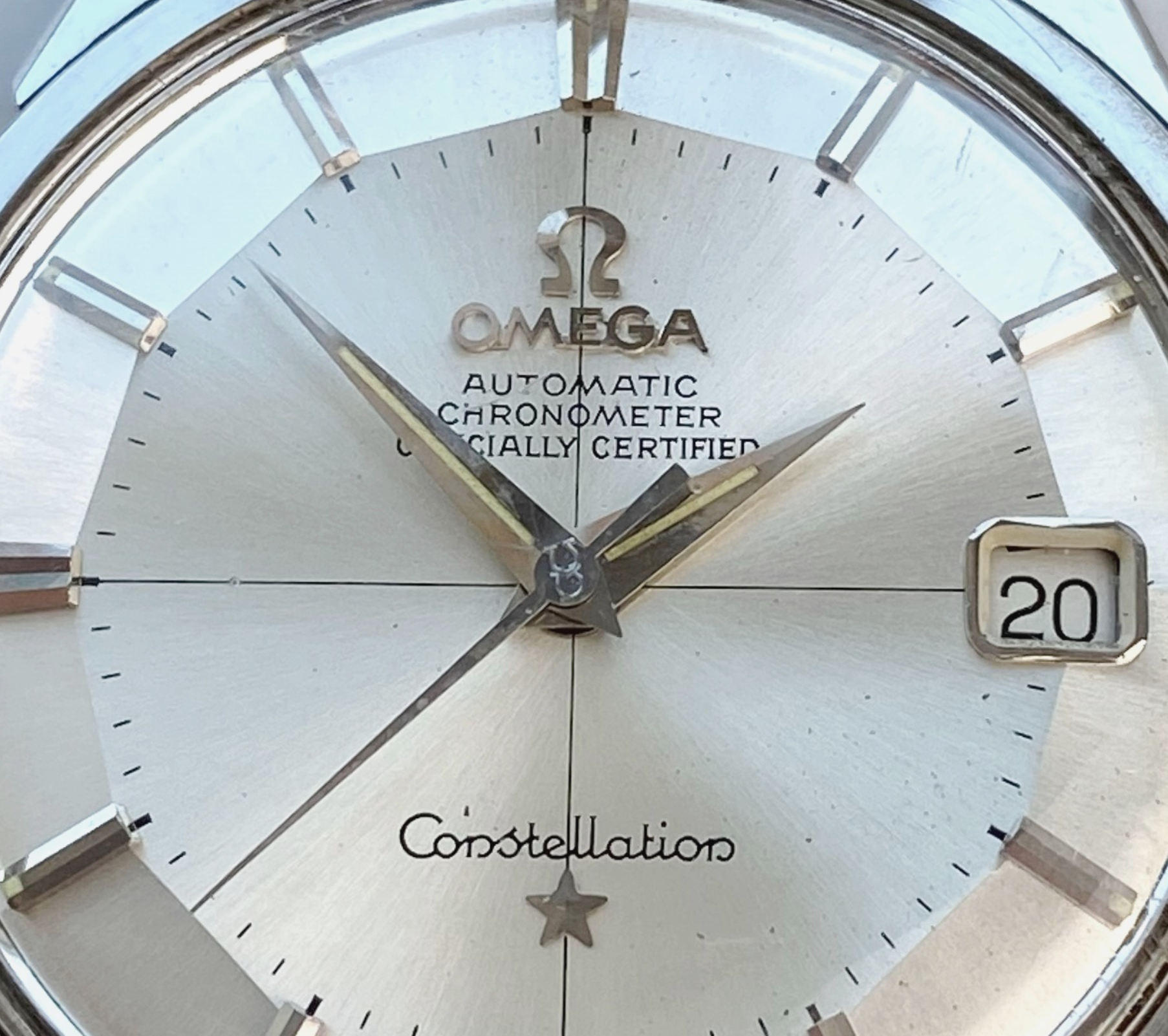

This is correct:
Some Constellations from this era did not have heavy serif fonts like that. Some Constellations had painted markers instead of onyx. The date window is slightly off position, but it could still properly fit a vintage Omega movement and this fake case if the case were slightly larger than the original.

Concerning letter G... I have seen open and closed one. Which is correct... I have no idea!
Opened is smaller and closed is larger.
On these photos metallic logos are very different!
