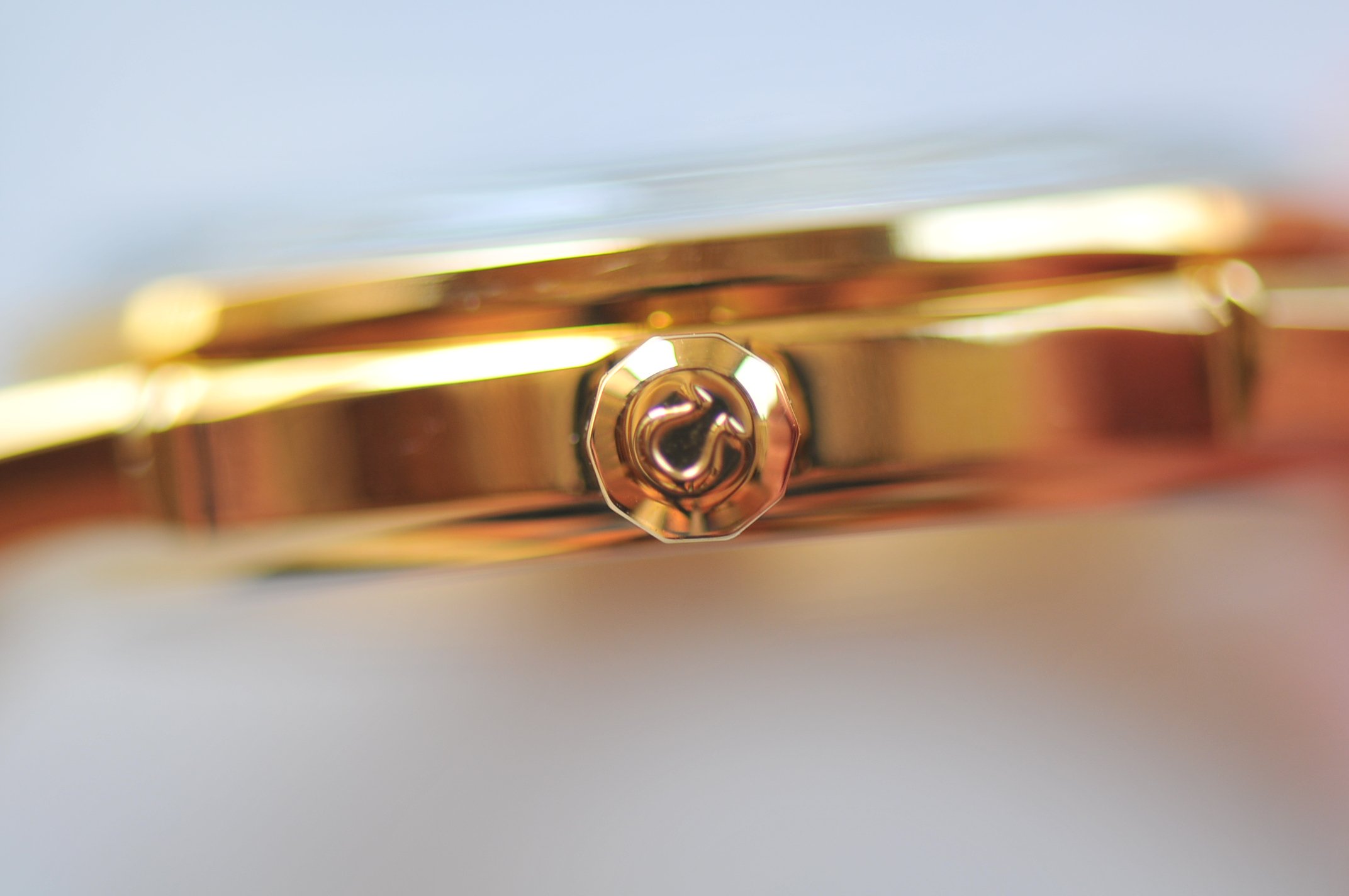

So I was lucky?

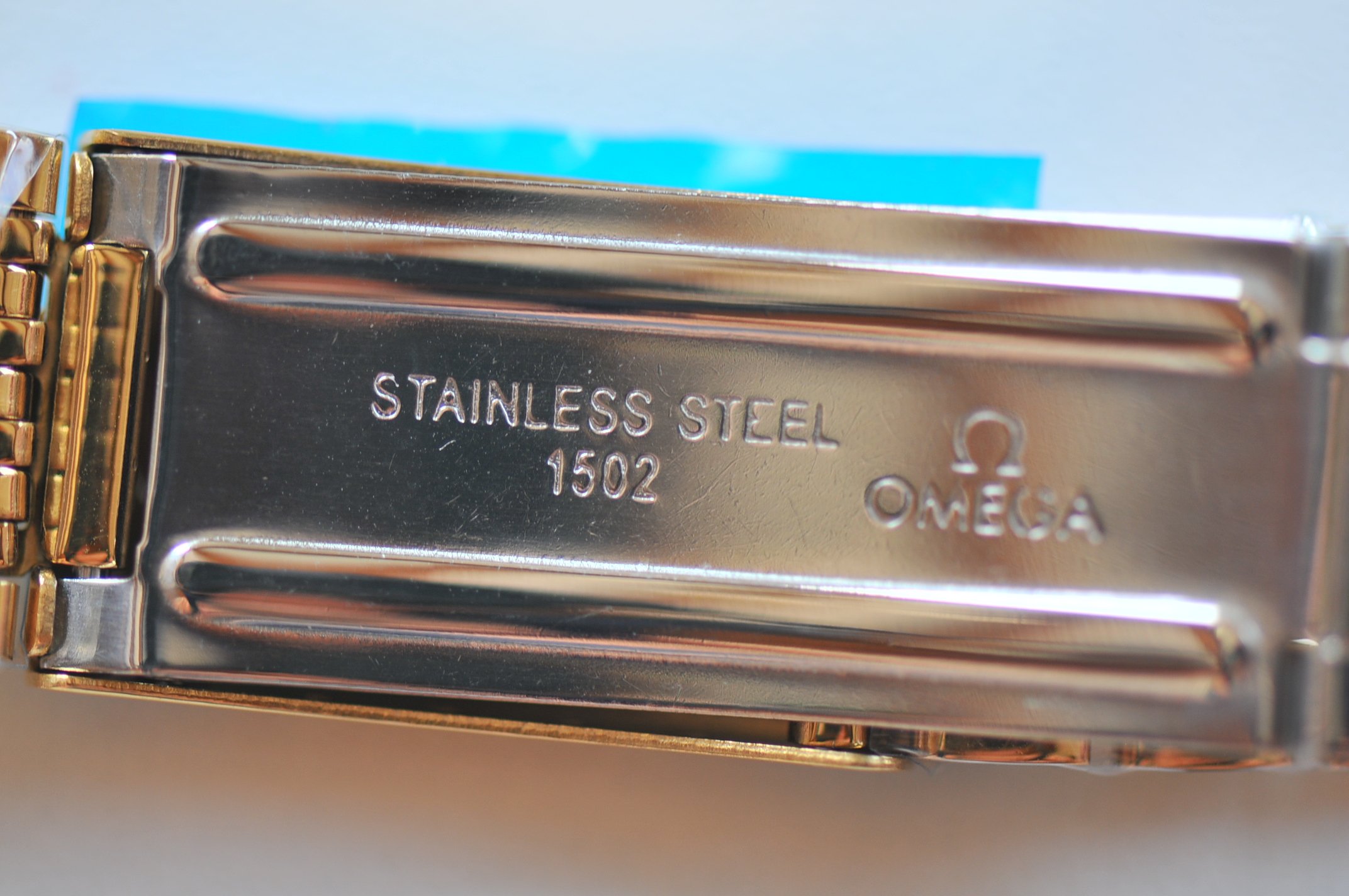

You havnt worried about the OMEGA Letters? The G is bigger then the sorrounding letters for example...
1,177
1,757
If it looks to good to be true, it probably is.
I would ask for a refund.
13,676
19,044
The star is different also. But fonts are more or less correct and these parts may fool the novice collector.

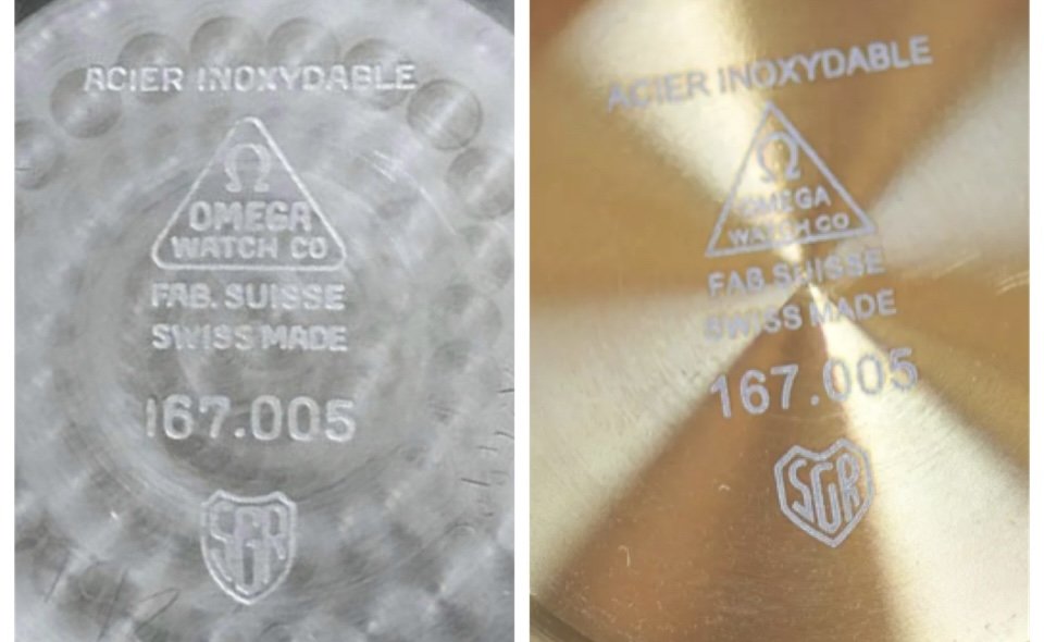

Oh by the way, the Ref. 167.005 on the caseback would be for a non-calendar movement. The dial has a calendar window. So even if complete, you would have a fake frankenwatch.

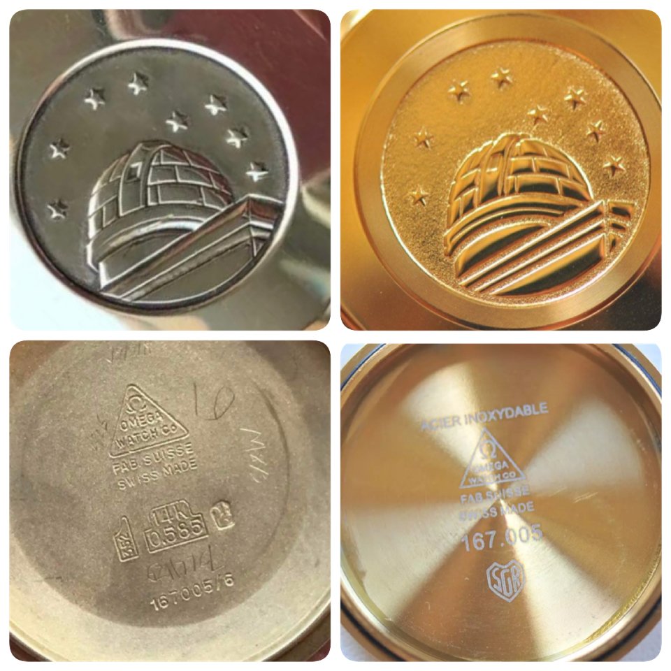

An all "gold" case marked acier inoxydable...
1,024
4,126
I believe that if the outer caseback was gold (as you showed), then inner side should be marked as 14k or 18k. The picture was searched from Google.
Please see the difference in medallion and “14k” as I mentioned, also print quality.
Even in the steel case ref 167.005 , it should be like this.
