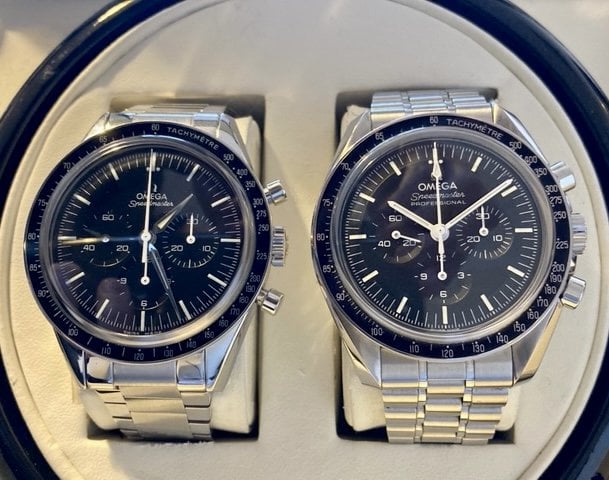

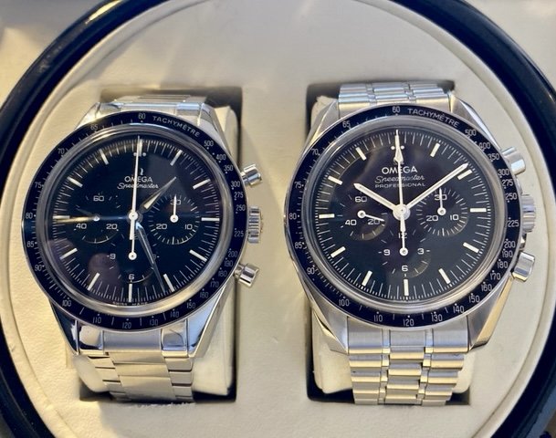

I was asked; "Does the chronograph run on a Speedmaster Pro when you are setting the watch?"
This made me...
I immediately thought I had the answer, then thought some more... but still wasn't 100% sure then I wondered what about the new 3861, and realized I have no idea.
While I have not checked, I am pretty sure the 321 and 861 will continue to run, but does the 3861 since it hacks?
Let's get some guesses, don't google it.

Never thought to try it…… 1861 runs but also jumps….. 3861 stops dead on the tracks when it hacks. Don’t think I will be doing it again on either watch but an interesting question. 321 will also run with a skip or two I imagine but they are not here today. Now can someone explain why the watch winder is having no effect?.
