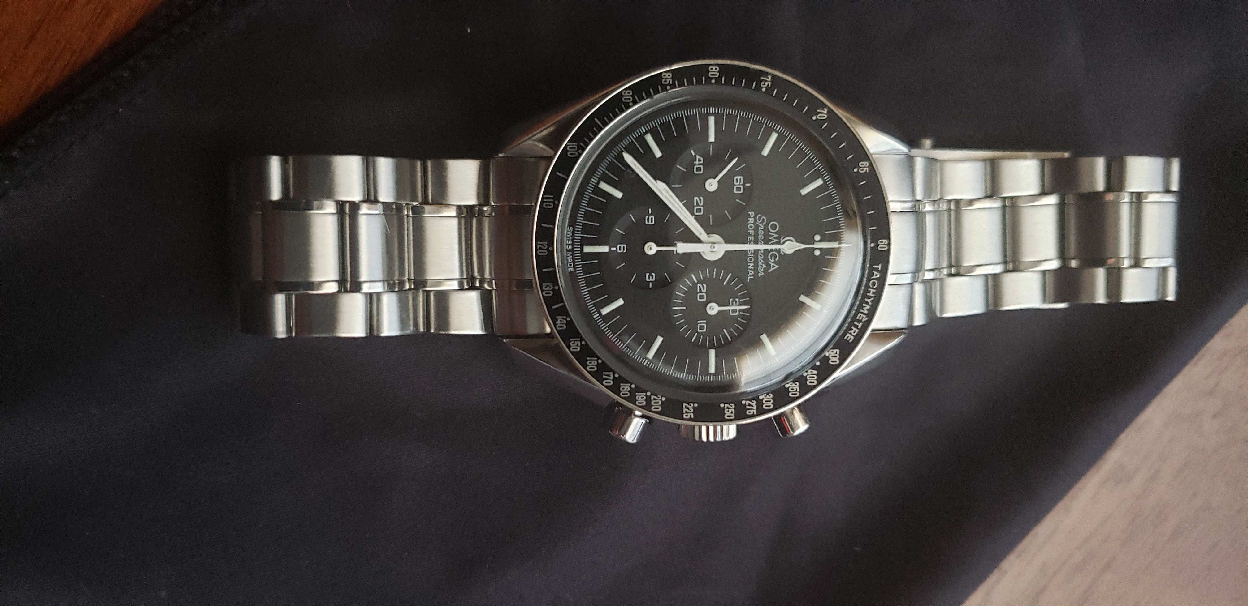

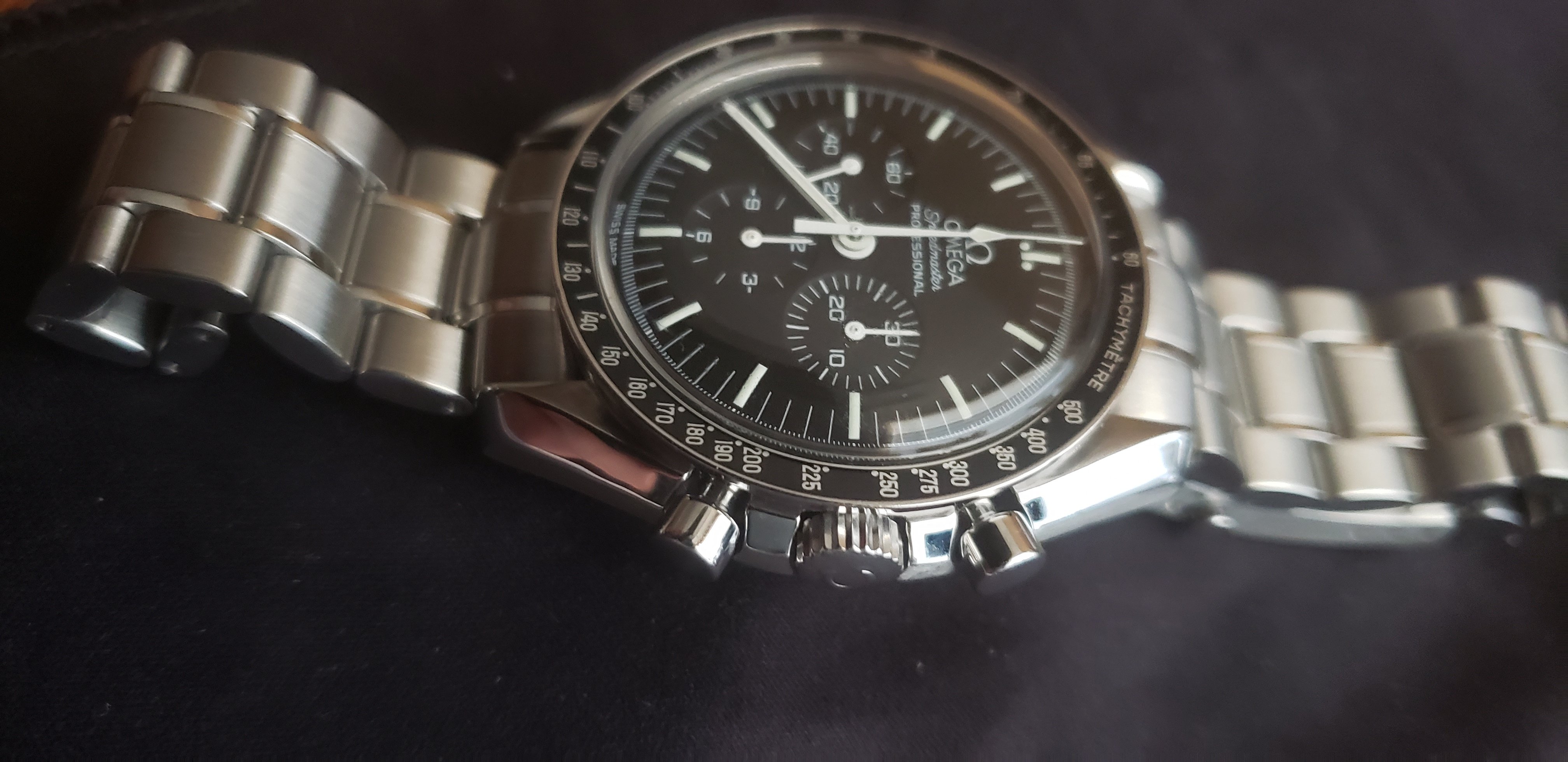

I just purchased a Omega speedmaster reduced 3510.50

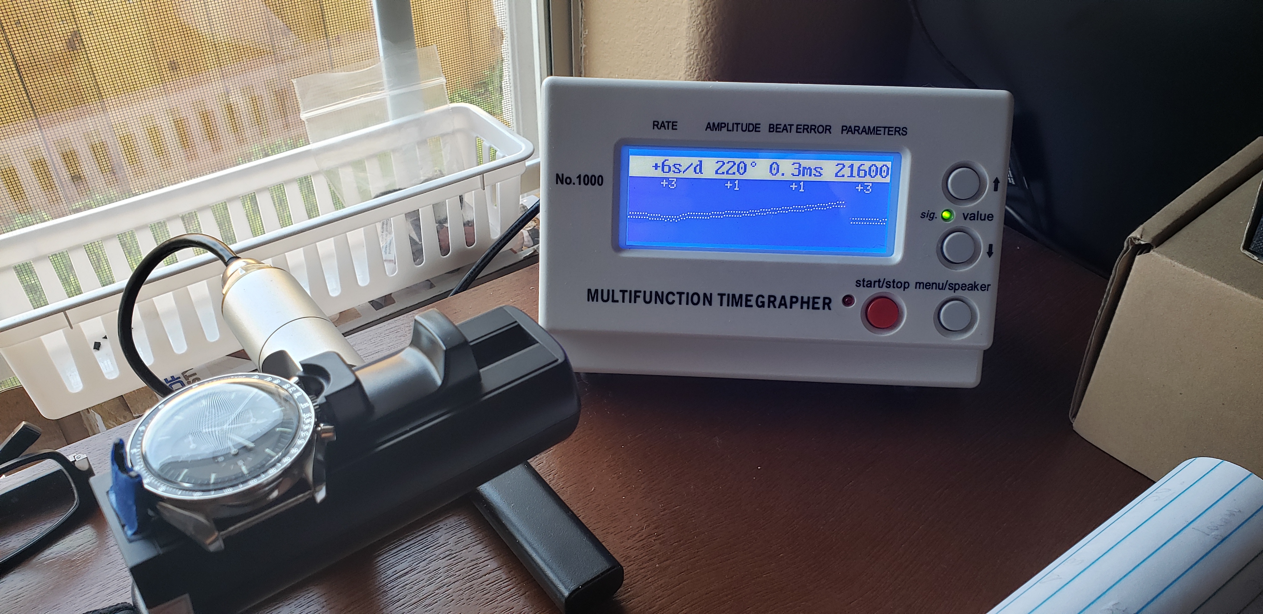

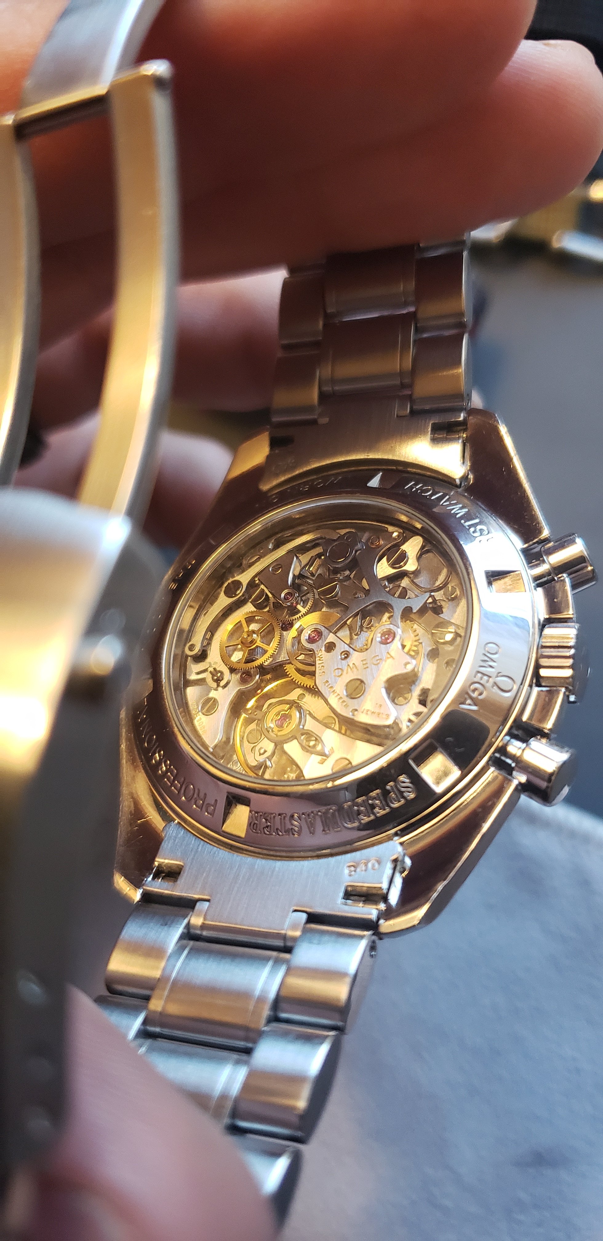

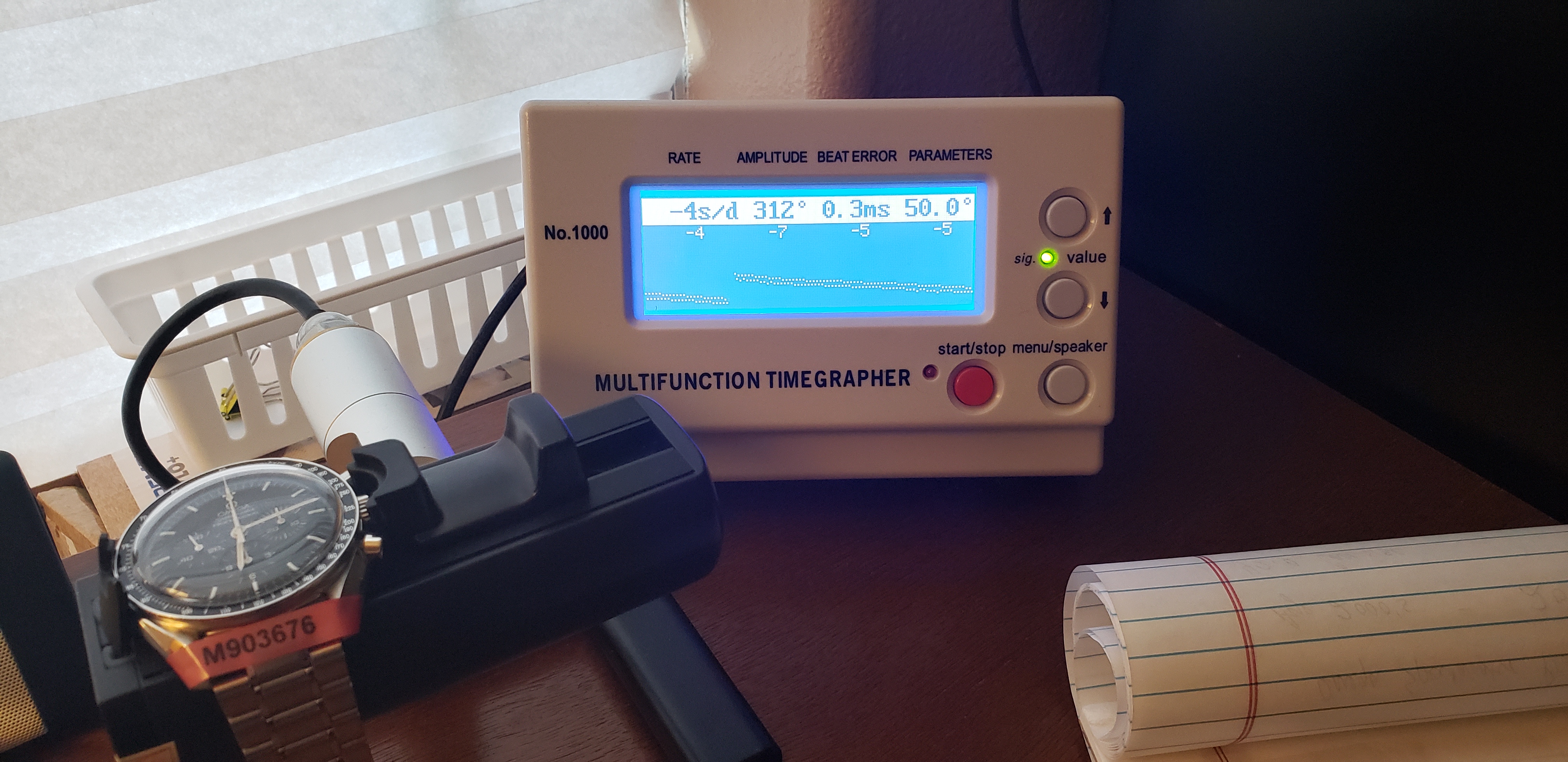

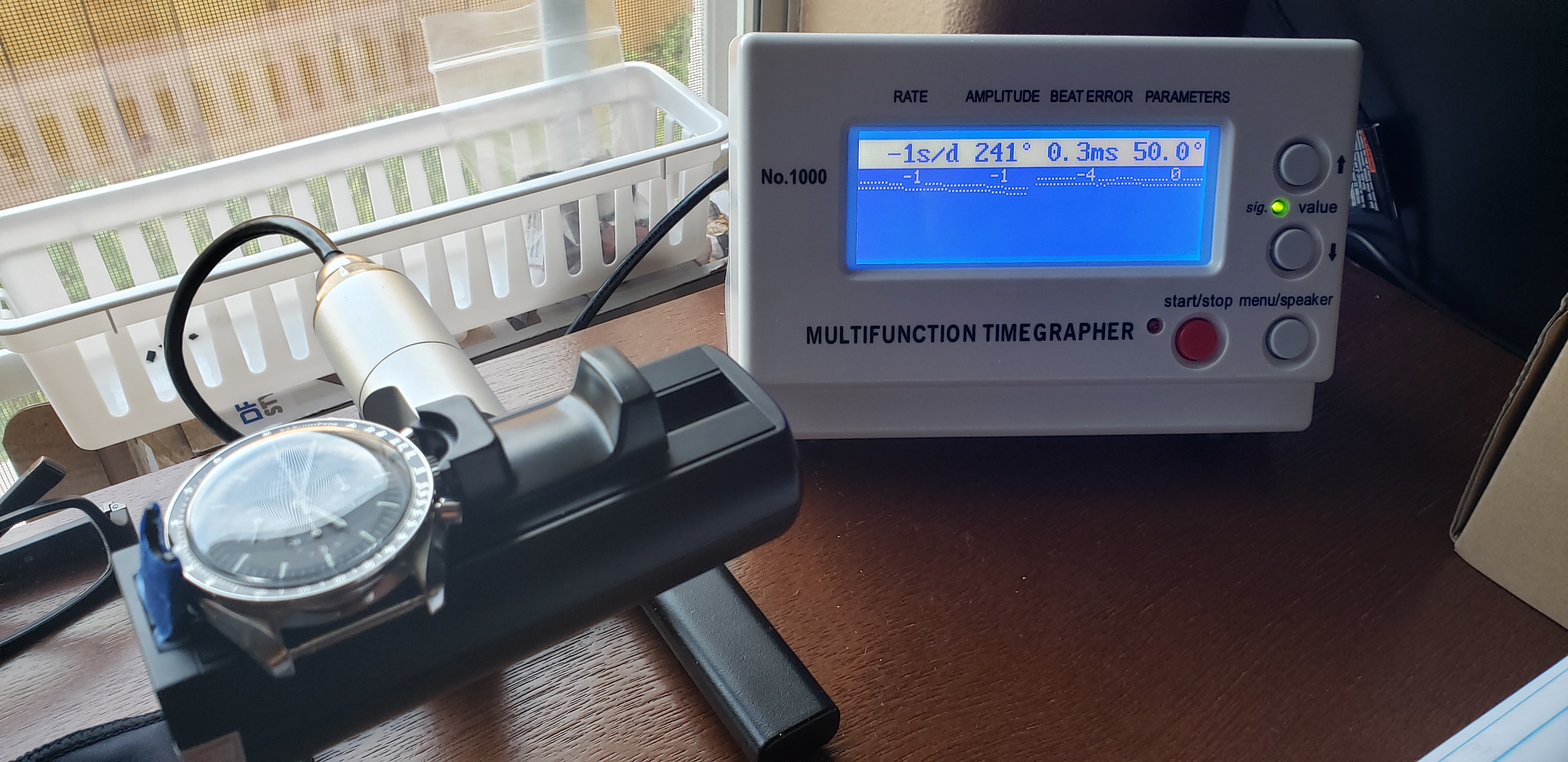

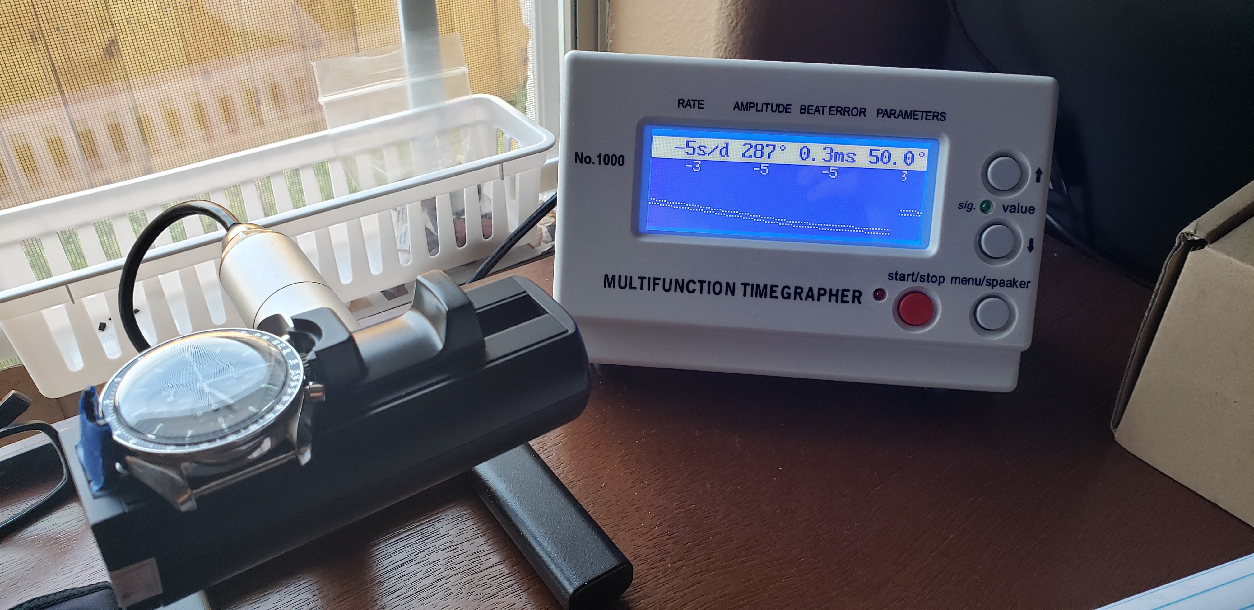

It is losing time. I read from Archer the regulation is from -1 to +11.
78
68
The secs jump back and forth to 0 to -6. Not really stable.

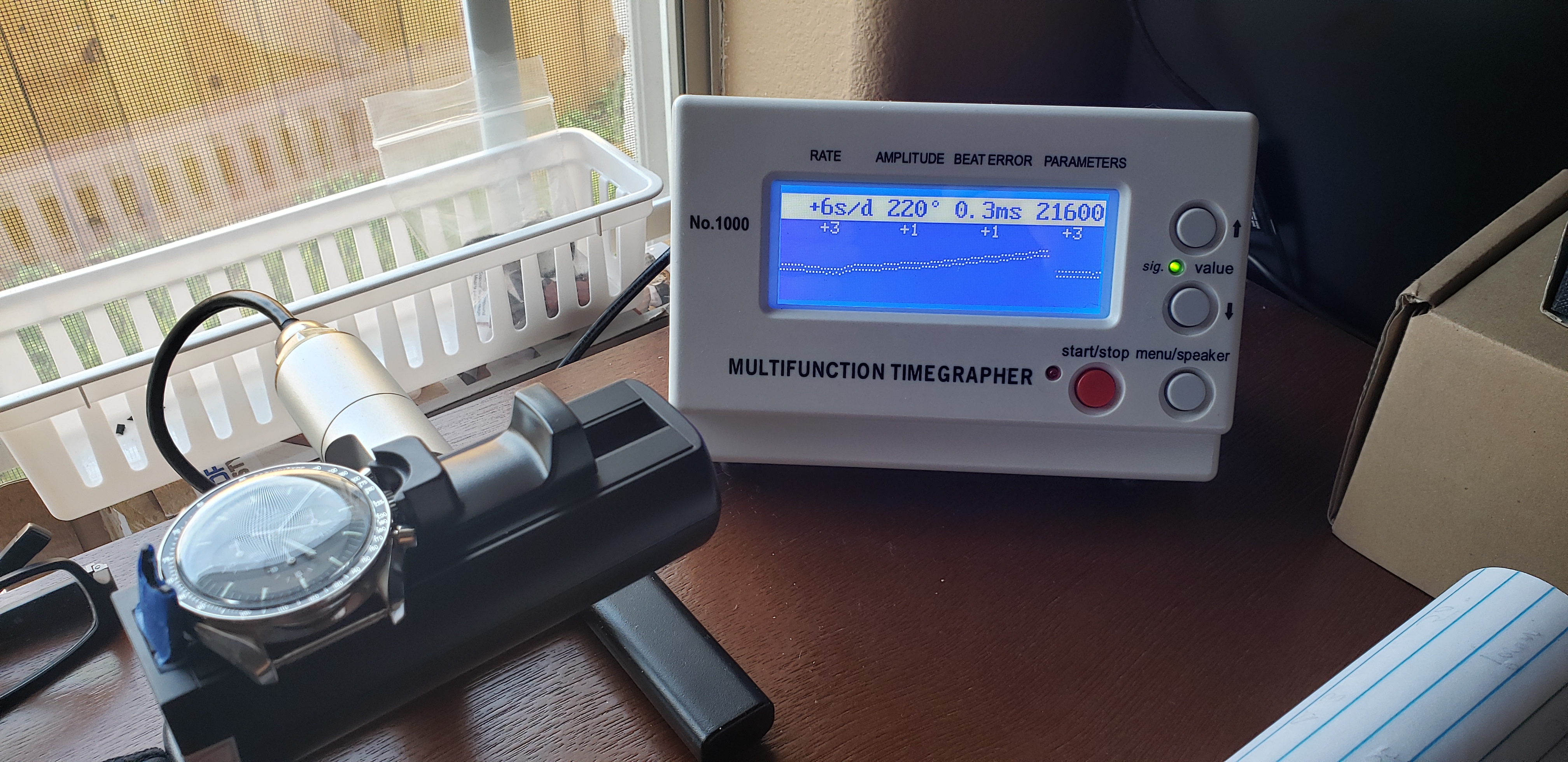

With chronograph on now it goes on the plus side. Maybe needs a cleaning? Or is this normal?

If the watch is fully wound, the balance amplitude is quite low, so an indication that service is likely needed...
I haven't winded since yesterday morning

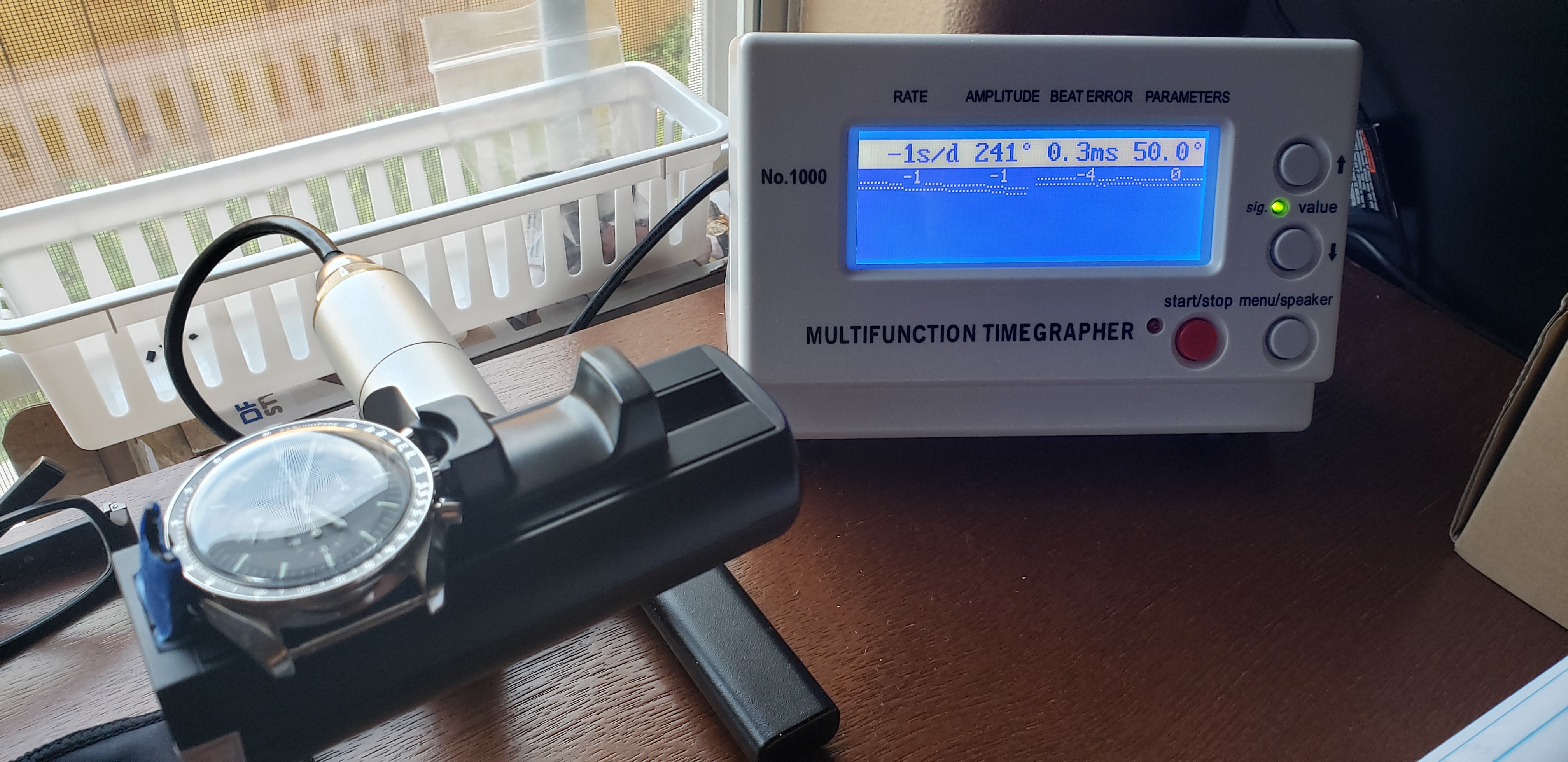

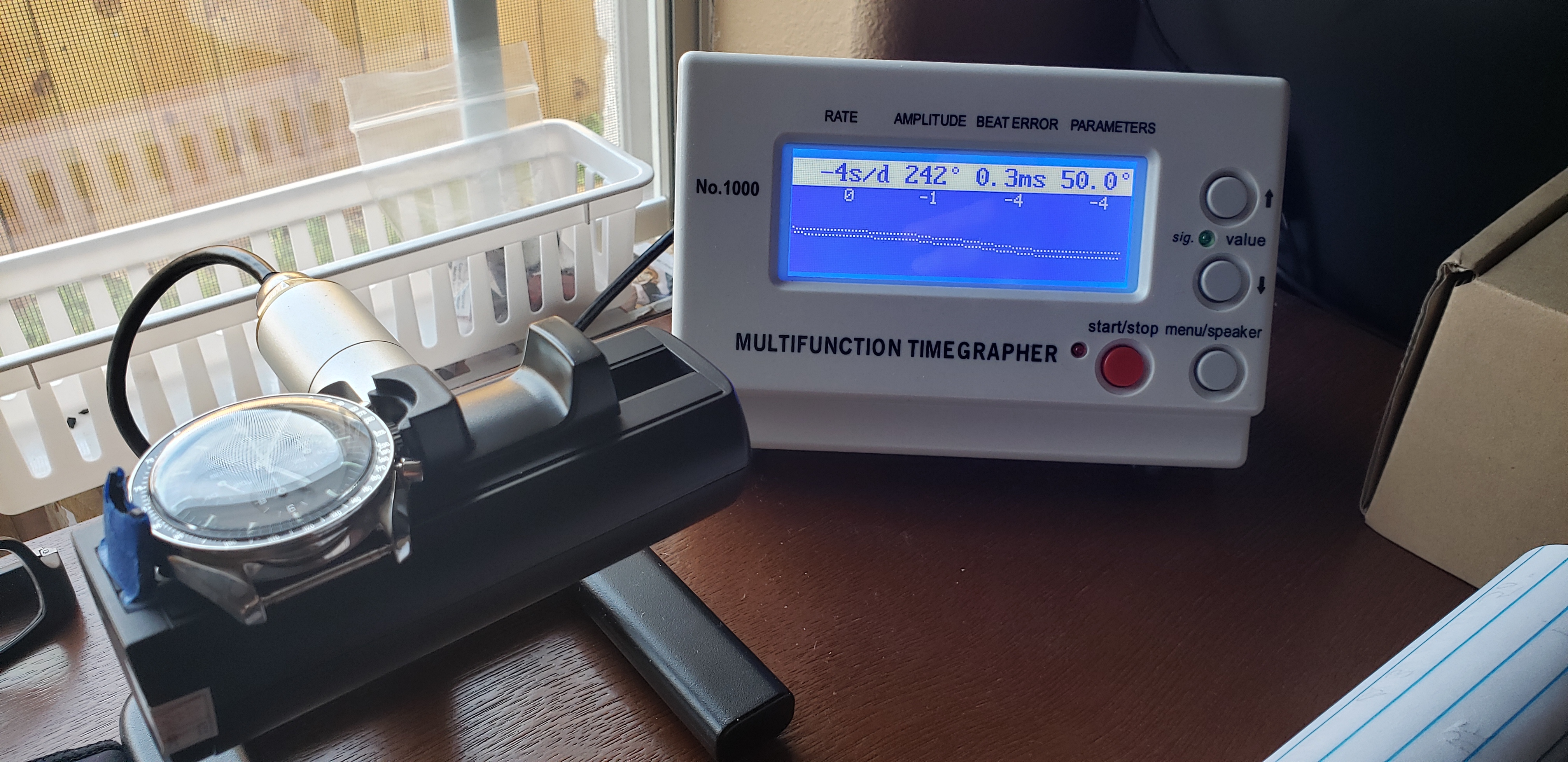

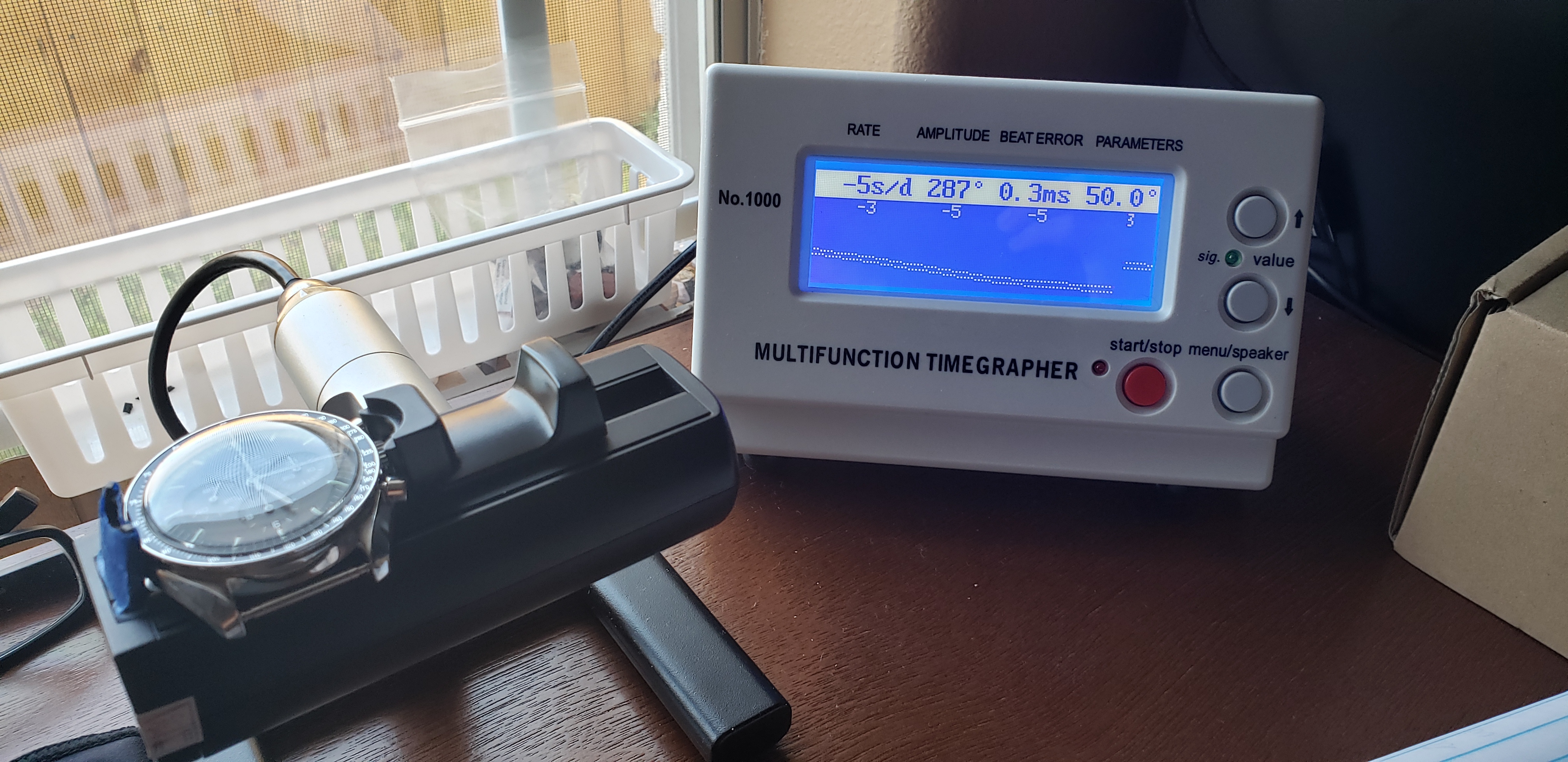

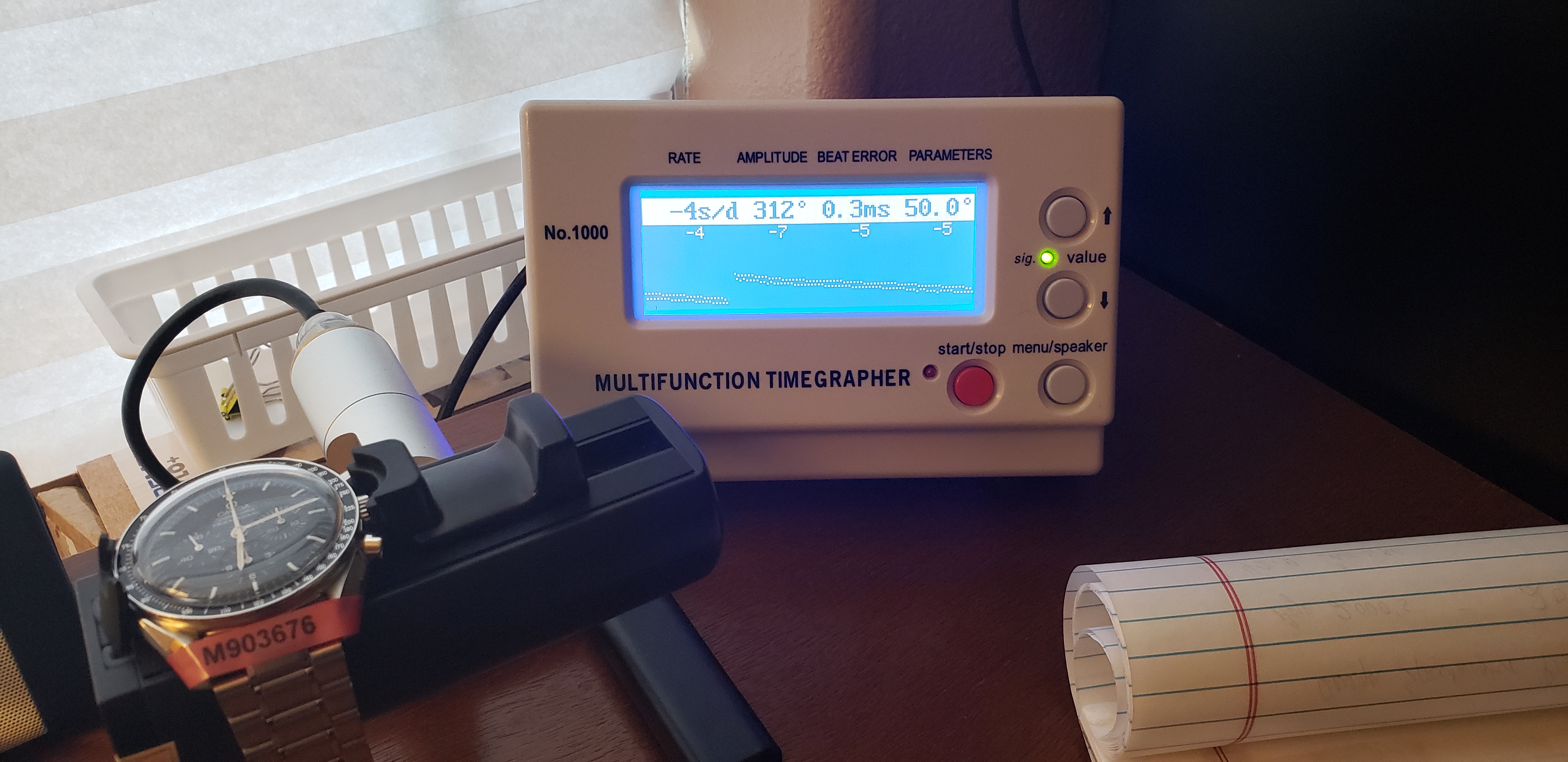

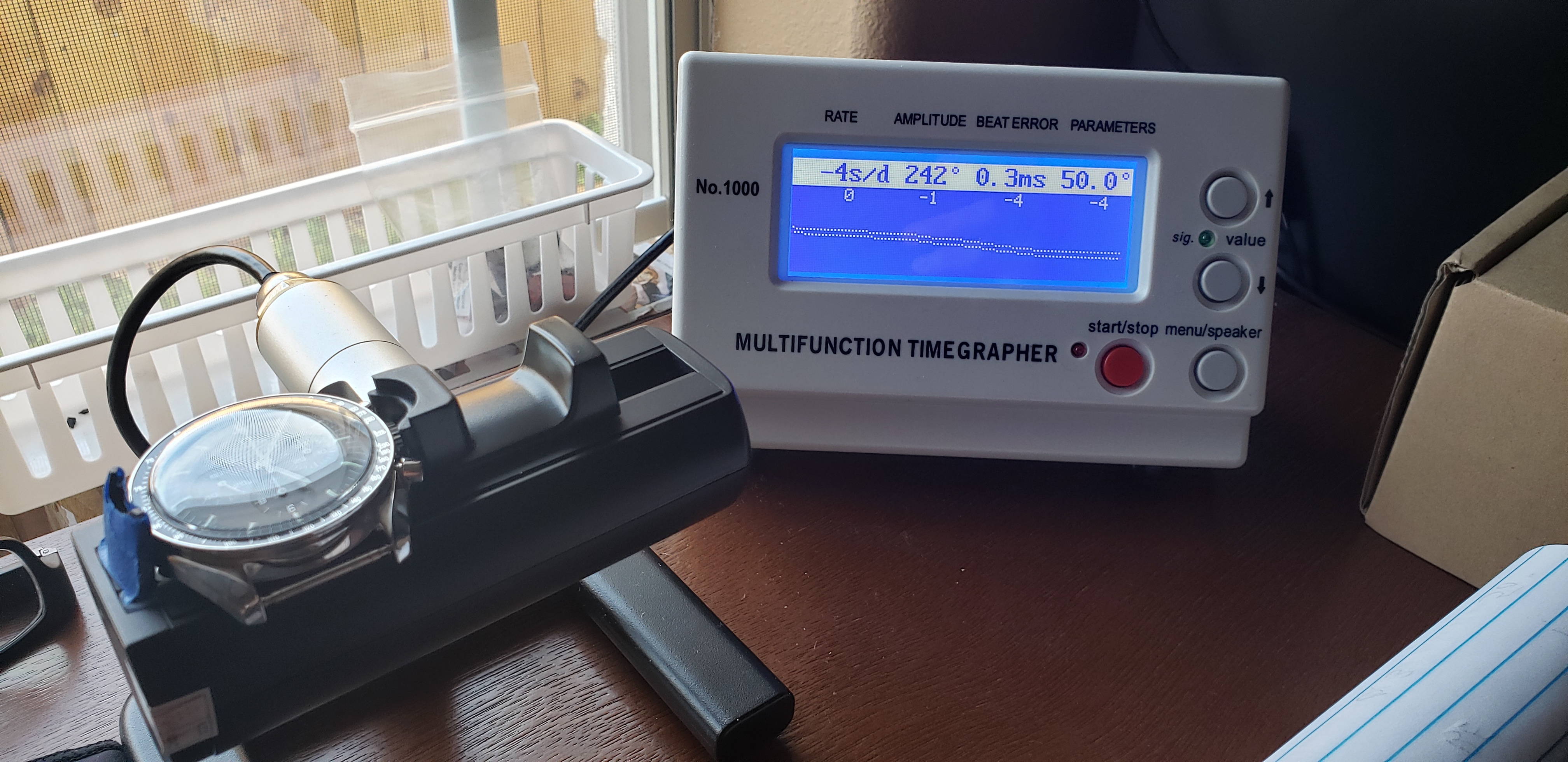

I just got a timegraper today. Looks like the speedy reduced is running good so far. Any expert advice would be greatly appreciated. Thanks Team!
