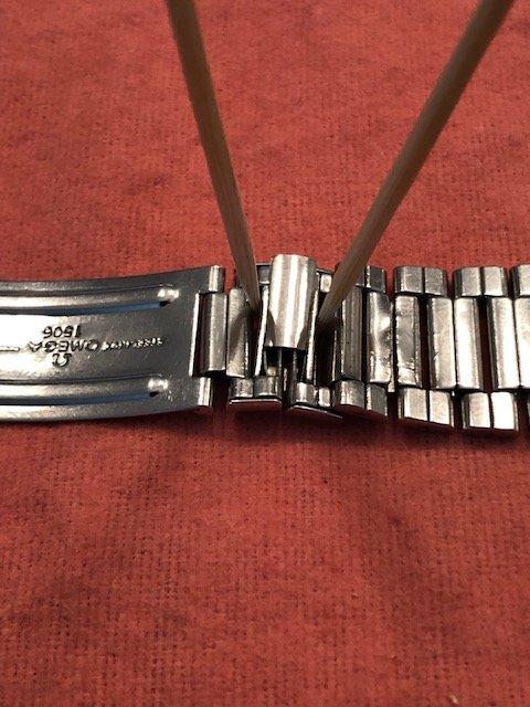

Look back a few posts you need to fold the bracelet back and use a couple of tooth picks to prop up the guides so you can slide it in.

I agree with @Taddyangle , it looks like you're trying to do this with the links laid flat, which is very very difficult. put the link in like you have it and then fold the bracelet over like it is in the pic with the tooth picks, it should only take 30 seconds to disassemble/reassemble a link using that method

Good job resizing-both yourself and your bracelet! Instead of two toothpicks I use a 1.0mm (black) screwdriver as I do the folded back on itself method and usually can slide back plate easily in with fingers. I also do this to facilitate removal of plate.

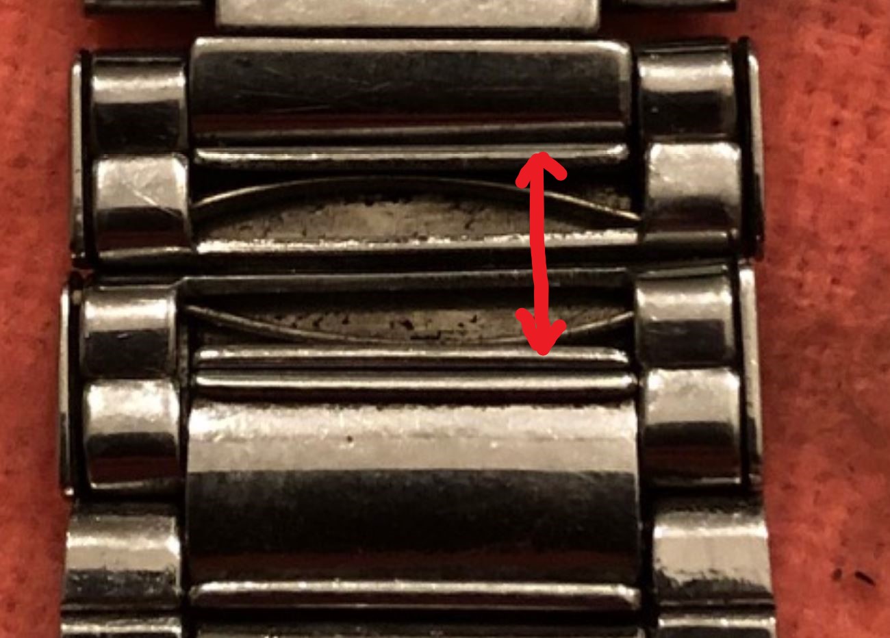

A great thread, and an old one, and one that contains all the info needed to complete the task. And I’ve been doing it this way for 25 years without a hitch. But now I’m stumped...
I’m having one of those frustrating moments when you dream of having a Wile E. Coyote mallet, smashing everything to bits with one huge swing, and sweeping them into the waste bin. The kind of moment when your wife yells from the other room, “Would you PLEASE stop cursing!” You get the picture...
I’m stuck here, where you try to slide the little cover back on:
No matter what I try to jam in that little seem to allow that little cover to slip under the edges (including my foot), I can’t get enough height to do it. I’ve obviously been trying to problem-solve this - have I encountered unusually stiff springs; is there gunk preventing movement and maybe I should lubricate it. I already ran it through the ultrasonic.
If anyone has any ideas or tips, they would sure be welcomed. Mostly by my wife...

Can you take an in-focus picture of the cover you’re sliding on and link?

Can you take an in-focus picture of the cover you’re sliding on? It looks like it might be bent or upside down.
Thanks. Tried multiple covers, all in the correct orientation. Just can’t get enough height to slide the cover on.

Hi mate. make sure the lid is sitting properly in the tray slides. Try a little bit of dry soap in the grooves or on the edges of the slide and then turn 90 degrees and use the table as support as you push down - not too hard as you don't want to bend the lid. This has worked for me most times, but not all times. I can't recall, been so long since I have done a few, but I do recall this often being a pain in the ass to fit while others just slid on beautifully.

Just a follow-up after much hair-pulling: it appears that sometimes, the little three-sided box, or outside cover, can get a minor bend that will make it impossible to slide the cover in. I found that if the cover will slide into the slots outside of trying it on the bracelet, it will usually worki when mounting it. But if you can't get that cover to slide in when off the flat-link, it very likely won't work on it either. Helps to have some spares...
