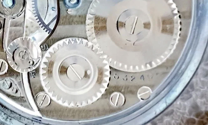

How do I identify the age of this inheritance

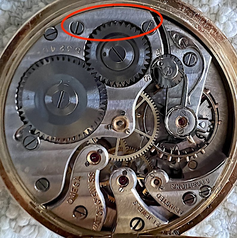

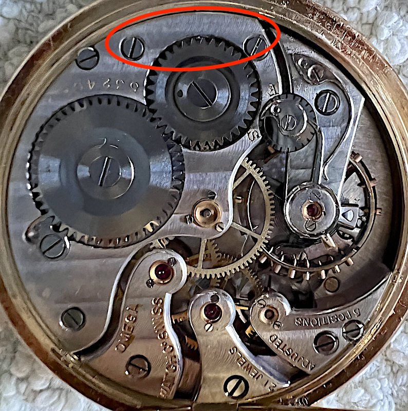

Jim, in your experience, is negative set more prevalent in North America?
I think it stems 😁 from the way watches were made in the US in those days Tom.
The large watch factories made and distributed standard sized movements which were intended to be fitted to standard sized cases made by watch case manufacturers. The two industries were seperate entities in the early years of American watch production.
Because fitting a movement to a case was meant to be a relatively simple task performed by the local jeweller, the movements had no protruding stem. It could easily be popped into a case of the buyers choice.
To correspond, the case makers produced cases with incorporated crowns/stems that would be in winding mode when the crown was pushed in and in setting mode when the crown was pulled out.
So, a jeweller would take a movement, which would be in "setting" mode due to the setting lever spring not being depressed/disengaged, and put it into the case with the crown retracted. The crown would then be pushed in to wind the watch, pulled out to set time and then back in to run.
This method was used up until about the 1900s when watch factory/case makers became complete "watch producers" and the need for case/movement standardisation faded away and watch movements were produced with integrated stems with "positive" setting which is the normal configuration today.
Swiss watches of that period were usually found with the integrated stem as we have today, but produced negative set movements, I assume mainly for the American market to allow Swiss movements to be fitted to US made cases.
If you look at the pic of the OPs movement, you'll notice there is no screw for depressing the setting works to allow removal of the stem as is found in watch movements with integrated stems.
PS: This is all from memory, so if I have things arse about I invite corrections.
Cheers Jim

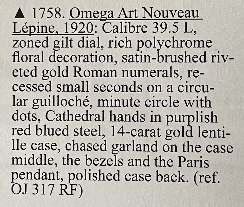

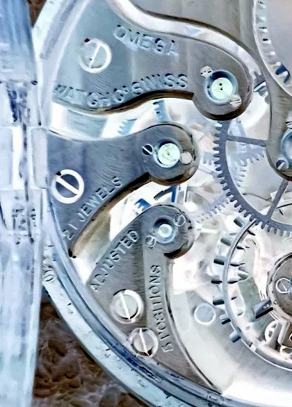

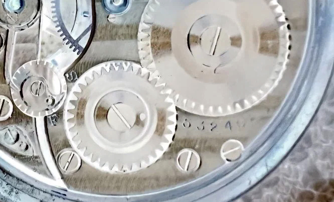

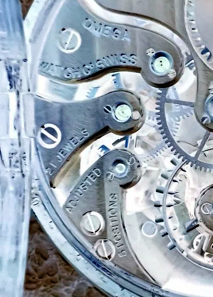

LX is a grade of finish (I assume).
Dear Jim,
I don´t want to act like a busybody but IMO your explanation is (partly) not correct. The "L" stands for "Lepin" which means "open face"

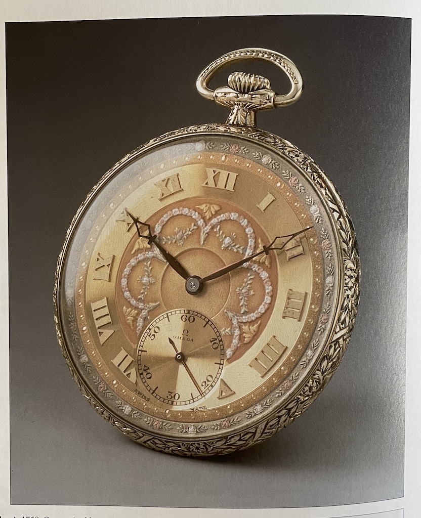

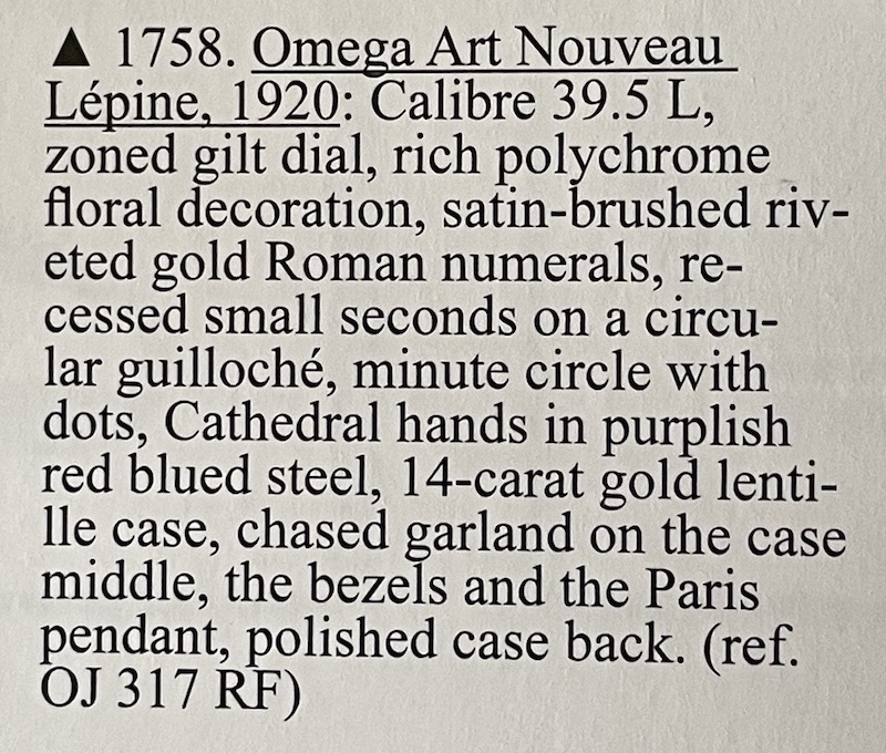

Something kept nagging at me, I was sure I'd seen a watch like that before, so I got out my bible and found one very similar in the "Creation" chapter.
While very similar, your's has a different movement, small details on the dial are different and the hands are not the usual style seen on Omegas of this period and they may have been US style hands fitted during purchase or later.

Dear Jim,
Thanks Erich, my booboo.
:whipped:
To my understanding the caliber came in two styles, LX for Lépine and SX for Savonette.
Is there any meaning to the "X"?

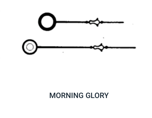

.............. It does have Omega on the second hand dial. Would it have been made by Omega and shipped to the states? It’s so beautifully designed.
Yes, the movement and dial would have been exported from Switzerland as a complete unit for casing in the receiving country.

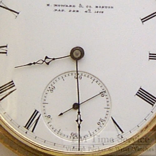

I don't know if the hands were part of the original movement/dial combo or not.

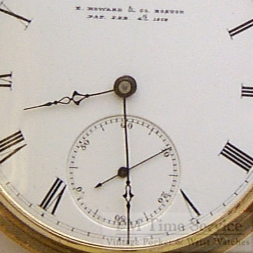

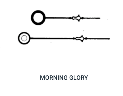

Edit: As I mentioned earlier, I believe the hands don't have "Omega DNA" and I've found an example of the minute hand like the ones on your watch. I still have to find an example of the hour hand.
Edit: After finding this, I suspect the hands are a match and probably a version of morning glory. These are usually found on American watches.
From PM Time Service
"The end of the hand is detailed with a stylized flower bloom design that is reminiscent of a morning glory or tulip bloom. Similar to the "Morning Glory - open" style but with a solid design instead of having open spaces in the design."
I have searched the Omega bible but was not able to find an explanation for the "X"
As the cal 19´´´ was build in 2 different versions, one with the common shape of plates and bridges, the other with "snake-shaped" bridges (as Omega calls it) as in the OP´s watch - the X might be the abbreviation for this kind of movement - just a thought...
18,837
39,175
Good deduction, I agree as it seems the only calibers with the "X" designation are the 13''' 15''' 17''' 19''' and 20''' with the serpentine bridges.

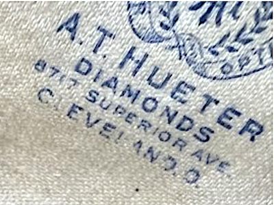

A little bit of entertaining thread drift.
Do we remember the retailer of the watch?
It seems the family was quite busy in Cleveland at the turn of the 20th century. Not only did they have the pleasure of selling a very nice Omega pocket watch, they also had some moments of excitement.

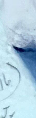

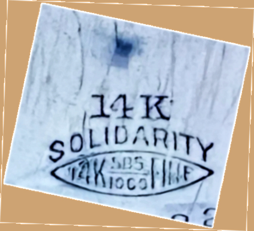

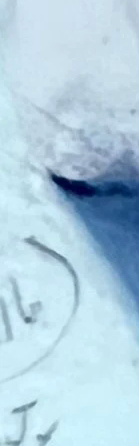

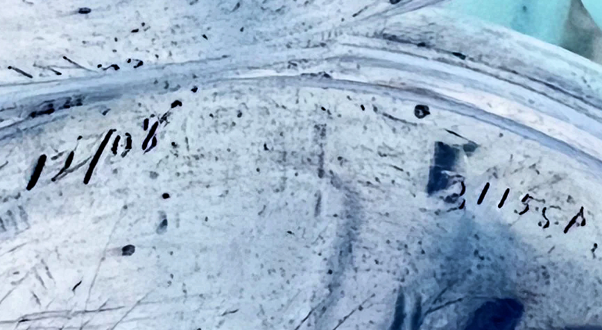

Fascinating thread and a gorgeous watch.

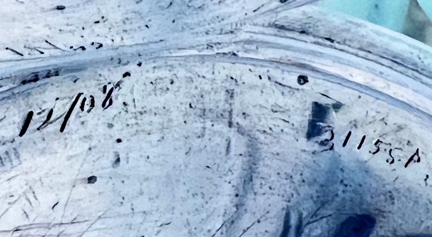

One of the marks on the case back does look like an attempt at a signature to my untrained eye.
