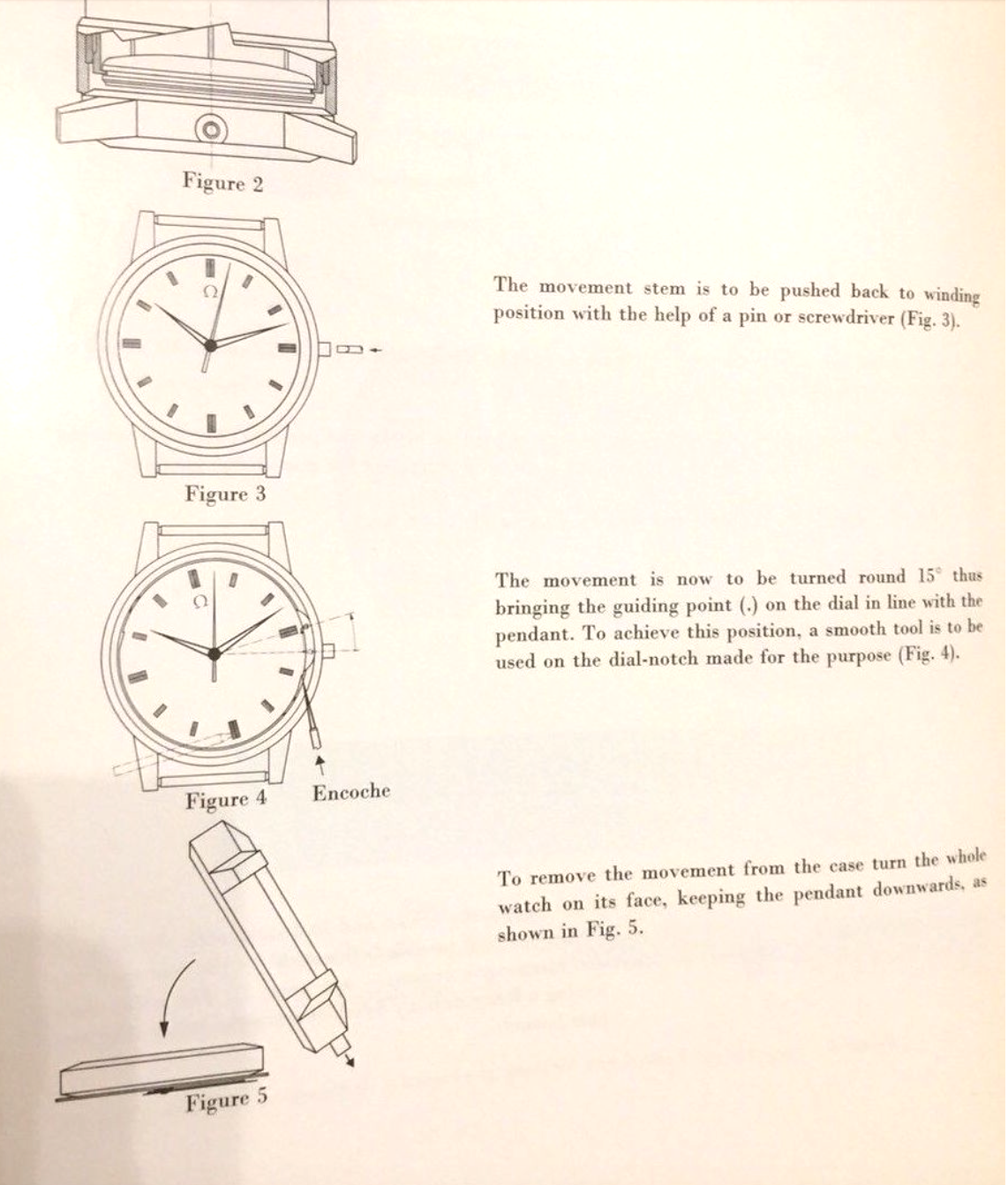

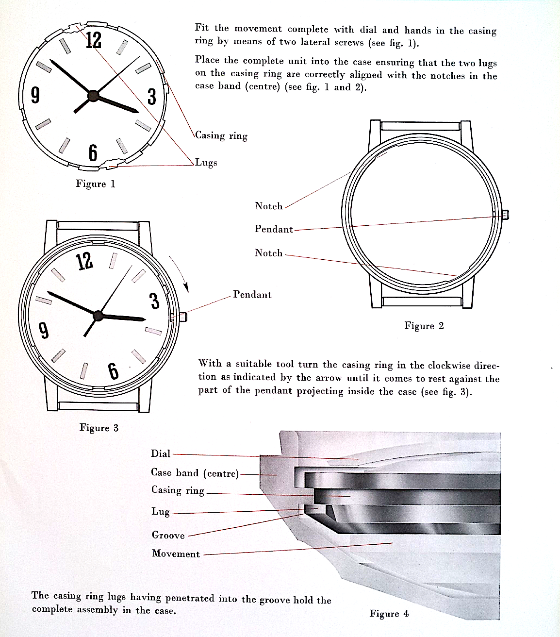

Maybe this.
The split stem should pull off and you can rotate the dial/movement out of the retaining clip in the case.
Search for Omega Monocoque/Unicoc/Unishell case.
Monocoque.
Unicoc/Unishell.

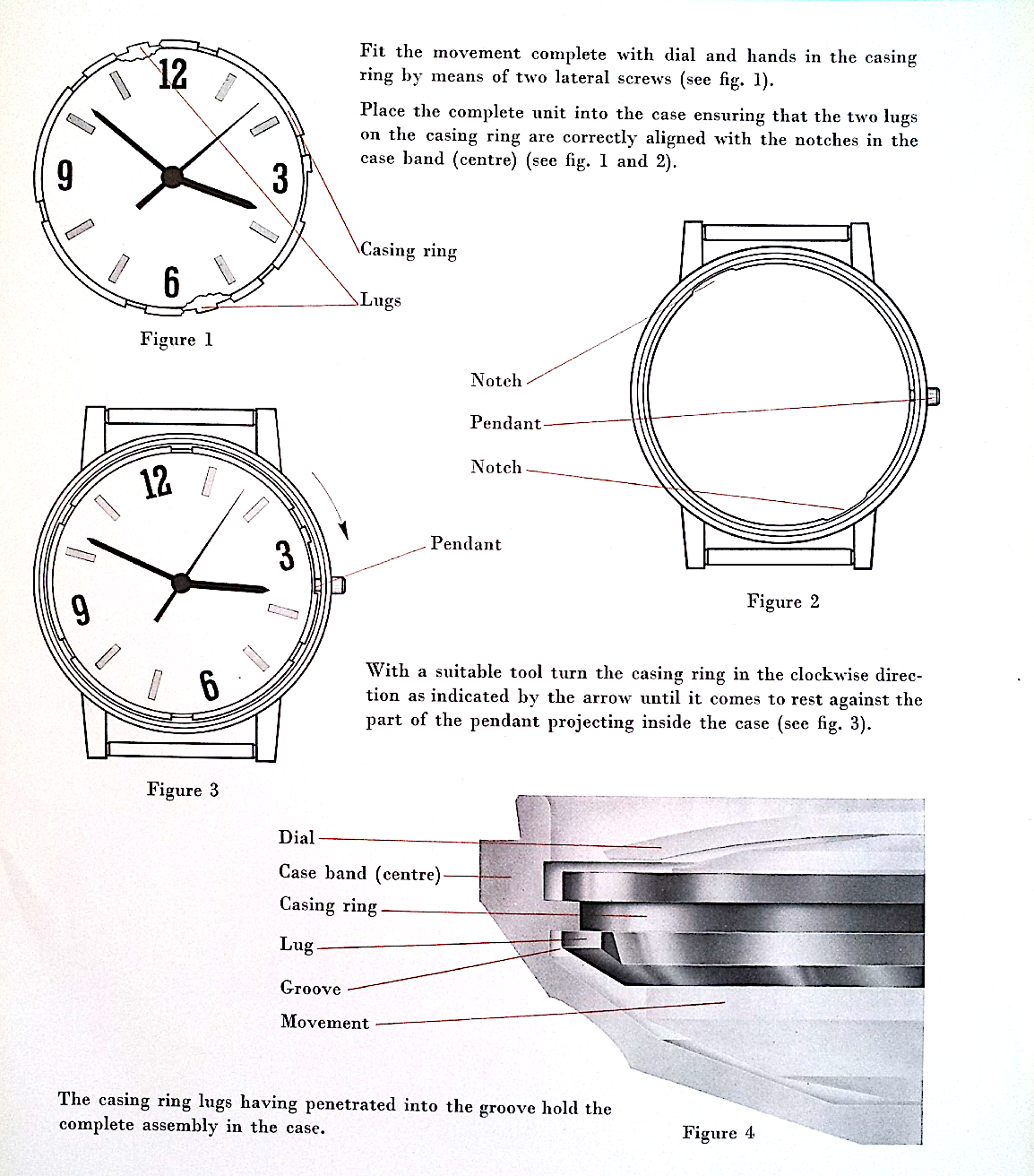

Front loaders usually use a split stem. You have to pull the stem out with some force and it comes out in two parts.
Then the movement is rotated a few degrees counter clockwise as I remember, there are fingers in grooves called case clamps what hold the movement in. Any prying will damage things ireversably.
If this is not a front loader and has a solid stem, then pulling the stem can damage it and the winding mechanisim.

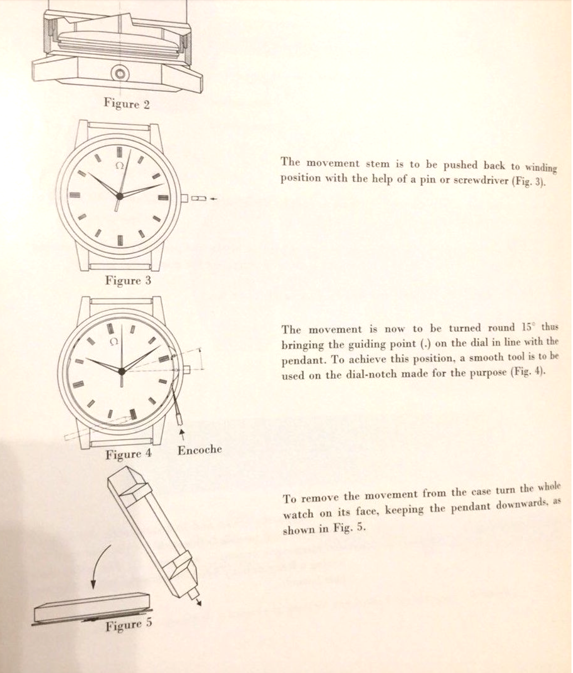

Thanks for the replies, that was very helpful. I gave a moderate tug on the stem and it did not want to come off.
From a search I found this thread: https://omegaforums.net/threads/1969-omega-geneve-9k-gold-131-25016---serviced-unpolished.78148/
It appeared that the movement should just come out. I pried a bit around the circumference and it came out. I was just too cautious the first time I tried.
