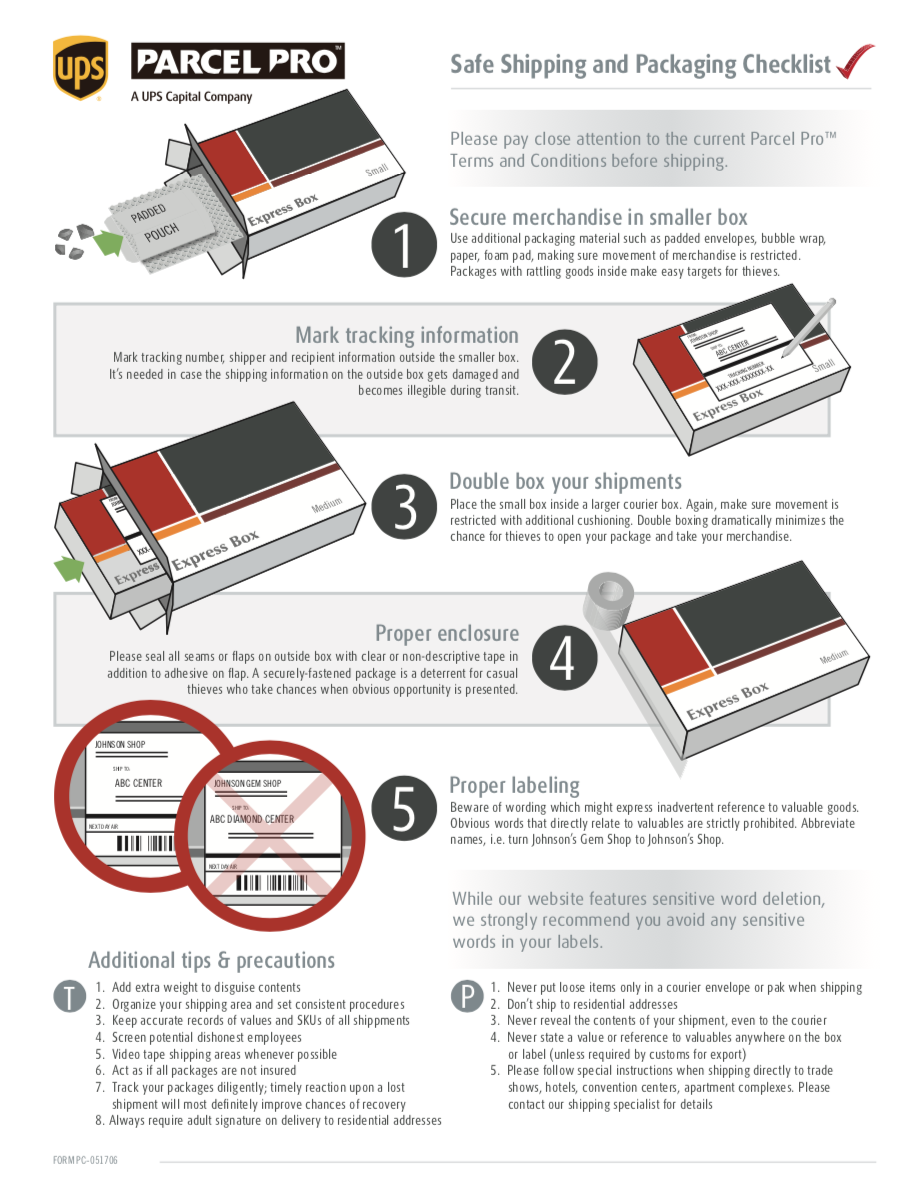

    Anyhow, what is in your opinion the best way to pack a watch to minimize risks of theft?
    I used to think a padded jiffy envelope surrounded by lots of tape, glue, staples would be more unobtrusive and deter curiosity— a bit like an old bike with a very big lock would make it inefficient to attack.
    One of our good members here who has extensive experience shipping watches opined that a box is better because it cannot be made to tear « accidentally ».
    If so, a small box or a larger box? I seem to recall people recommending a larger box (shoe box size or larger) because it’s harder to hide away or suspect what’s inside.

    I usually double box my watches while providing delivery instructions on both. Also, opt for large box as it’s more difficult to steal or conceal.

    Oh no, I use a medium FedEx box as the outer shell and a small FedEx box which slides in nicely as the inner box. Both are free at local FedEx stores. You can also look up their dimensions on their site to get an idea.
    I also video tape all my packing for insurance purpose.

    I normally use shoe boxes. I have no idea if it helps but they couldn’t be stuffed inside a jacket and taken to a quiet corner for opening. Also I double box for security.

    When I was "VP of Logistics" (aka unpaid helper in the summer) for my dad's watch shop, the procedure that had the most success was to wrap the watch in bubble wrap, put it in the smallest box that would fit it, and fill any remaining space with crushed newspaper. Tape up that box, put it a larger box and stuff the remaining space with more newspaper until nothing moved. (If a customer had been a PITA, they'd get packing peanuts instead of newspaper). The goal is to be able to shake the box and not be able to to detect anything moving inside.

    Thank you dear lady and gentlemen! A lot of great advice here, double boxing seems to be the gold standard.

    I really like the tamper proof tape which I had no idea existed and I see available on Ebay! It sounds like a really good deterrent as everyone down the chain should notice tampering.
